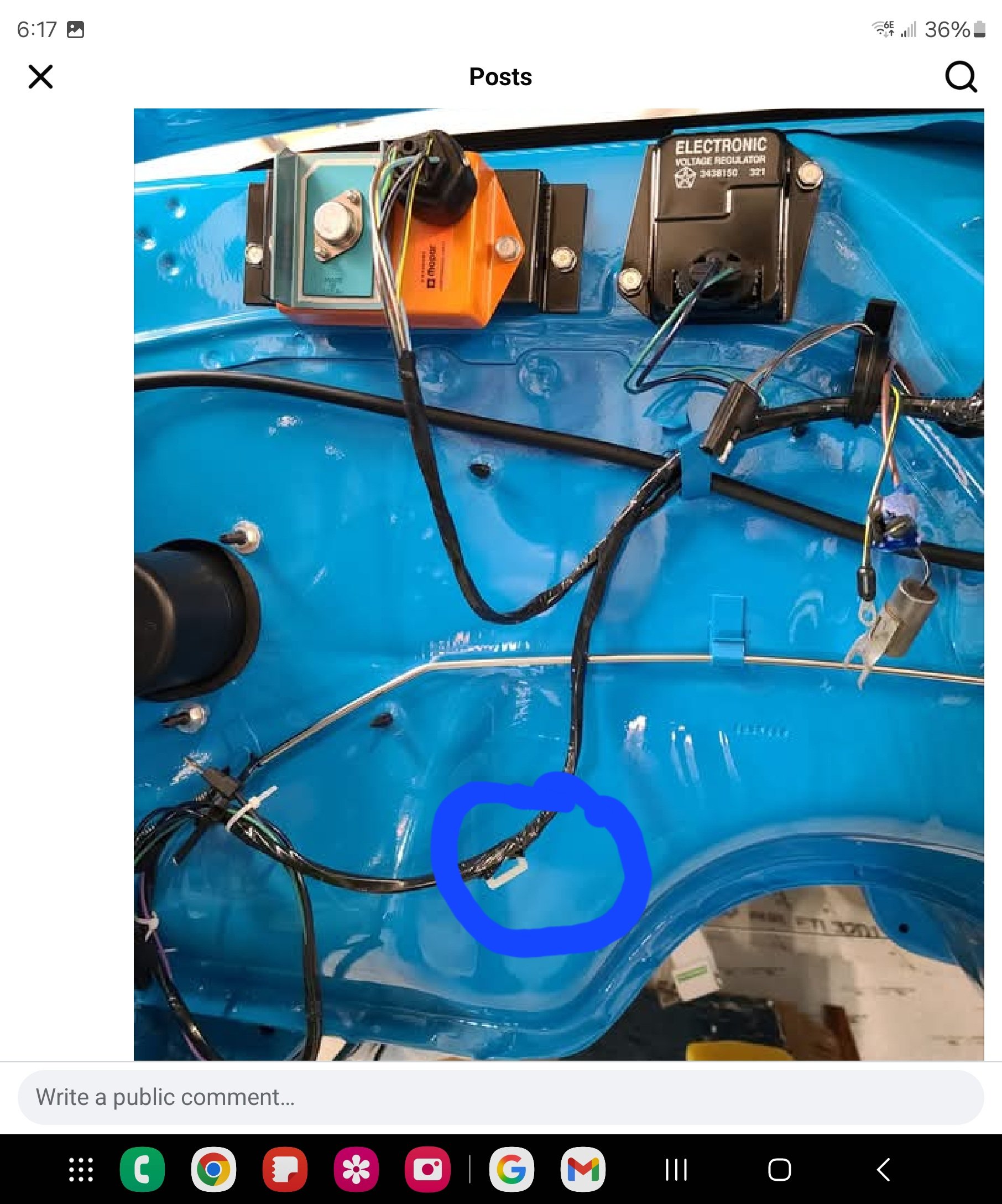

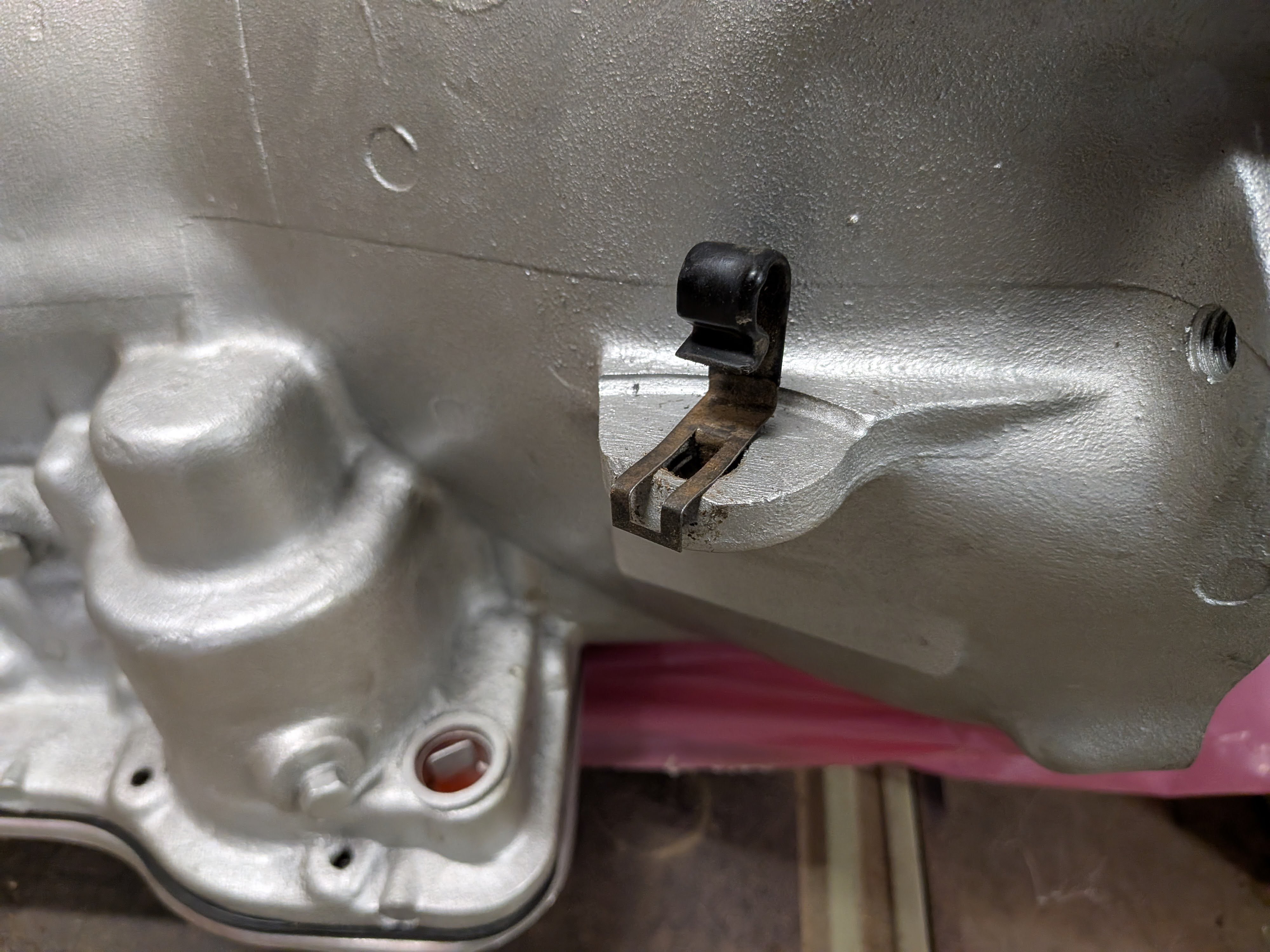

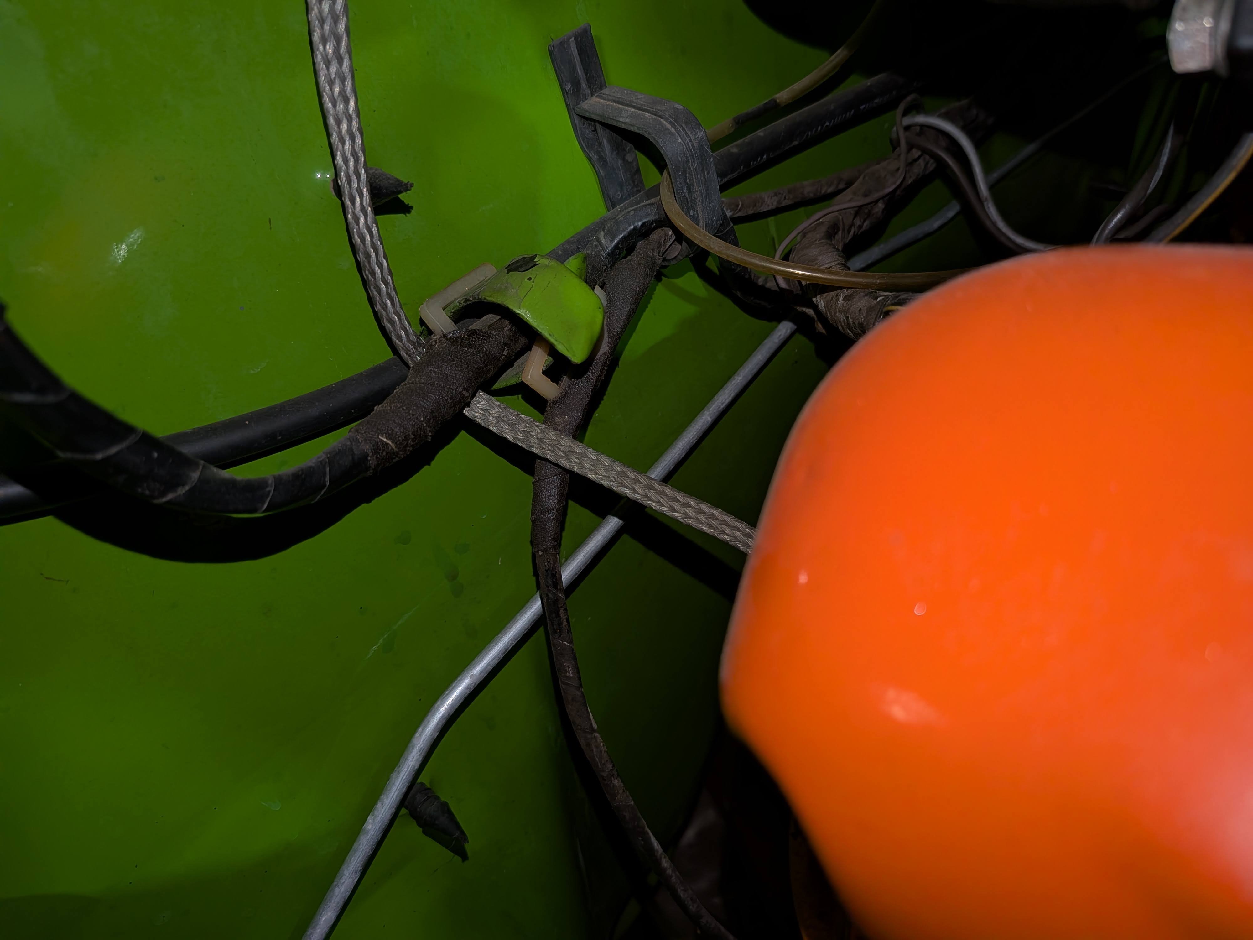

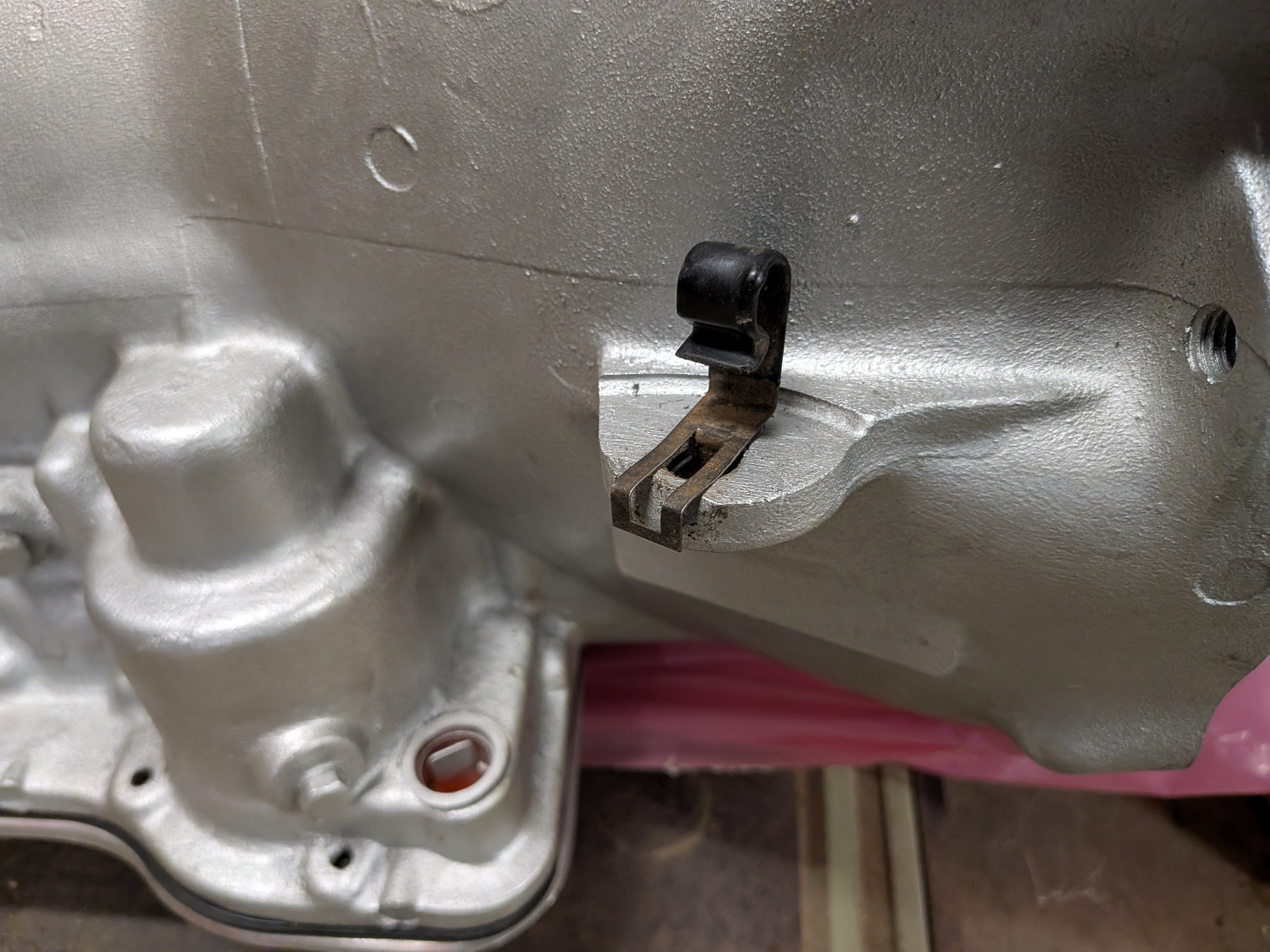

I have a new neutral safety switch wiring harness that goes from the bulkhead down to the transmission. My question is, there is a white plastic hanger that is made into the harness. It looks like it hangs on something.I am looking to find out where that wiring harness hangs at on the firewall going down to the transmission.Also , there is a metal clip that is supposed to go into a half hole on the transmission that holds the wiring harness.. Any advice or pics would be helpful.Thanks... The first clip is the wire that holds the neutral safety switch harness to the transmission somewhere.. In the second pic is of what the white piece of plastic that is made on to the neutral safety switch?Harness?Looks like it hangs on the firewall.Somewhere thanks

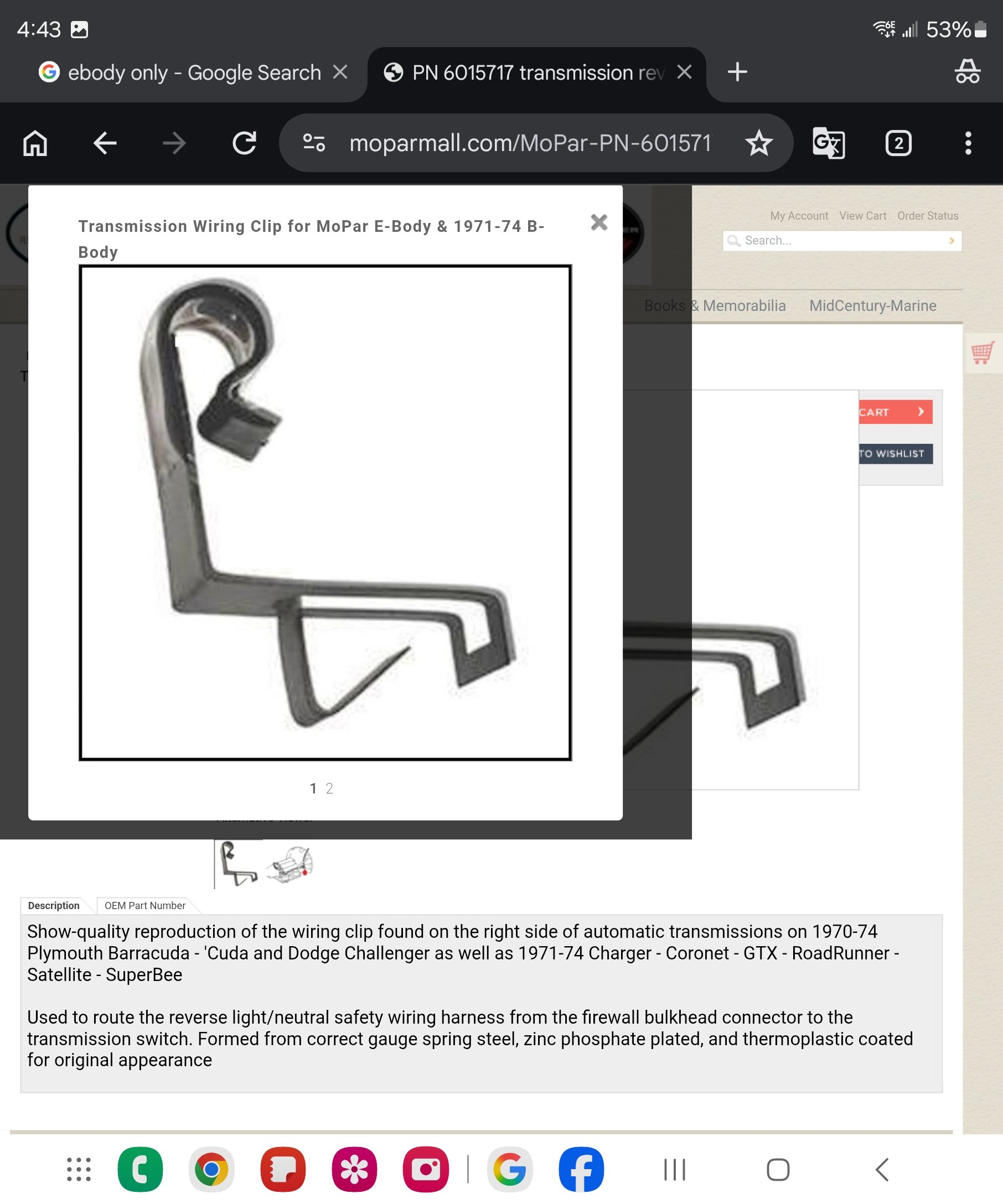

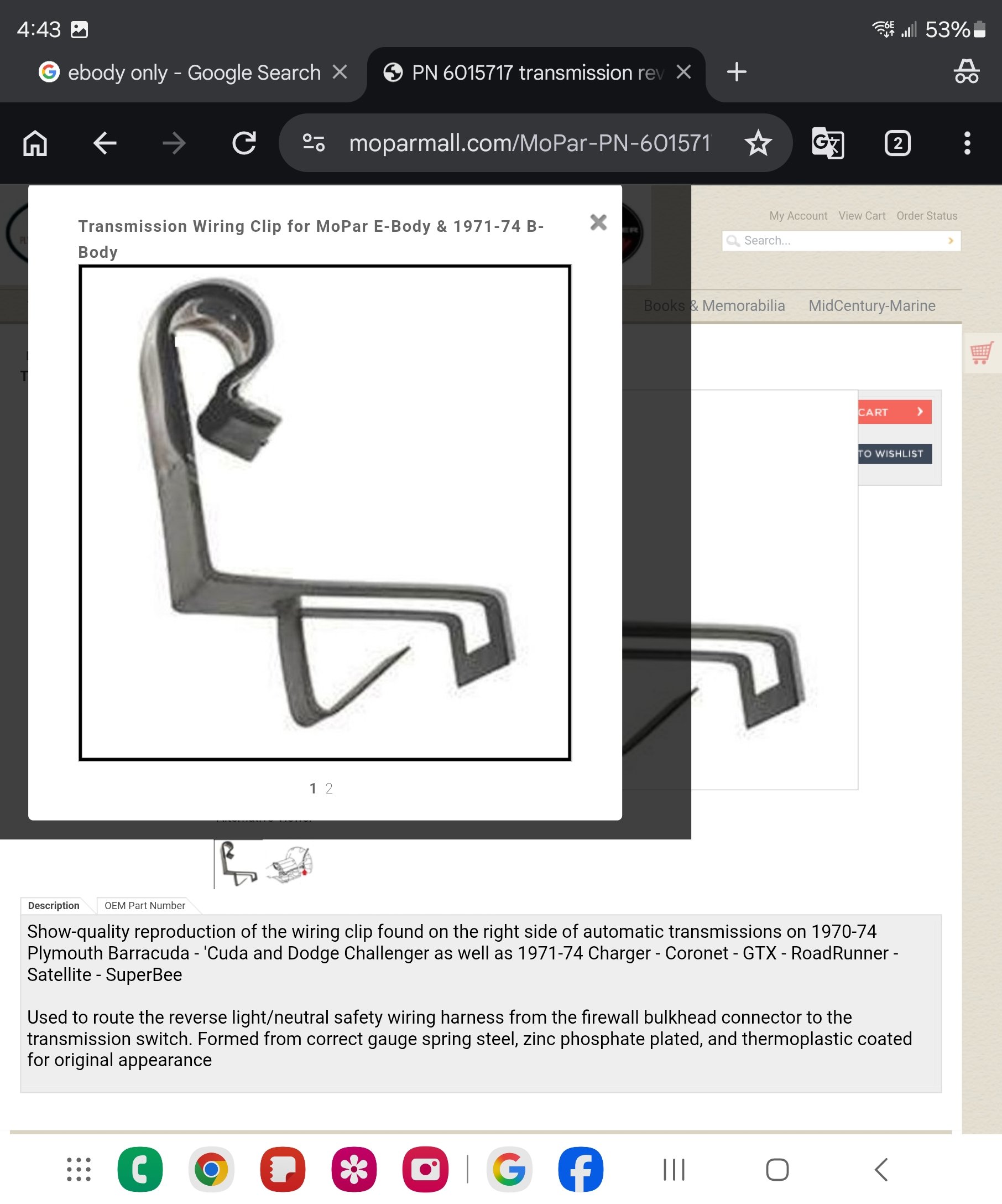

The transmission wiring clip snaps into the lug on the side of the transmission as shown in the following image:

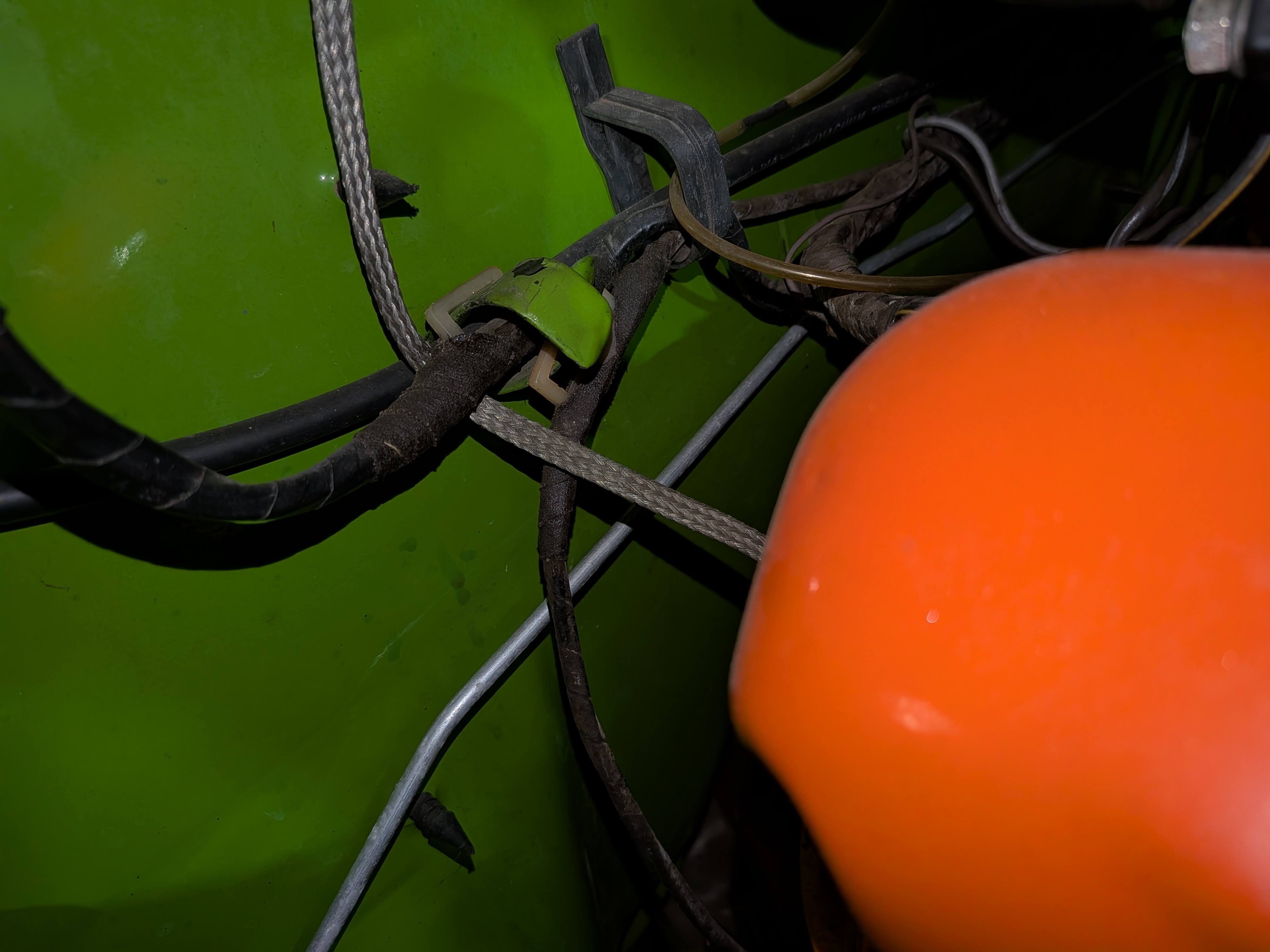

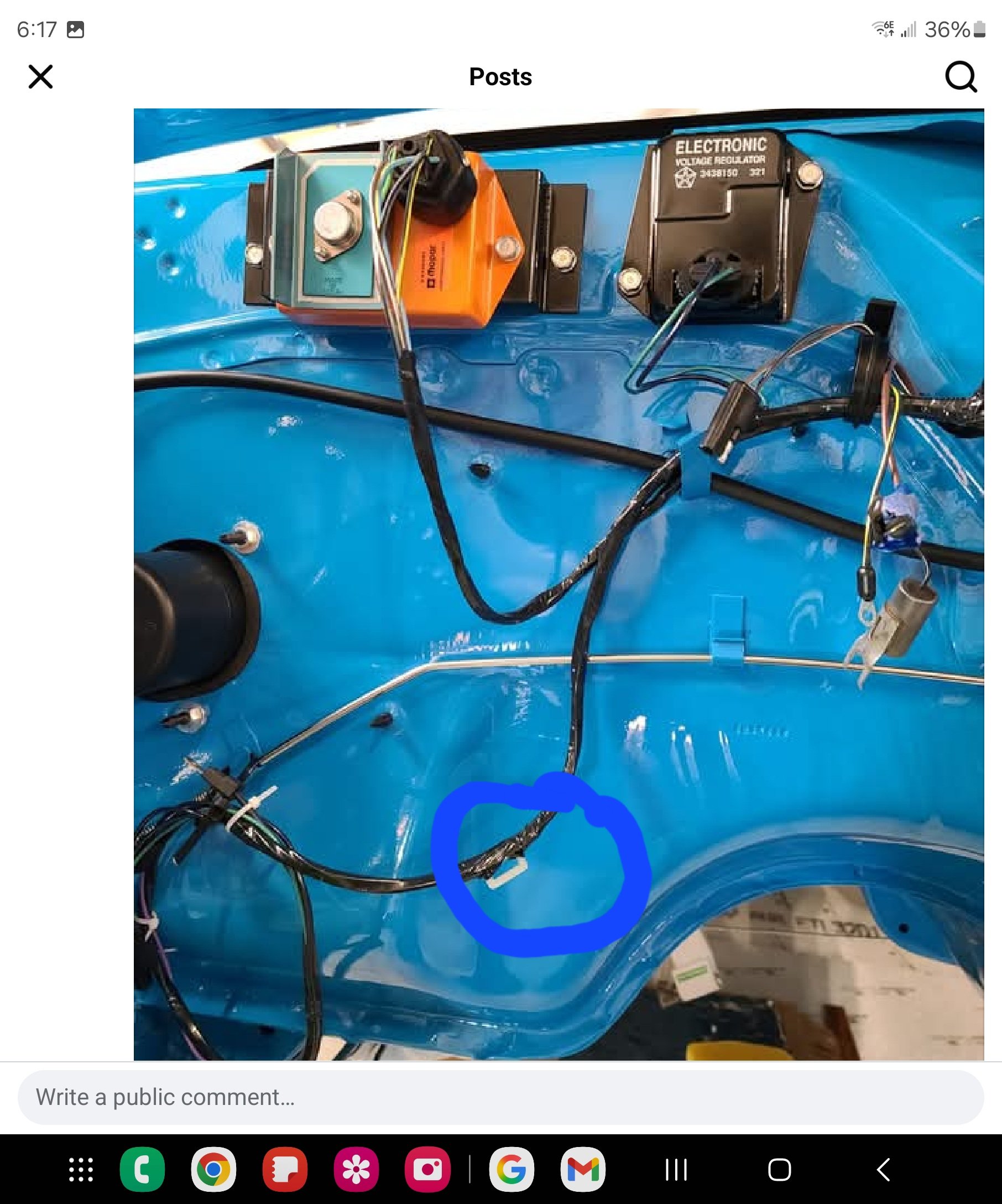

The neutral safety and reverse lamp wiring harness retainer hooks onto the wiring retainer on the firewall, similar to what is shown in the following image. This retainer is positioned differently than yours because it is a 1970 model.
The plastic retainer is broken here. It is just hanging on the firewall retainer. I will replace it later.
