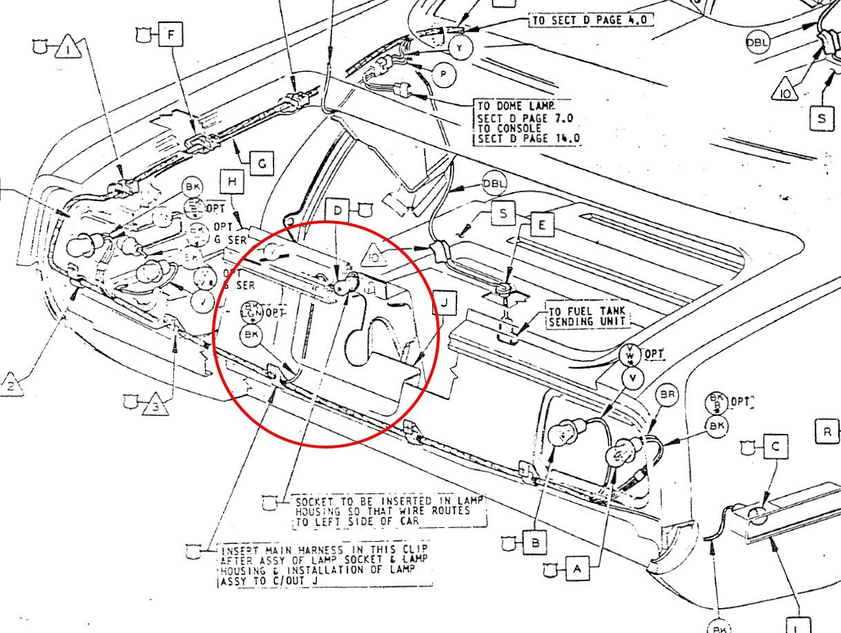

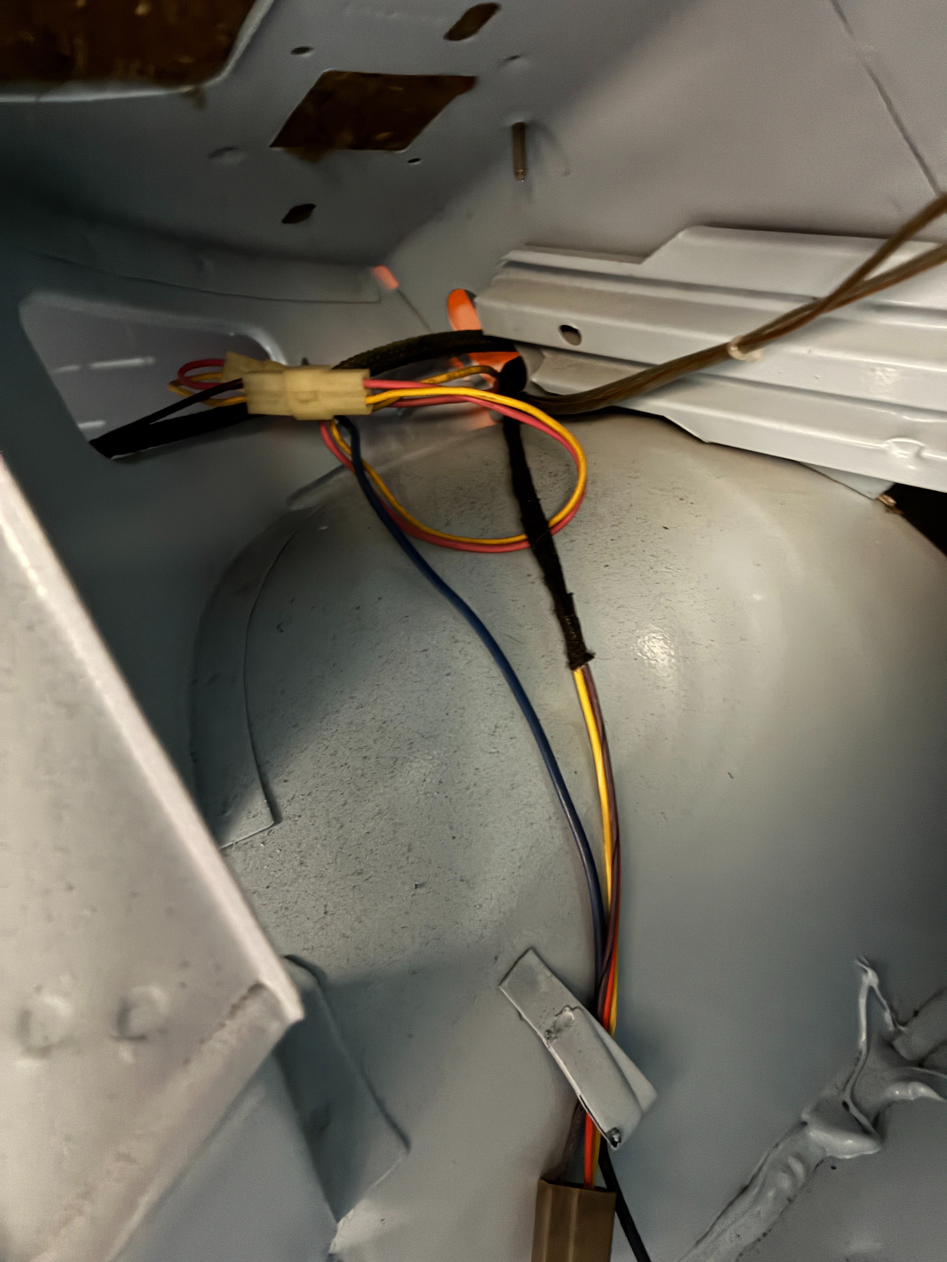

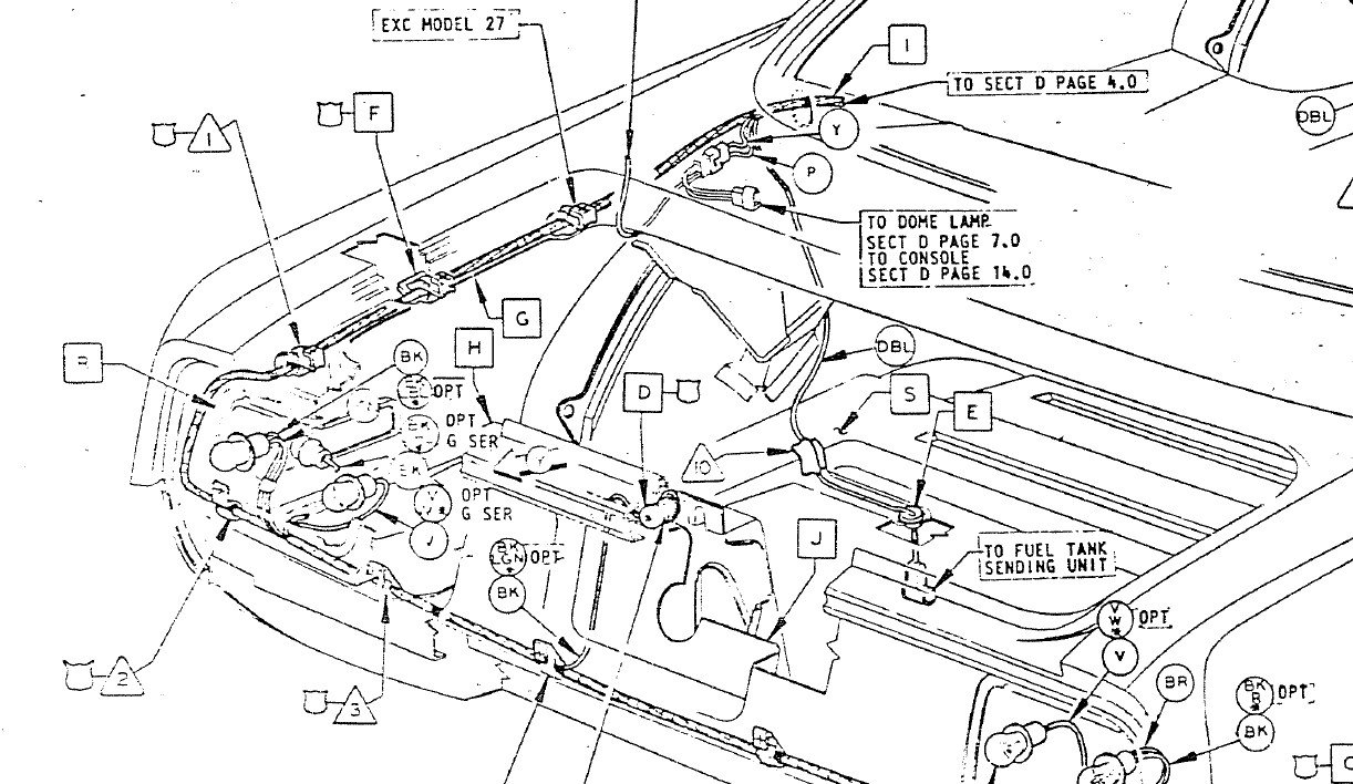

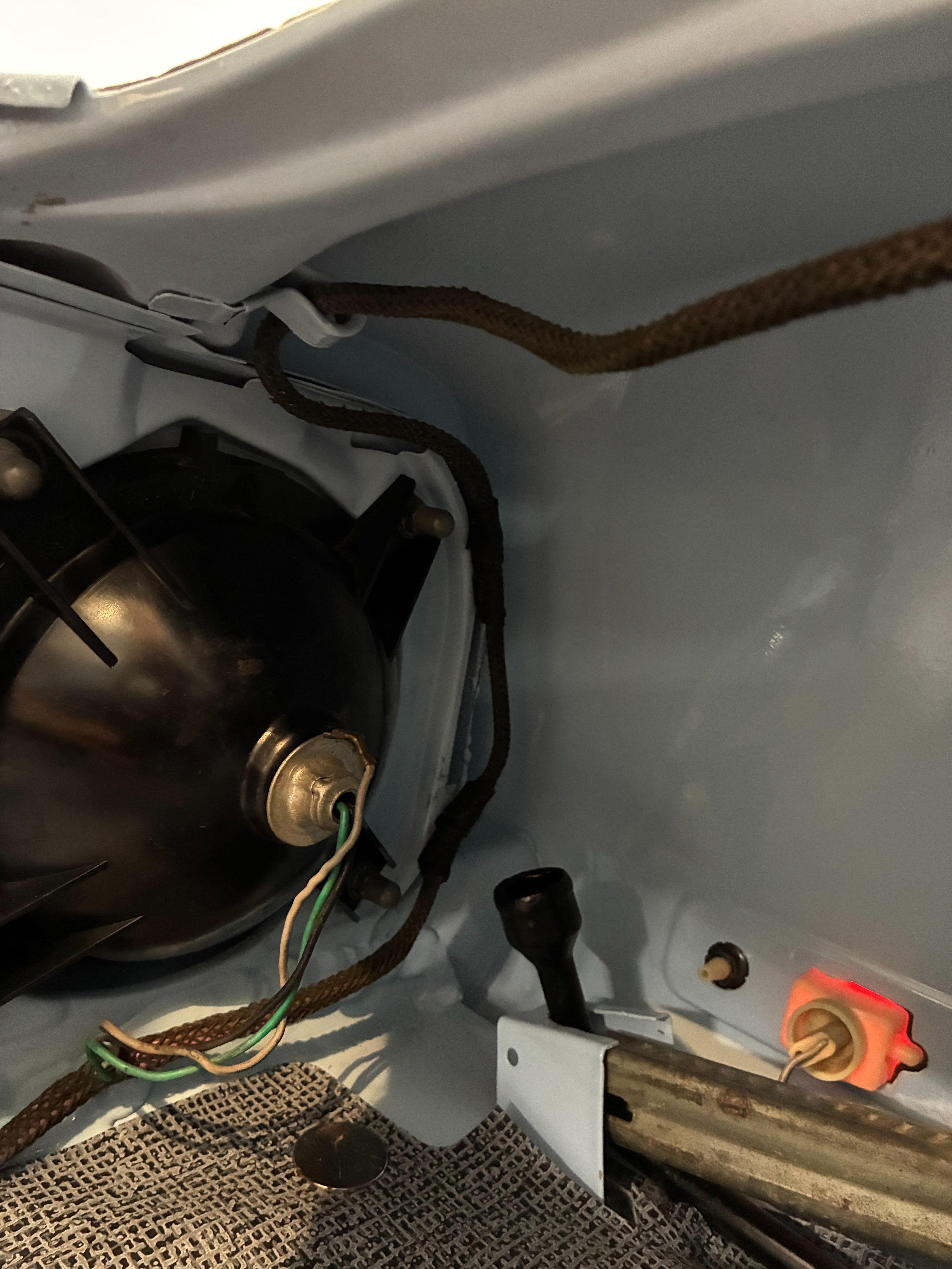

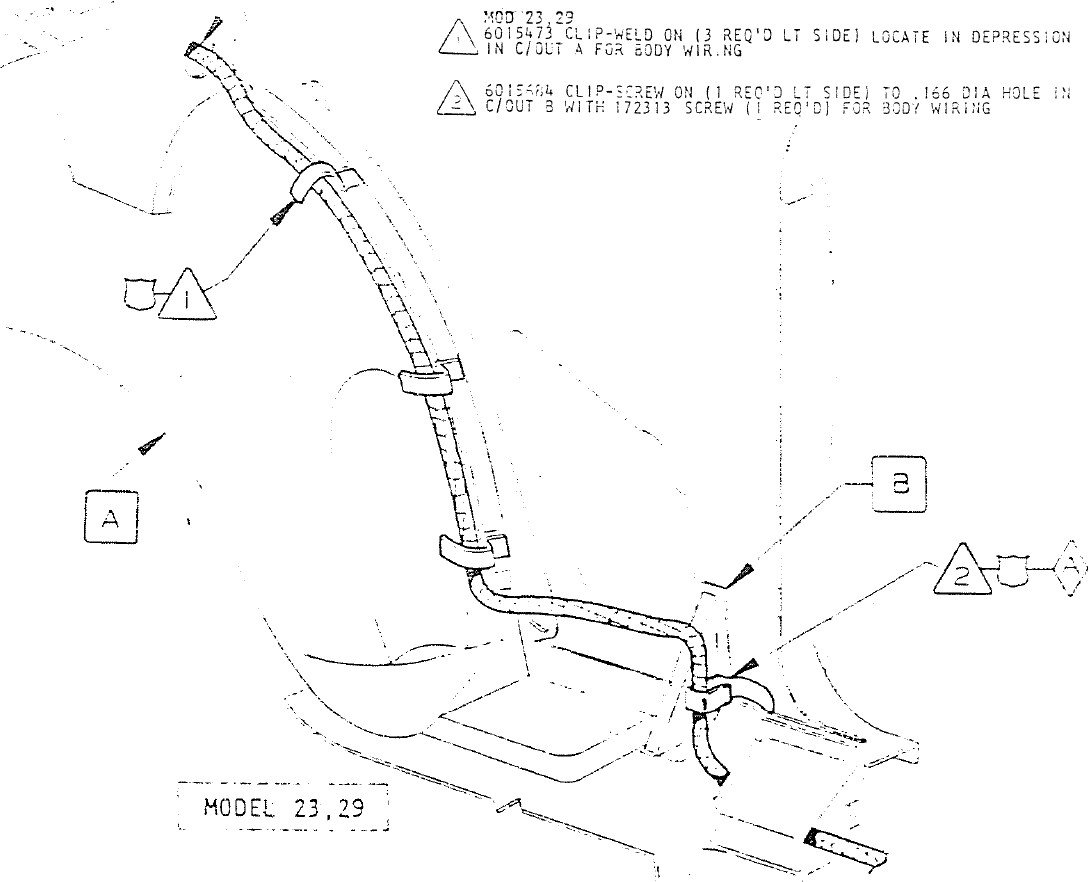

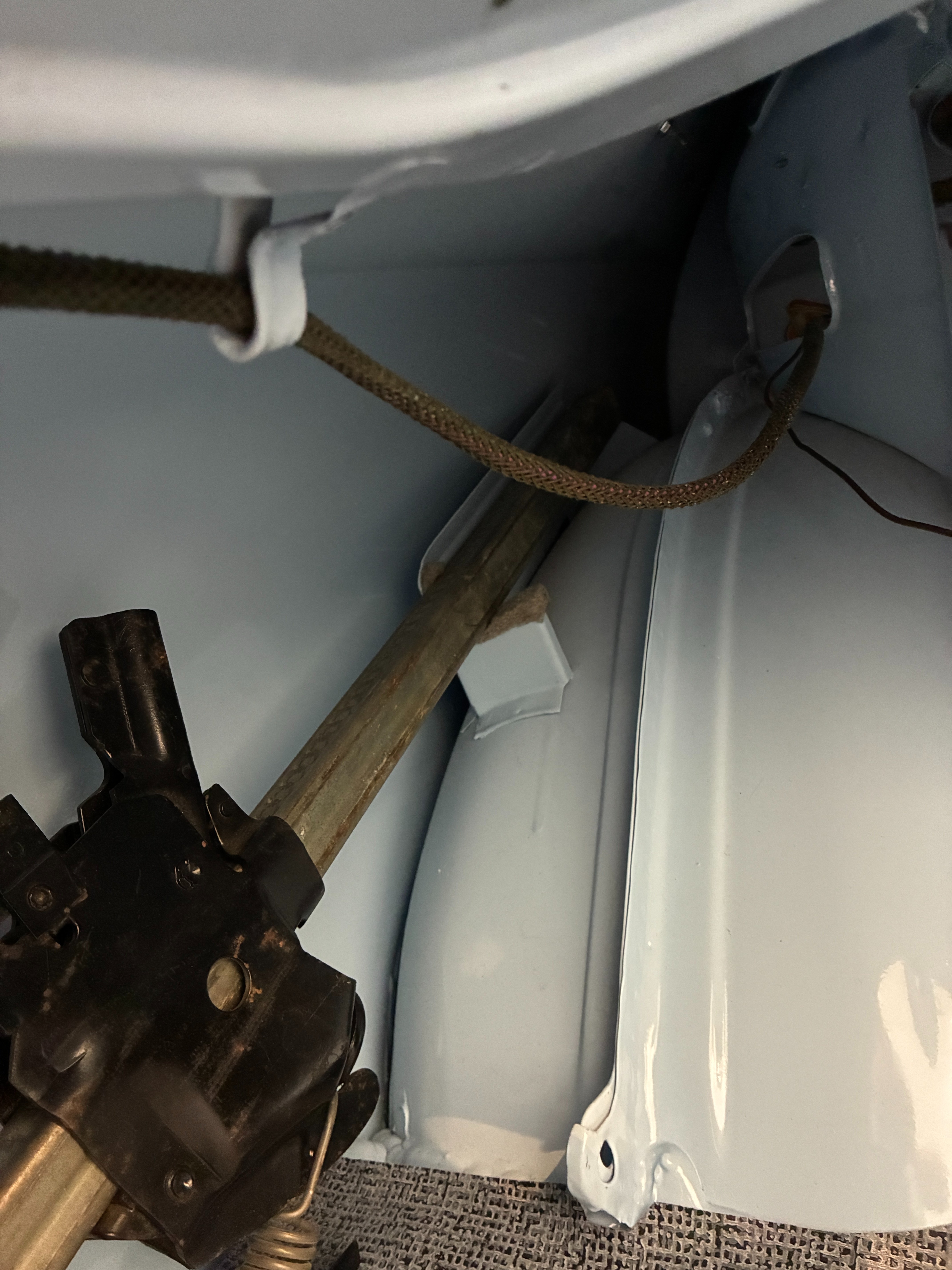

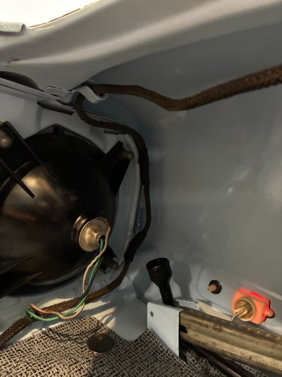

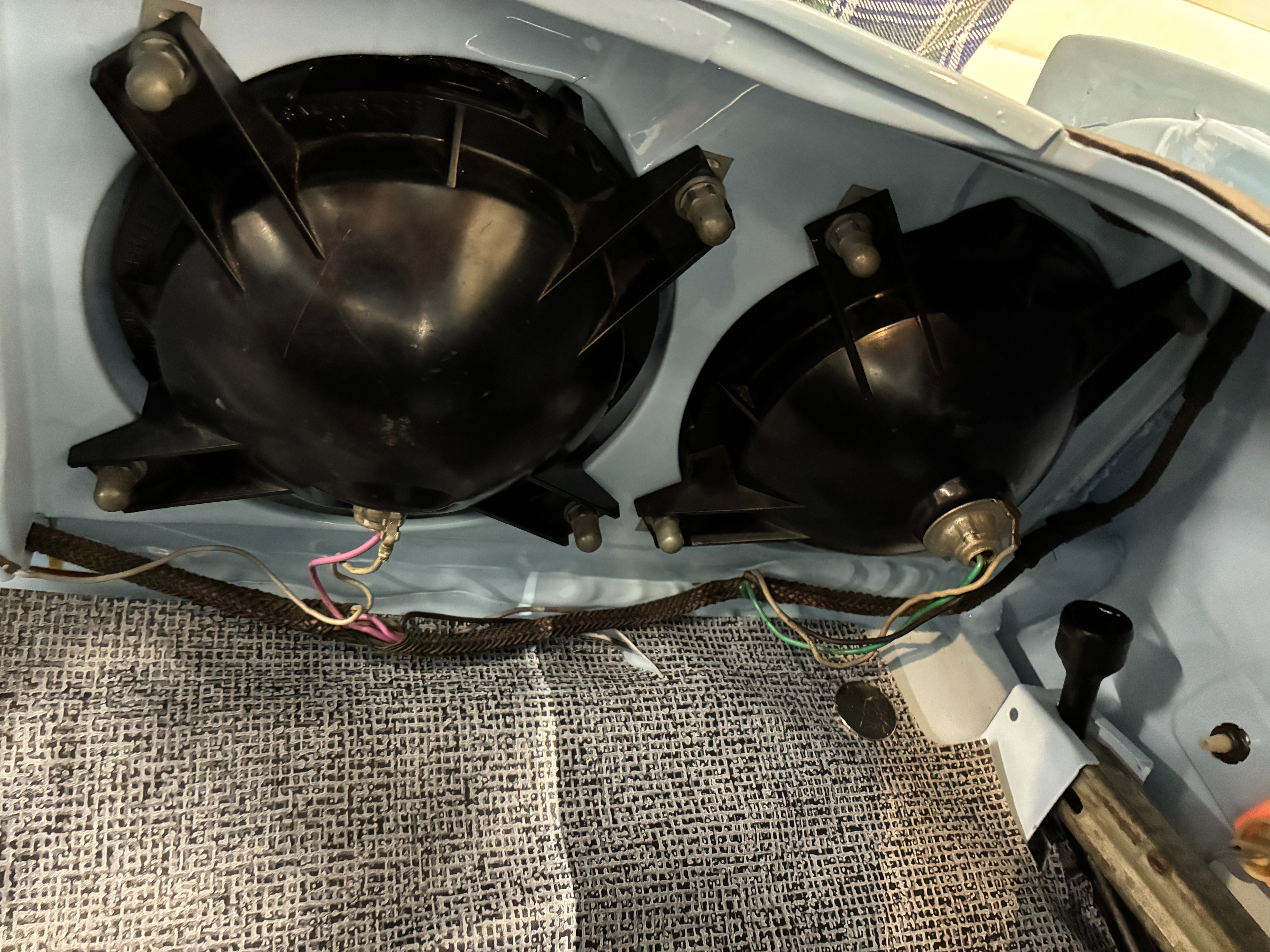

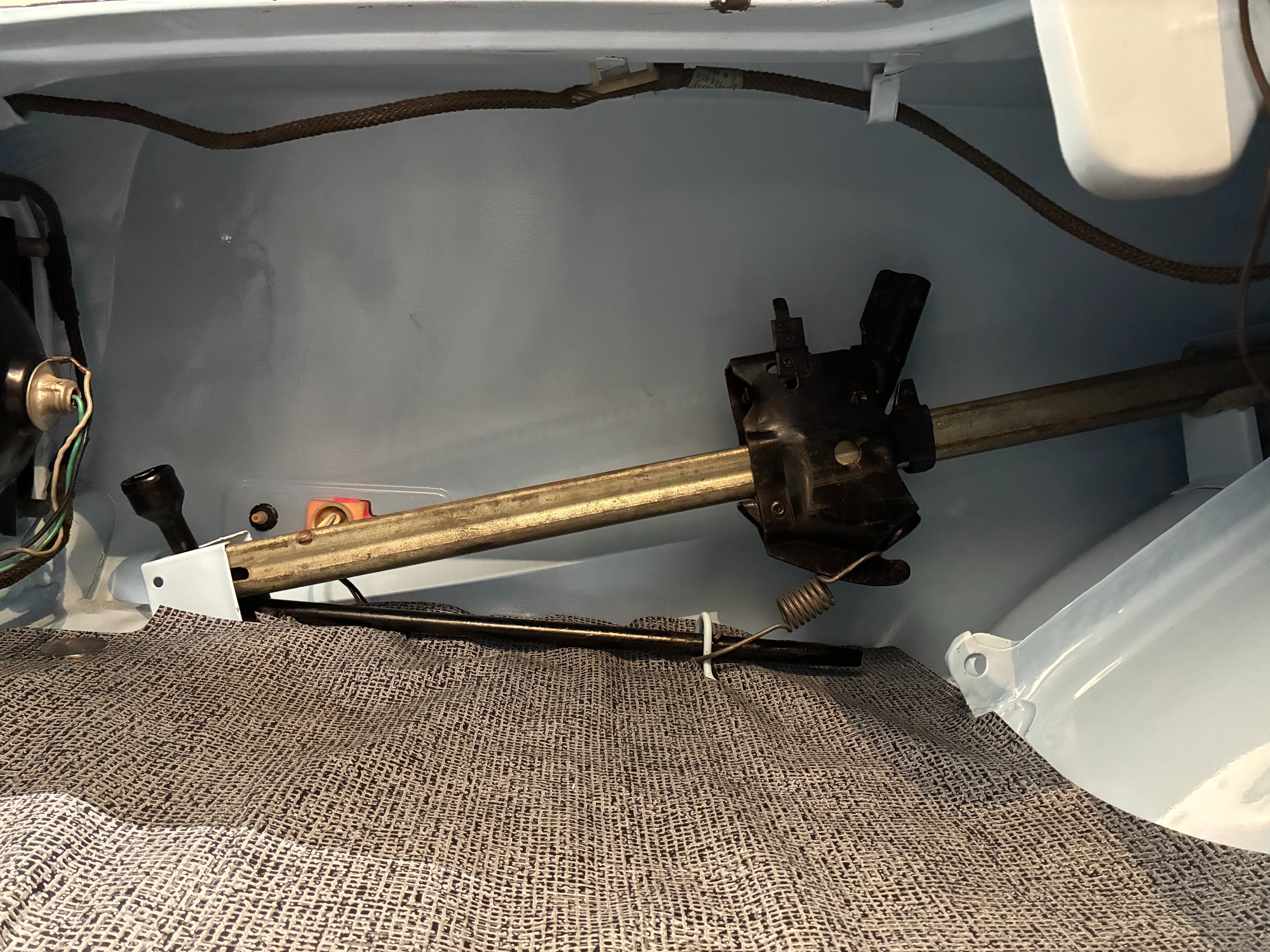

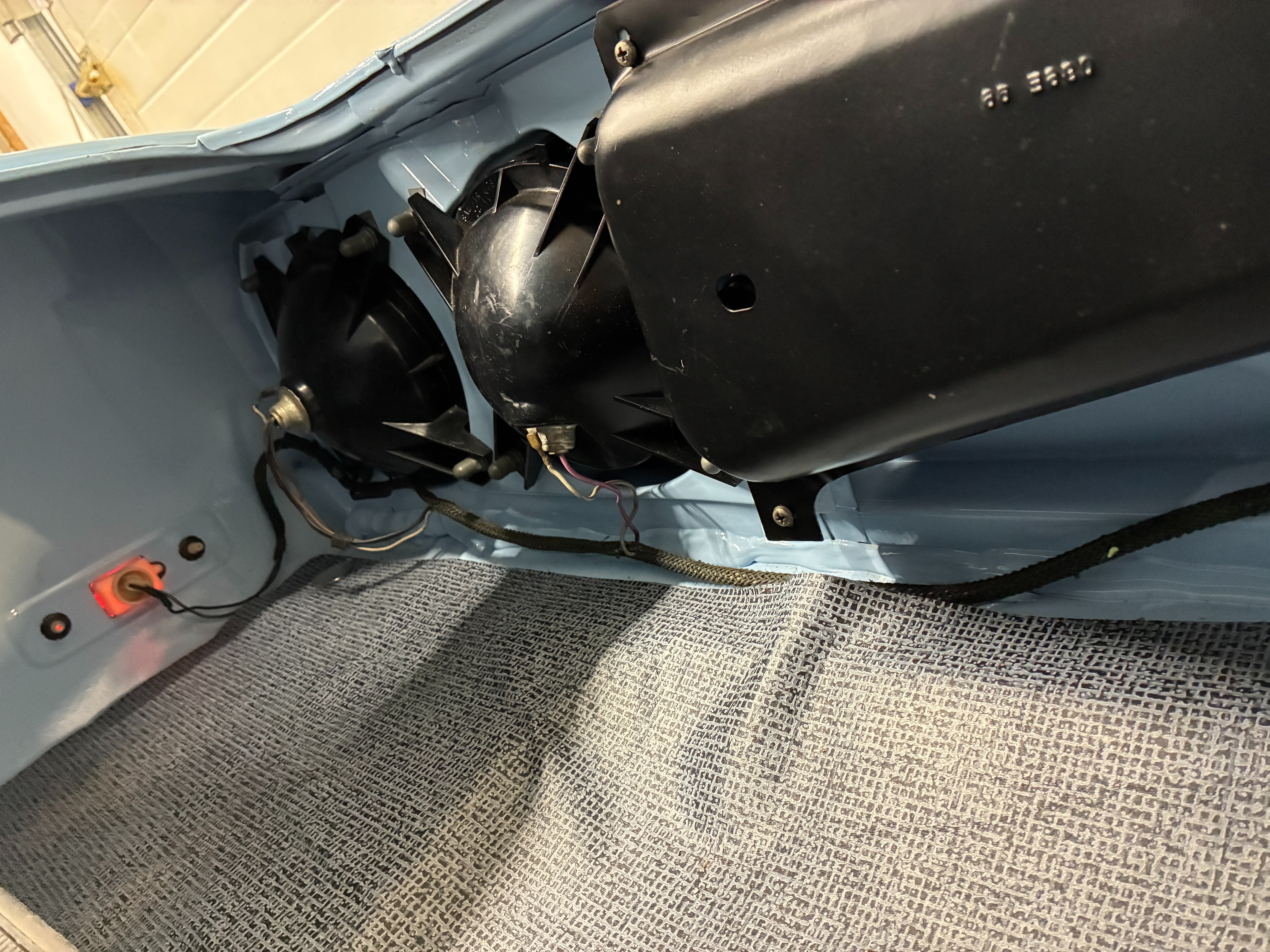

Is there a diagram or any pictures that shows the routing of the rear wiring harness after you plug it in UP front?And it runs down and up into the trunk... After it enters the trunk , which way does it go.. I know it seems obvious, but LOL.. Were there originally metal bendy strips that held the wire up?Or did it run down along the trunk pan over to the lights , or? Thanks.
The wiring runs along the driver side rocker panel behind the flexible wire guards that are under the carpet. Then up and over the driver side wheel well and along the driver side quarter panel then across the tail light panel. If you have rear speakers and/or rear defroster that will connect right around where the package tray meets the wheel well. Your fuel sending unit plug will be at the top of the wheel well also. I hope the phots help.
