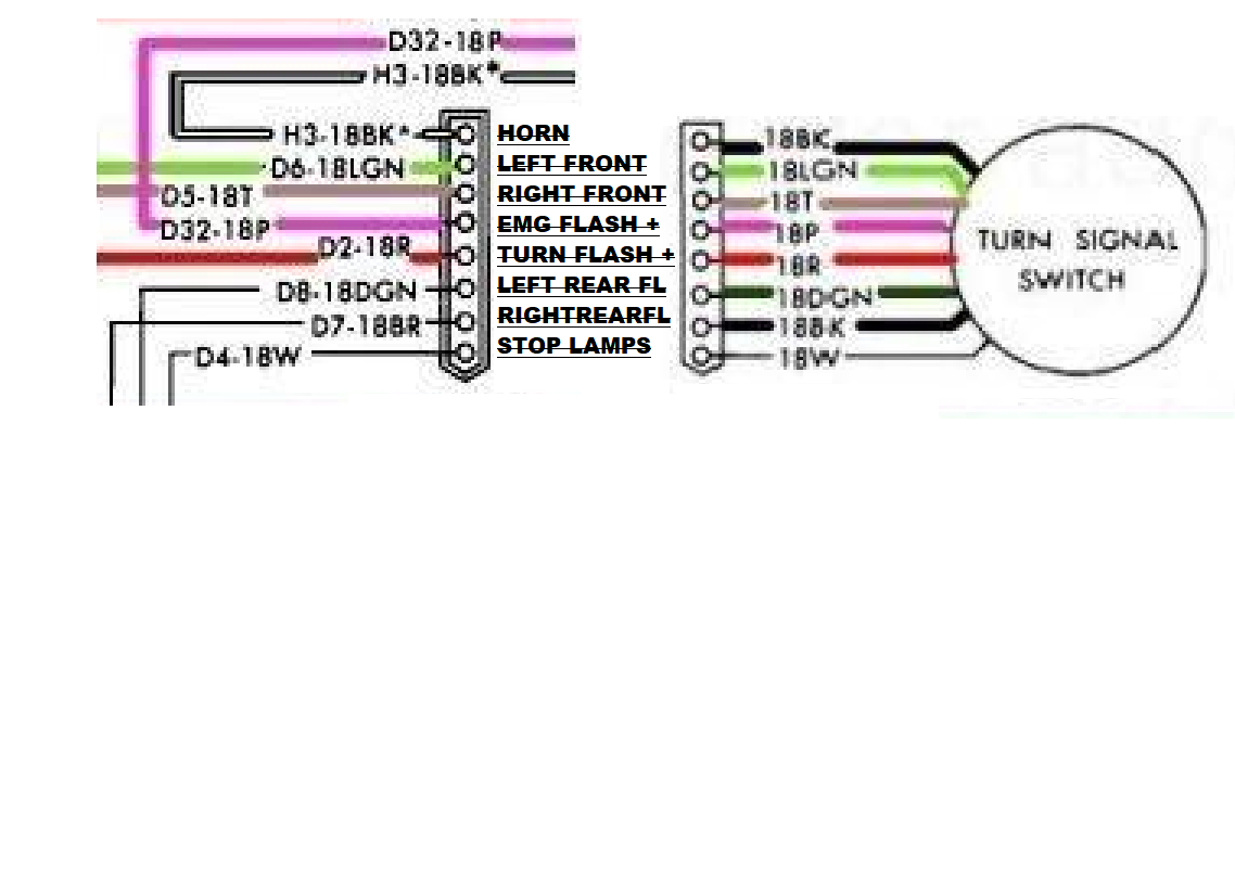

MOPAR turn signal Switch colors---------- After market Switch colors-------------AAW wire colors
Stop lamps-------------White -----------------White------------------------------------White
L F turn signal --------LT Green--------------GREEN ----------------------------------Light blue
R F turn signal -------Tan---------------------Yellow/ Blk Stripe ------------------Dark Blue
Emg Flasher ----------Pink-------------------RED --------------------------------------Brown
Turn signal Flasher--Red---------------------BLUE ------------------------------------Purple
L R turn signal-------Dark Green----------- Lt Green --------------------------------Yellow
R R turn signal-------Brown-----------------Yellow -----------------------------------Dark Green
Horn relay------------Black-------------------Grn/w-----------------------------------Black
AAW wiring. So you needed to cut the plug from the switch? This is what the colors would be on a new turn signal switch. The AAW wiring colors. Figure F. The Mopar wiring colors. My opinion: If you have the the car side of the turn signal sw plug. I would cut it with enough wire to remove the insulation. Then soldier the AAW wires to the plug wires and have shrink tube on before soldiering. Or get one. That way you retain ease of replacement and or trouble shooting. They are low current.
BEAWARE After market switch colors may vary. Pay no attention to the color chart in the picture. I have no idea what it is referring to.

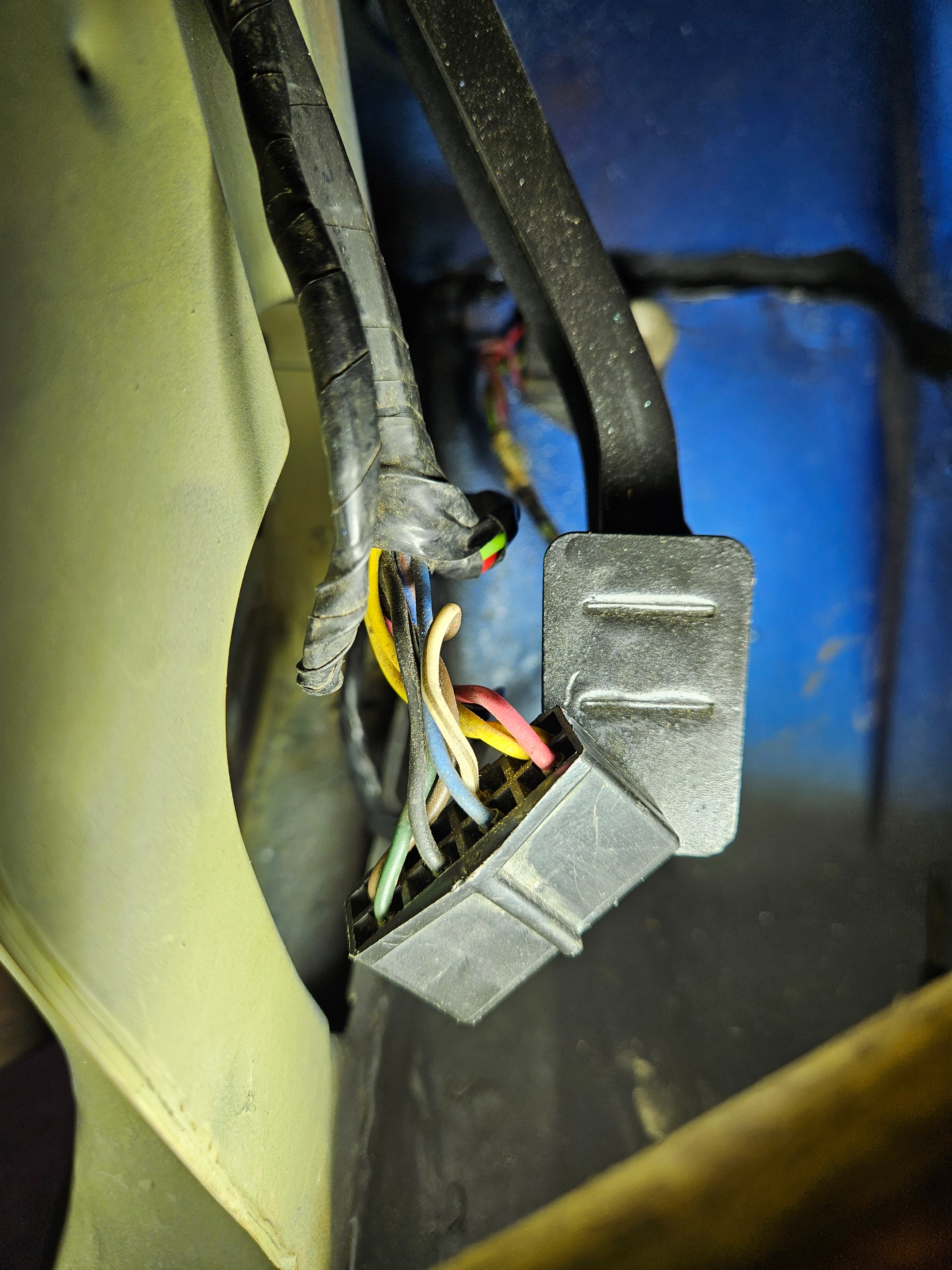

LOLI have a new issue.Wish I was good at reading schematics.. the park lights work. The turn signals work, but for some reason when I push on the brake.I have a passenger side brake light.No driver side brake light, but I do have a light on the driver's side.For the turn signal comes on with the brake light.It's got to be a wire

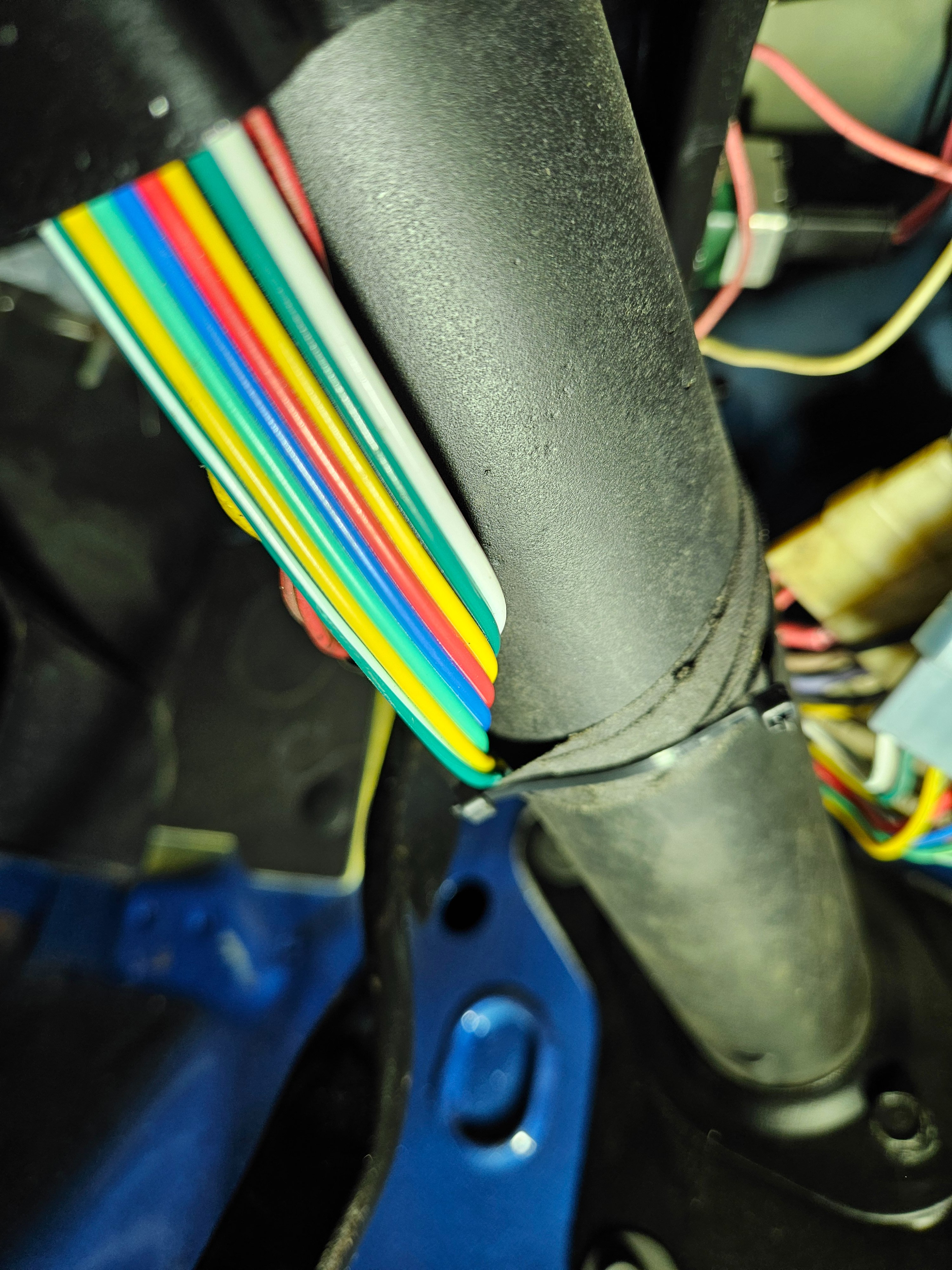

This is the switch that I used... One picture shows the current color of the wires... The other picture shows that I just swapped the yellow wire.. I thought I had it until I tried the brake lights passenger side.Brake light works driver side front turn signal light comes on with the break pushed.\nNo driver side brake light.
Can anyone tell me how my wiring should go? As far as the plug with what I have in the pictures, thanks\n Sorry for the confusion. I'm just not that good at figuring things out like that. I thought I had it LOL
If one brake light works the other one should too. Bad bulb, socket, wire or ground. The cheap bulb will go in wrong.
If one brake light works the other one should too. Bad bulb, socket, wire or ground. The cheap bulb will go in wrong.View attachment 153798
I was thinking the same thing I swapped the bulb with a new one. Still the same thing, the parking lights work. Both sides, the turn signals work both sides. When I push on the brake, the passenger side works driver side does not But Driver side front turn signal lights up when the break is pushed.

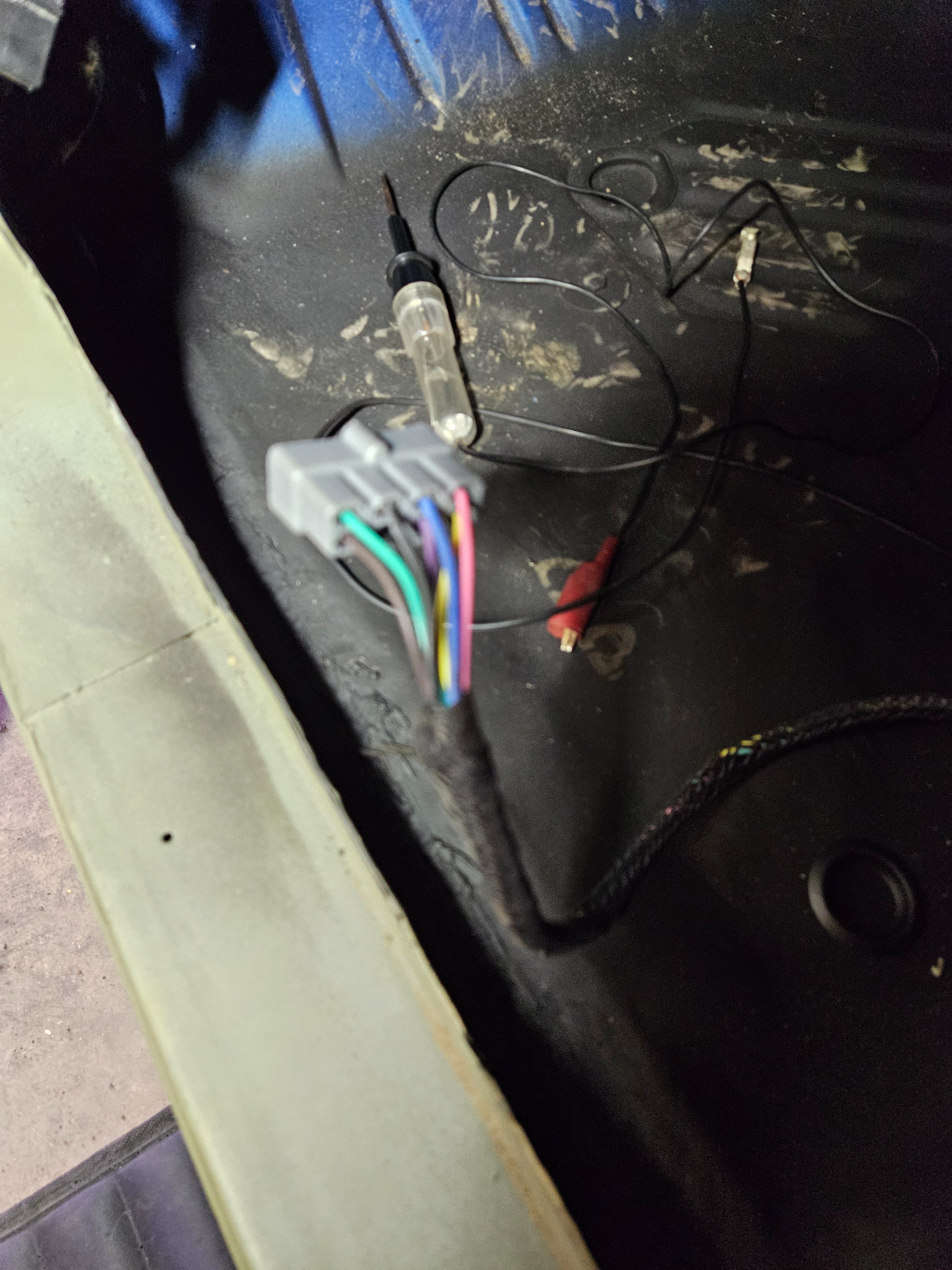

Behind the drives kick panel. Unplug the rear harness. That will narrow it down where it's at. At the front plug use a test light to ground. One at a time. Test for power for the brake light. Do left and right turn signals and parking lights.
Black, Dark Green and Brown.
Then take power from the bottom of the fuse panel Batt connection. Fused jumper would be a bad idea. It should be ok. Apply power to each wire brake, park. The blue wire is the sending unit need not be done.
Keep in mind the socket need a ground.
Then take power from the bottom of the fuse panel Batt connection. Fused would be a bad idea. It should be ok. Apply power to each wire brake, park. The blue wire is the sending unit need not be done.
I will try that. I just ran that rear new harness. A couple of days ago... I also installed the new turn signal, switch on Friday.Had to swap the 2 yellow wires on the current switch.I am using.\nYeah , the turn signals working didn't check the brake lights until today.... Also have new wiring harness going to the front as well... Like I said , everything works exactly like it should except for the driver's side , brake light is out in the back and brings on the front turn signal light crazy....lol
Ok take the plug apart and test. I think someone here had a problem with a new rear harness and it was doing the same thing.

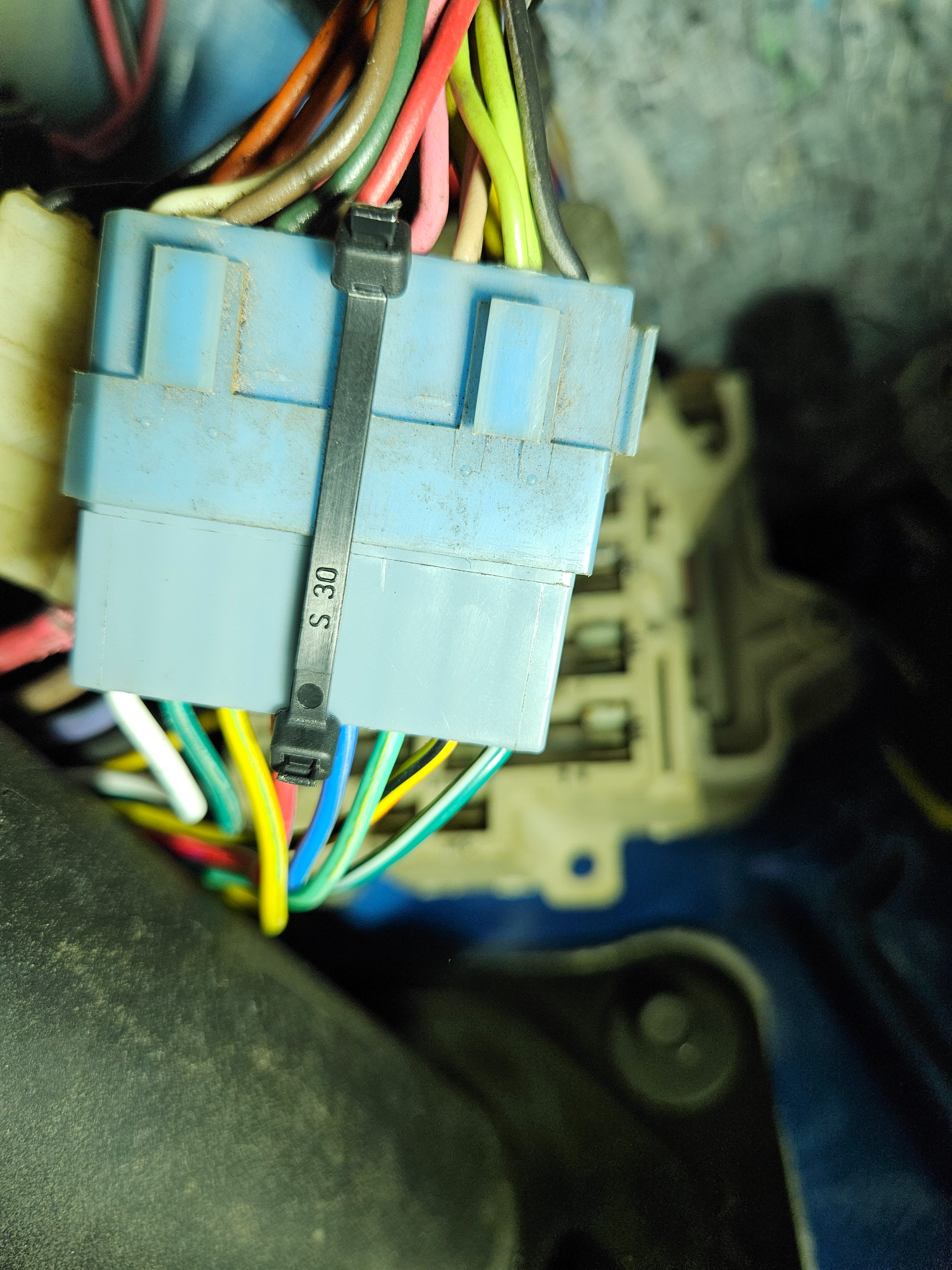

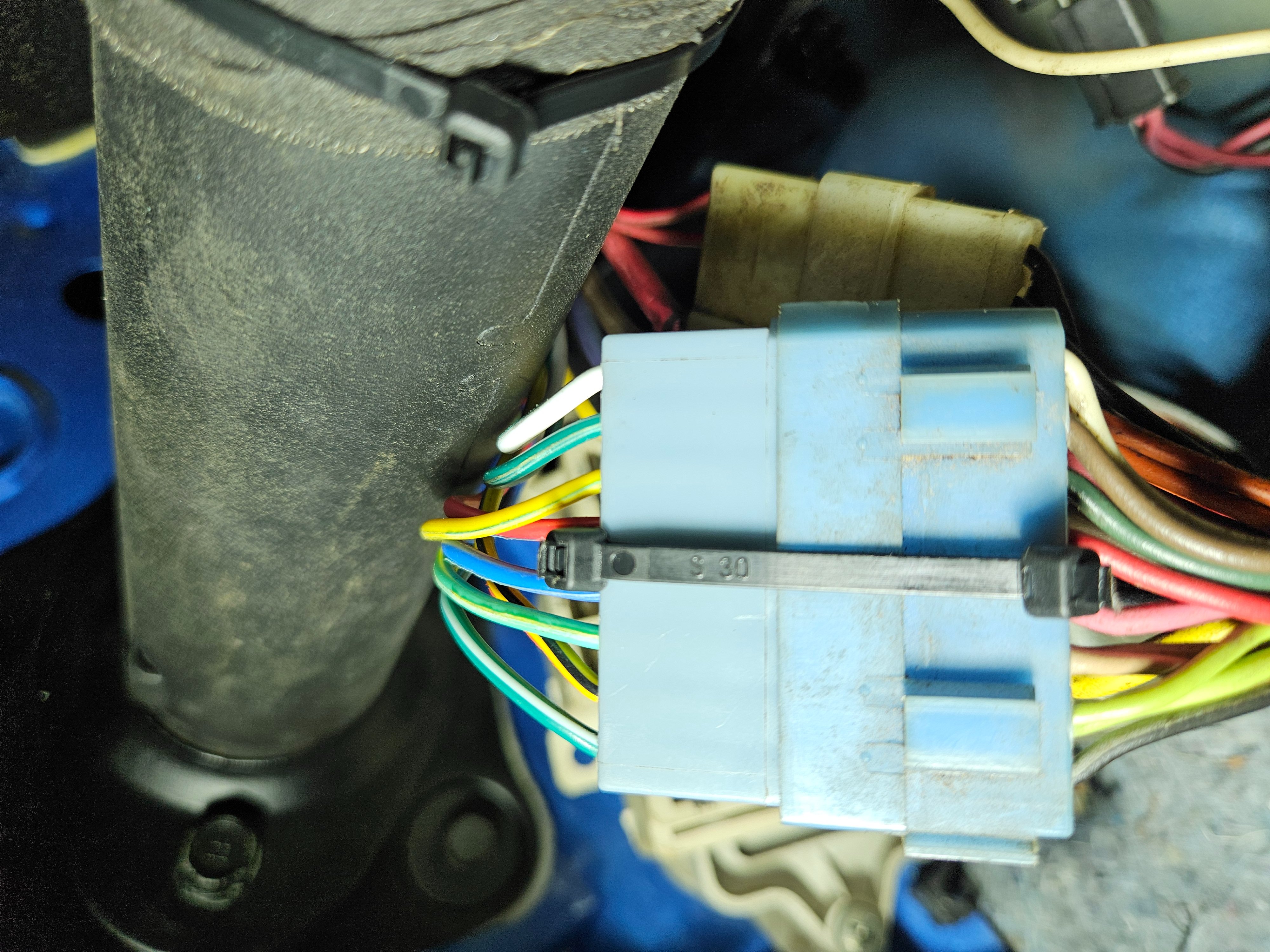

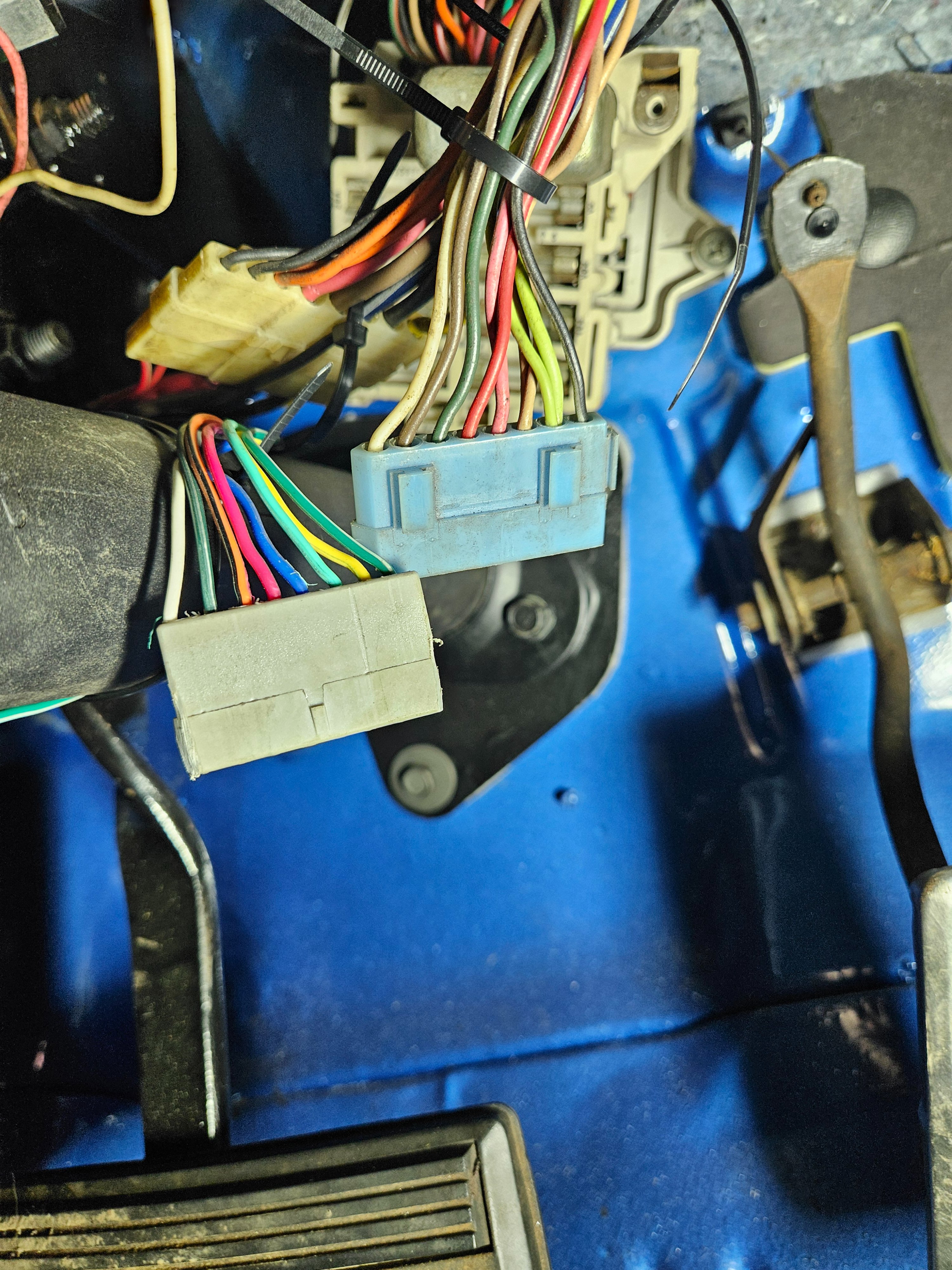

Seems that the Weir harness going to the back is correct.All the checks that I did so they correspond with the wires and the slots on the plug.. this is the picture of the plug from the rally dash.. And the plug from the lion harness to the back. I'm just wondering why out of all these years that someone has not corrected the turn signal switch wiring wire for wire where it should be with the new switches. I'm not very smart with wiring diagrams, but I'm sure I can't be the only 1 LOL.
When I get home tonight, I am going to try as you suggested. Looking at the turn signal, plug the original that you have a picture of and try to follow it wire for wire and not worrying about the color too much on the new switch, just the locations in the plug.. As you have already suggested me , they just gets a little confusing l o l
Did you use a test light to ground on the front plug? One at a time. Test for power for the brake light. Do left and right turn signals and parking lights. That would tell you which ones are not correct.
I will when I get home. I was trying to check it out before I went into work.L o l things get stuck on your mind sometimes.. There is not a separate break wire, correct..for right and left
Okay apologies need to be made.. After retracing my steps And deciding to swapt the two yellow wires that I originally changed back to the way it was originally out of the box.. Everything is now working brake lights, park lights, turn signals and no front turn signal.When you push on the brake. The oer switch i bought worked without no modifications out of the box. Thanks for everyone that I bug and try to help me figure this out. When I caused it all by myself. Lol less and learned. Sorry for any headaches I might have caused thanks again..
If you never do anything, even it it's wrong. You never learn nothing! I think understand the electrical a bit better now.
