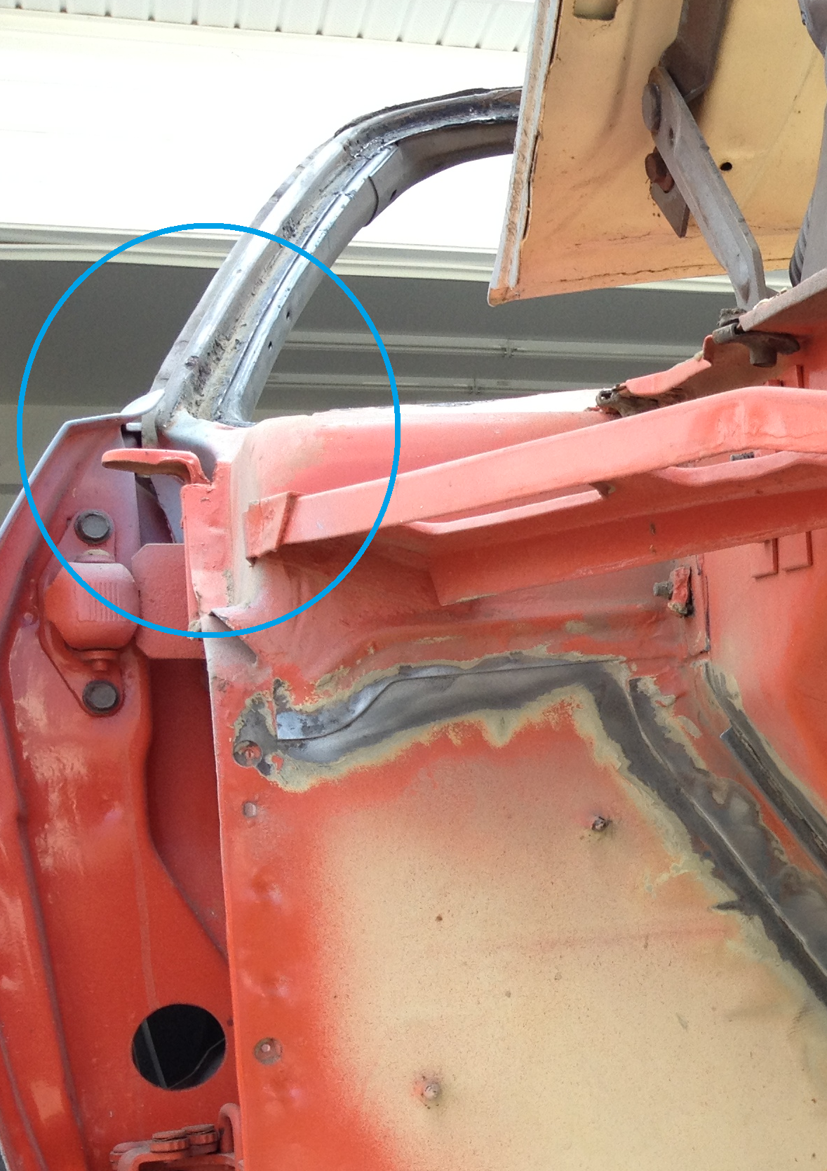

Does anyone know what these parts go to?Thanks in advace..

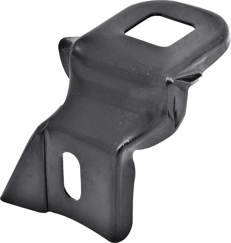

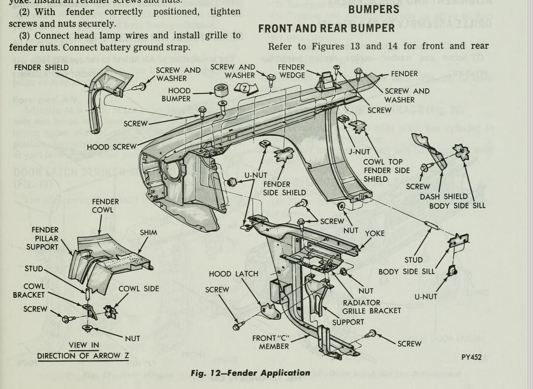

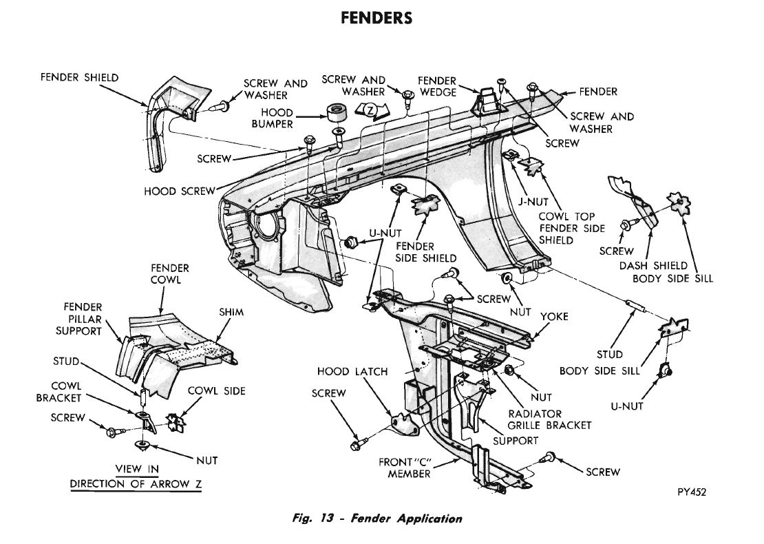

The two parts on the left and right look like a part sometimes referred to as the Front Fender to Cowl Brackets.
Refer to: MM1108A - 1970-74 Challanger, Barracuda, Cuda; Inner Front Fender To Cowl Bracket; RH Passenger Side; EDP Coated
The center bracket looks like a K-member support piece, that attaches centerline of car from the base of the radiator support to the front of the K-member (on which the engine mounts)
