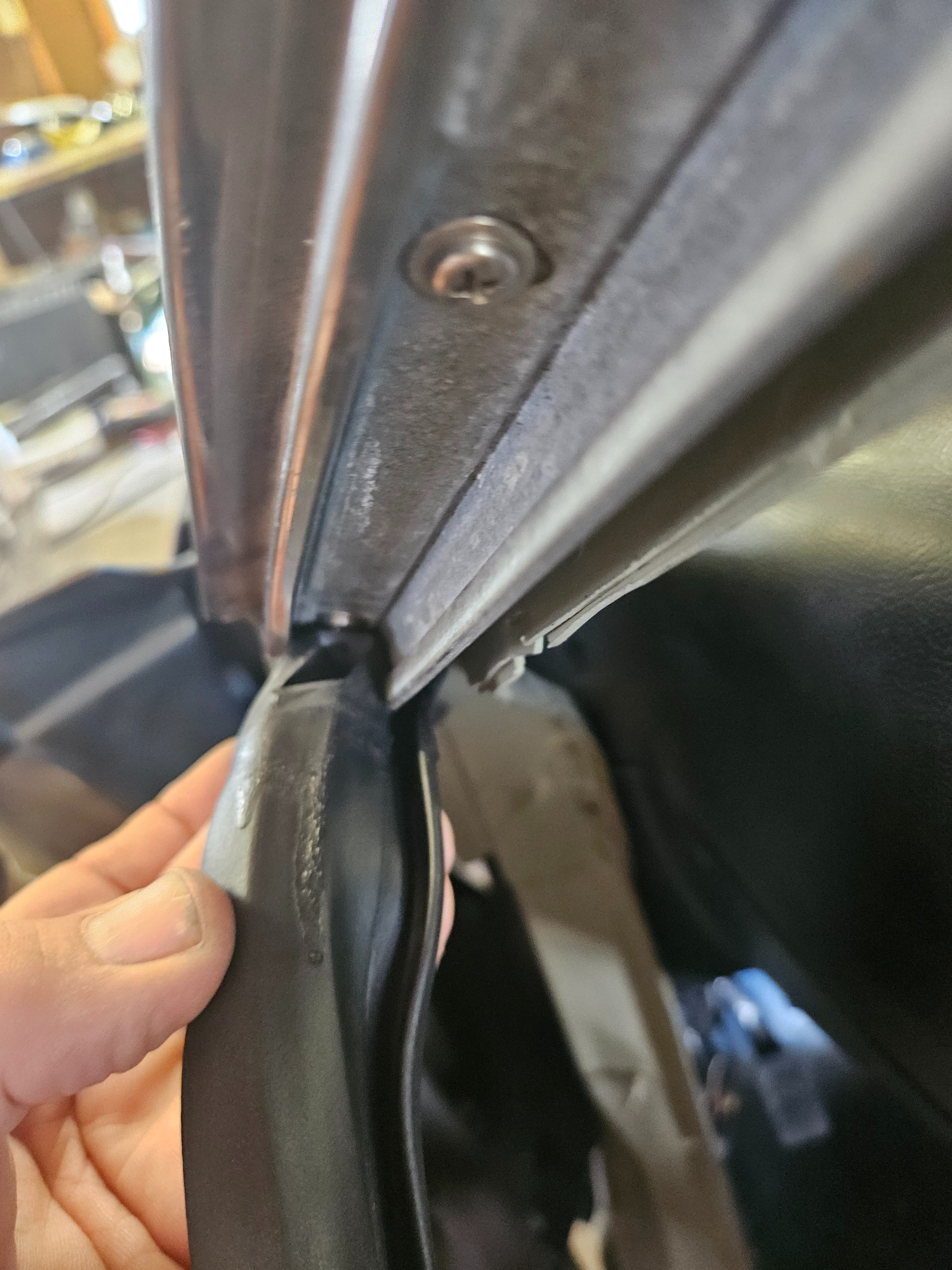

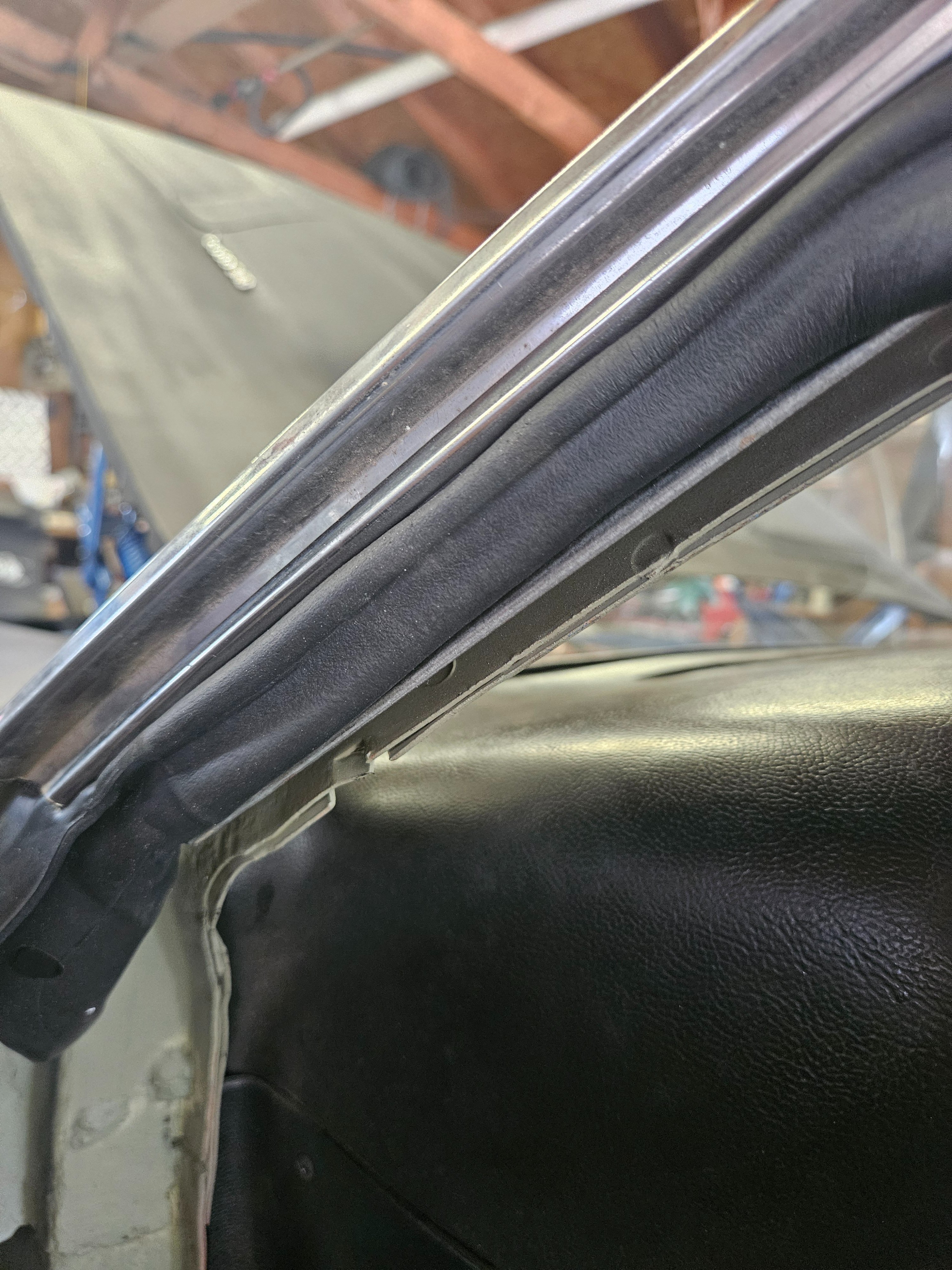

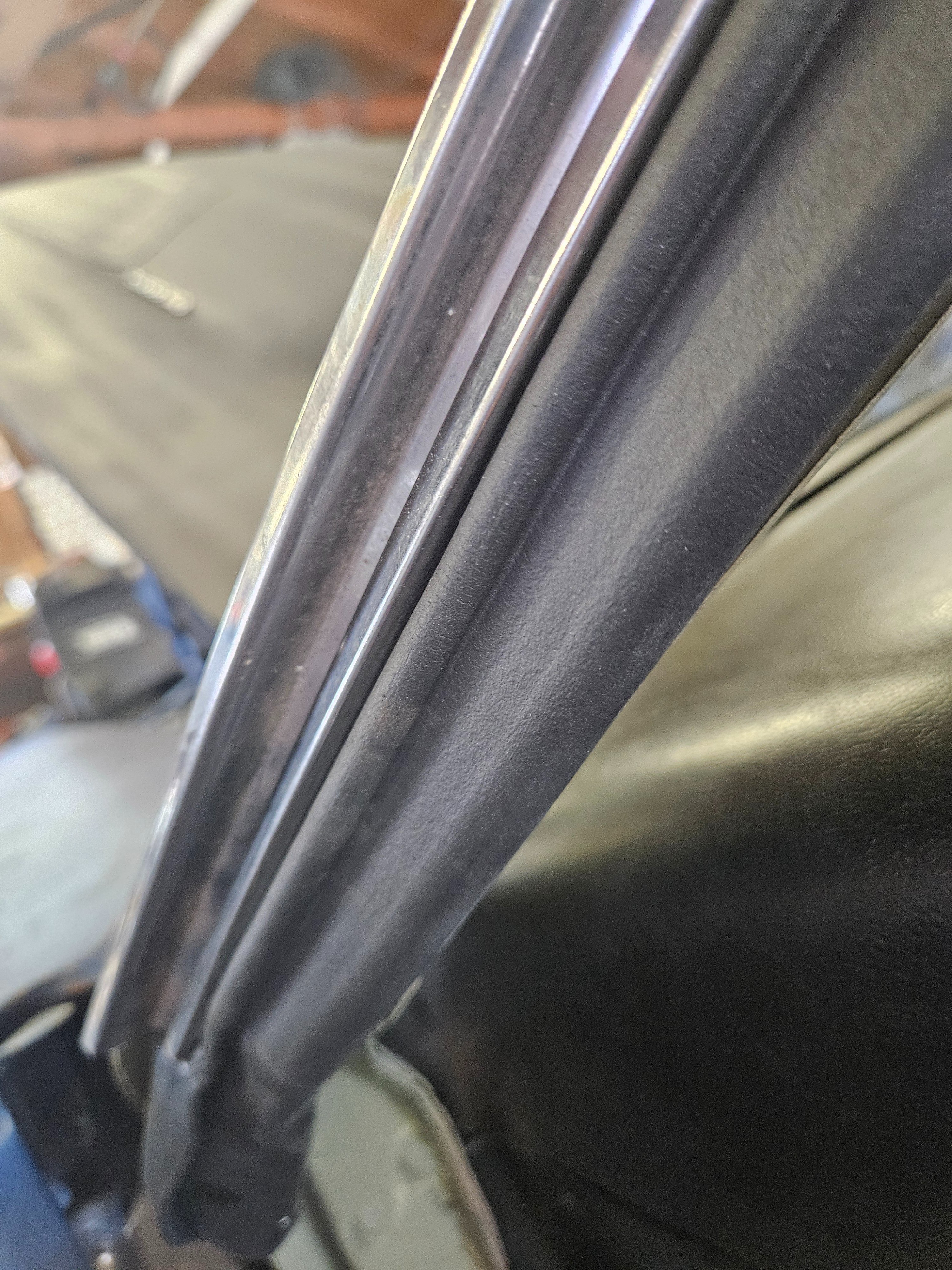

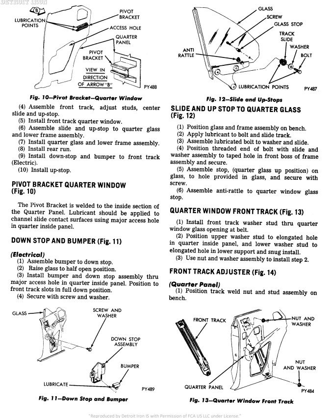

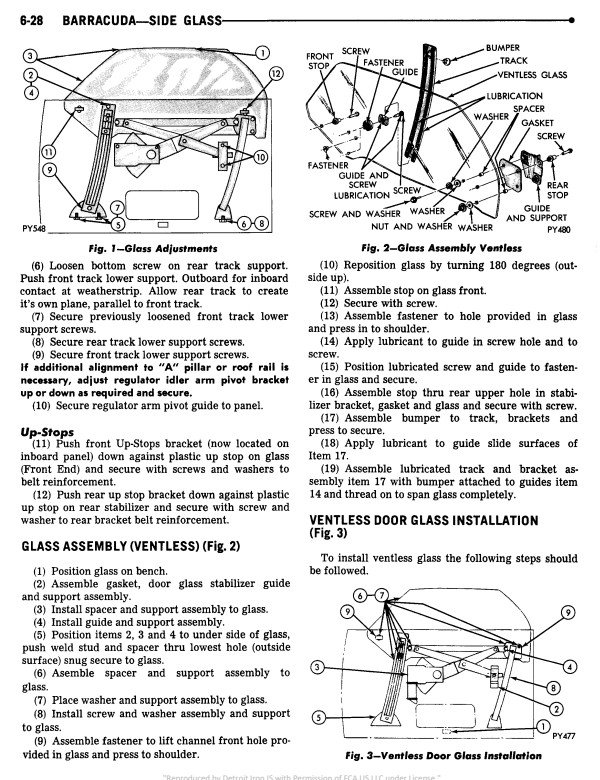

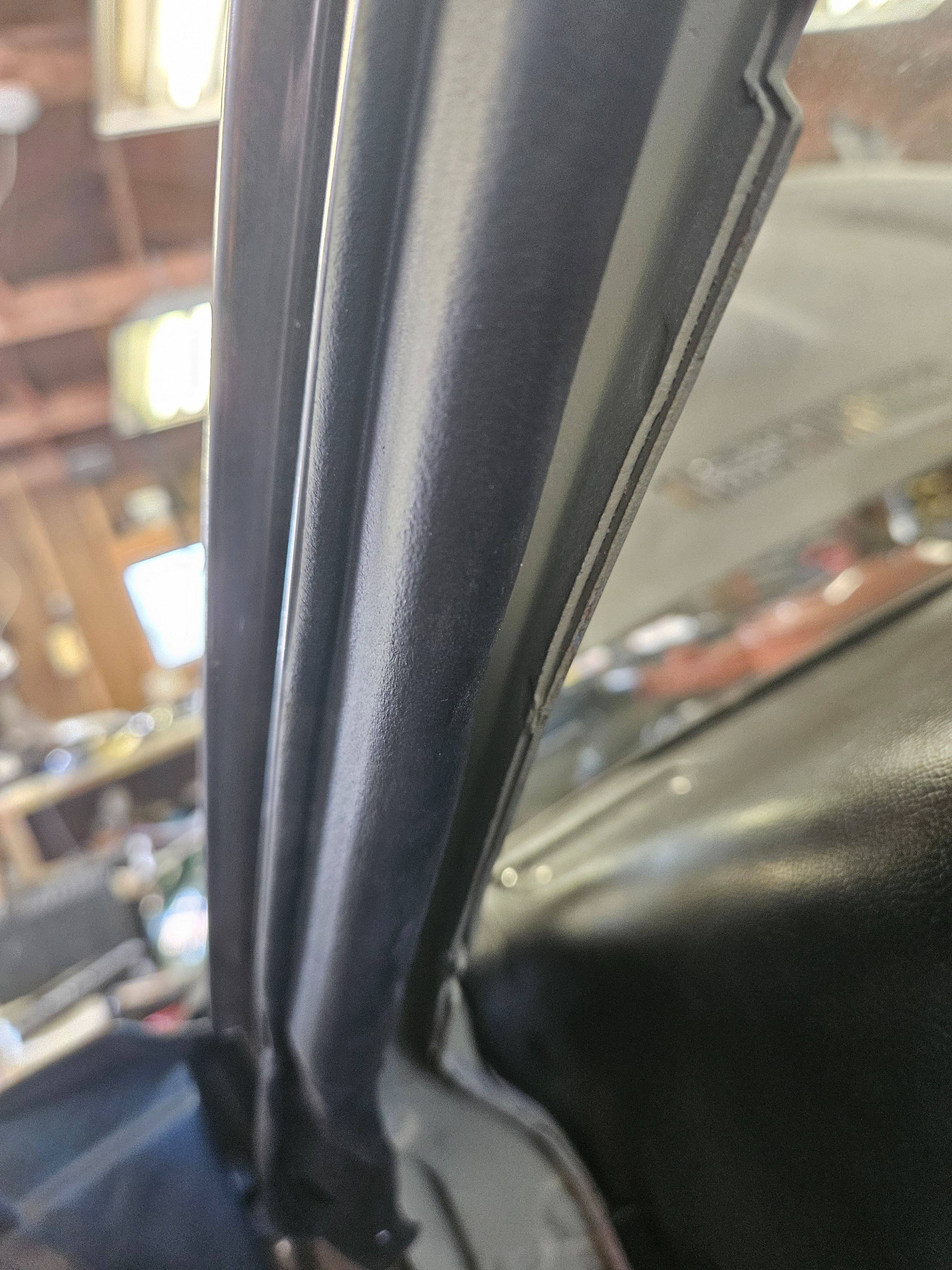

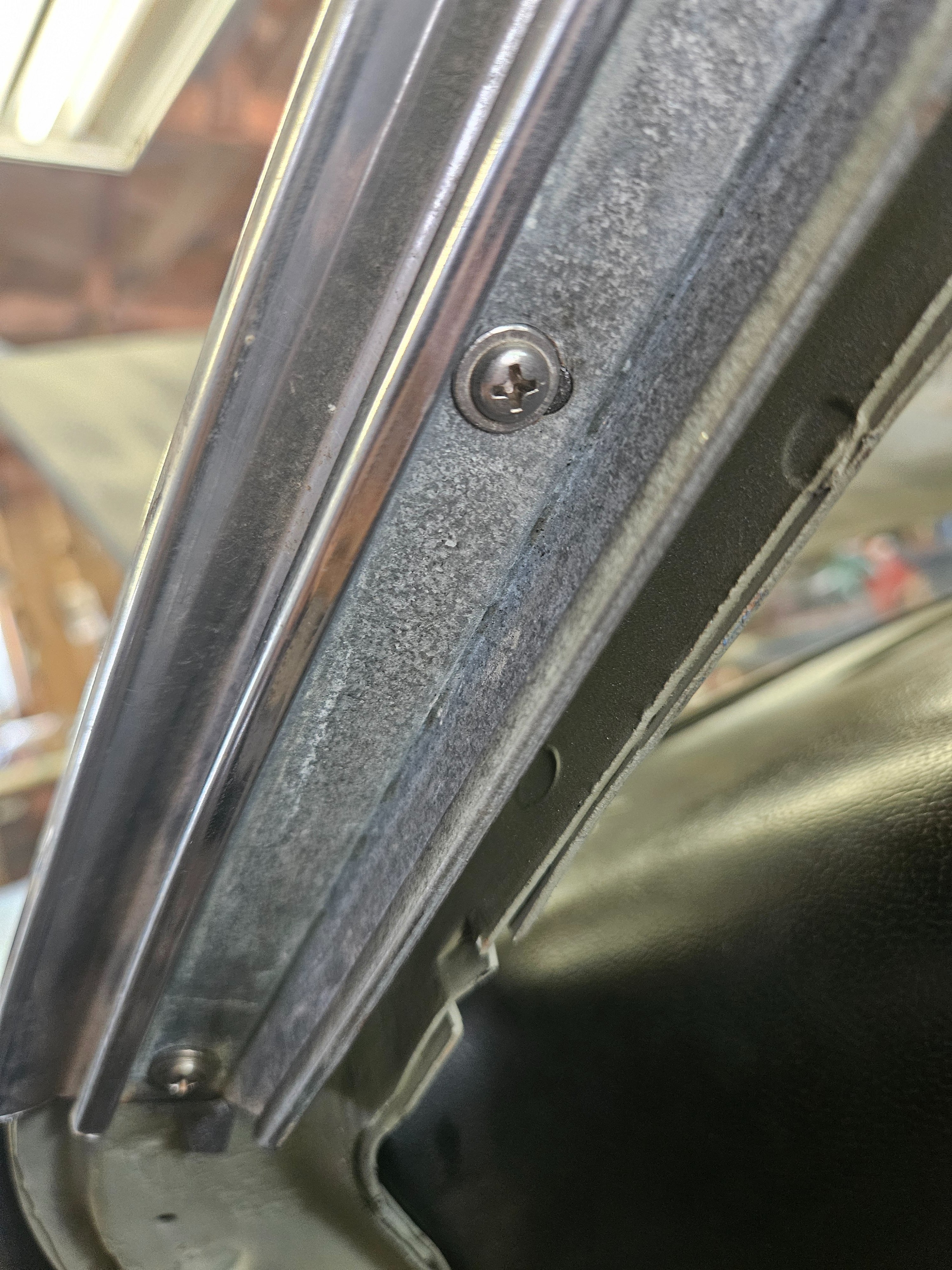

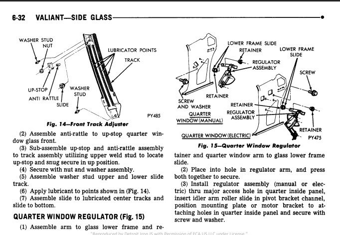

When adjusting the quarter glass.. Should the quarter glass be adjusted to meet right in the center of the drip rail channel when rooled all the way up ?. I am attempting to make adjustments before I put the rubber in the drip rail channel... I guess what I am asking if you didn't have the rubber weather stripping in where would the window be right , left or in the center of the channel.
