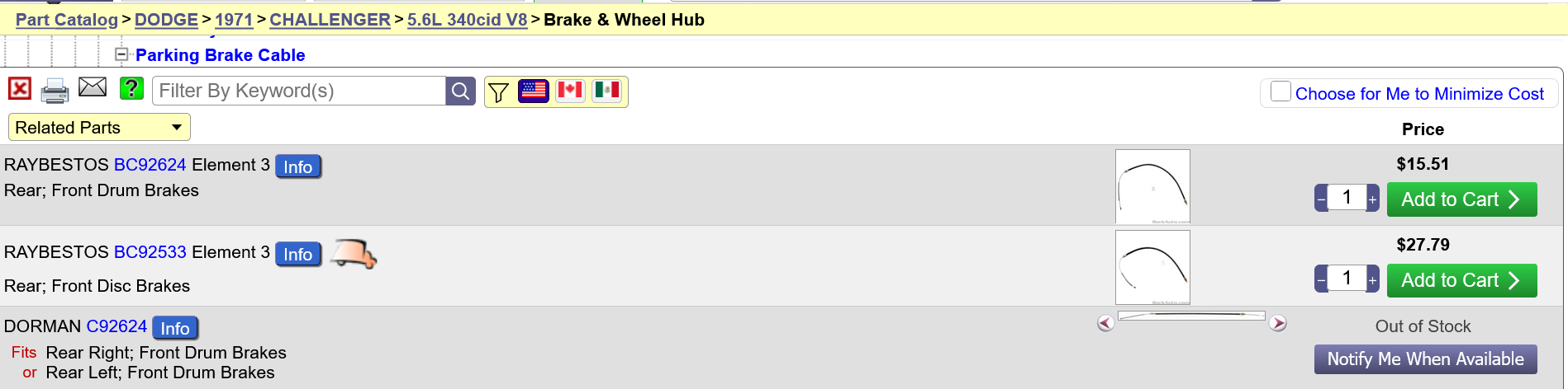

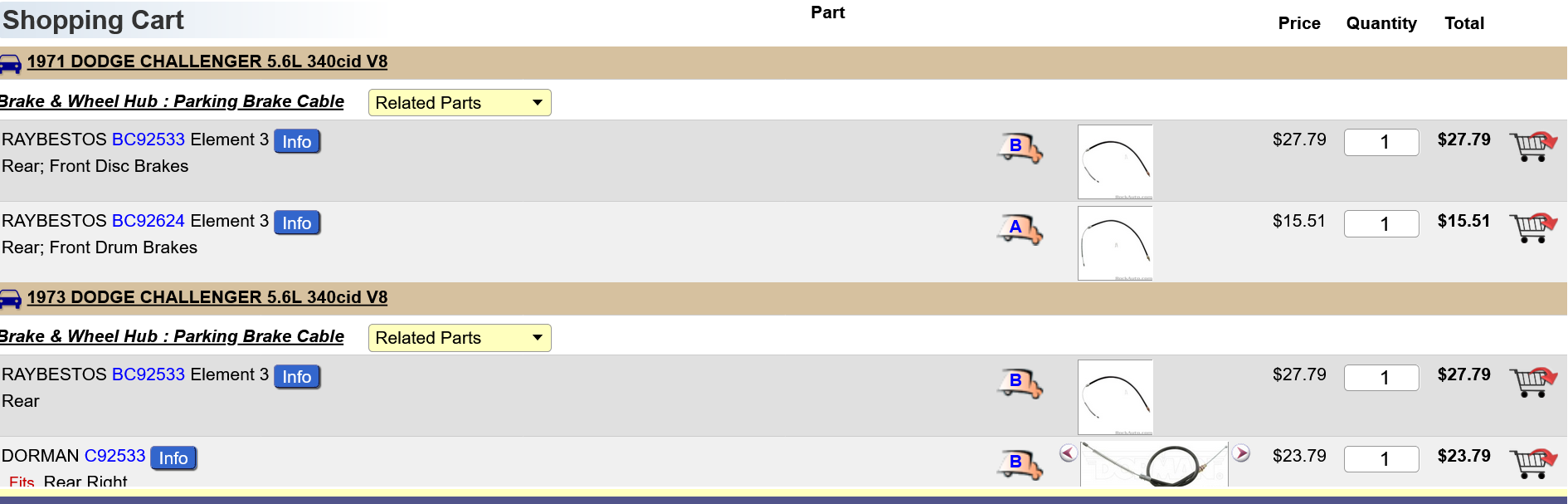

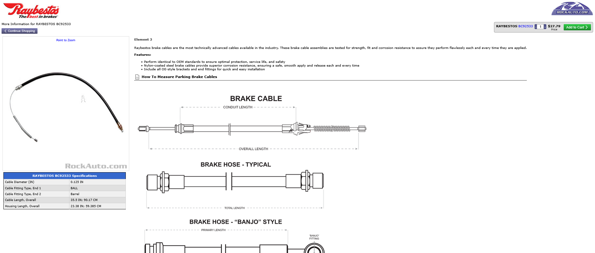

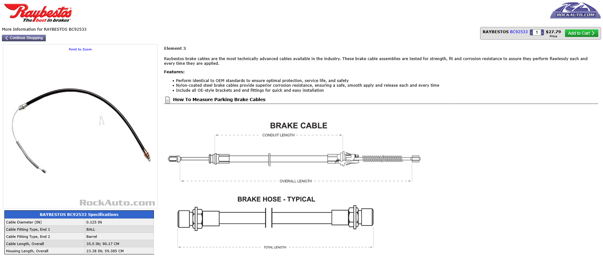

Today at 6:52 AM #2 Challenger RTA Well-Known Member Joined Oct 28, 2018 Messages 5,039 Reaction score 2,853 Location PA Flood city I came across this before. If I remember correctly. The back one are all the same. The front for 72 and up is shorter. That's where the difference comes in. The intermediate cable is longer. Others may have more info, Confirm or correct. From Rock auto. 73 challenger Rock auto 71 challenger Cart 71-73 Last edited: Today at 7:29 AM
Today at 7:10 AM #3 C Chryco Psycho Well-Known Member Joined Dec 28, 2008 Messages 5,059 Reaction score 2,706 Location Panama 3 piece set with intermediate cable
