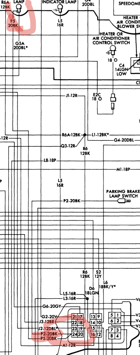

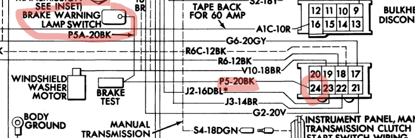

The wire to the brake warning lamp switch routes through the bulkhead disconnect via cavity 24. Inside the car, where the wire enters the cavity from the instrument cluster warning lamp, it joins with the wire to the parking brake switch. From cavity 24 under hood, the wire runs to the brake warning lamp switch.
The wiring connections are shown in the factory service manuals wiring diagrams. If you don't have the 1973 Doge service manual, a two volume set, are available at MyMopar.com via the following links. The linked are compressed PDF zip file.

The bulkhead disconnect is behind the fuse box, so behind it. The fuse box clips to the bulkhead. The other side is in the engine compartment where all the wiring there connects to go inside.
Following are a couple of quickly highlighted screenshots showing the bulkhead cavity 24, etc.
From the engine compartment diagram page, 8-128:
From the instrument cluster diagram page, 8-131 (or similar on 8-138):

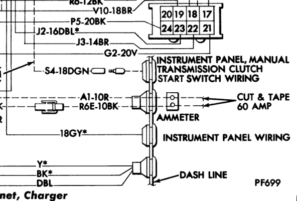

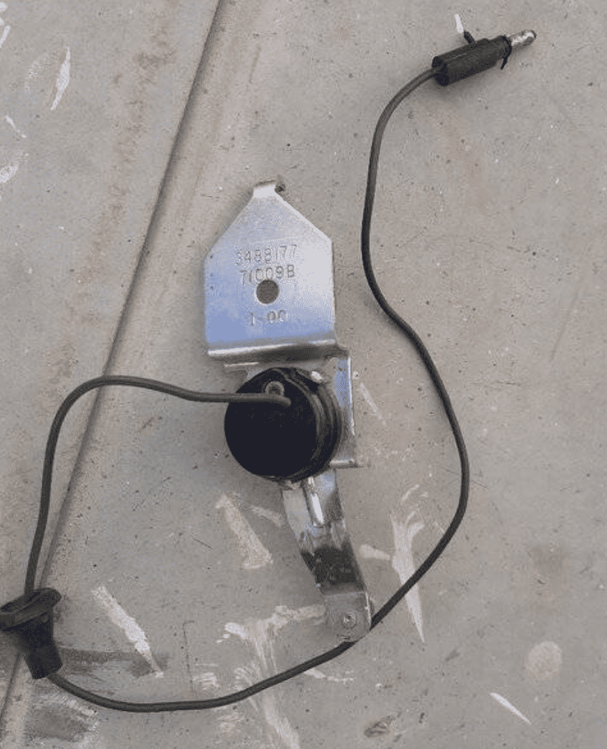

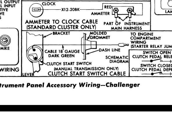

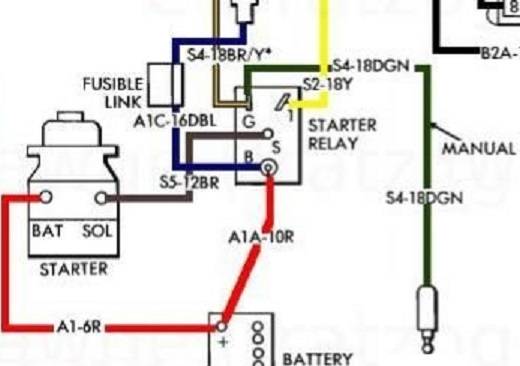

The switch at the clutch pedal is the clutch safety switch. It grounds the starter relay when the pedal is depressed to allow the starter relay to be engaged to crank the engine. The wire routes through a separate dedicated hole in the firewall. The wire is green and has a molded grommet on it to seal in the dedicated hole. From there, under hood, it runs along the inner fender apron and connects, with a bullet connector, to another green wire that continues to the starter relay and connects to the "G" (ground) terminal as shown in post #6.
Although you have the switch, the following image shows one with the correct molded grommet on the wire:

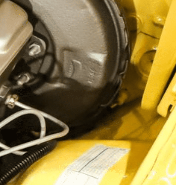

The firewall hole for the wire is in the corner of the firewall and fender apron, below the grommet for a manual windshield washer hoses, or a Caplug if not so equipped. The following image shows where it comes through the firewall. In this case, the wire and grommet has been painted with the engine compartment:
If your car was not an original manual transmission car, the hole will not be open from the factory. And if it has not been drilled open by whomever installed the manual setup, there will be a small dimple there showing where to drill for it.
Following are two more images showing the wiring inside and at the firewall to supplement post #6:
