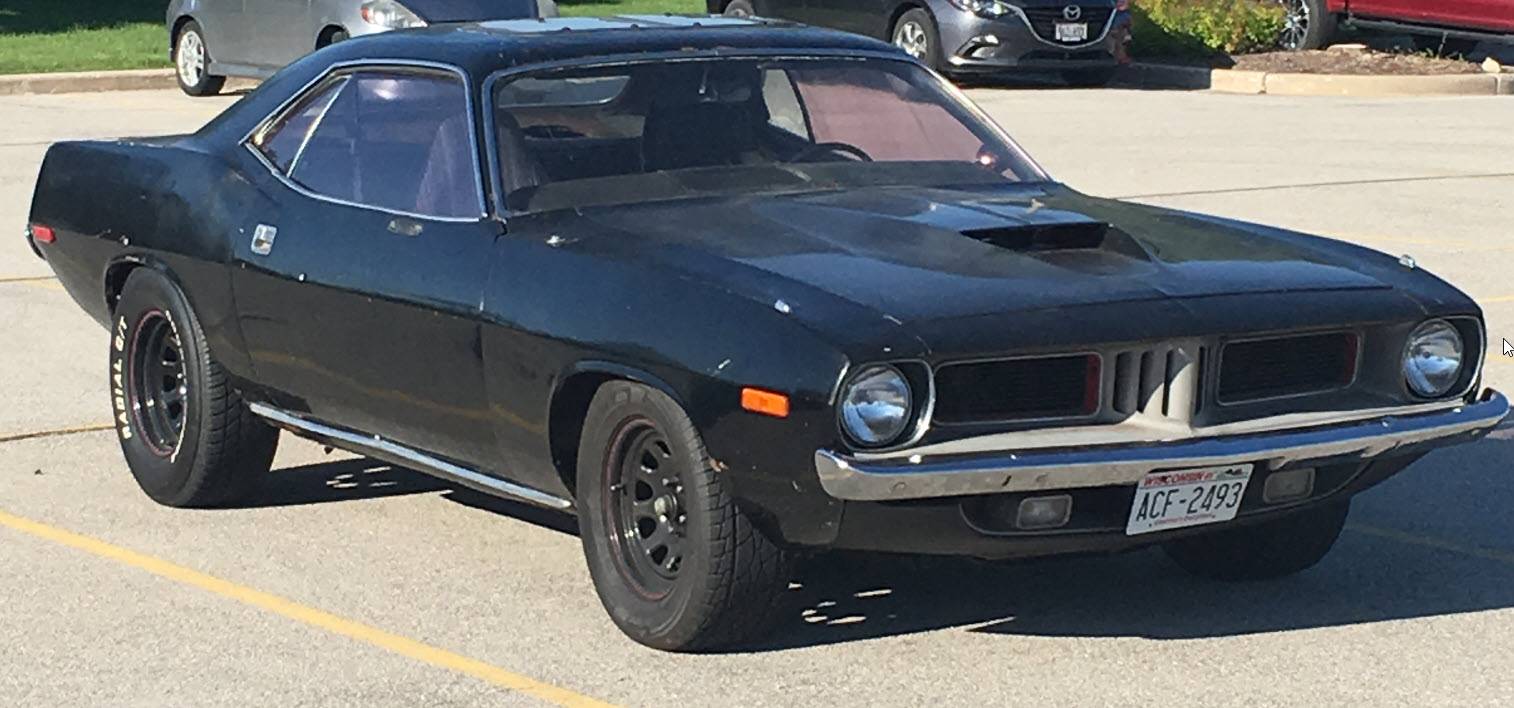

I have 255/60/15 mounted on 15x7 wheels on the front and there is plenty of room to go wider. With the right offset wheel a 275+ wide would fit. But there isn't much room for a taller tire than the 27" tall 255/60/15 without catching the front fender lip.
Looks great! What is the Backspacing on that 15x7 front wheel?

I want to say that is it 3.5" but I can't remember. I'll check when I get home, hopefully it is stamped on the outside surface. The rears are a 255/70/15 on a 15x8 and it needs to move closer to the spring to clear the fender lip better. That's a 29" tall tire and it really fills the well from top to bottom. These are place holders though and will be replaced with some snazzier components when the car goes back together.

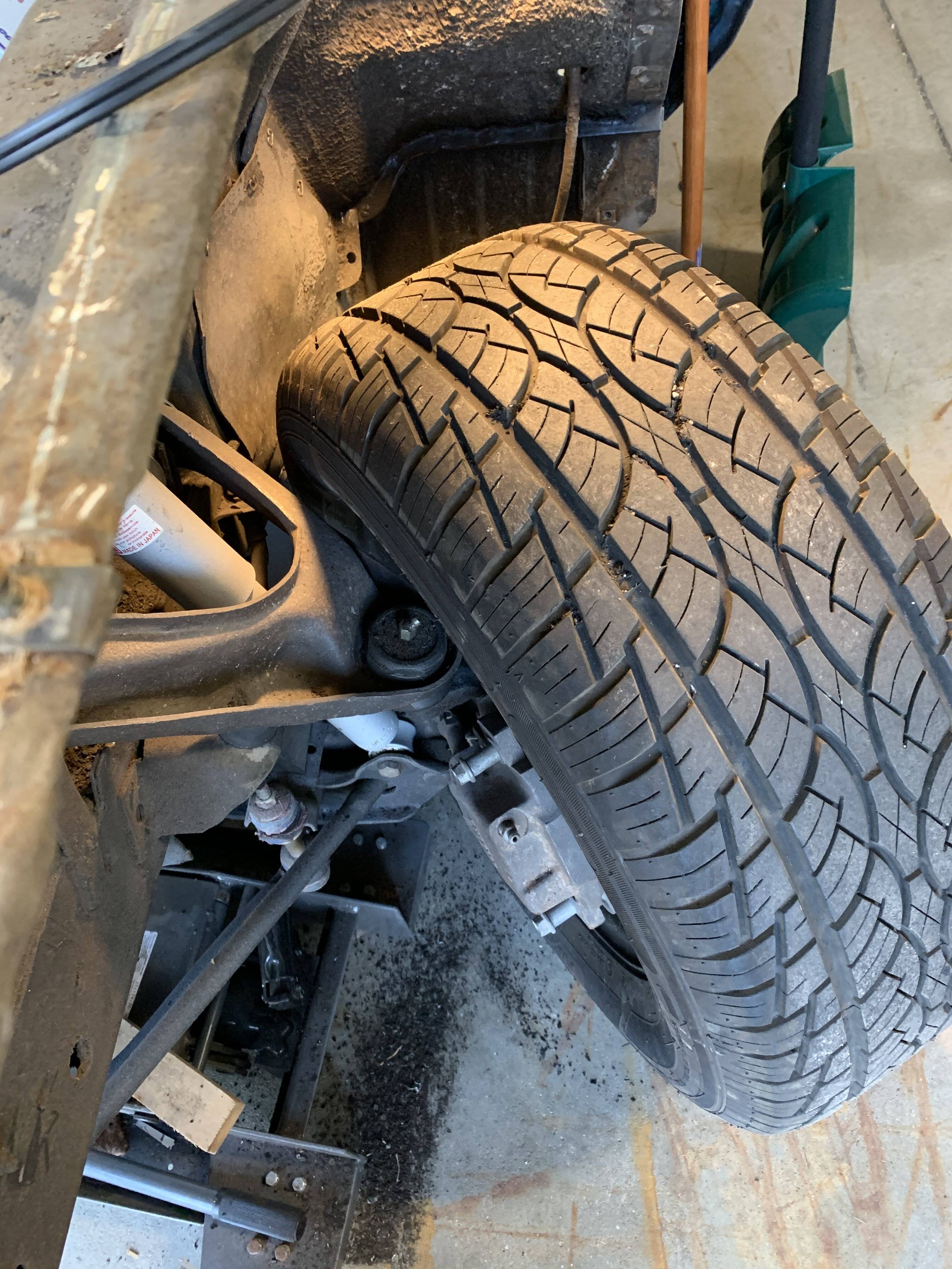

The backspace wasn't stamped, just the size, so I took it off and meausered. It looks like it is a 4" backspace. If I can get my phone to cooperate I will add a pic showing that there is still at least an inch between the tire and frame at full lock. Granted there is nothing in the car, but it never rubbed when I was driving it before disassembly.

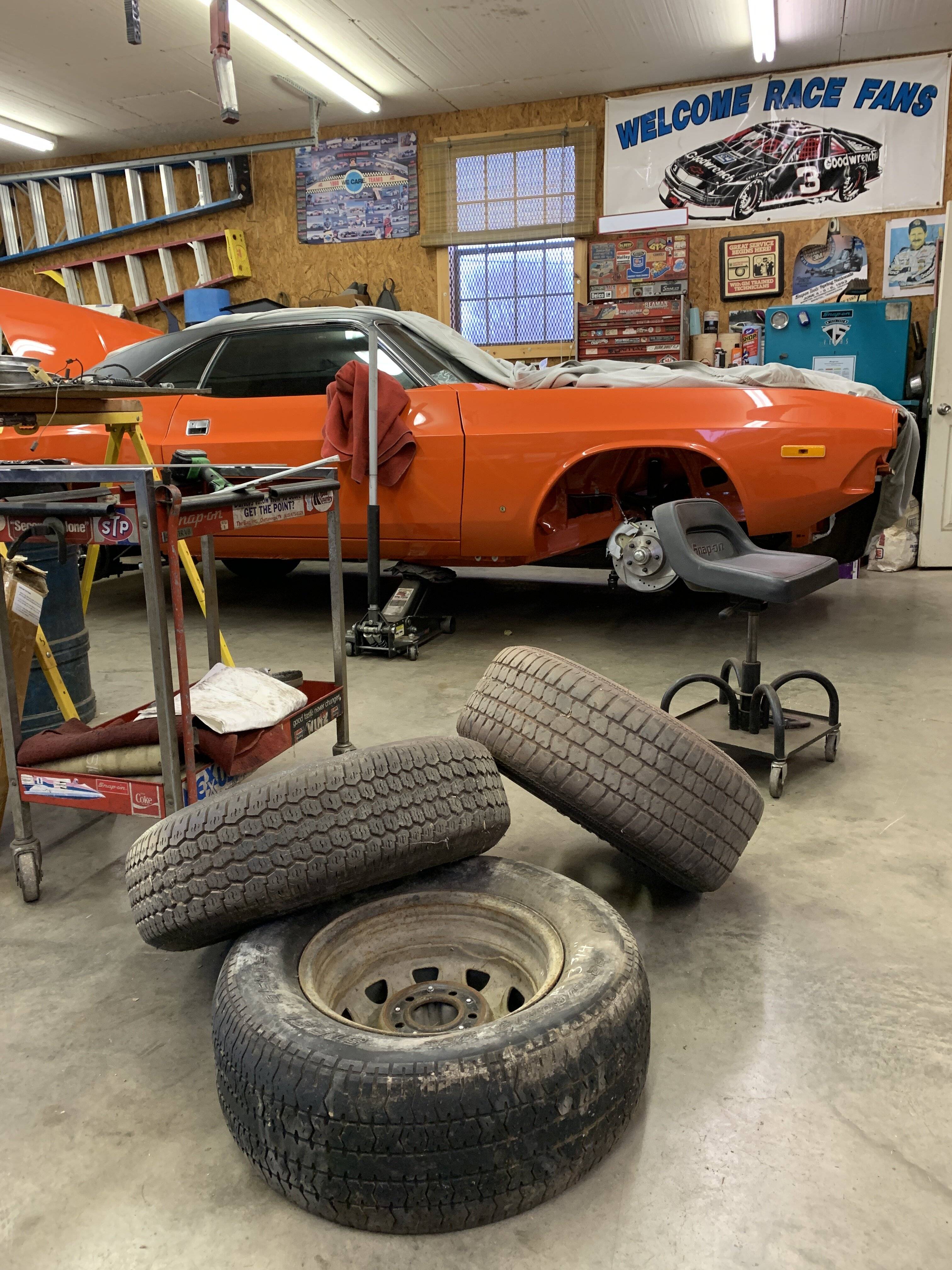

Thanks to everyone that is on this thread. I am sizing up my 1972 Challanger for her first set of wheels and tires.
I benefited from each of your posts to better understand tire sizing and especially backspacing.
Thanks again to all!
