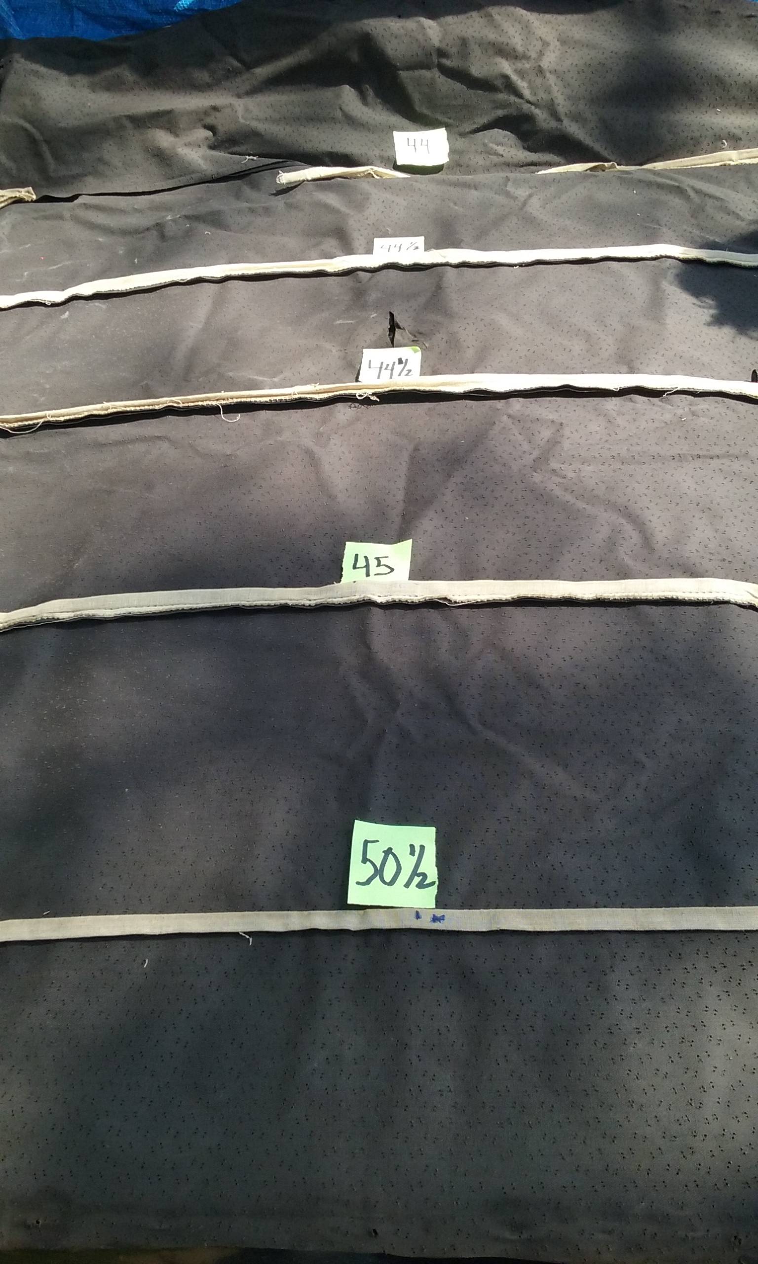

can anyone tell the exact length on the bows and which holes they go in?
my car came with no headliner but with them wrap up. i have 5 and i know i need 4
tried installing it. and I'm ready to whatever( you get it)
I've read the stuff online and still not getting it.
HELP?

Start out by laying out the bows.longest on goes to the back ,shortest to the front. I'm guessing there not color coded. headliner shown is a 71.the numbers represent the center of the headliner to the cut for bow to pass through.Maybe this might be a help.

my rods aren't painted, everytime i have the rods set ,they slide inward
