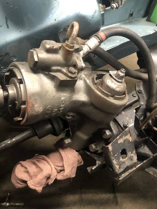

I have a 74 challenger. Originally a 318. Had a 360 until the other day when I started my 6 month preparing to swap in a 440/727 fitech injection. I spent many months doing my best to prepare everything I would need for the swap but found many many obstacles along the way that are gonna take a bit to get the needed parts to complete all this. My question is; I have always had a lot of slop in my steering wheel and the steering has never been very comforting as I would like. I notice when I turn the wheel side to side that the shaft connected to my steering column moves inward and outward not just in left and right. I tried to get a reman box while the old engine was put but they were all wrong. Is there an adjustment that will remedy this issue? I’ve searched online with nothing promising coming up. Any help would be greatly appreciated. Thanks in advance, Kevin

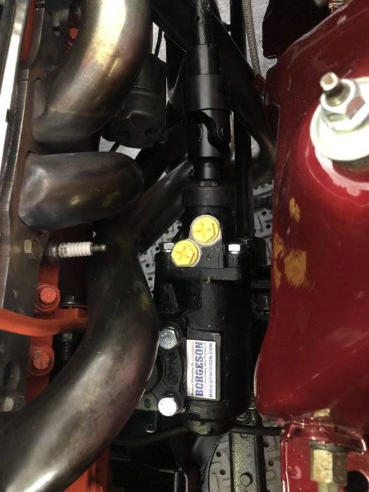

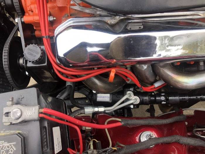

A Borgeson conversion gives you a much more modern feel, and is an easy bolt in.
I love mine.

I can’t wait to take a road trip soon, as this setup feels so much better. Super tight, all the slop, and crazy no feel steering is gone, and the ratio is much faster.
jegs and Summit both sell
One member on here got a hundred off his through jegs recently.
