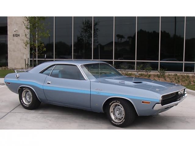

I have a 74 challenger,and am going to buy some rally wheels from jegs.wondering if 15x8" will fit on the back??if so what is the biggest tire i can fit in there??wheels have 4.5" b/s..thanks
I saved a pic of this car because it has the perfect 15" wheel and tire package on it. The fronts are 15x7 with 235-60's and the rears are 15x8 with 275-60's.
I have 275s on rear of my cuda 15x7. Pretty sure you could get 295 50s w a 8 in rim
