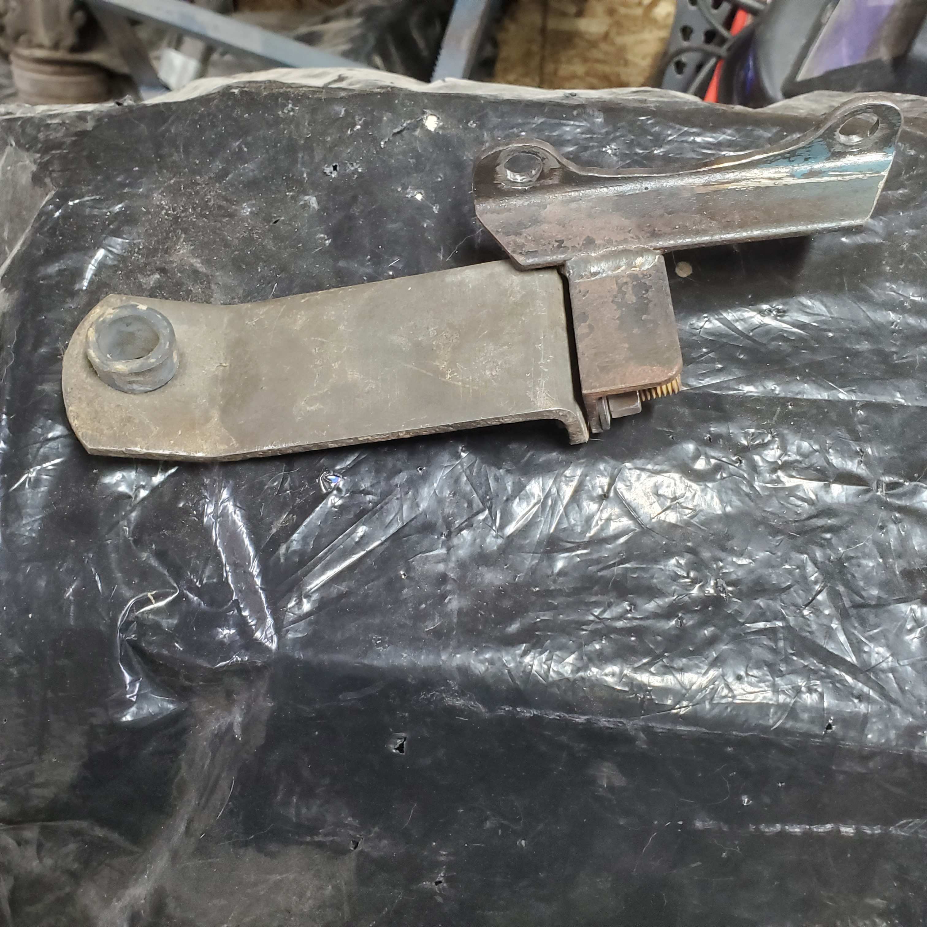

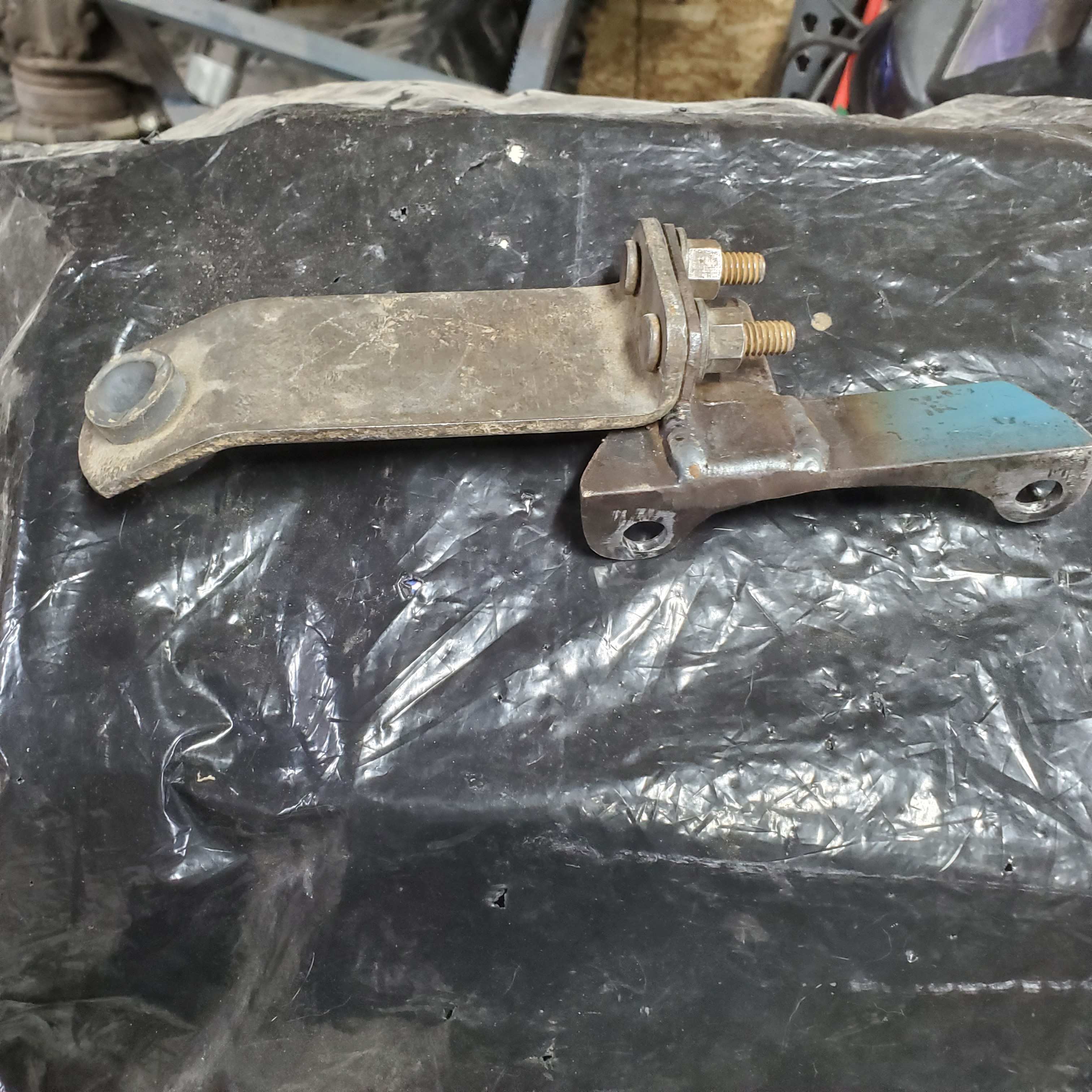

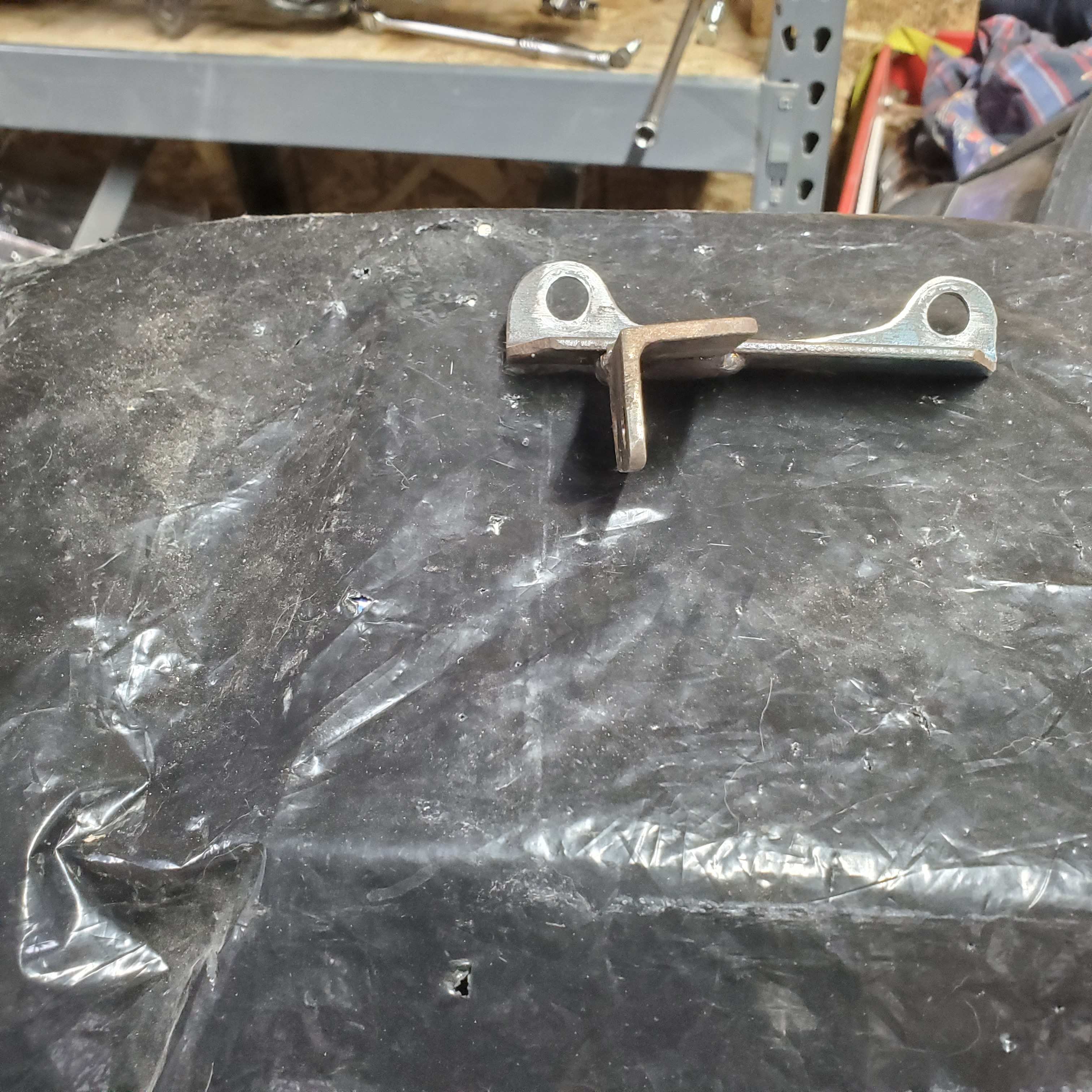

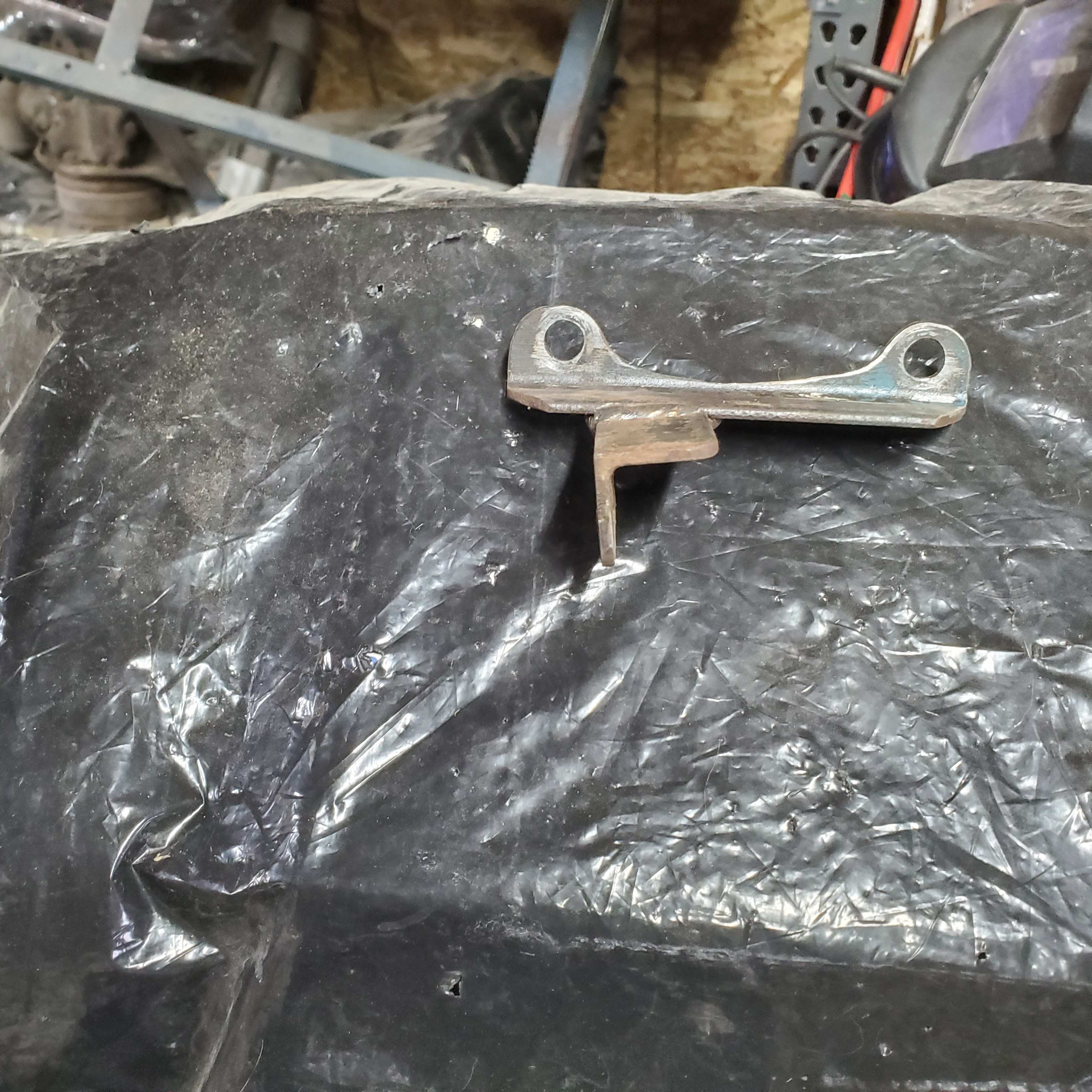

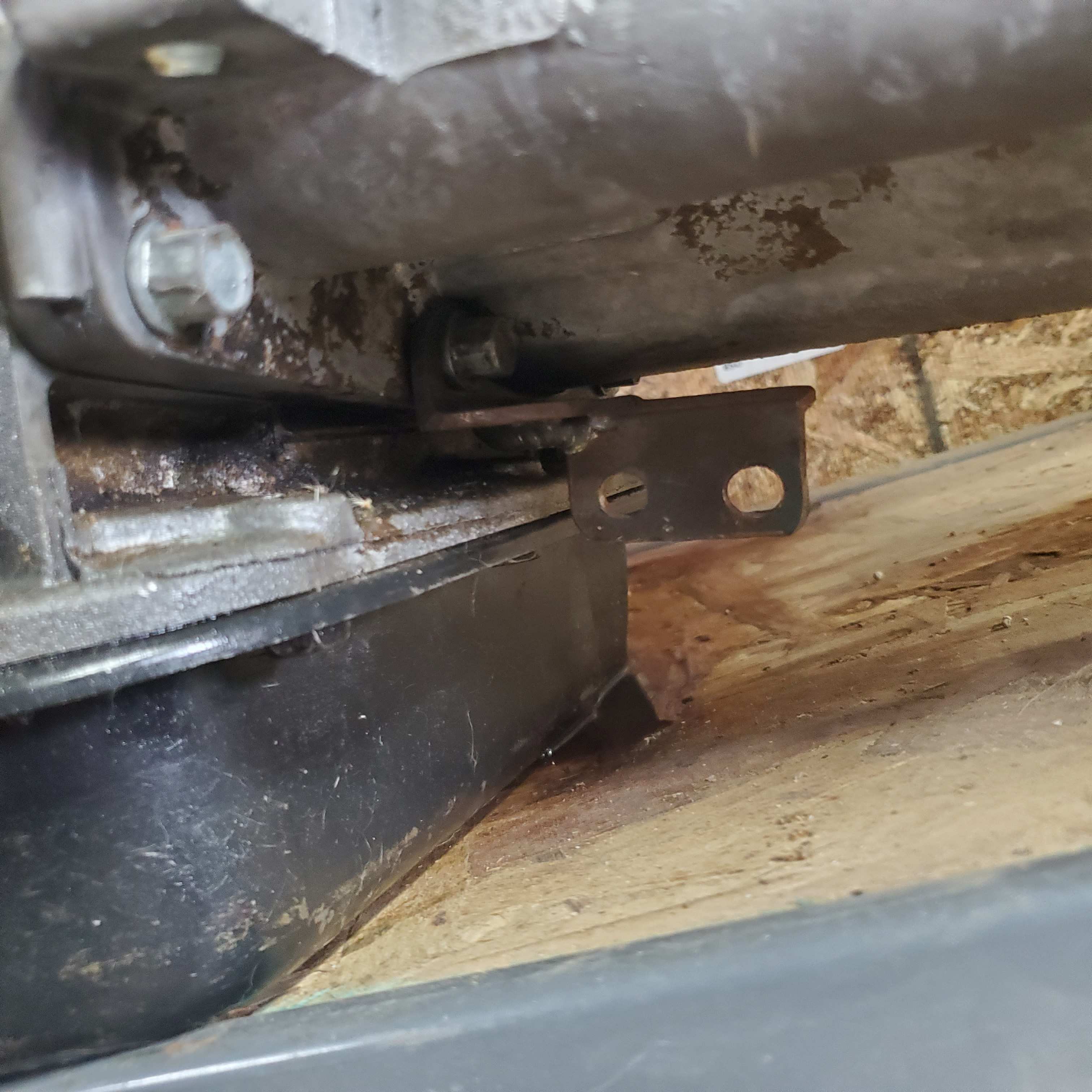

I made this bracket to use with the center console stock shifter and the 518. It locates off the two bottom overdrive tailshaft bolts.
