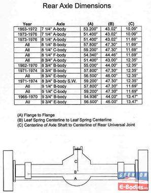

I have not done that but here are some details for size and dimensions.

The axle width chart doesn't tell the whole story.
The drum flange to flange width is the important one
Early A small bolt pattern rears are narrow but, small bolt is worthless to us.
Big bolt pattern adds an 1 " to each side, making a big bolt A body rear almost the same as a B rear, which most of us use for narrow rear ends.

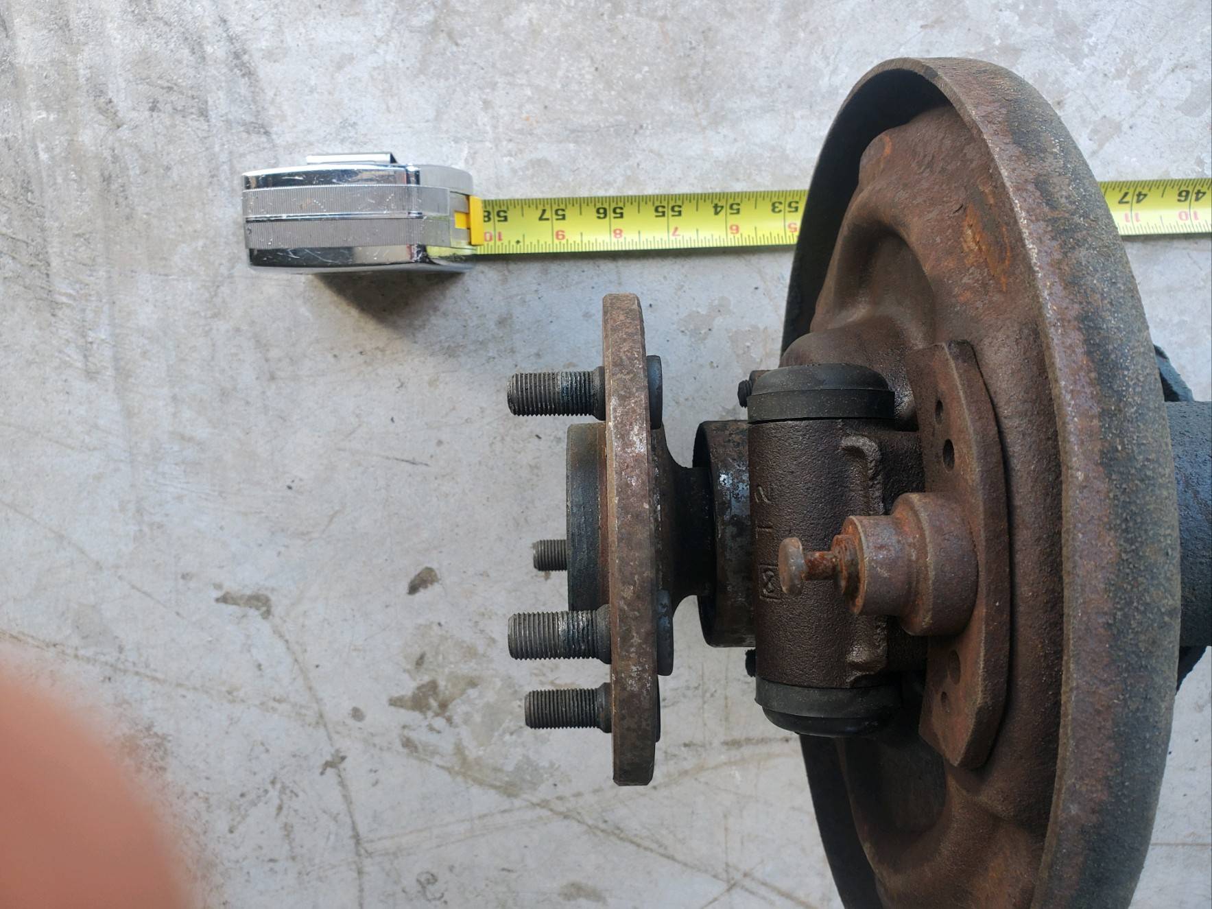

I've got this listed on the A Body sight. [FOR SALE] - 8-1/4 rear Flange to Flange is just over 56". I also have an early (65-67) B body 8.75 I have not yet listed for sale, but will be soon.
