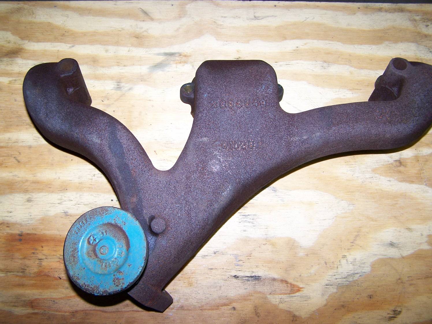

This is the first I’ve heard of a different counter weight. What is the difference? From what I’ve seen, the TA AAR had different exhaust manifolds in the way and location of the part numbers. They were made a at a different casting facility later in the run. The numbers are not raised like the ones in the picture. They are the same numbers, though. They were not unique to AAR and TA cars and can be found on other 340 cars. I’ve got some st the shop I can take a picture of them.

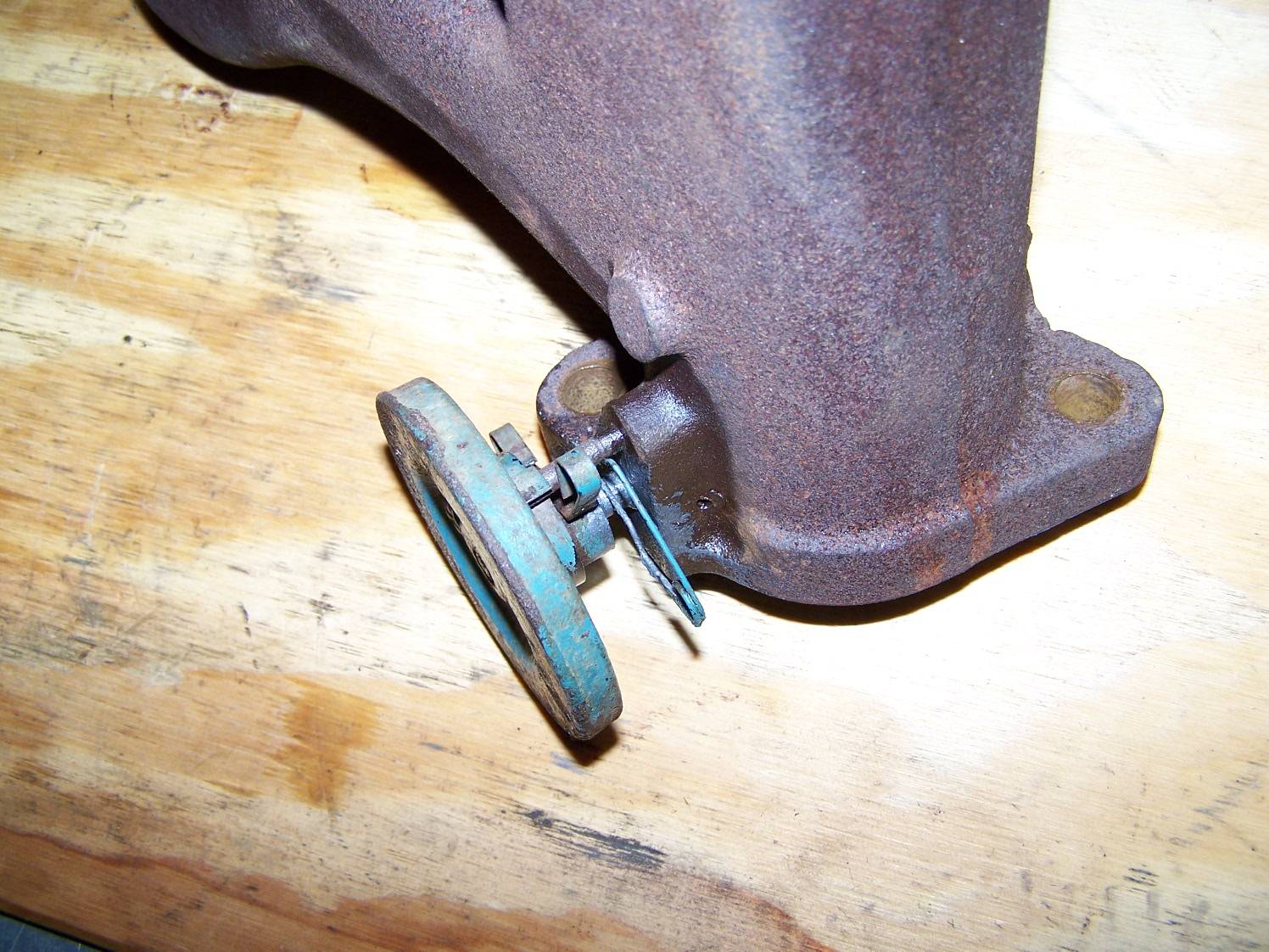

Here are a couple of pictures of the original passenger side manifold off of my 1969 Dart GTS 340.

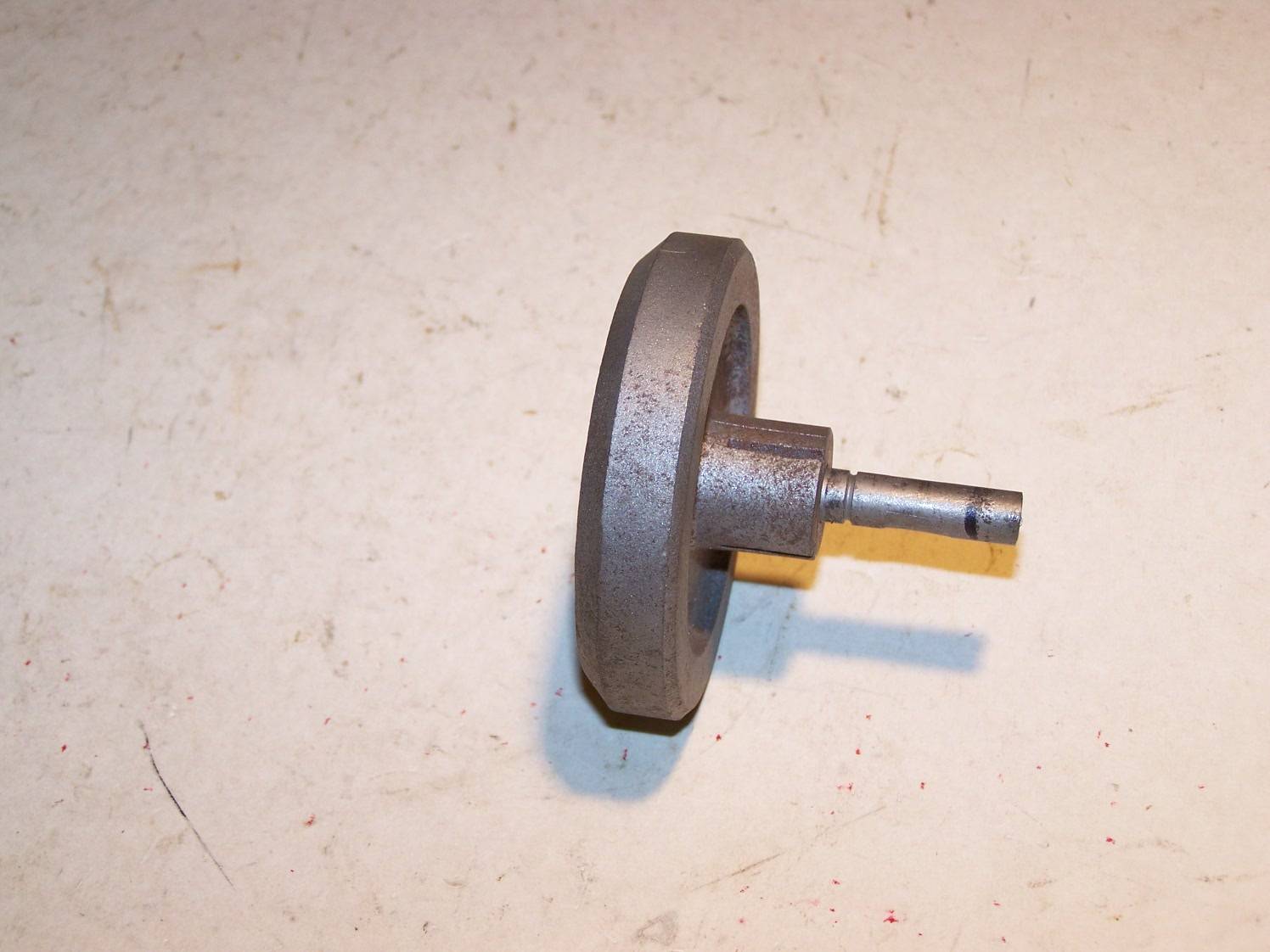

I also dug up a 1970 and later heat rise counter balance. The 70 and later ones were thicker and the face was different.

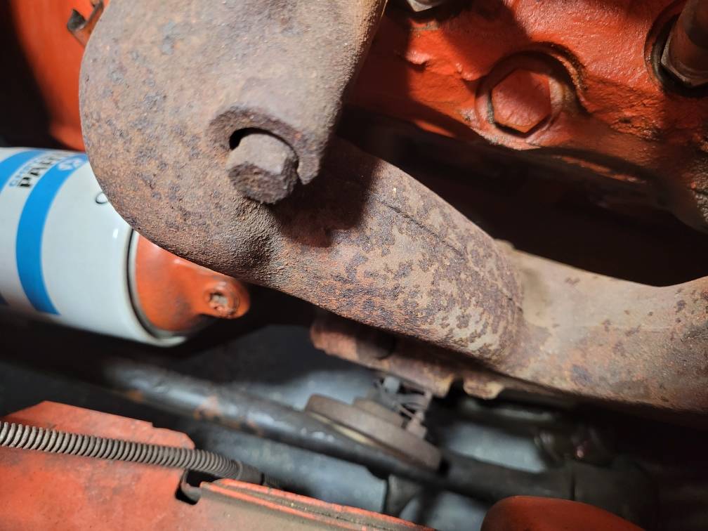

Here’s a pic of the “earlier” style weight on a friend’s 4/30/70 SPD survivor Cuda.
Not surprised to find examples of the earlier style weights on 1970 models.
