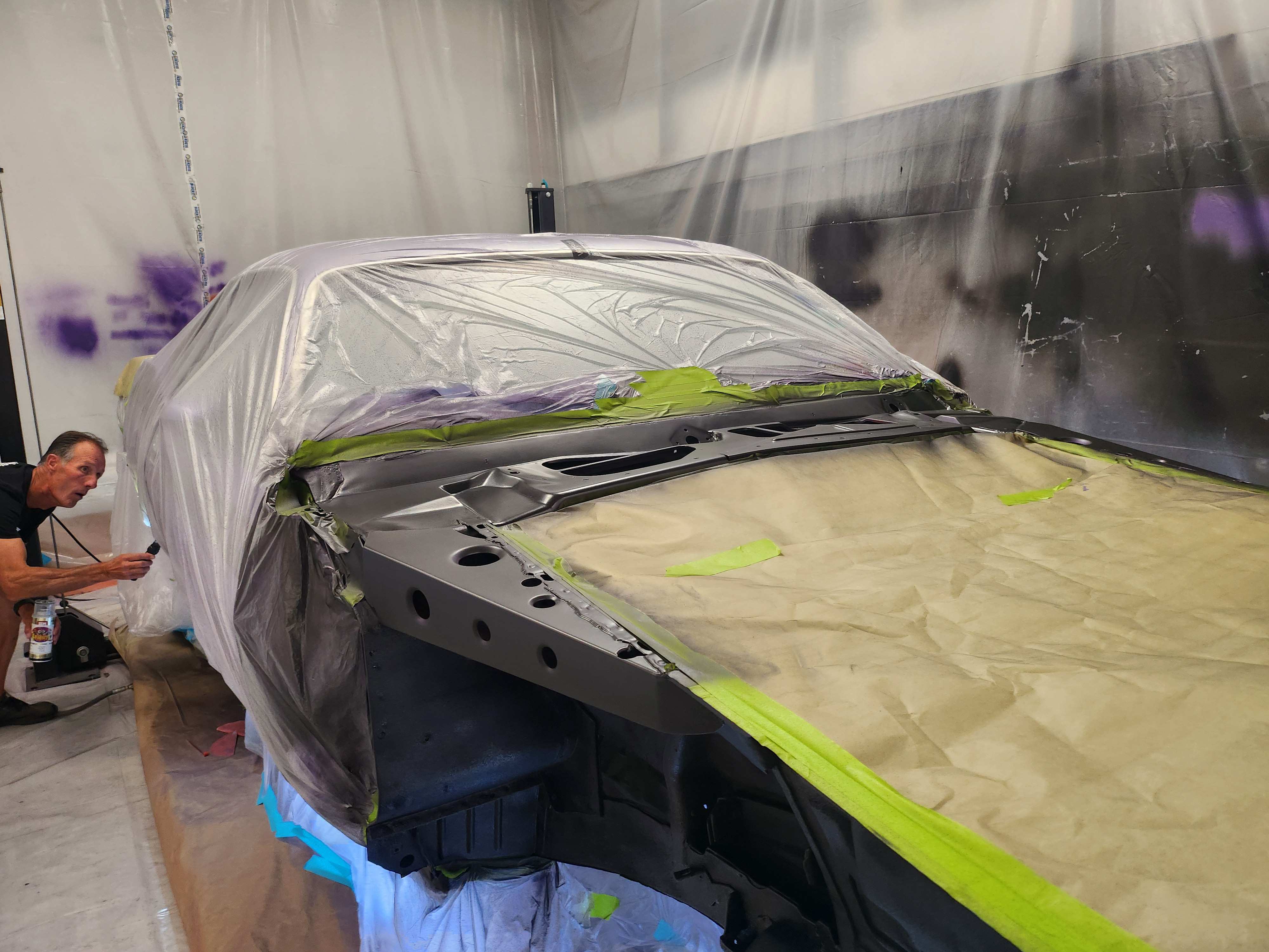

thank you, just heading out to the shop this morning going To be nasty hot here today, going to buff the main areas that shows in the engine compartment, and what you can see in the trunk looking at it from standing height, nothing crazy just a cut with a pad then a polish, enough to smooth out any dirt specs. then will be prepping the last of the parts tomorrow for spray on Wednesday morning. A cold front is supposed to move through tonight and cool it down here, should decrease the humidity too, I hope.

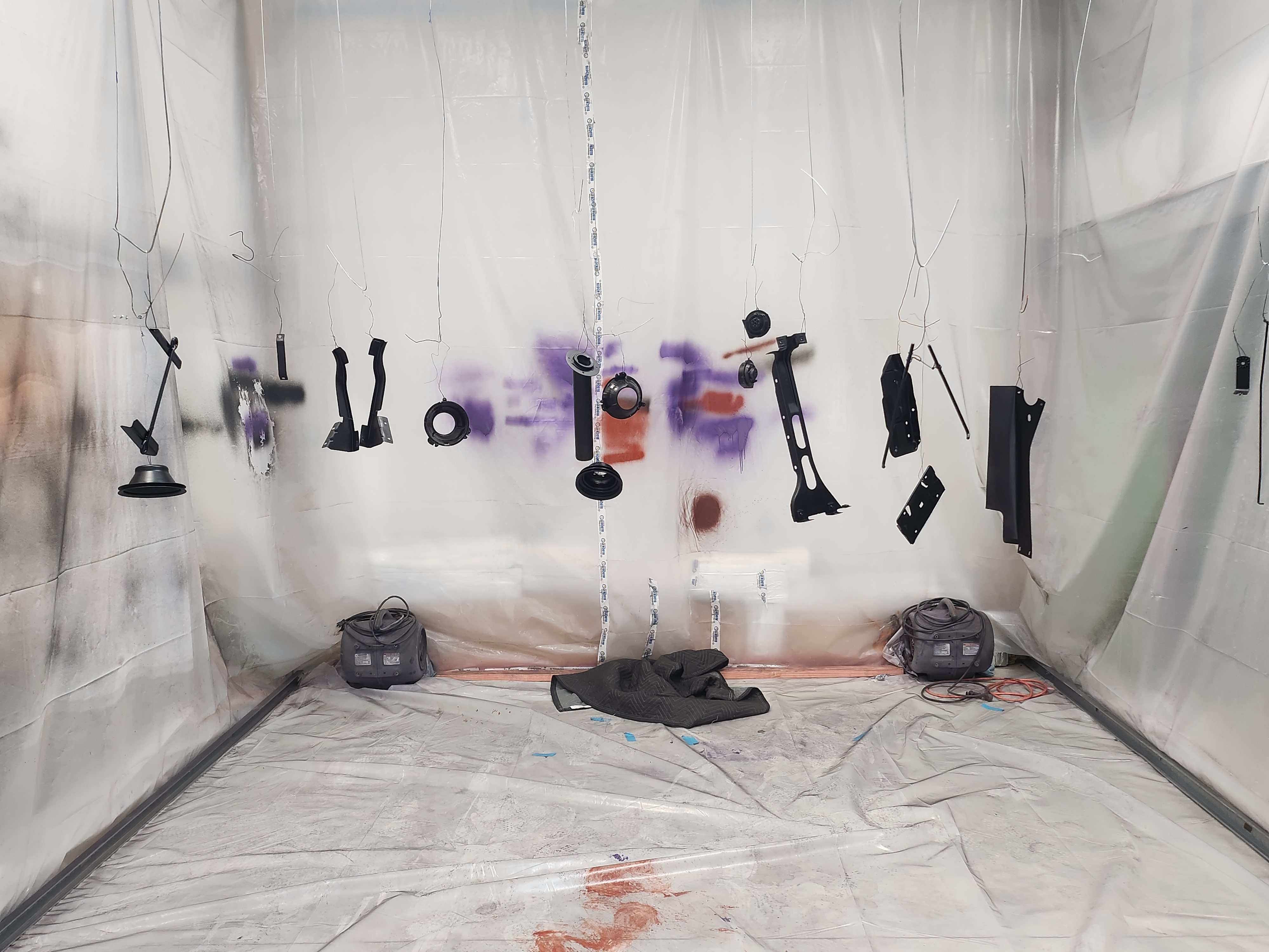

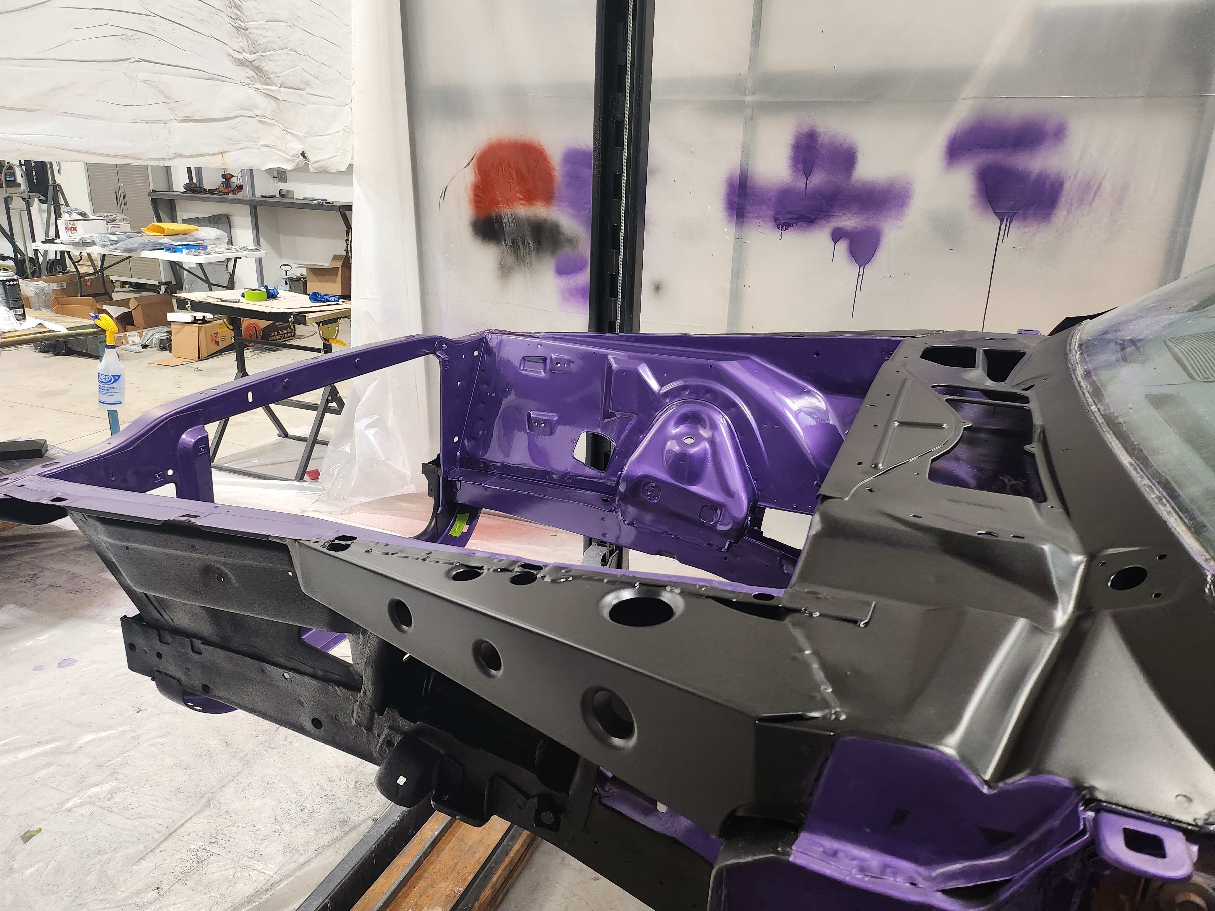

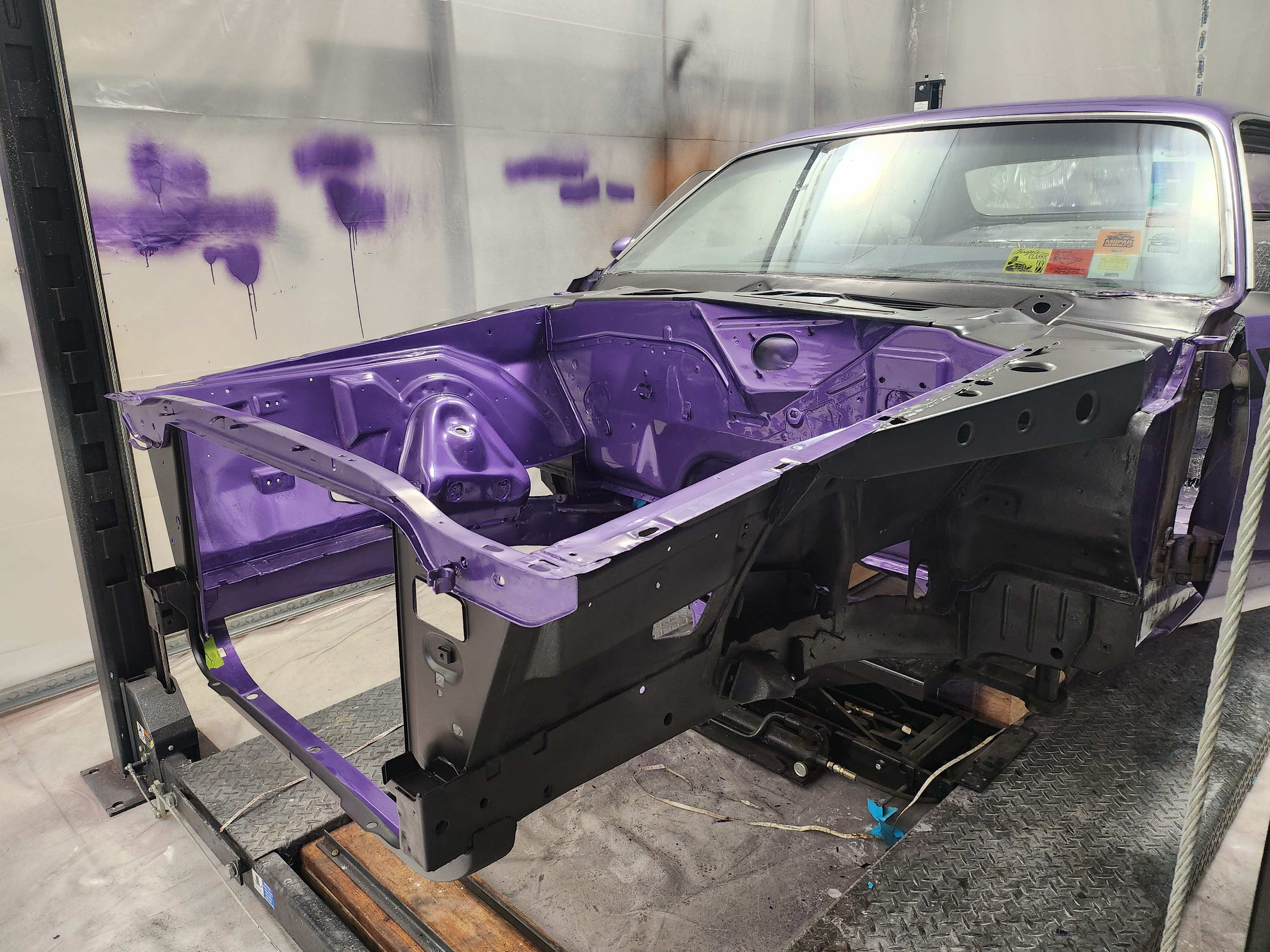

got 11 hours into her today cut and buffed. sandblasted and treated about 20 parts, will let them dry and shoot them tomorrow. SEM black mainly under hood parts, gonna call Advantage driveline tomorrow to see how my 8 3/4 and drive shaft are coming. will have more pics tomorrow.

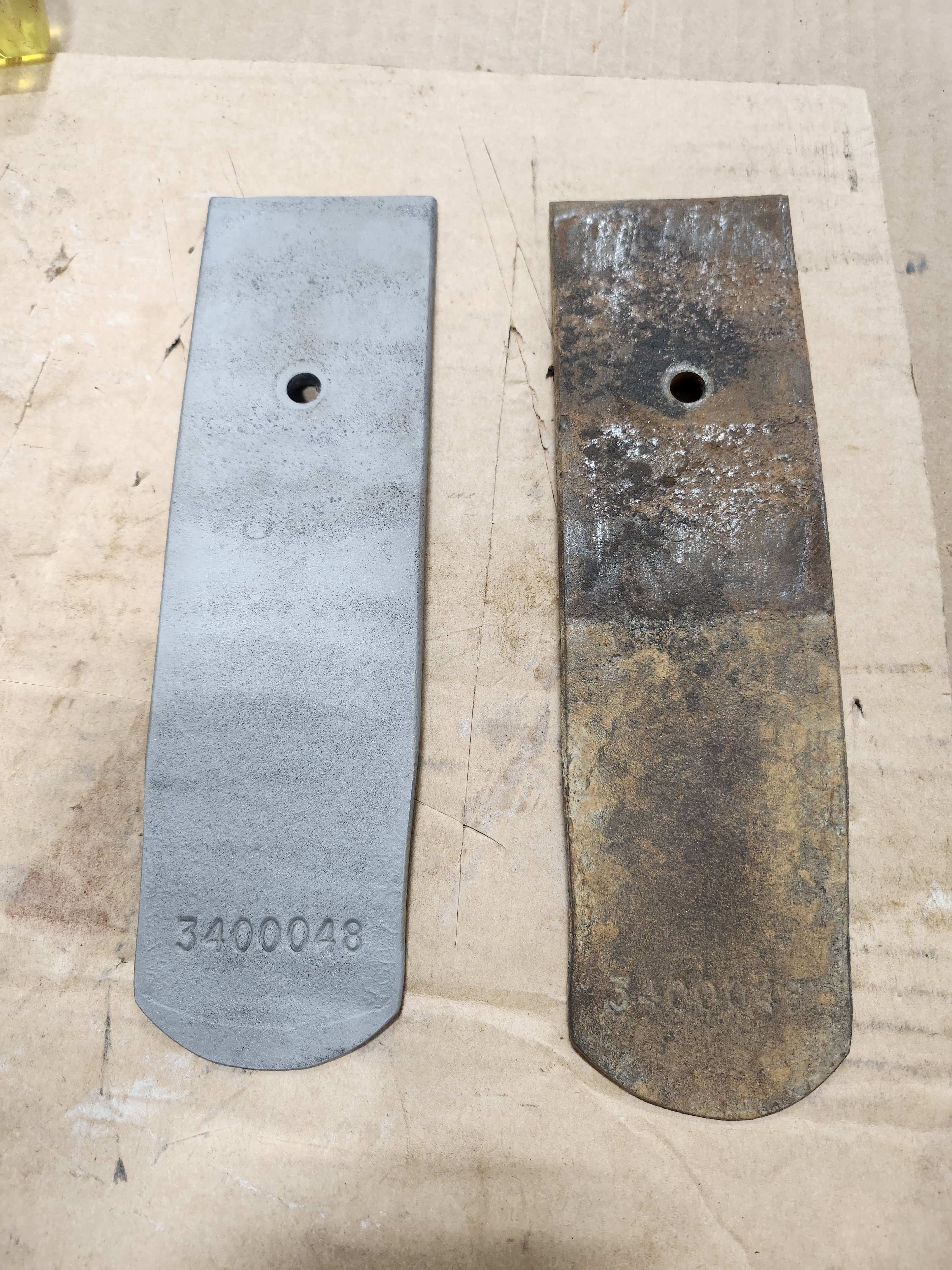

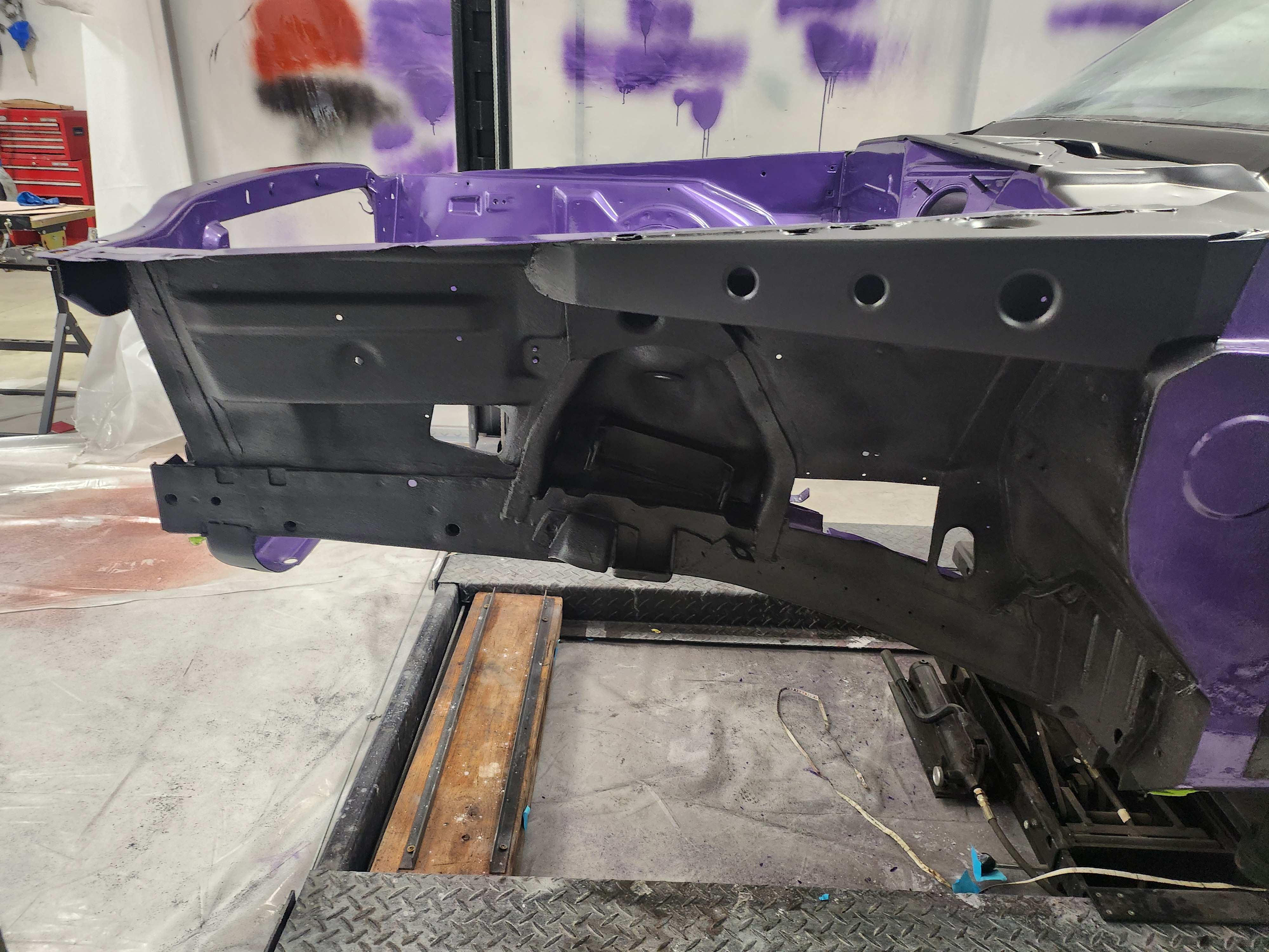

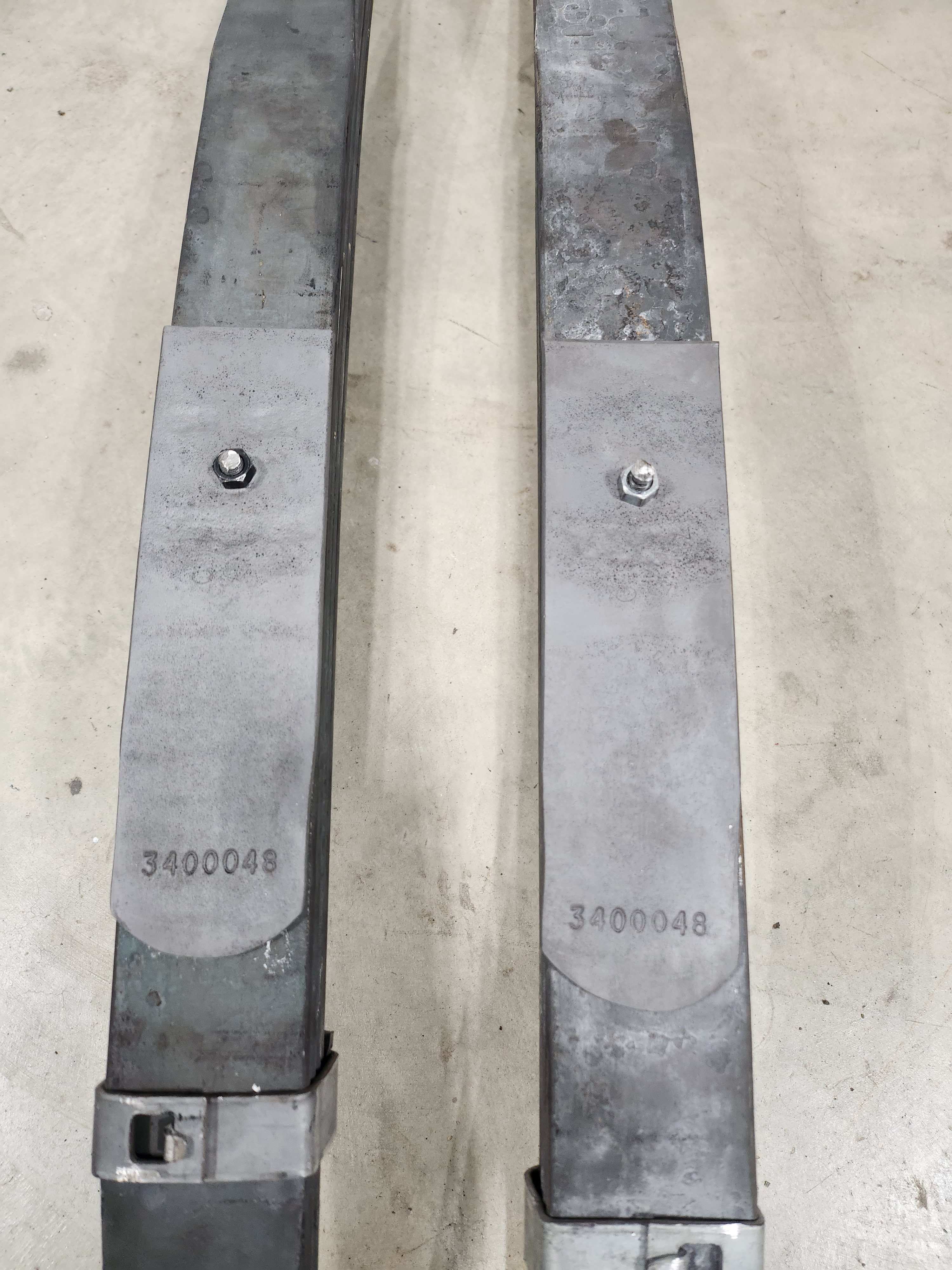

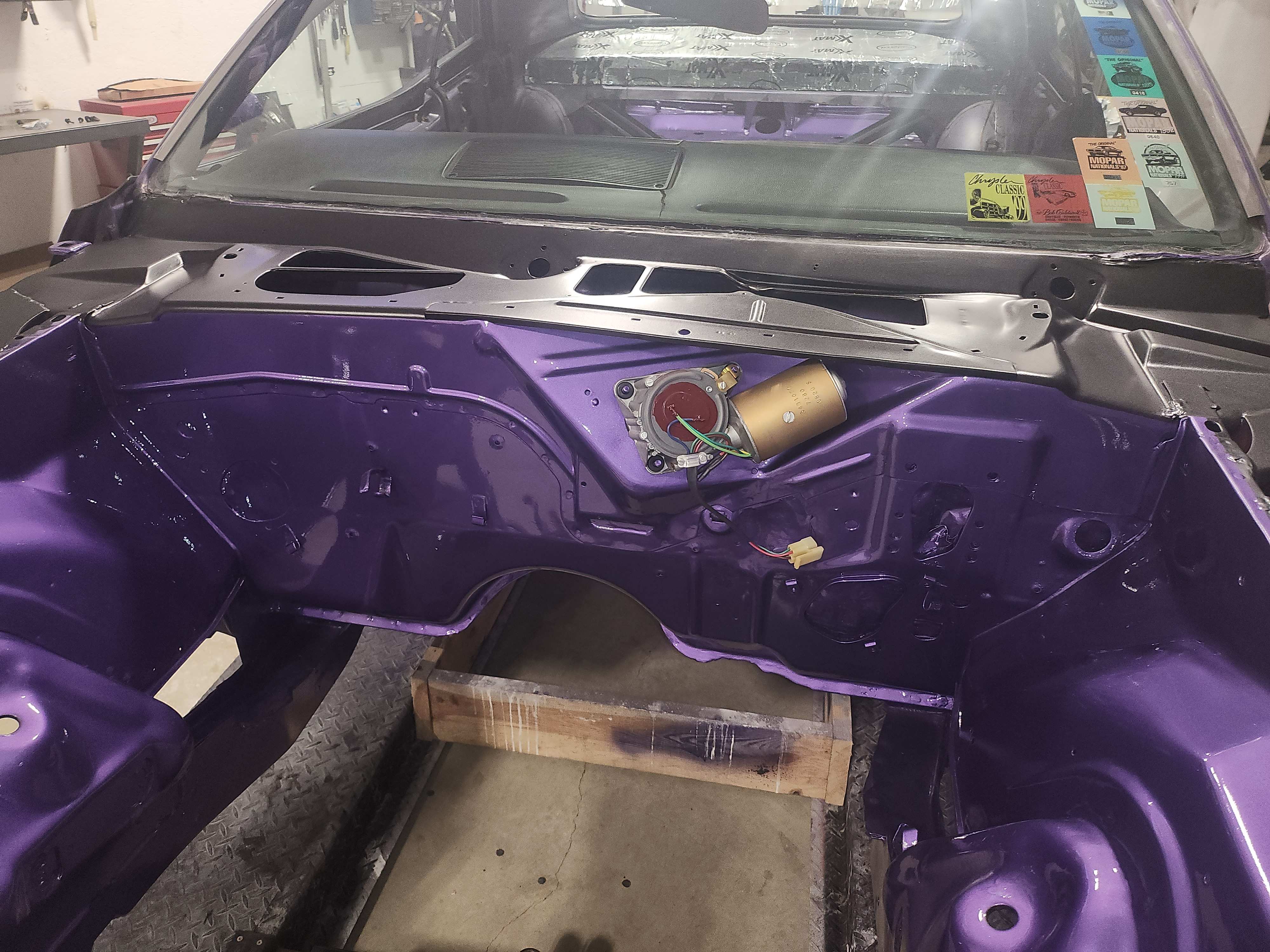

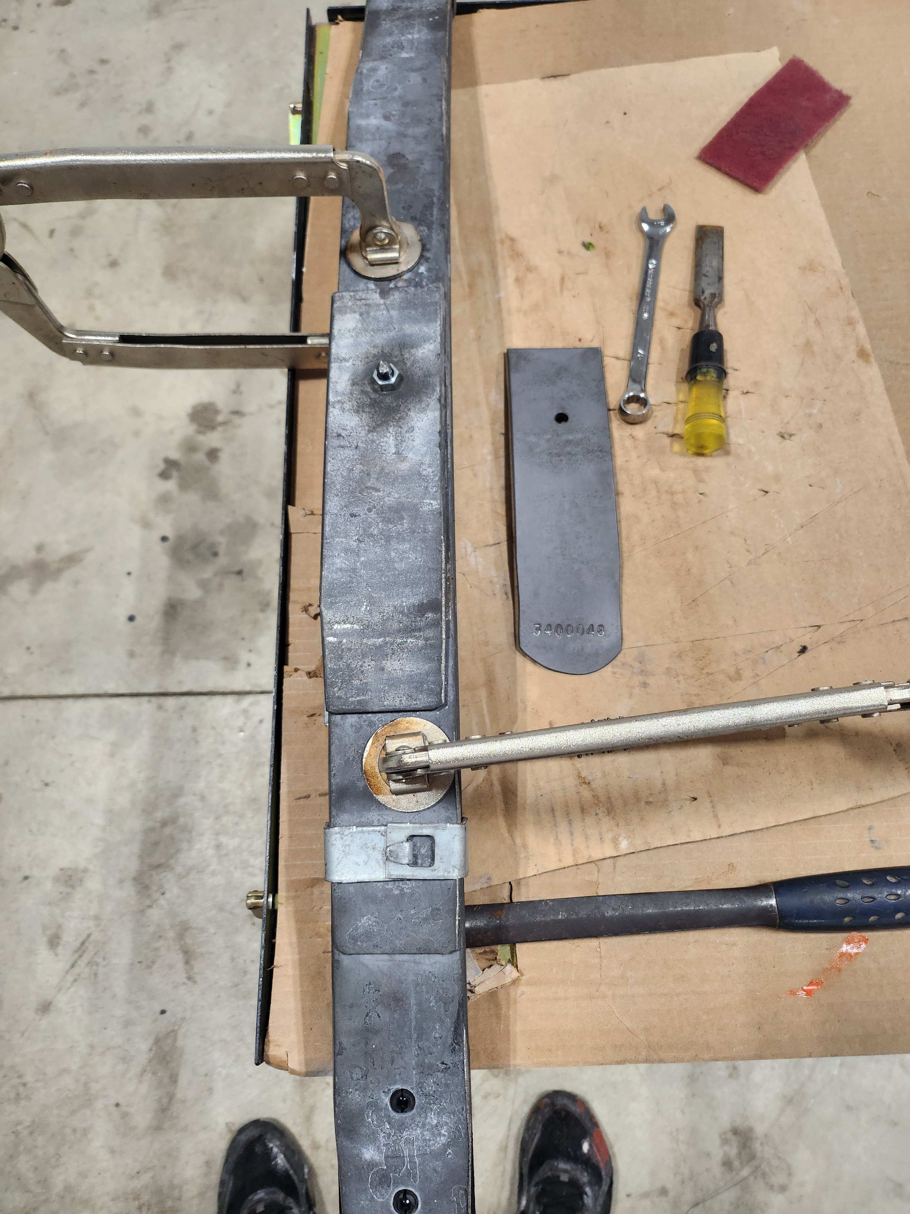

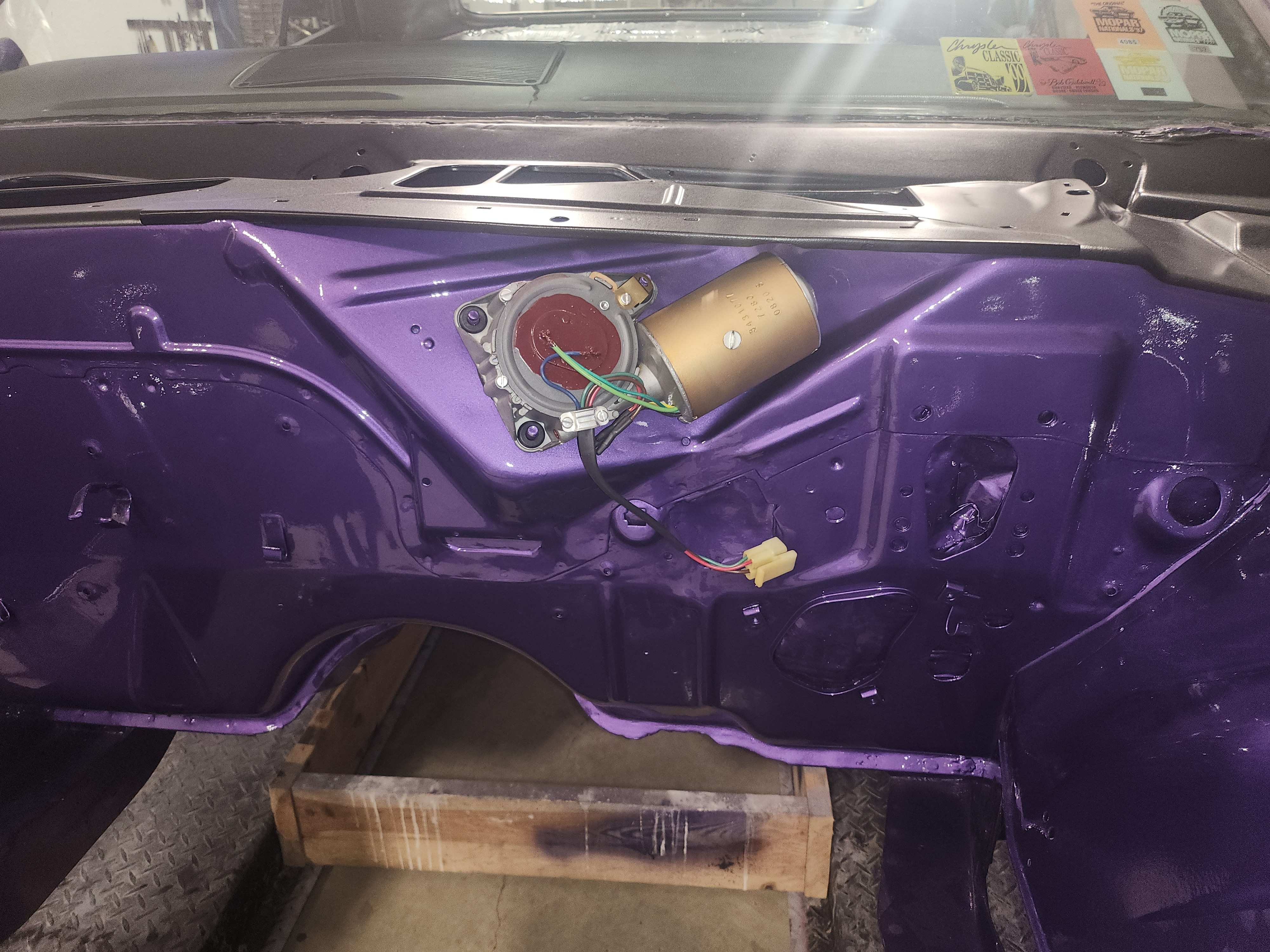

got the SEM rattle can black done today, talked to advantage drive line said by the end of week, for the rear end completion, so then the ceramic undercarriage paint can be shot with the leaf springs and center link. That will get the car on its wheels again. removed the aar # leaf spring front the bottom of the old springs, blasted, rust inhibiters added and rebolted to new springs, love my cabinet blaster. touched up some purple areas deep in the truck now accessible from the back seat area. going to work on a few things in the morning then headed to the weekly pool game in Bridgewater Michigan about 35 minutes from here. will throw back a few, B.s. with some good friends, all retired machinests, engineers, and several other regular guy jobs. Will
figure out a date and time to go get my engine and trans, so I can start the rebuild process. threw the rebuilt wiper motor in just to look at it. BM Cuda does a great job, Bill is a way good guy.

What is the secret to getting the leaf spring bands on nice and tight? I see your clamp on the leaves.
don selleck
Dec 8, 2022
385
384
michigan usa
clamp them before you remove the bottom leaf bolt, clean up the thread so the nut will thread off the bolt, I ground it back to be able for the nut to thread off the bolt, then hit it with a grinder and a hammer to replicate the cut, at least somewhat, when its replaced. :lol:

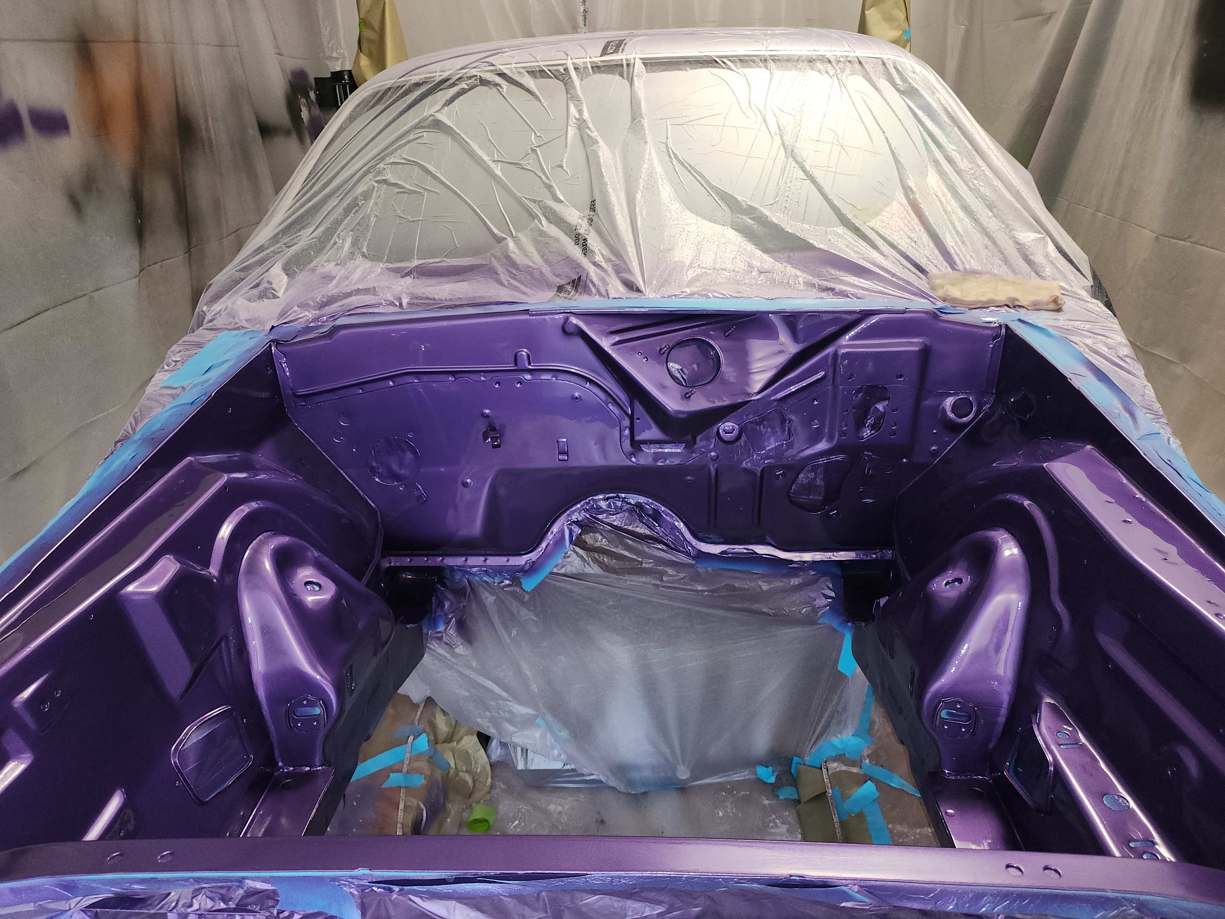

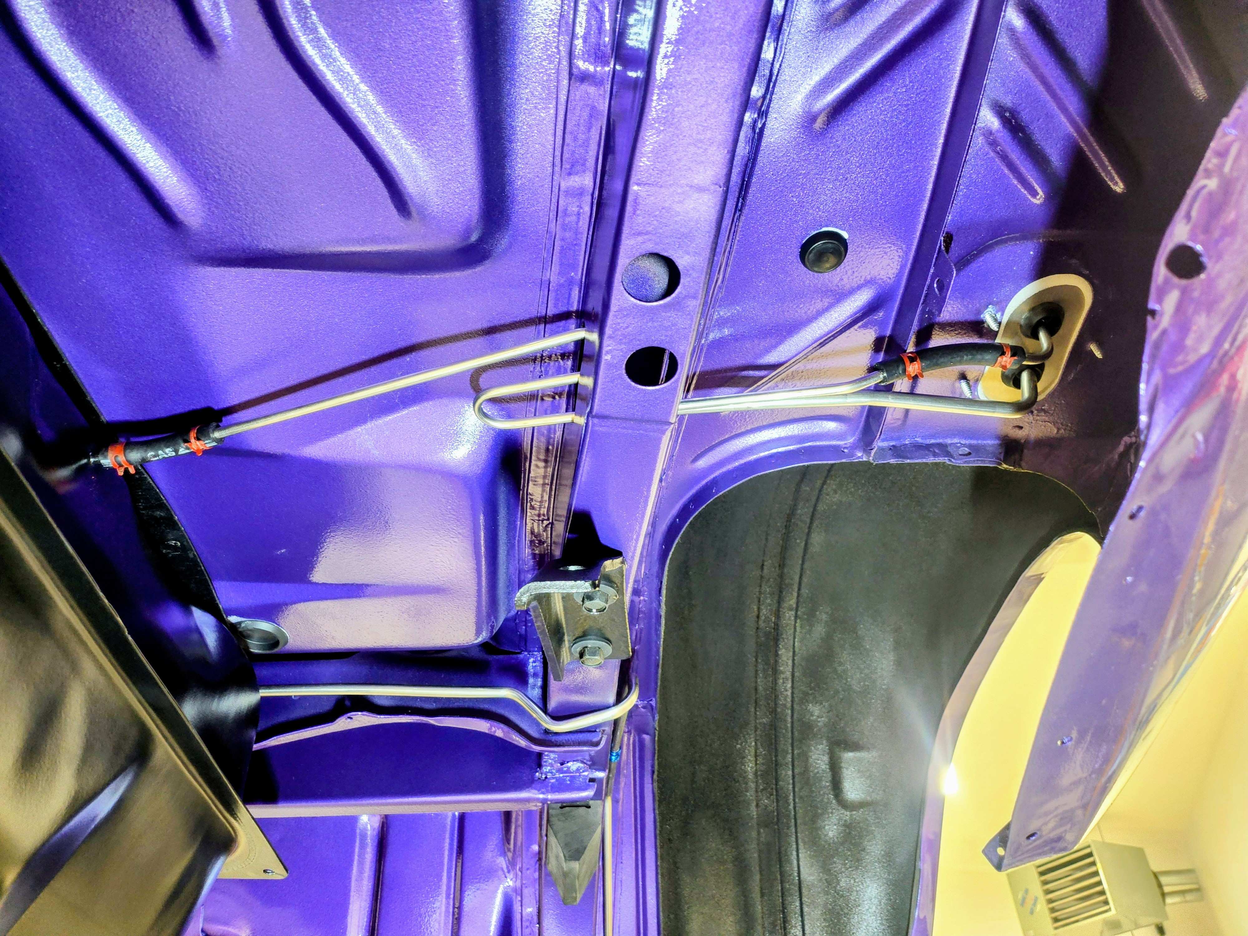

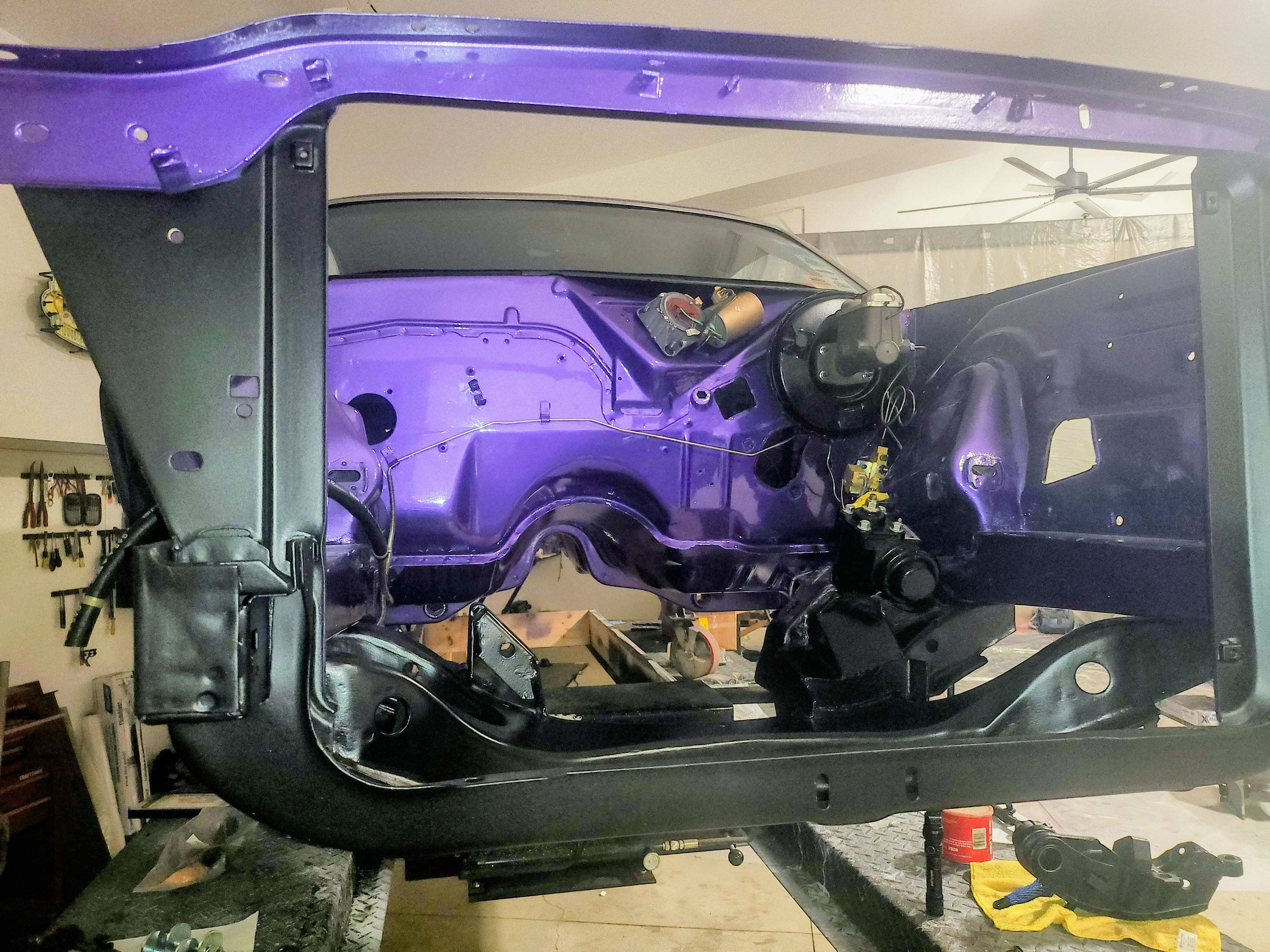

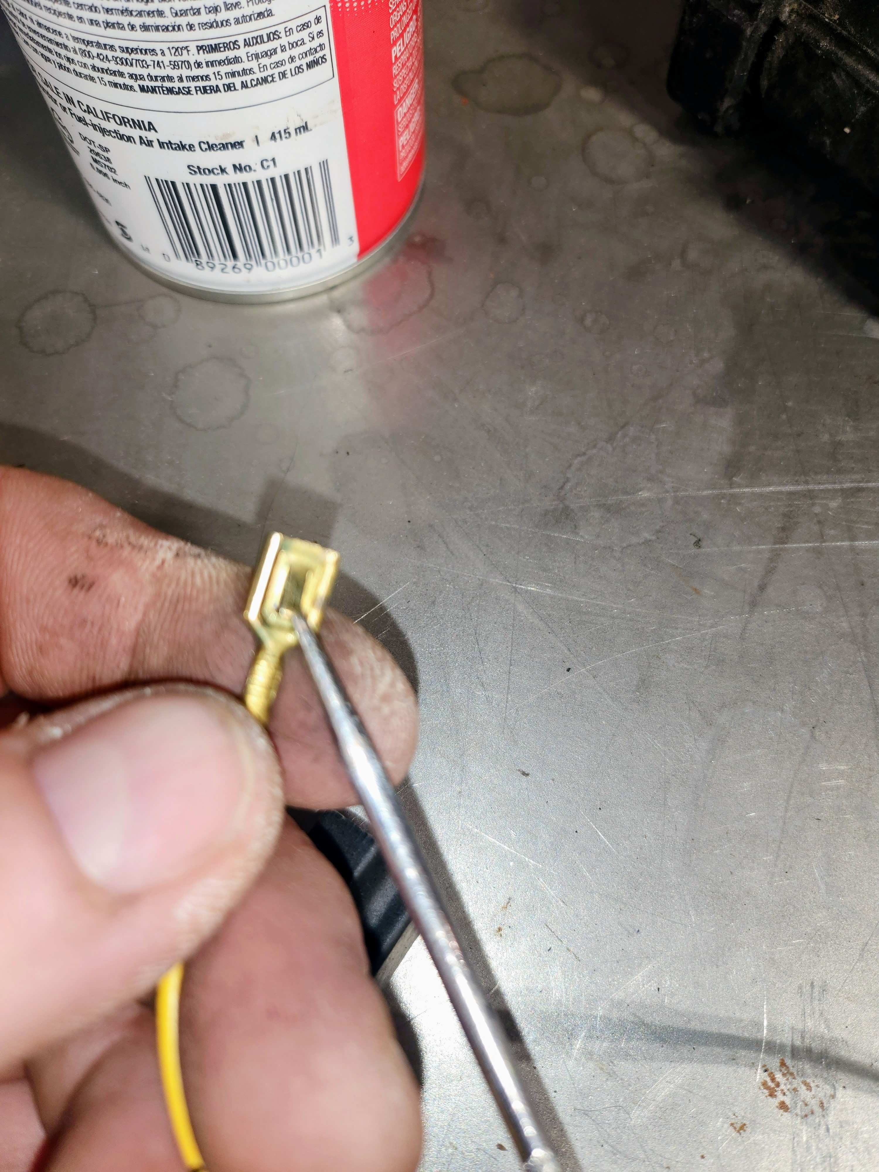

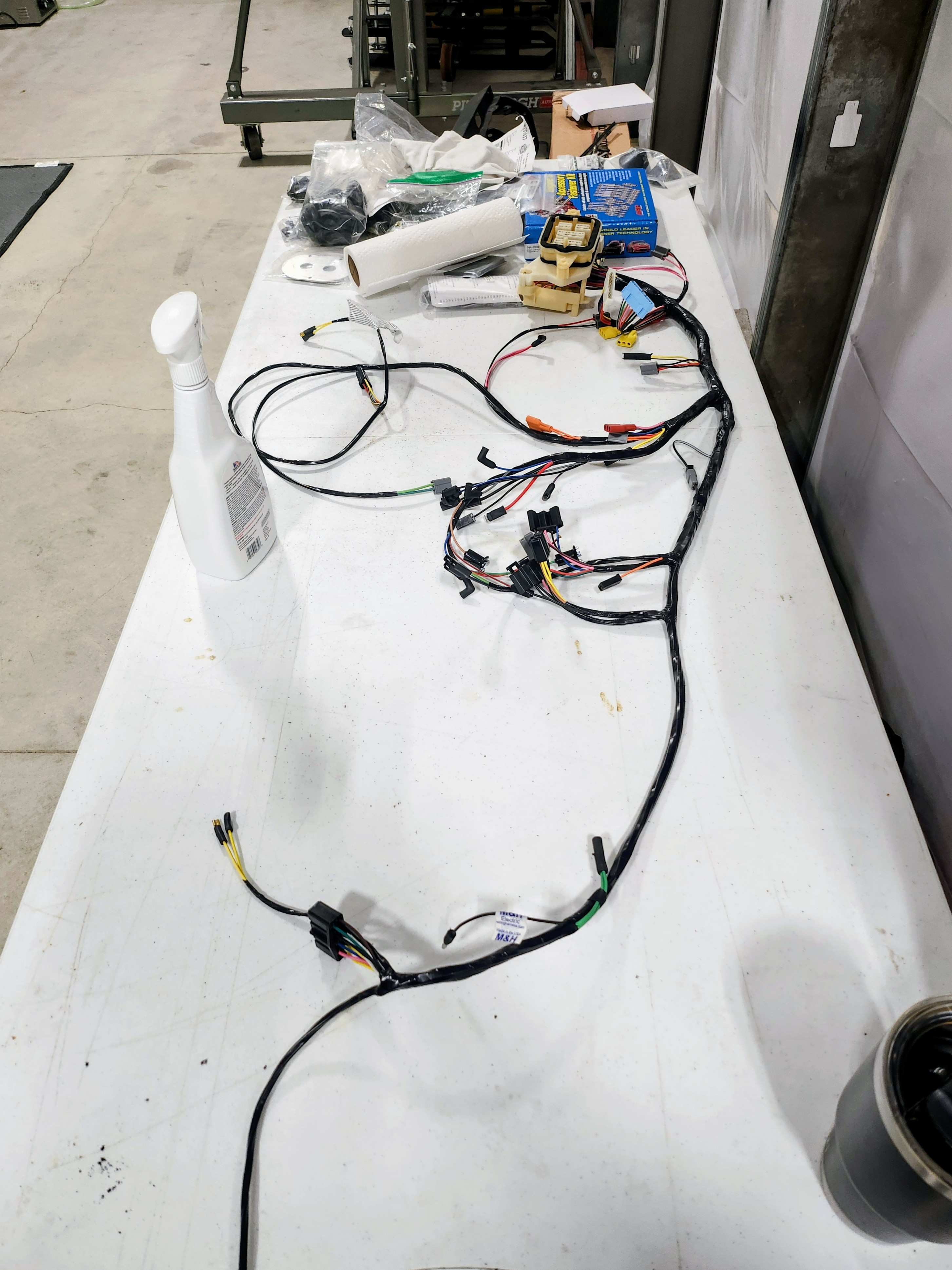

got the master cylinder, booster and all the lines yesterday, pulled 13 hour day today on it got the old dash harness out, kept the light bar harness and accessory/ courtesy light, and console wire, removed the connectors and cleaned up everything for a good connection
. new tailight, engine compartment and front headlight harness. Assembly is so much better than paint and metal repair, love a clean car.

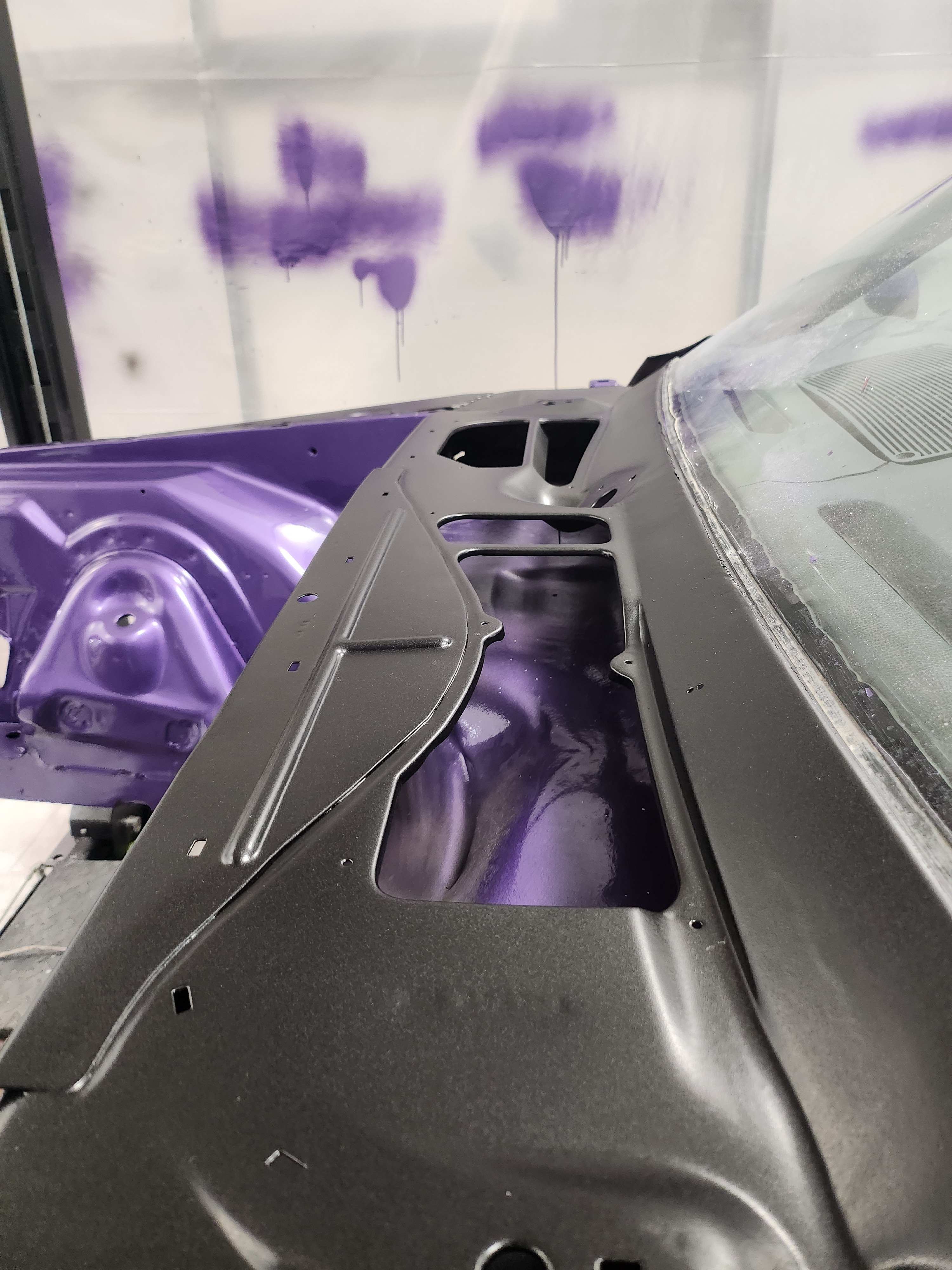

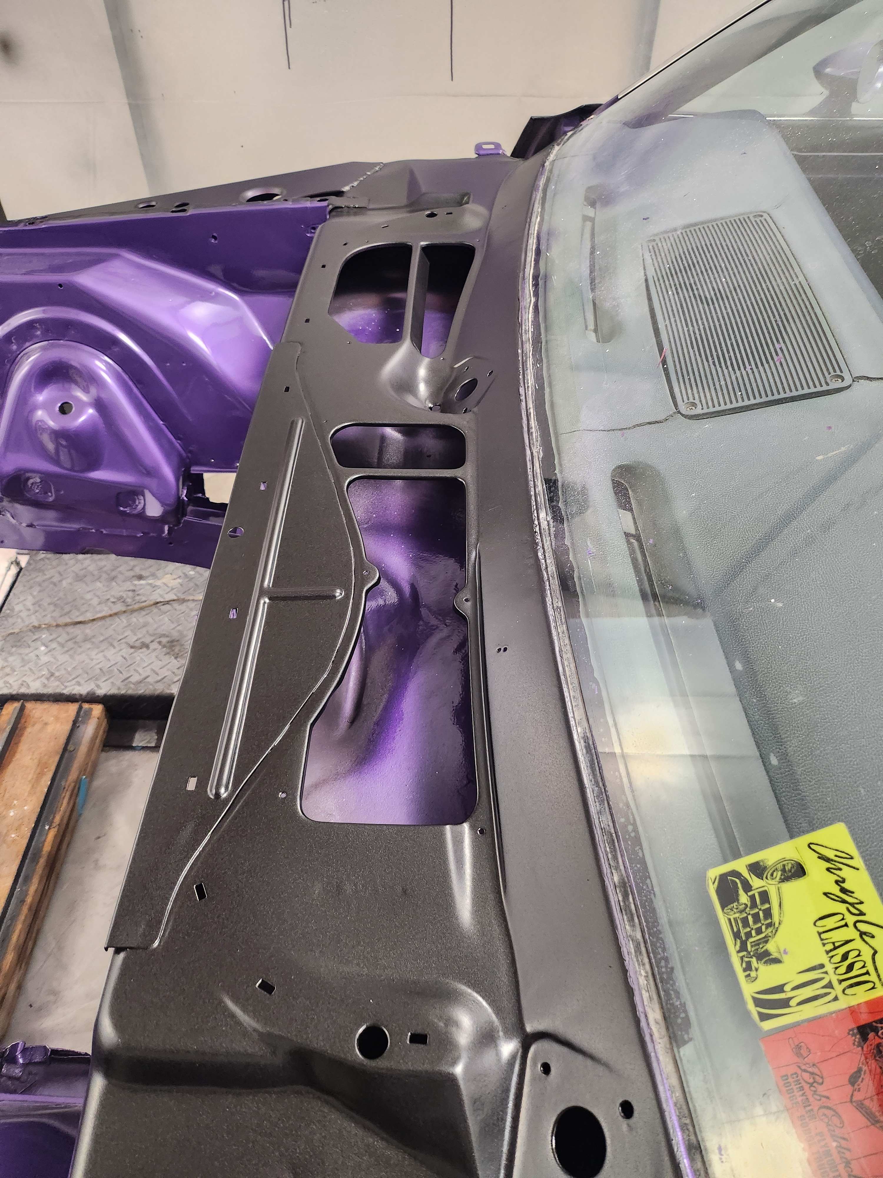

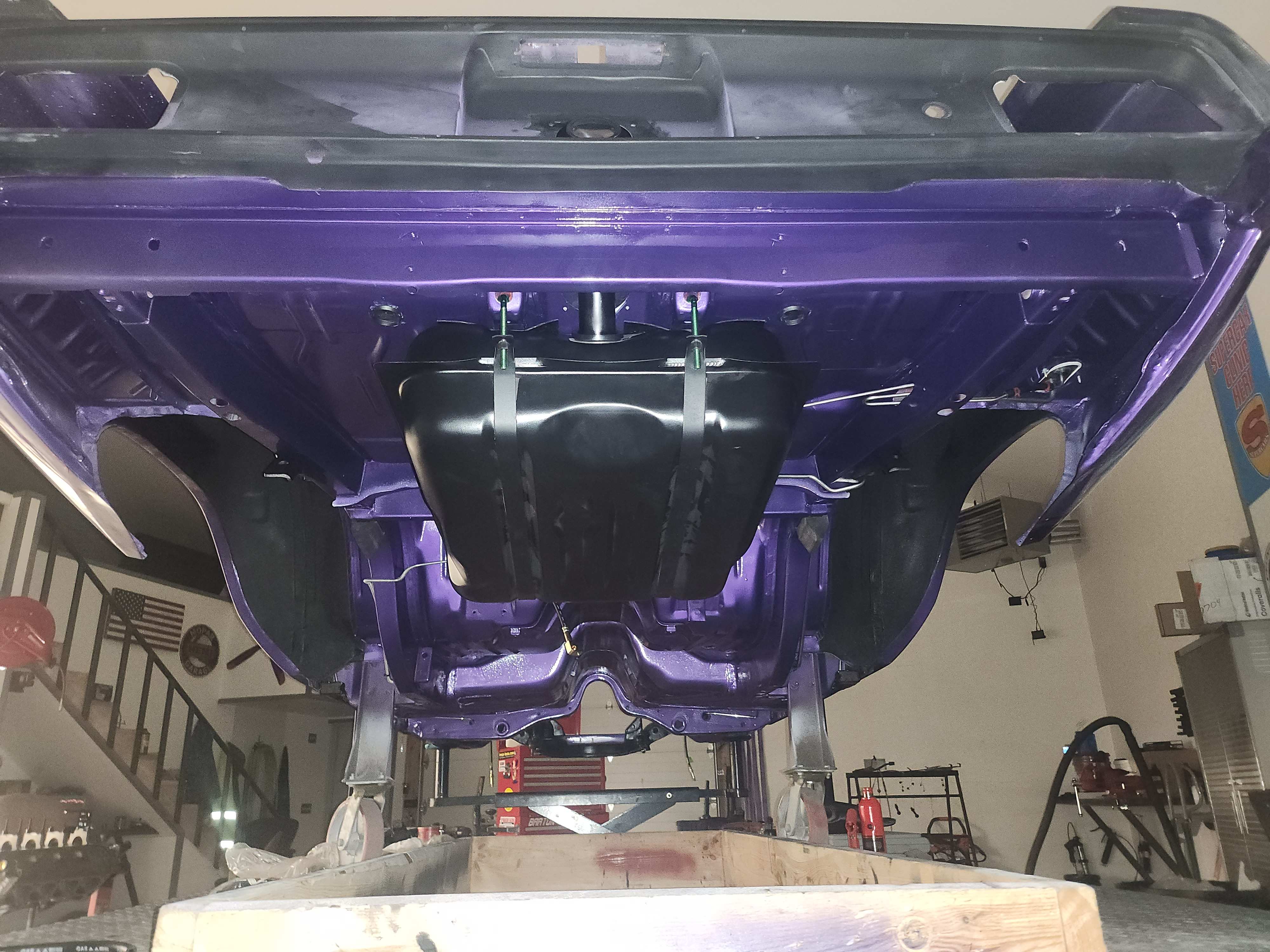

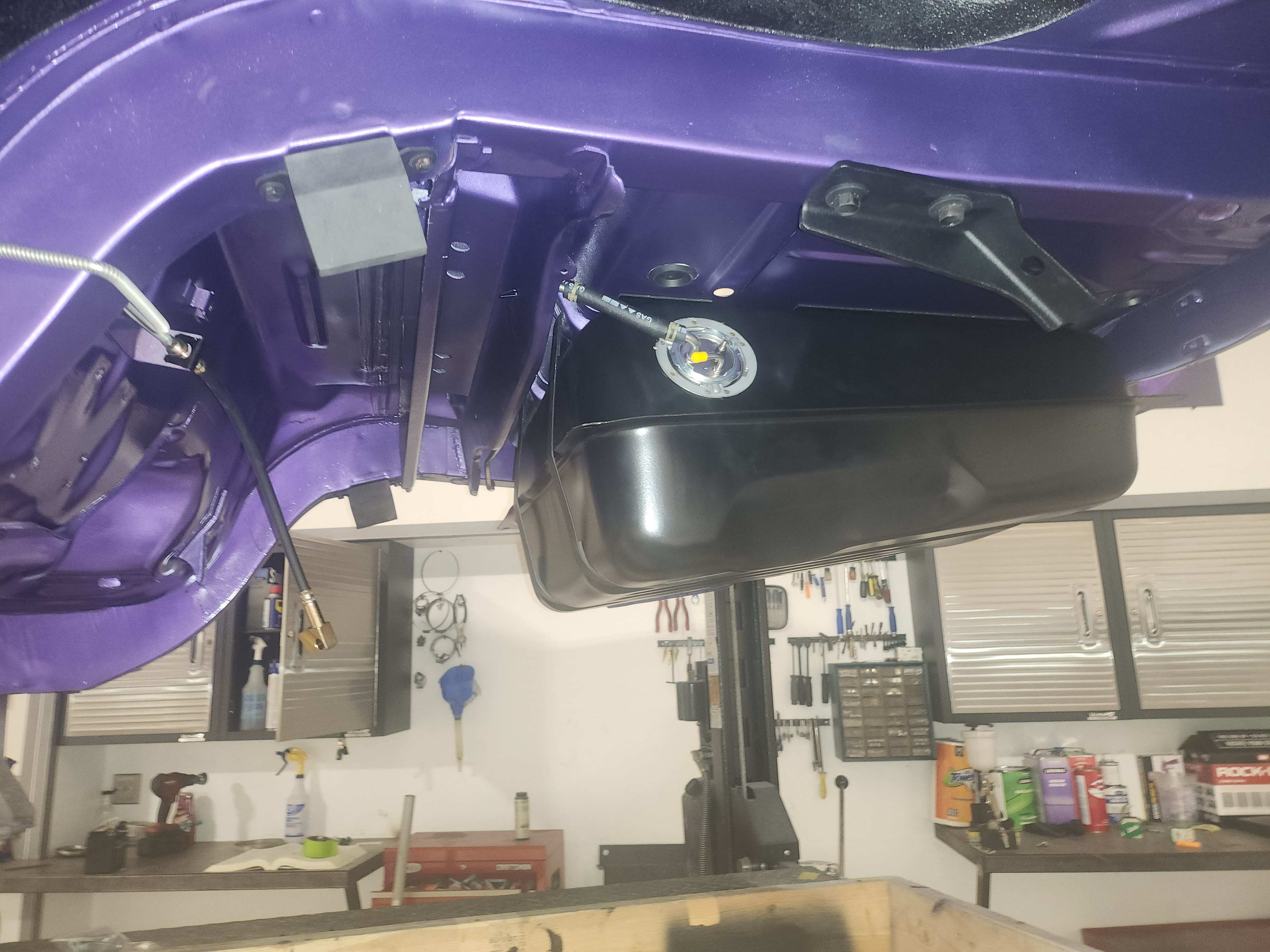

everything else is black, figured it would look good, I think it does, The purple really sets it off or vice versa. I had the original one that was blasted and had a screw in the top of it and for the price and the time, decided to get a new one. Used ceramic chassis paint on it from eastwood same as the rest of the chassis.
