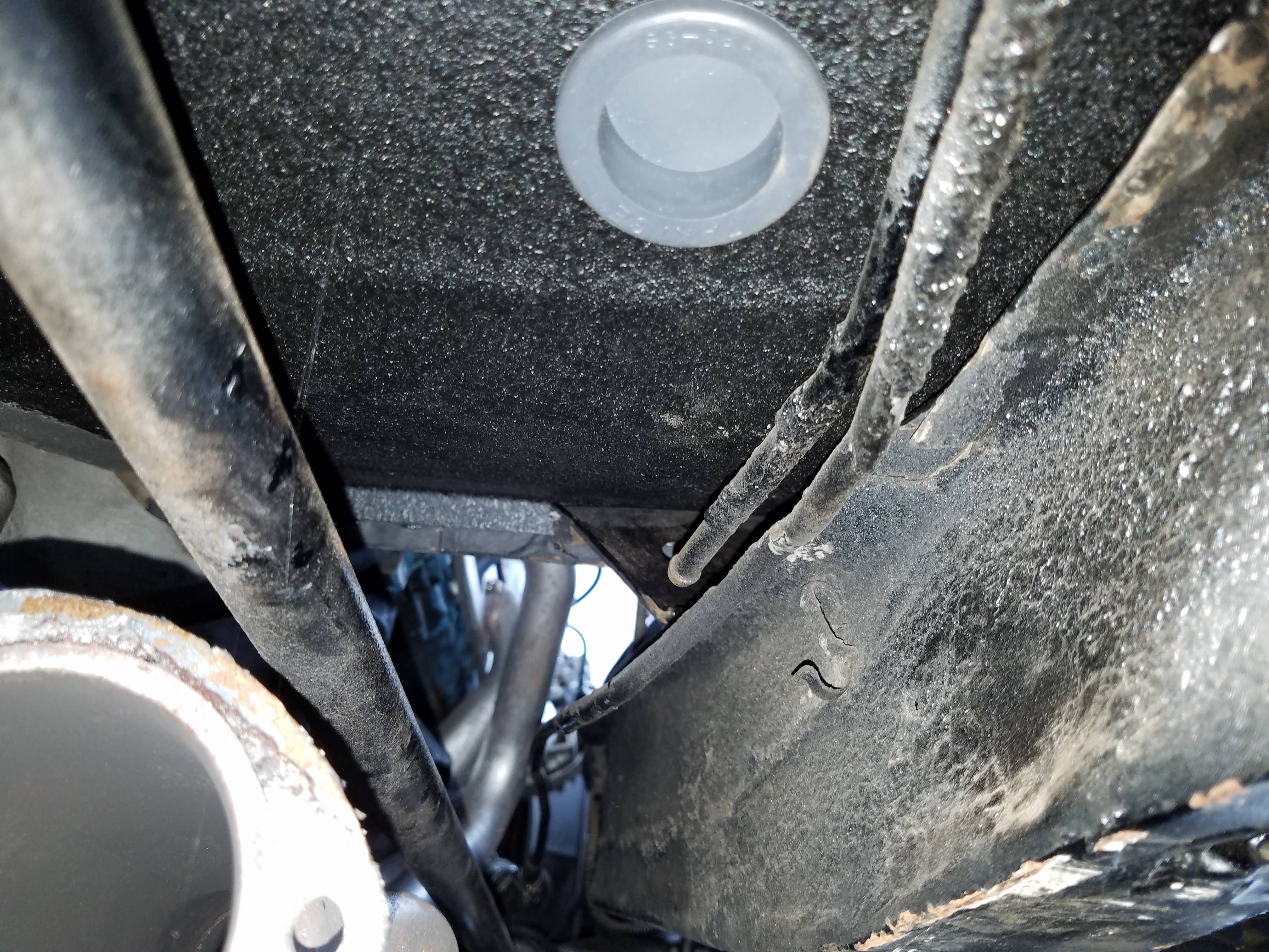

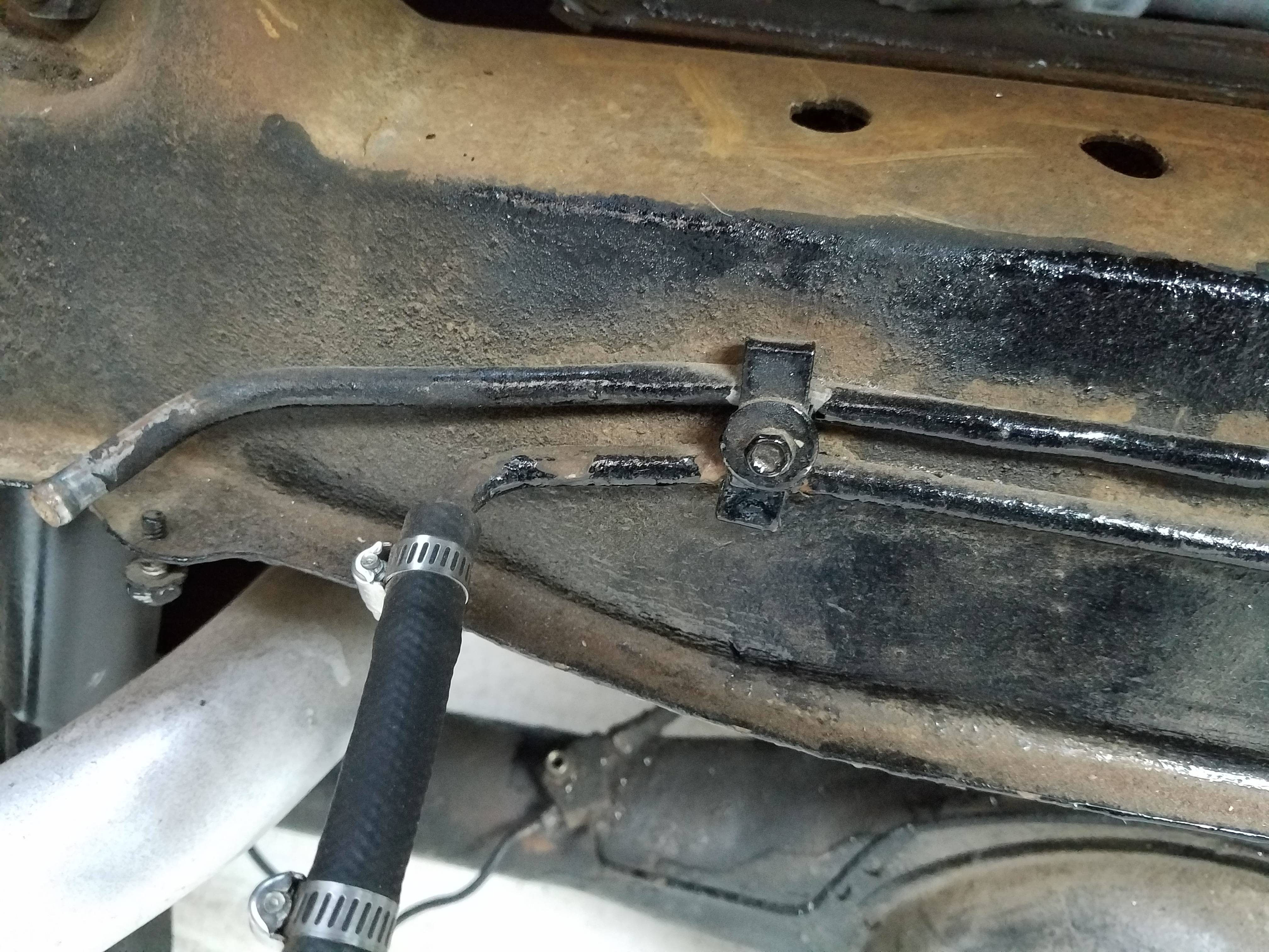

My 70 Challenger has two fuel pipes running through it, one from the fuel tank to the fuel pump and the cab, but the other pipe isn't connected anywhere. I am planning to install a new pipe. Is this pipe unnecessary? Please give me some advice. thank you for reading it until the very end!

on Performance engines they used a special fuel filter with a return line to the tank .
Roseville Moparts will have the correct filter .
