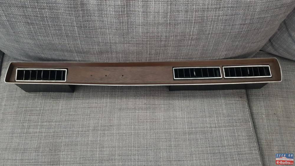

They can sometimes be repaired - what's wrong with yours specifically?I’ll keep looking. I wonder if I can fix them
The controlling louvre is not connected. And some of the fins aren’t eitherThey can sometimes be repaired - what's wrong with yours specifically?

Excellent more optionsHere's a great thread on how to fix them - shown are charger vents but ebody are similar.
Charger Center A/C Dash Vent Resto How-To
Another option would be to find a 71-74 B-Body dash panel with a/c, the vents in the housings are the same as 71-74 e-body.
Ok now how hard is it to get out of dashExcellent more options
I thought so seeing some dash pics. Thanks.I've only ever removed them with the dash out of the car, some have said you can remove them with the dash still in the car but not easy. They screw into the dashpad frame from the inside out.
