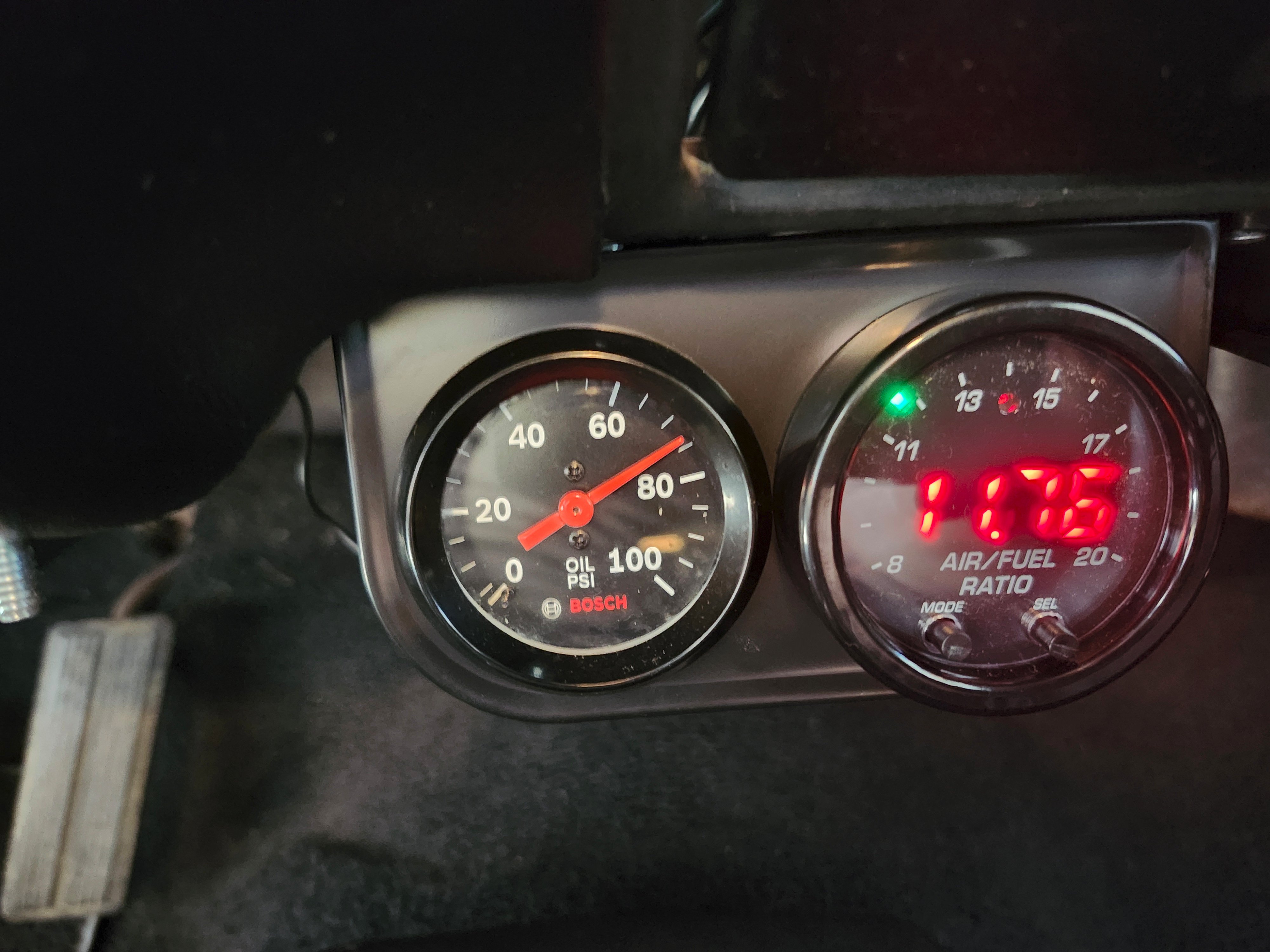

I installed an AFR gauge on my 340. I am dialing in timing, vacuum and AFR before eventual cam swap, so I have a before and after. Car does smell rich at idle and the picture confirms I need to lean out the Edelbrock AVS 625 a bit. I have not gone for a cruise or WOT yet.
I purchased this wideband for $90 and installed, very easy.
Sensor is just below the collector, on top side of pipe to avoid excessive moisture build up.
I do not drag race the car, I did not need recording , so chose a lower cost unit.

Cruising the AFR is 11 to 12.5 with the gauge showing green. I will consult my Edelbrock tuning kit and try to get this to 12-13. I made a few WOT up to 80 mph and gauge stayed between 12 - 15 on both runs. Cuda has decent power and runs well for a stock step, so wasn't expecting to find some hidden power but its nice tge gauge confirmed rich at idle and cruise, much like I expected as you can smell it during cruising and bit of eye watering even with garage doors open
