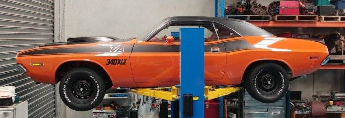

Patience & preparation is the key.
This was my first job

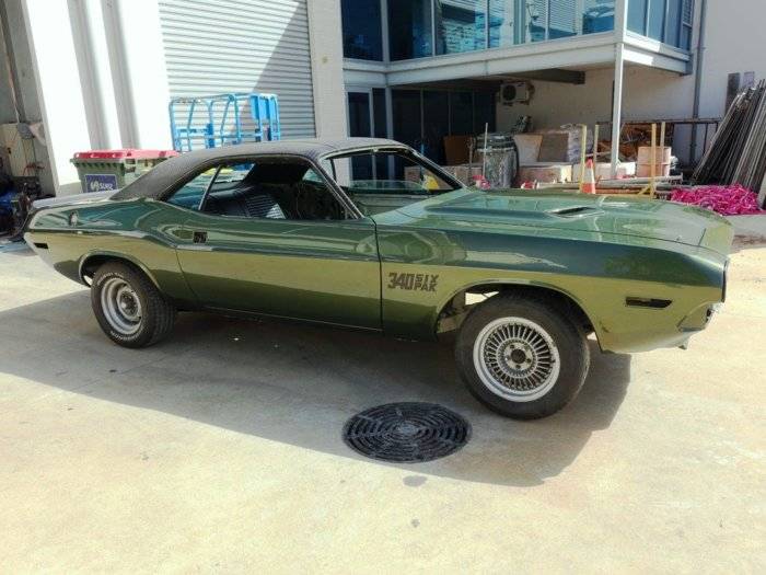

Hardest part Blocking to get a good straight finish the big long panels on these cars require careful blocking the longer the block the better
Patience waiting until each part of the process was finished before going to the next.
Clear coat is a pain, have a bad habit of putting that extra coat on & then it run,s take it easy there is no rush
A mate done this one last week it i did the beating & repair + primer wanted that special finish
F8 Green Metallic from the new Stars & stripes was water based converted to solvent base
