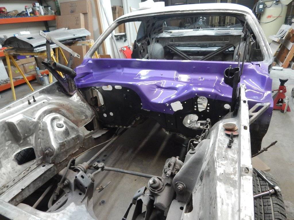

What's left of the old Firewall cobbled up with galvanized sheet metal
New AMD firewall and cowl

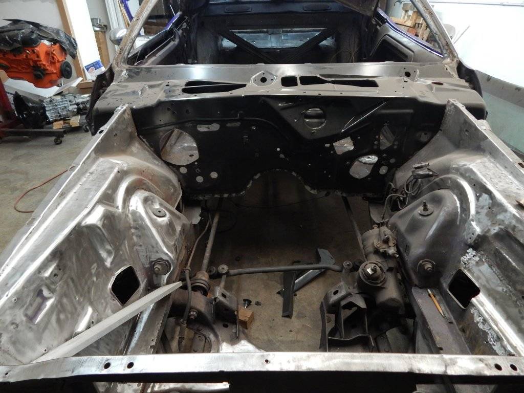

Taking the rest down to bare metal

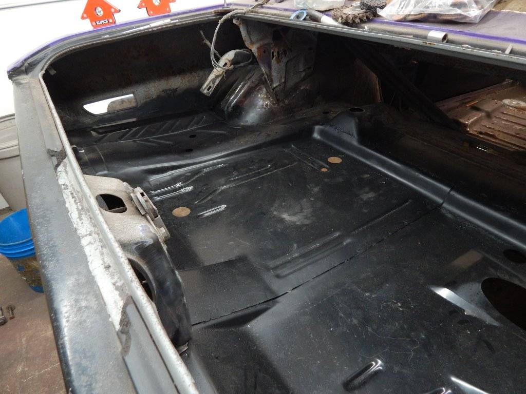

New AMD 2 piece trunk floor and extensions

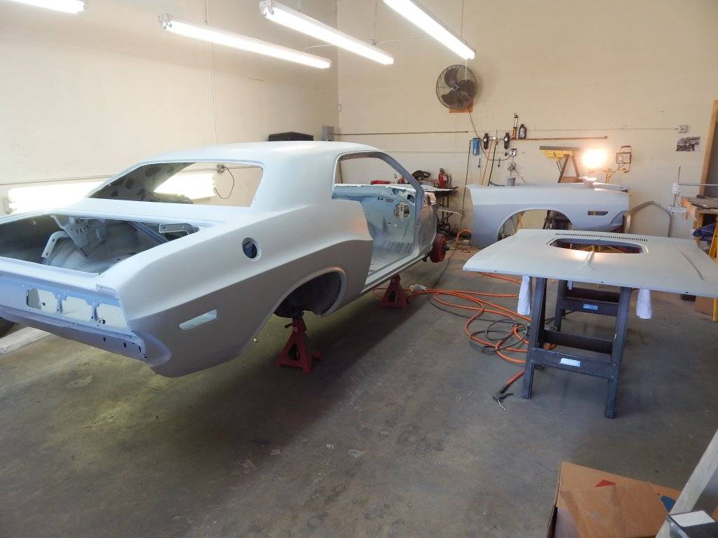

PPG Epoxy primer and primer surfacer

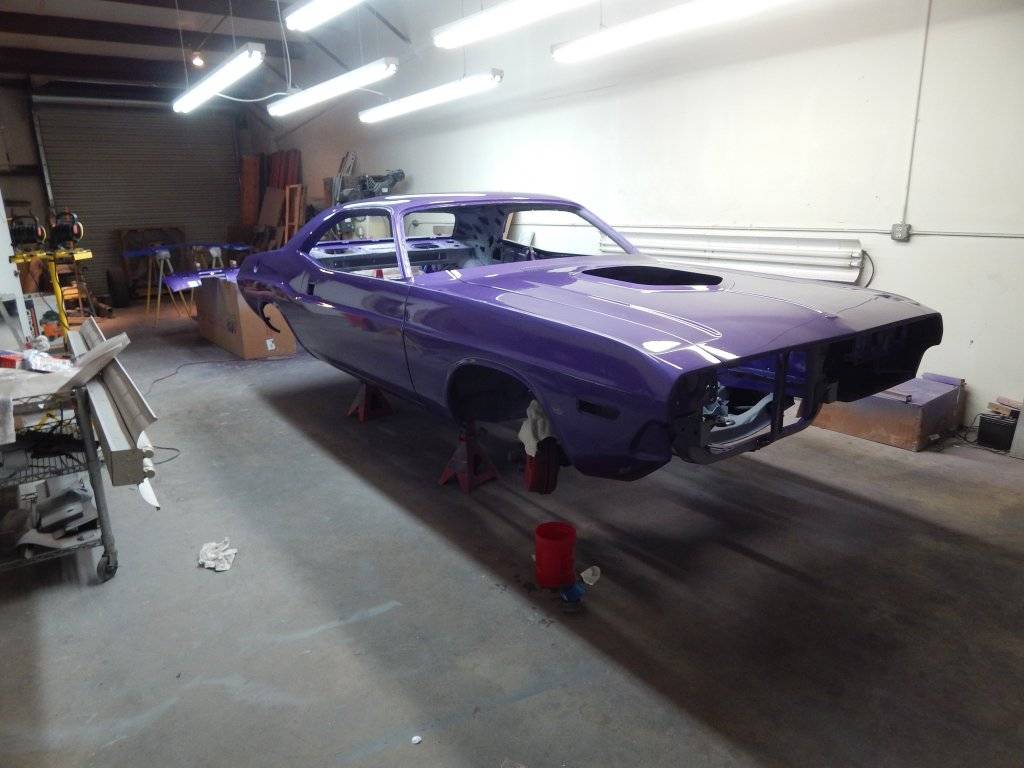

Plumb Crazy base coat/Clear coat
