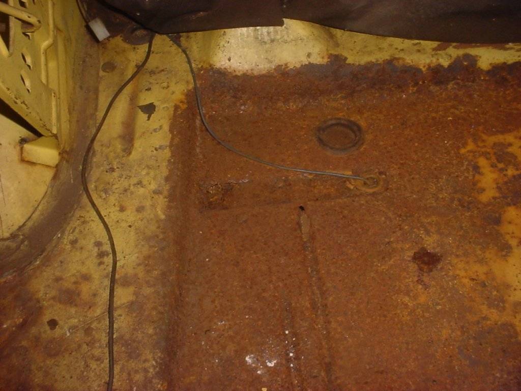

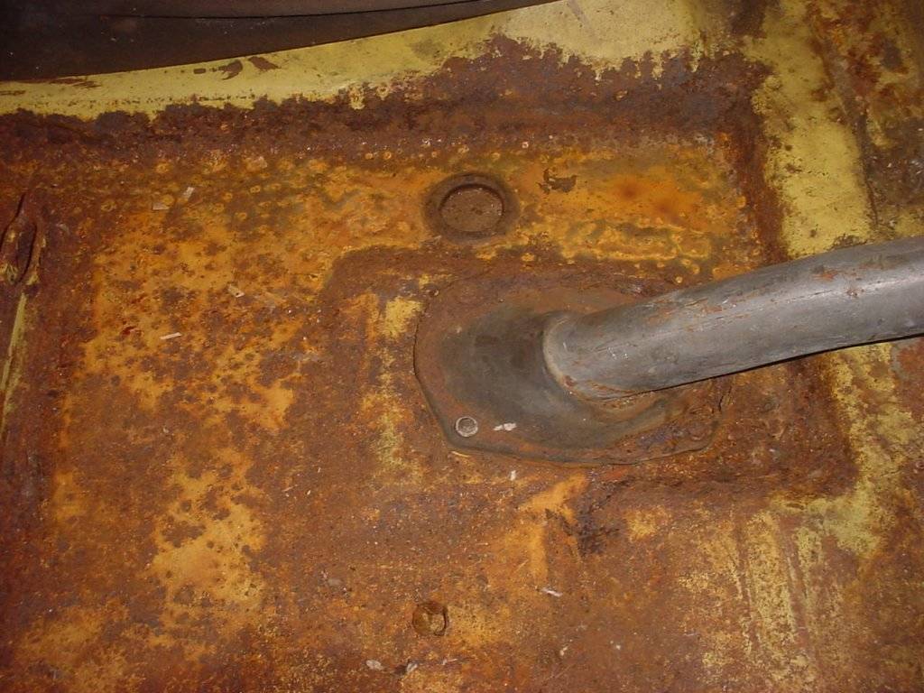

340challconvert
Feb 13, 2011
5,434
2,918
Parsippany, NJ
jimbyr, Appreciate the response.
The trunk is most damaged part of my car.
I liked the way your trunk turned out, based on the two piece floor pan it came out pretty well.
I will be grinding the floor down to metal, and cleaning up the seam areas. Adjacent extensions appear to be solid.
I making a driver out of the car (makes the most sense if I want to actually get to drive it)
I should be able to do the center section similar to what you did.
I was concerned about the fitment of the 1/2 trunk floor panels from AMD.
The general consensus is that there are some quality and fitment issues with the different AMD panels, especially the fenders.
Your feed back was helpful.
Thanks
