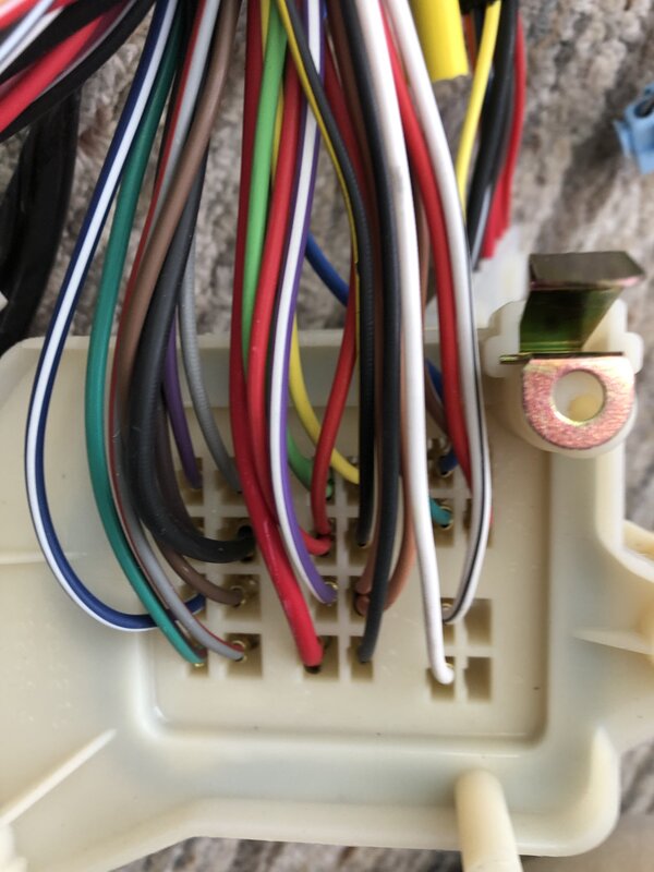

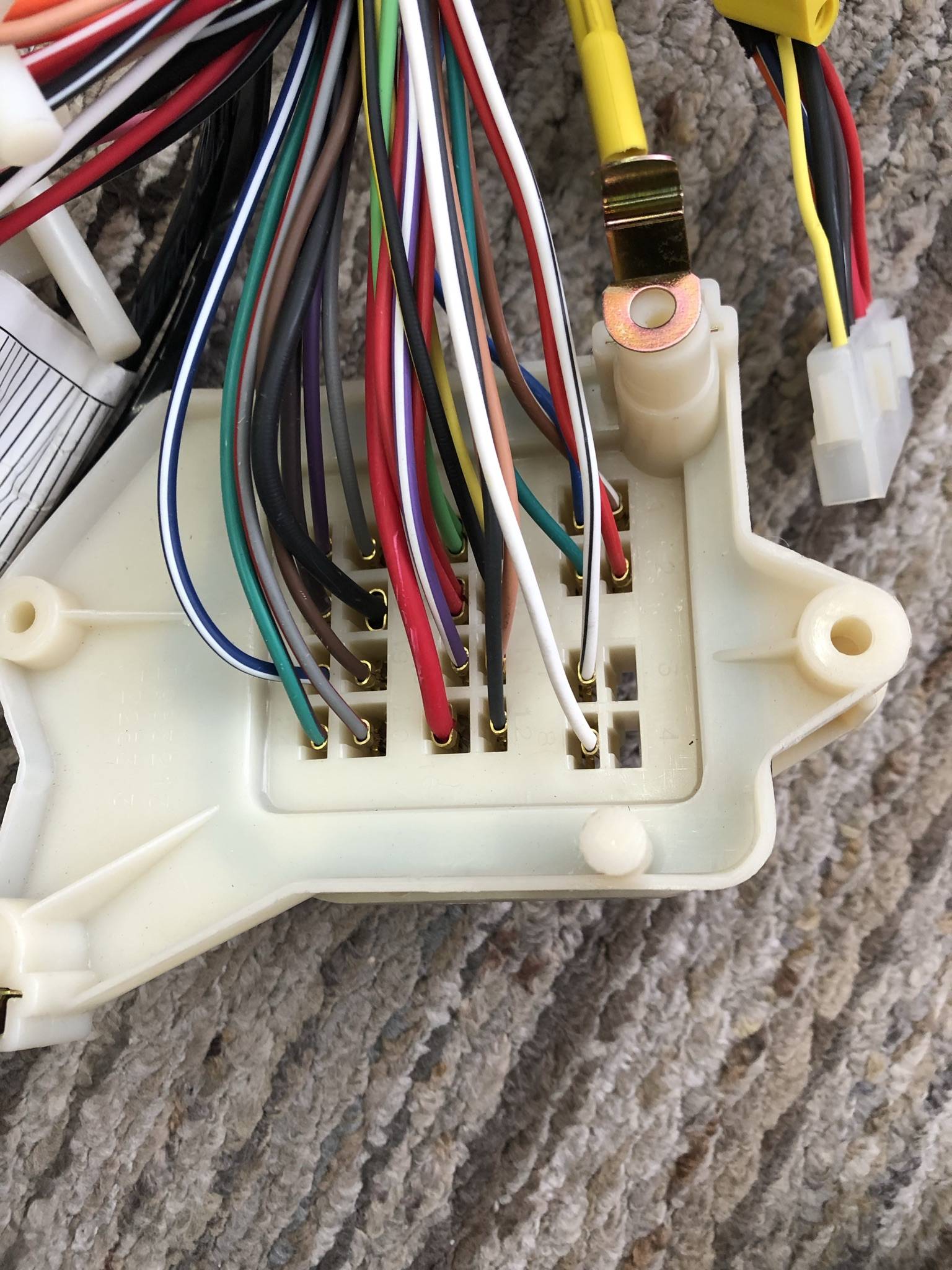

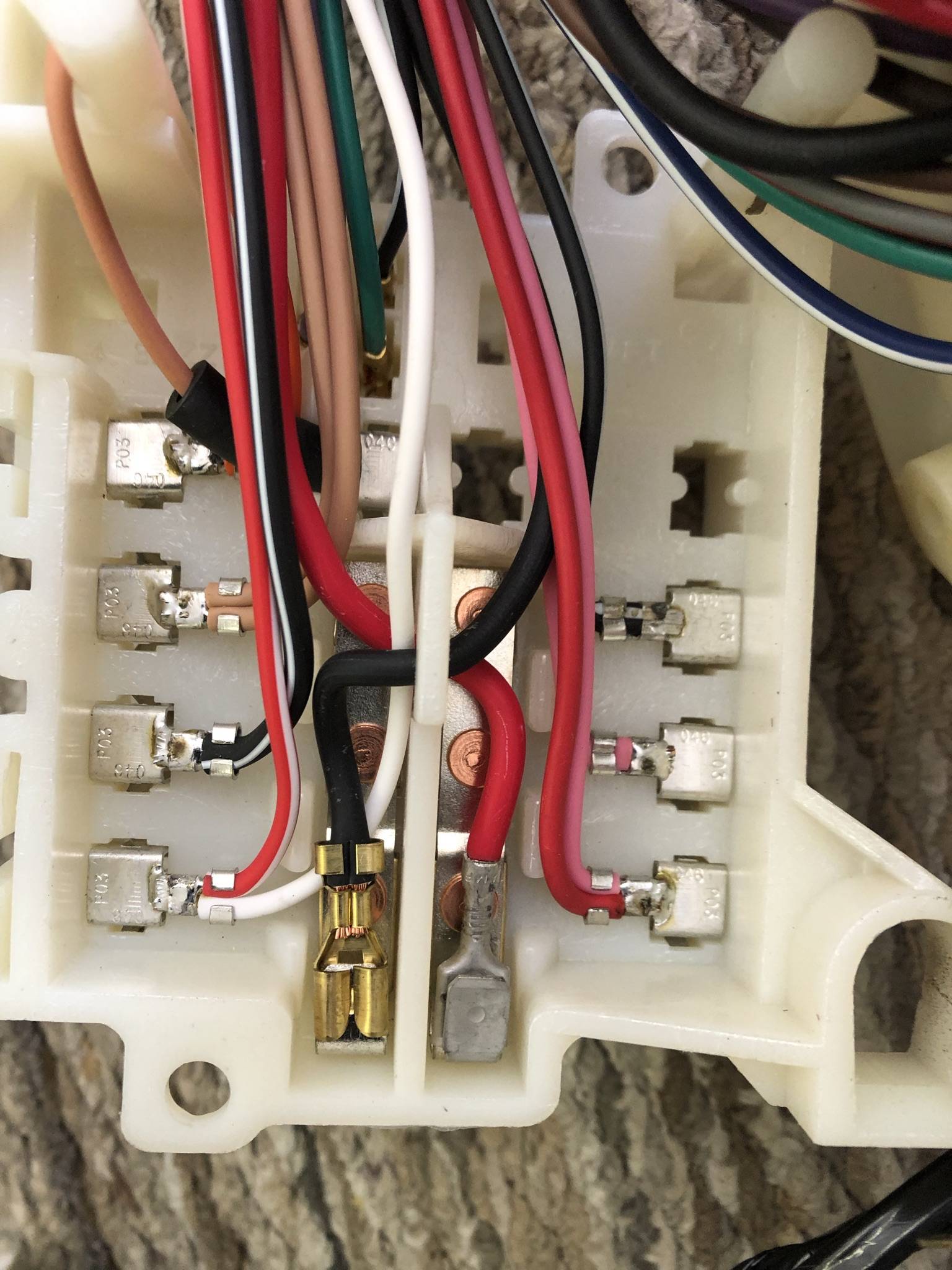

I just installed a new under dash loom in a 70 cuda.
and it doesn’t make any clicking noise when the key is turned on so I took pictures of it, you might want to ck your wiring with this one.
Also installed a new NOS Ignition Switch
How difficult was it to replace the firewall bulkhead connector?
