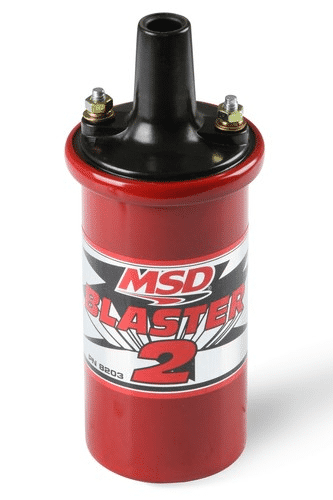

That could be correct. The correct coil has to used with MSD system and vise a versa. I have a MSD coil on mine that is stock electronic ignition. I'll have to find the part number. But that's not a mechanical issue. I would still prime the motor to see the oil flow. It might been seen through the valve cover cap.

Thanks. It's a new motor with no oil leaks or any other fluid leaks I didn't want to start taking off the pan etc unless I'm certain and it's necessary. I'm not the world's best or luckiest mechanic! Only drive the car 2200 miles a year if that. Just realized I may not even drive another two hours plus run again this year.

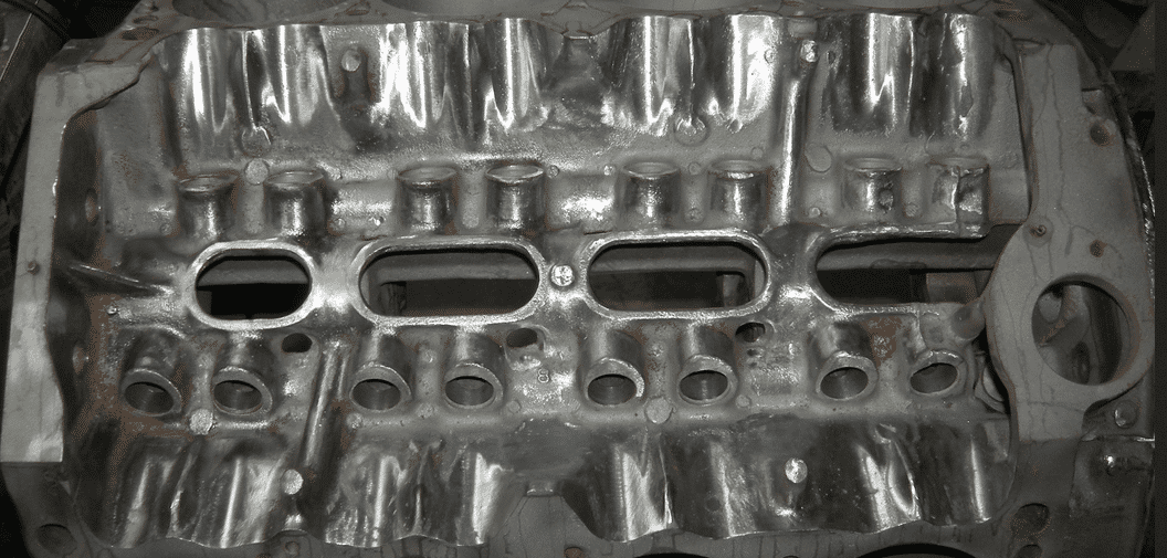

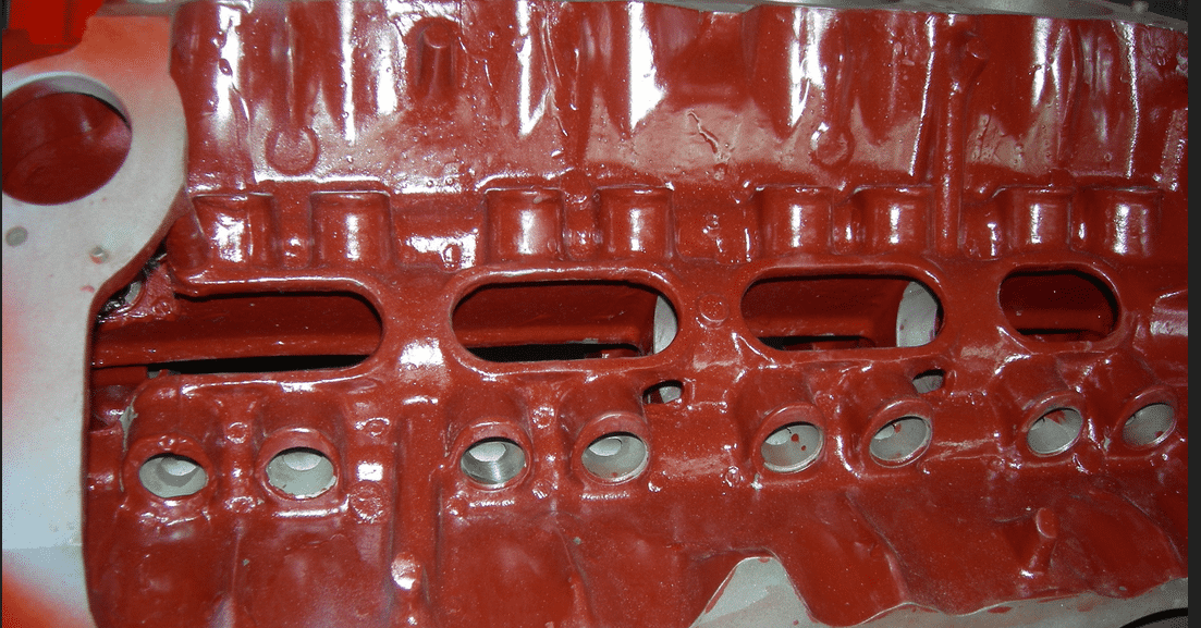

The oil return hole were in enlarged and inside of block ground smooth. Mostly for a quicker return of oil to the pan. This should be done with a high volume pump. I think depends on how it will be driven. I did mine just incase!

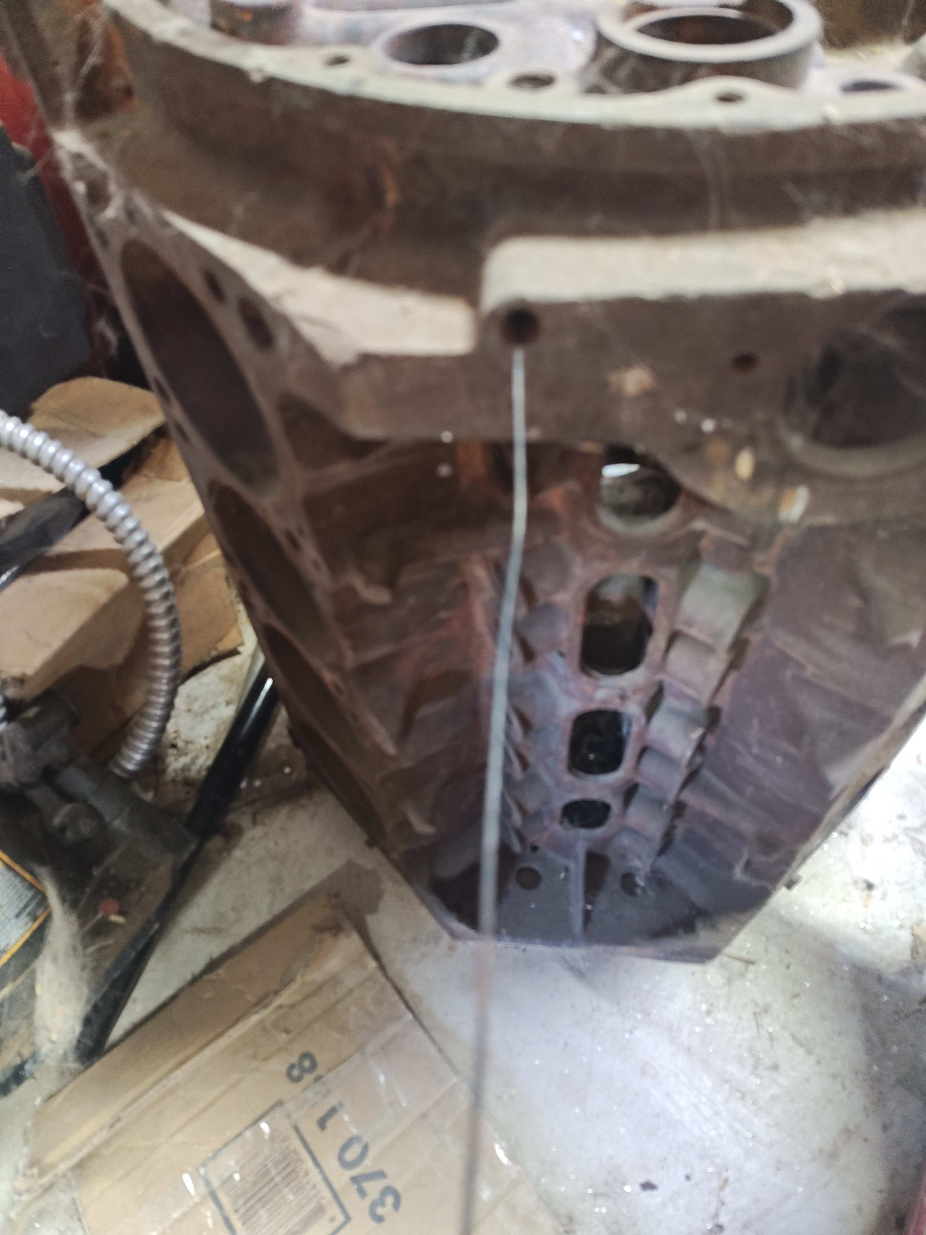

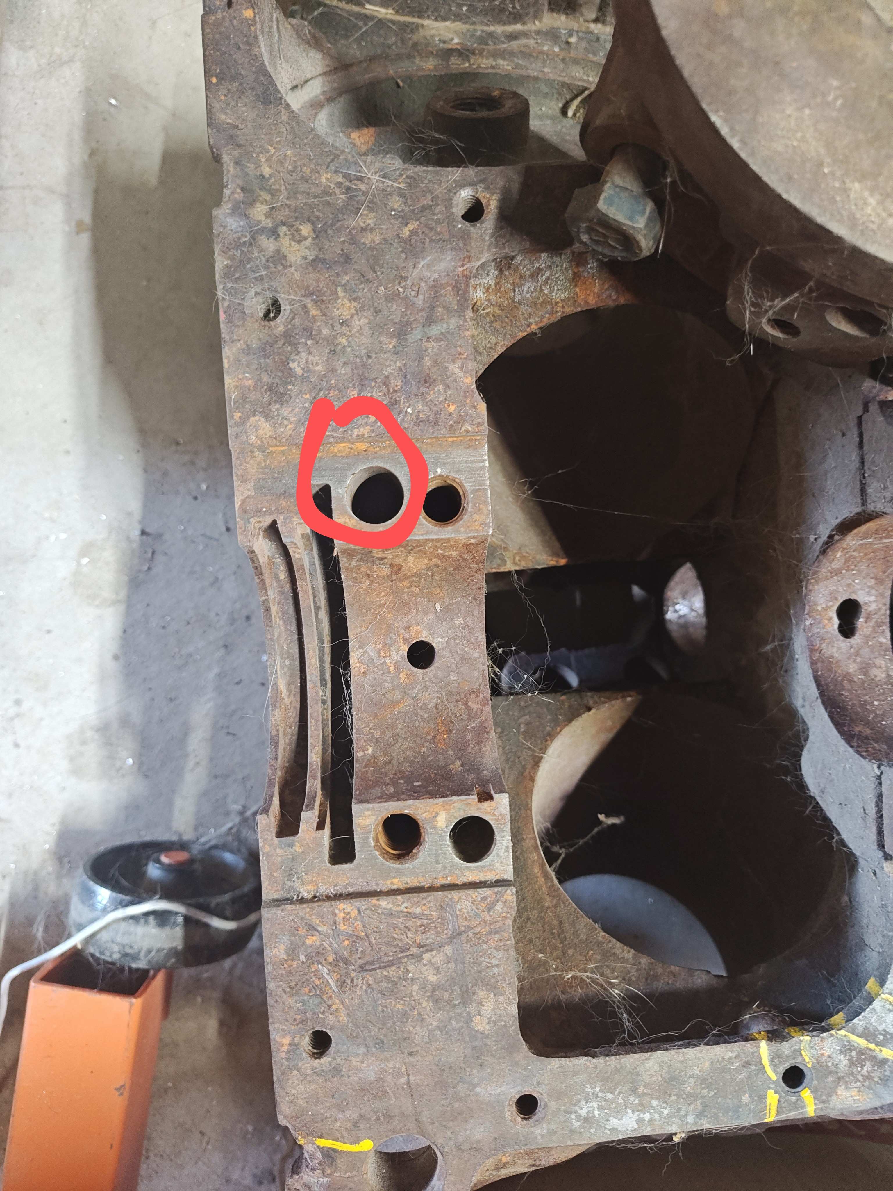

I ran a Chrysler Kit Car circle track asphalt car. I built lots of 340 etc engines and I'm just trying to remember if that plug in the oil gallery diverts the oil through to the filter before it goes on to oil the whole engine, and without the plug the oil can bypass the filter and still go on and oil the engine unfiltered?
Yes, the plug diverts the oil to the filter. Without the plug, the engine still gets oil, but the pressure dynamics change with the filter bypassed.
Also, agree it could be high tolerances between the crankshaft mains and rods. High volume pump might just solve the problem if the plug is indeed in there. When changing the pump, it's just two more bolts to remove the rear main and check if the plug is there or not. My issue with high volume pumps is pumping the pan dry. Not a big issue on big blocks because we can run a 6 quart pan instead of the more common 4 quart. Stock small block oil pans all have the same capacity be they 360 or 273/318/340. An oil accumulator would definitely be a good idea!

This is a new 408 stroker motor, (not a rebuilt) with just over 2000 miles. Unfortunately I don't have a hoist readily available at my disposal. Also I'm a novice at best. Is there any methodology to determine the issue without removing the pan? When the engine starts from cold it runs at 55 psi @ 1200 rpm. It runs fine around town and stays around 25 - 30 psi at warm idle. I've been told that 10 psi per 1000 rpm is acceptable. Sometimes there is some vibration that can be felt thru the pistol grip.

If I remember right the hole that the oil sending unit lives in is a the top of that rear oil gallery and if you put a clean rod in there to see how far down it goes it would tell you if the plug is in or not?

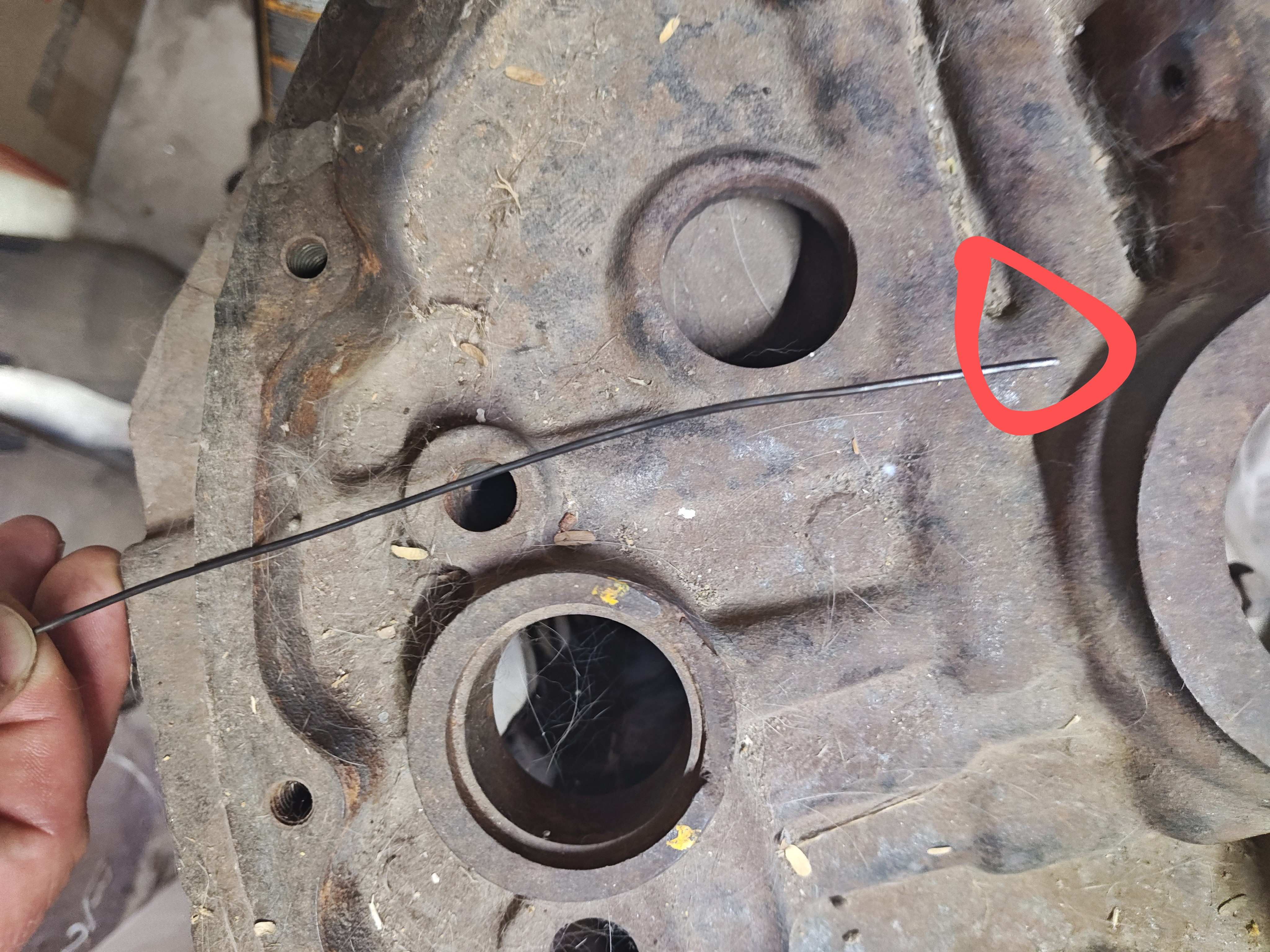

OK, I went out to the barn and drug out a bare 340 block. Please ignore the cat hair on everything! It's much better that mice and rat crap! Assuming you can remove the oil pressure sending unit next to the distributor, you can take a piece of wire and run down the hole. It should hit the plug at ~7 1/2" from the block top surface. If it goes in 8" or more, odds are the plug is missing. See photos below. First photo is were to insert the wire. Second photo: I put a read circle with the wire at where the plug is located and in the last photo I circled the hole below the rear main cap where the plug is installed.
