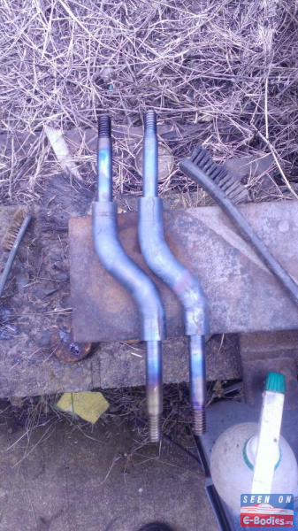

Making up some offest links is another option. Not mine, but would be a clean solution if you are handy.

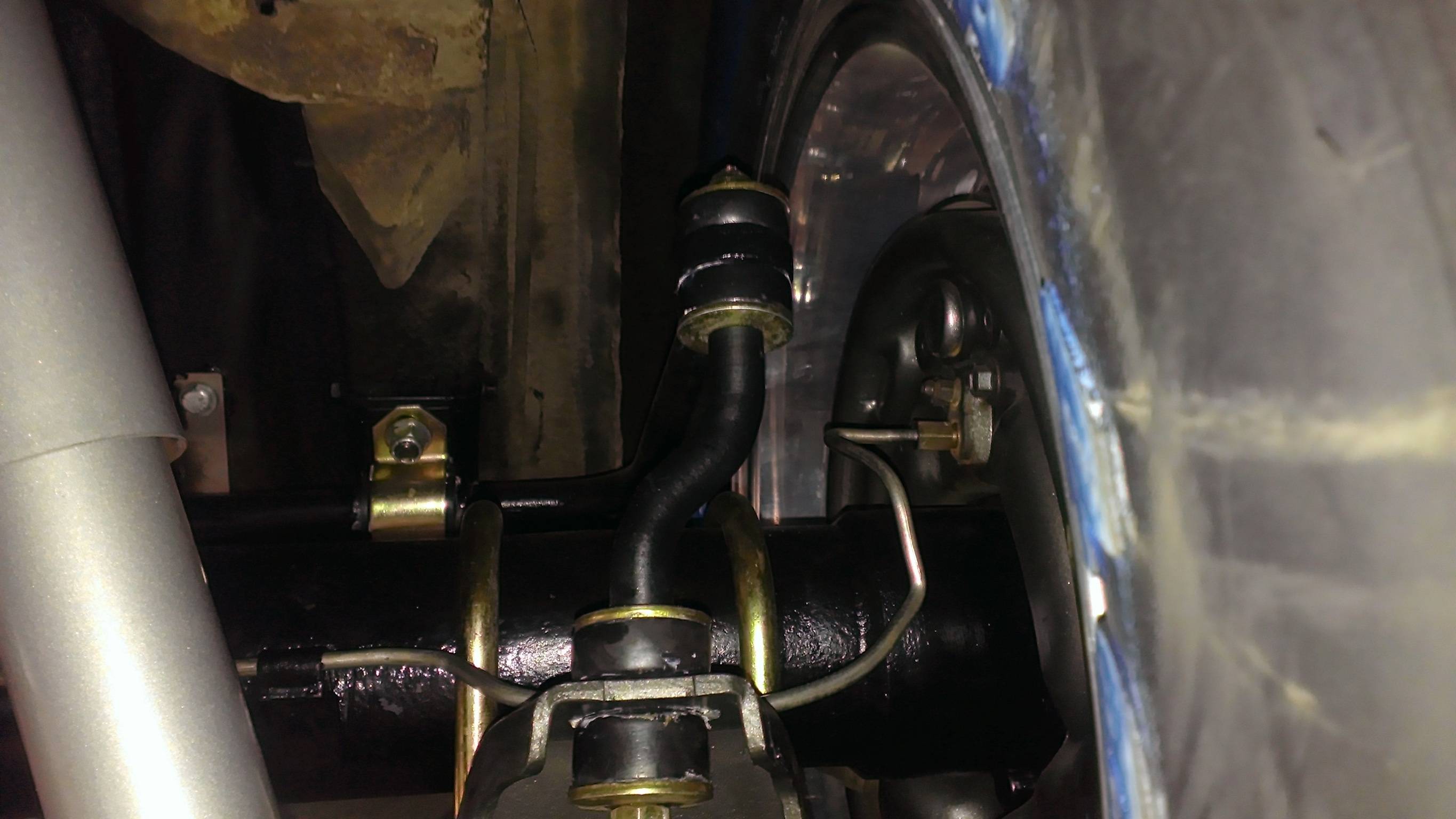

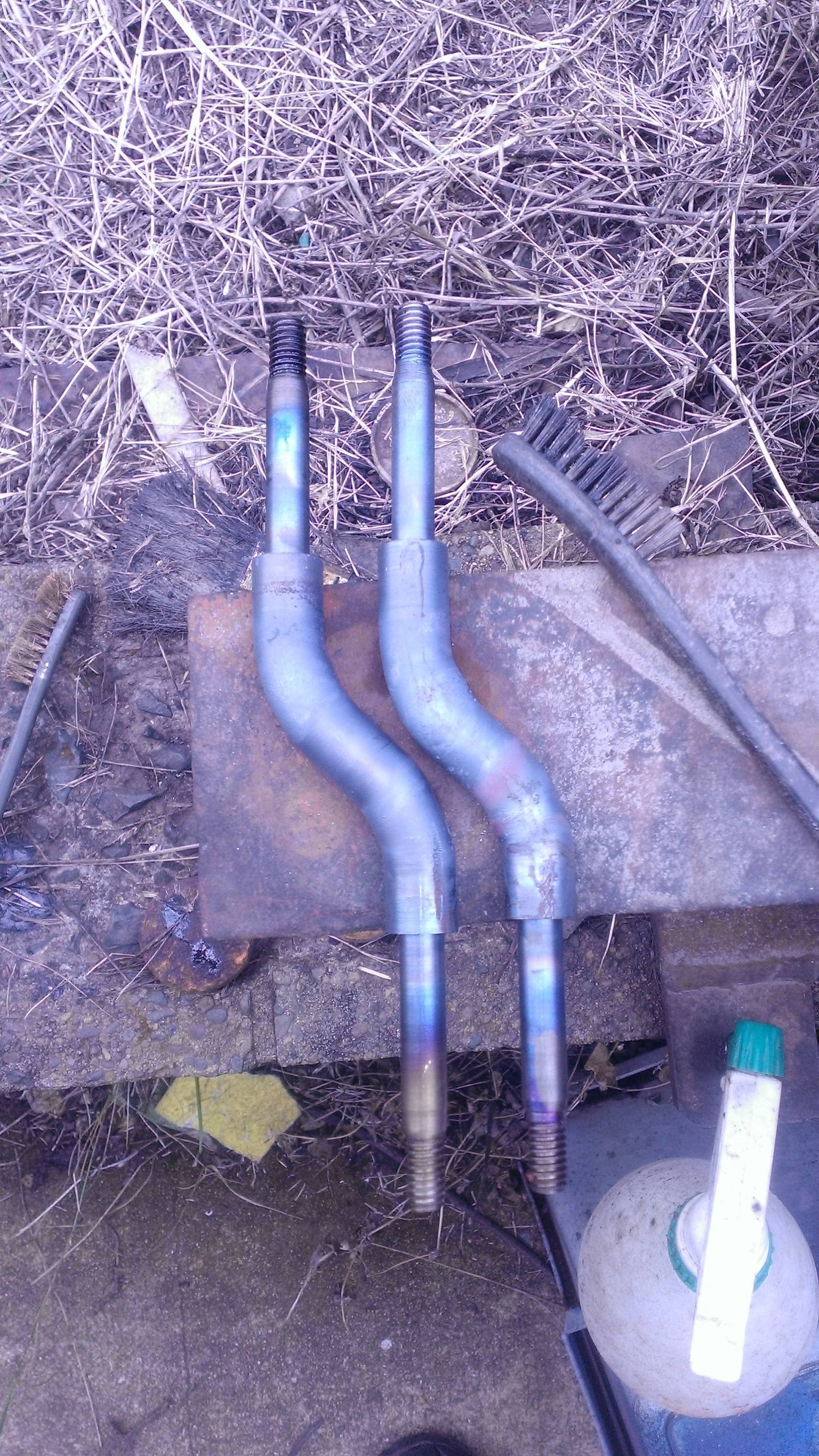

I made these up, really easy to do and work perfectly

Those are nice, and it looks like they will pretty much center themselves where they need to be! :thumbsup:
Yes mate they do that exactly, fortunately I have a lathe so very easy to make then just heated them up and offset them 1” good to go
