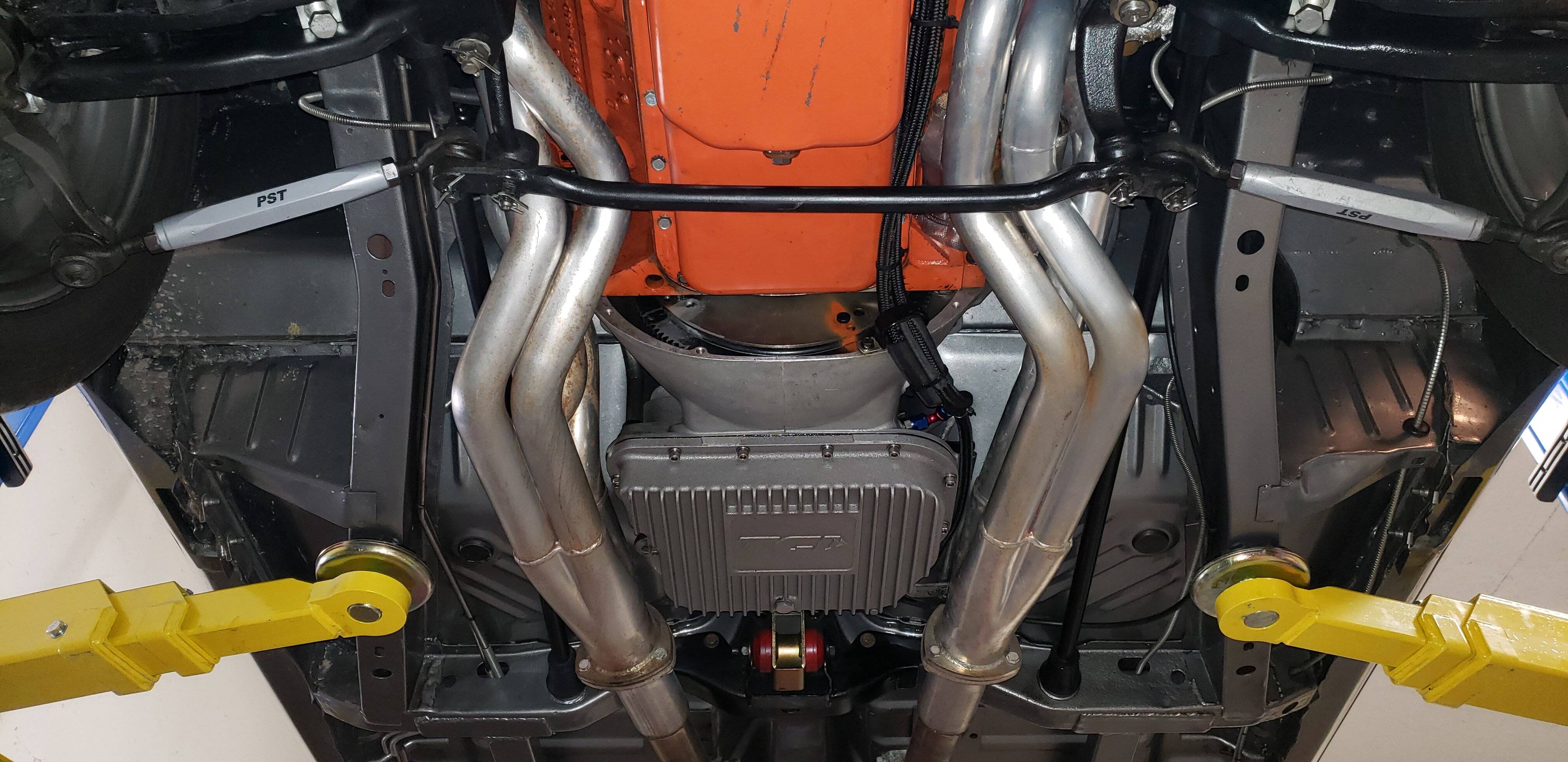

My car has the Pypes system on it. Its got the 1 7/8 TTI headers. Fits really well and sounds pretty good too.
