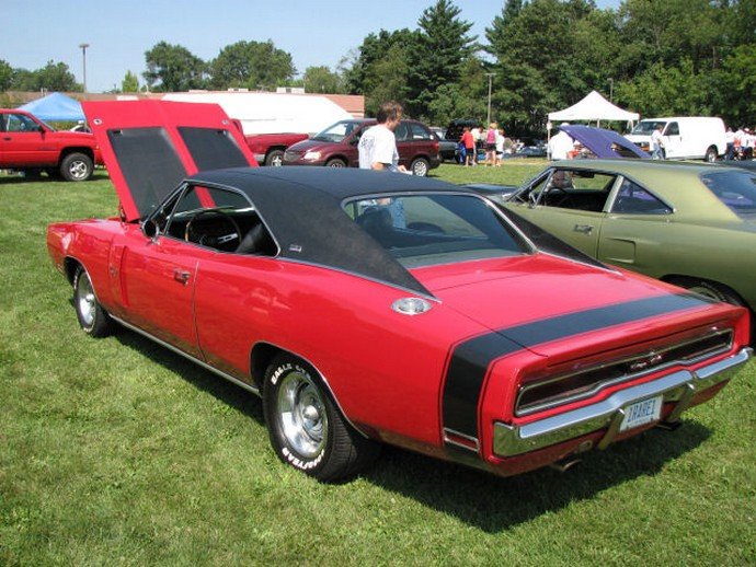

I bought an AMD front bumper 10yrs ago, fit good and still looks great.
This was when you could get them for $300, shipping included.

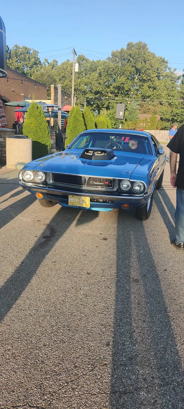

Im thinking they're stamping the new repos to the 73-73 shape and selling as 70-72 because the one I tried from AMD is shaped same as my factory 73. I am now using a late 71 produced (June/July?) bumper, has the latest revision of corner squares but has the first pre run of jack slots. And I mounted it on the factory 73 brackets that were slid back on the frames. Only a slight grind/touch on the top curve to flatten it was required to get them exact. Confusing. I mean there were 4 revisions in 1971!

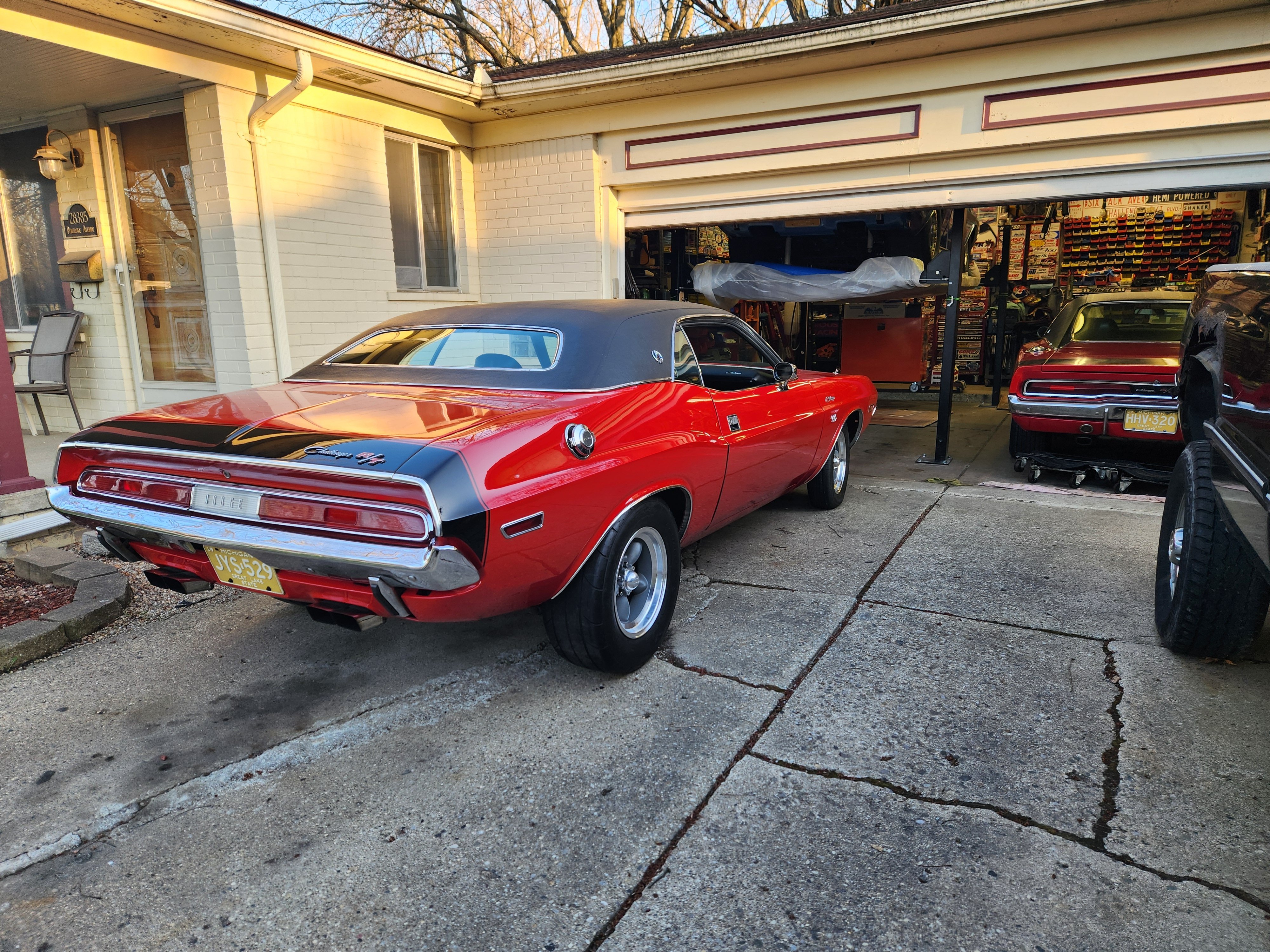

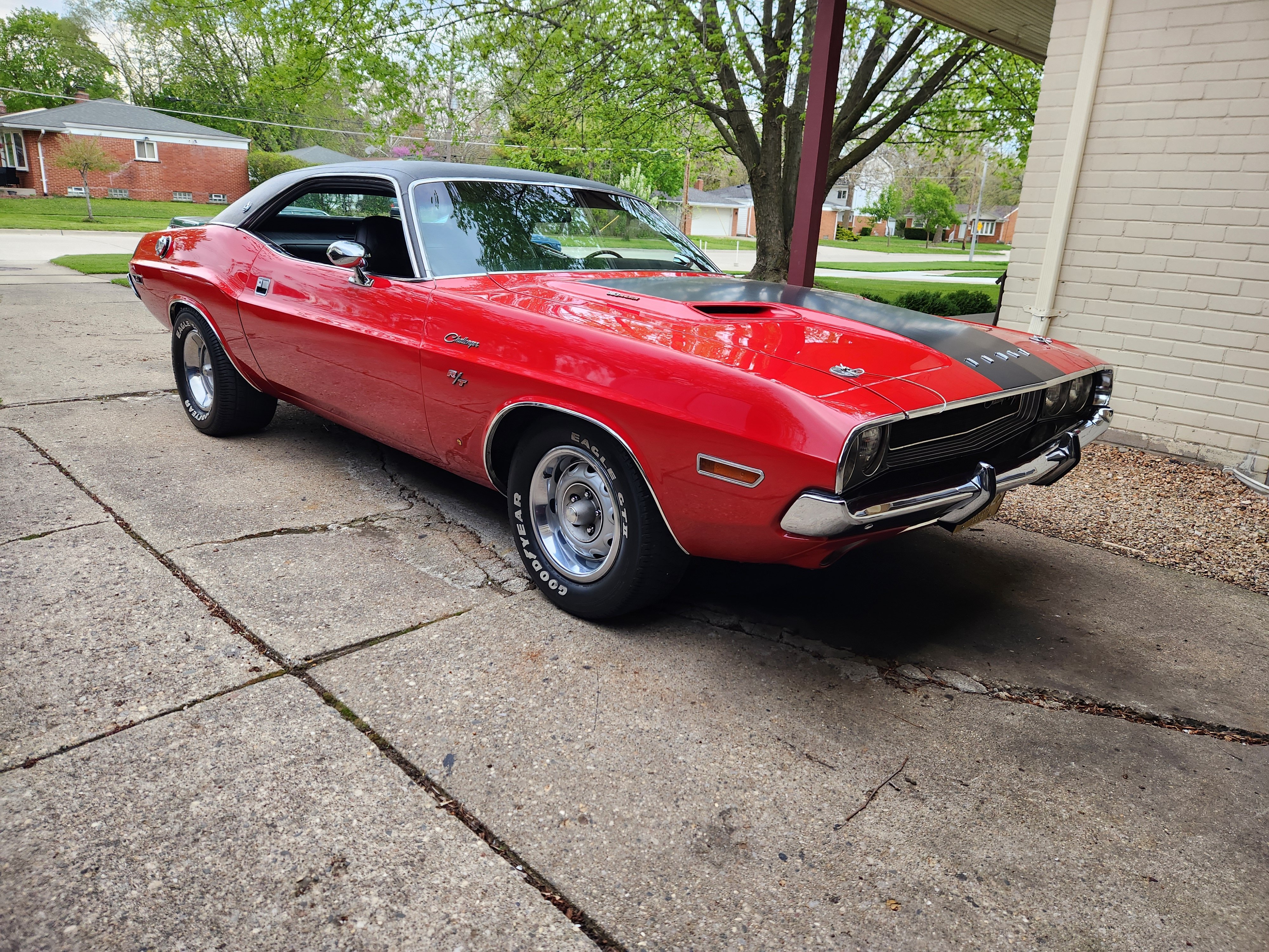

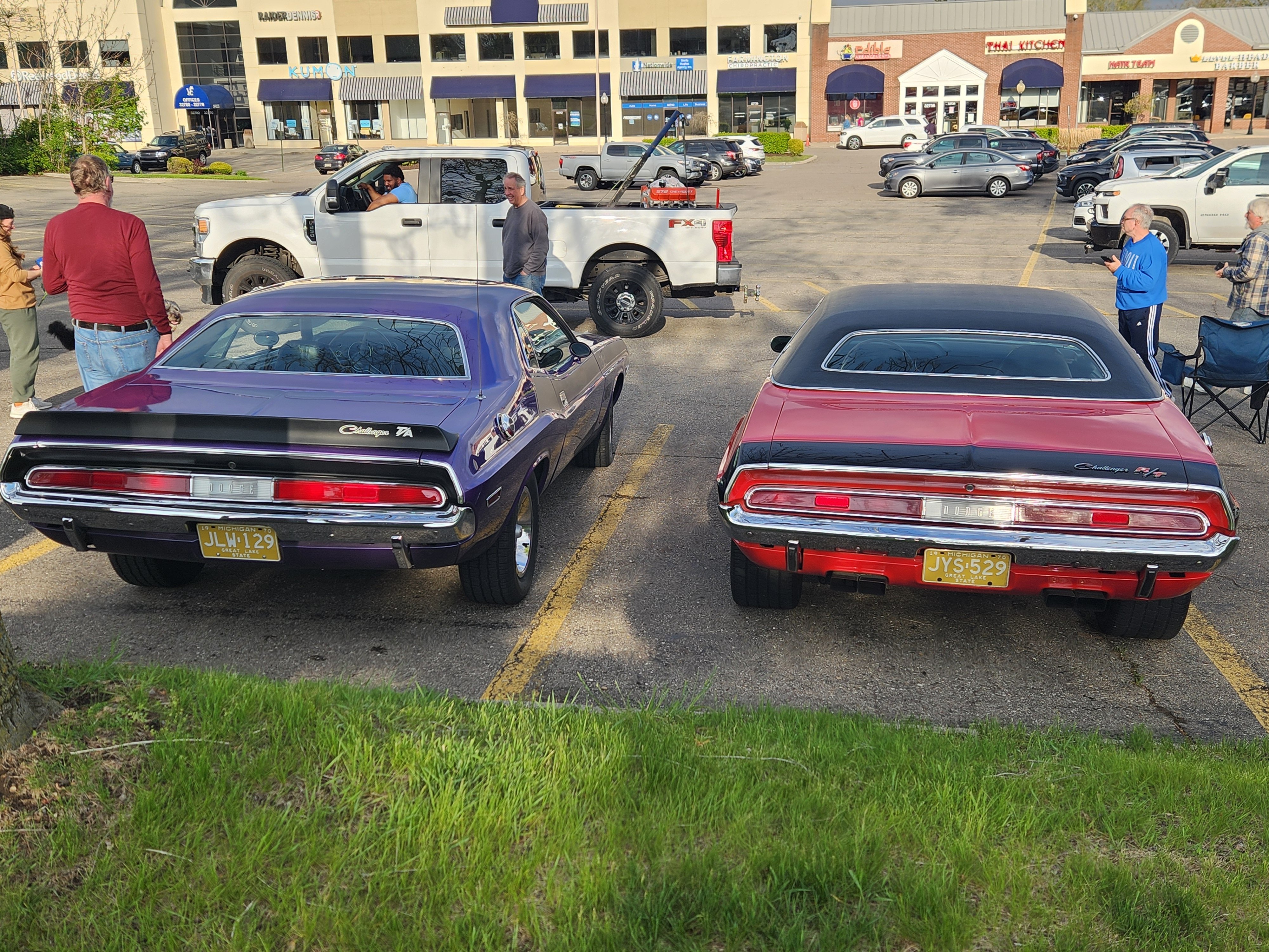

Both of my 70's are AMD replacements front and rear and are over 10 years old also. Fit and finish was good. The bumperettes even followed the contours nicely on the fronts of the red car and on both of the rear bumpers on both cars.
