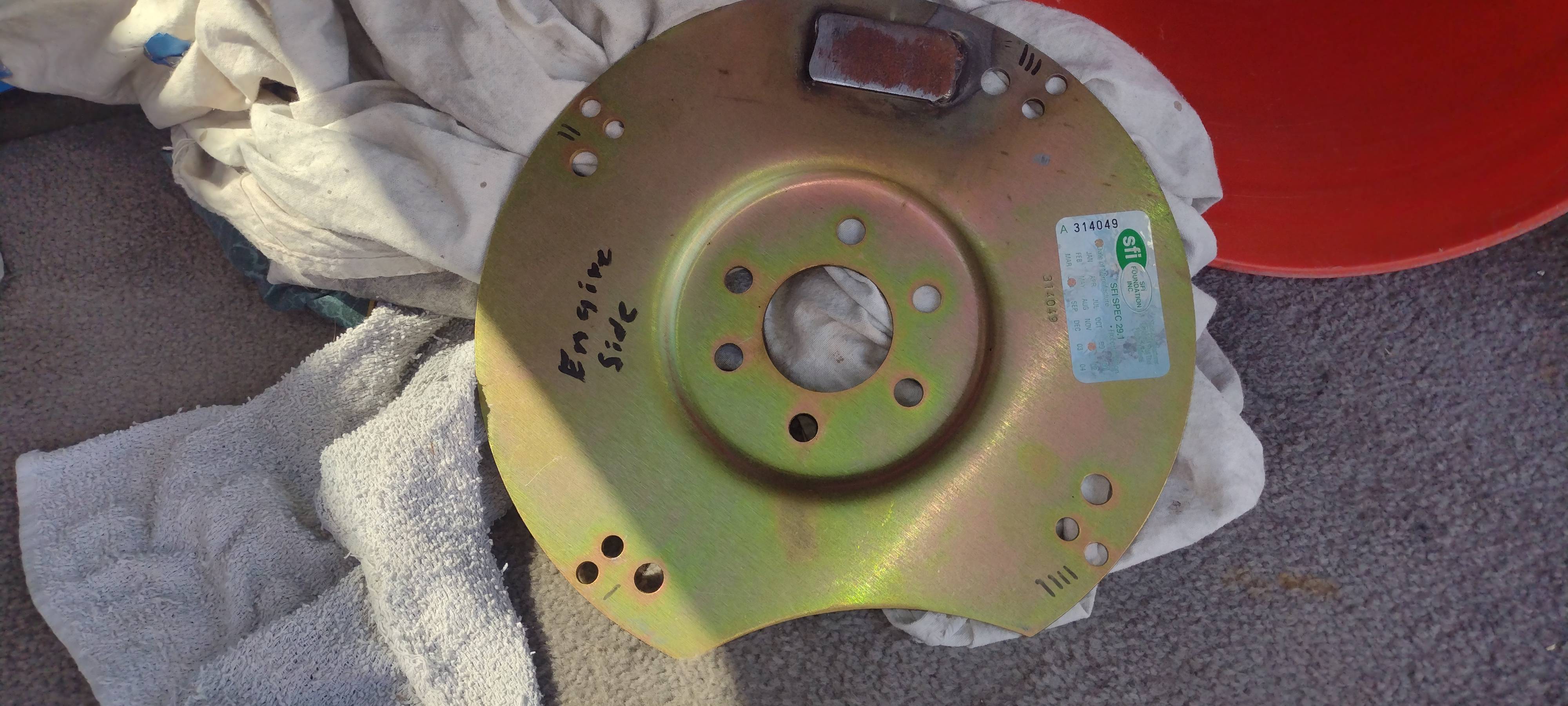

Looking for some advice here. I purchased this flex-plate many years ago for my engine (426 wedge, 440 cast crank, 6-bolts, damper number 3577785 [USE WITH 440 CAST CRANK ONLY], externally balanced, no weights on the converter. Should I grind of the weight welded onto the flex-plate, or leave it? I have no idea.
Thanks

Looks modified as a custom balance for 1 particular engine , the B&M plates are not delivered new like this

OK. That makes perfect sense to me. Please allow me to phase the question another way. Consider the specs I mentioned, if I were to purchase the identical plate, would I have to add any weights to it, or could I install it right out the box?

Hard to know , did the engine vibrate with that flex plate before ?
You have a unique combo with a 426 W & cast 440 crank so the pistons should be lighter than 440 & you could have LY or 6 pack rods in there which will affect balance also .
If the engine was balanced with that plate when built it needs it .
Why do you want to replace it ?

The engine came with a stock flexplate. I wanted to upgrade so I got this one. I went to the B&M website where I found about 12 others who asked the same question. Based on the specs of my engine and torque converter, I discovered that I can use this flexplate. I just have to grind the weight off, which I did today. Also, the original plate and converter did not have any weights added so I should be good to go.
Chryco, thanks much for you assistance.
