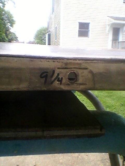

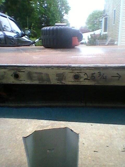

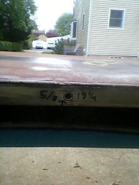

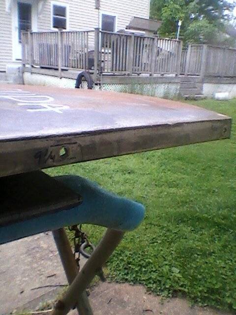

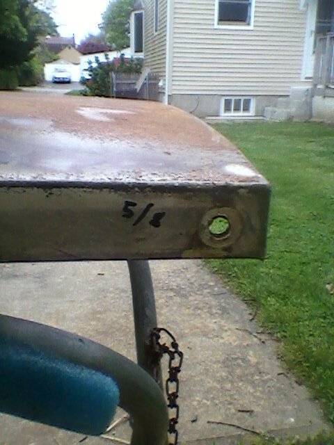

There are 8 holes in the trunk lid for the molding. From either side the first hole is 5/8 inch from edge to the center of the hole. 2nd hole 9 1/4 inch to center, 3rd hole 18 1/4 inch to center and 4th 25 3/4 inch to center.
From the bottom of the lip of the trunk to the center of the hole is 5/8.
The hole itself is 1/4 in
