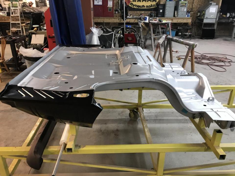

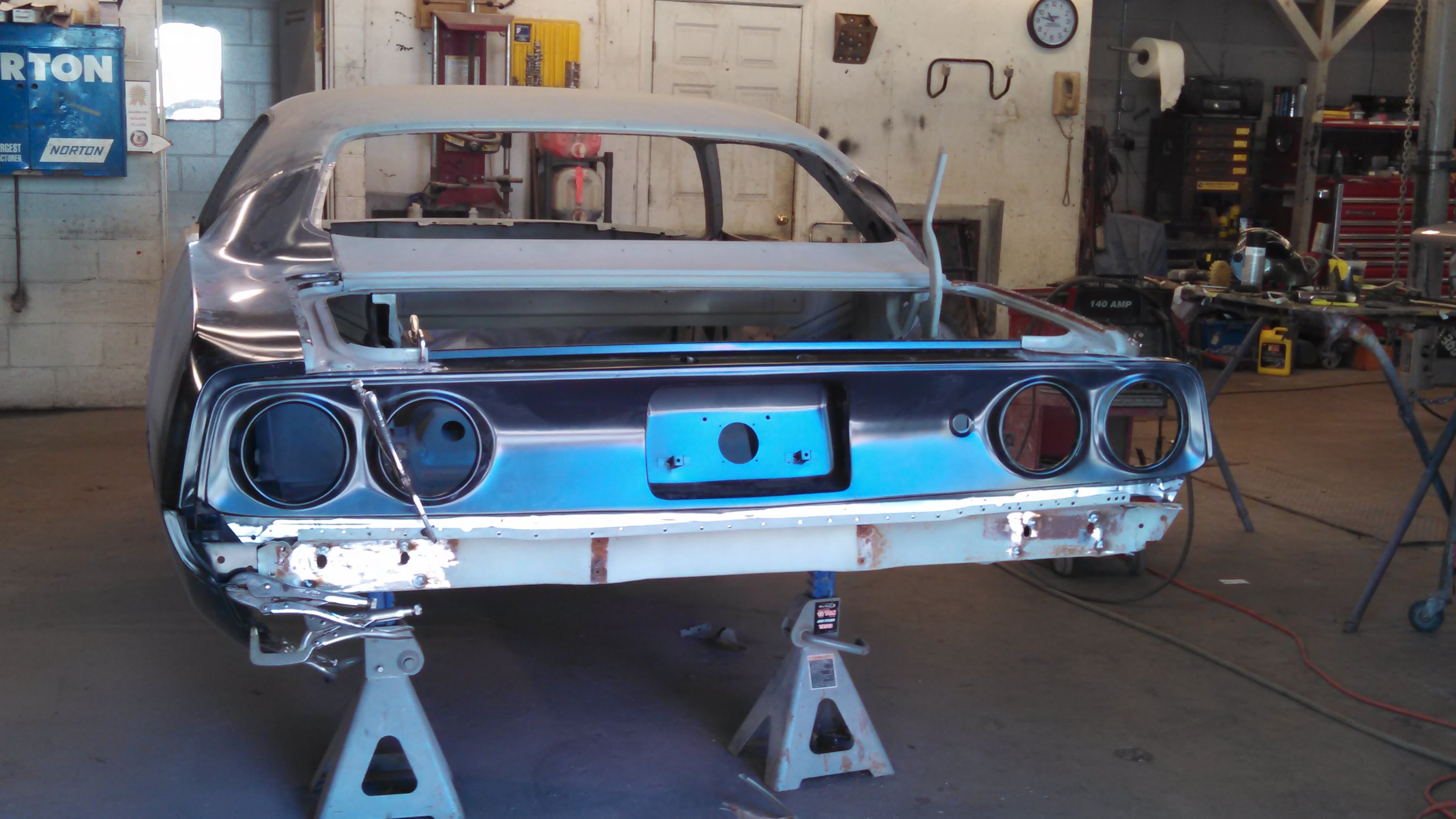

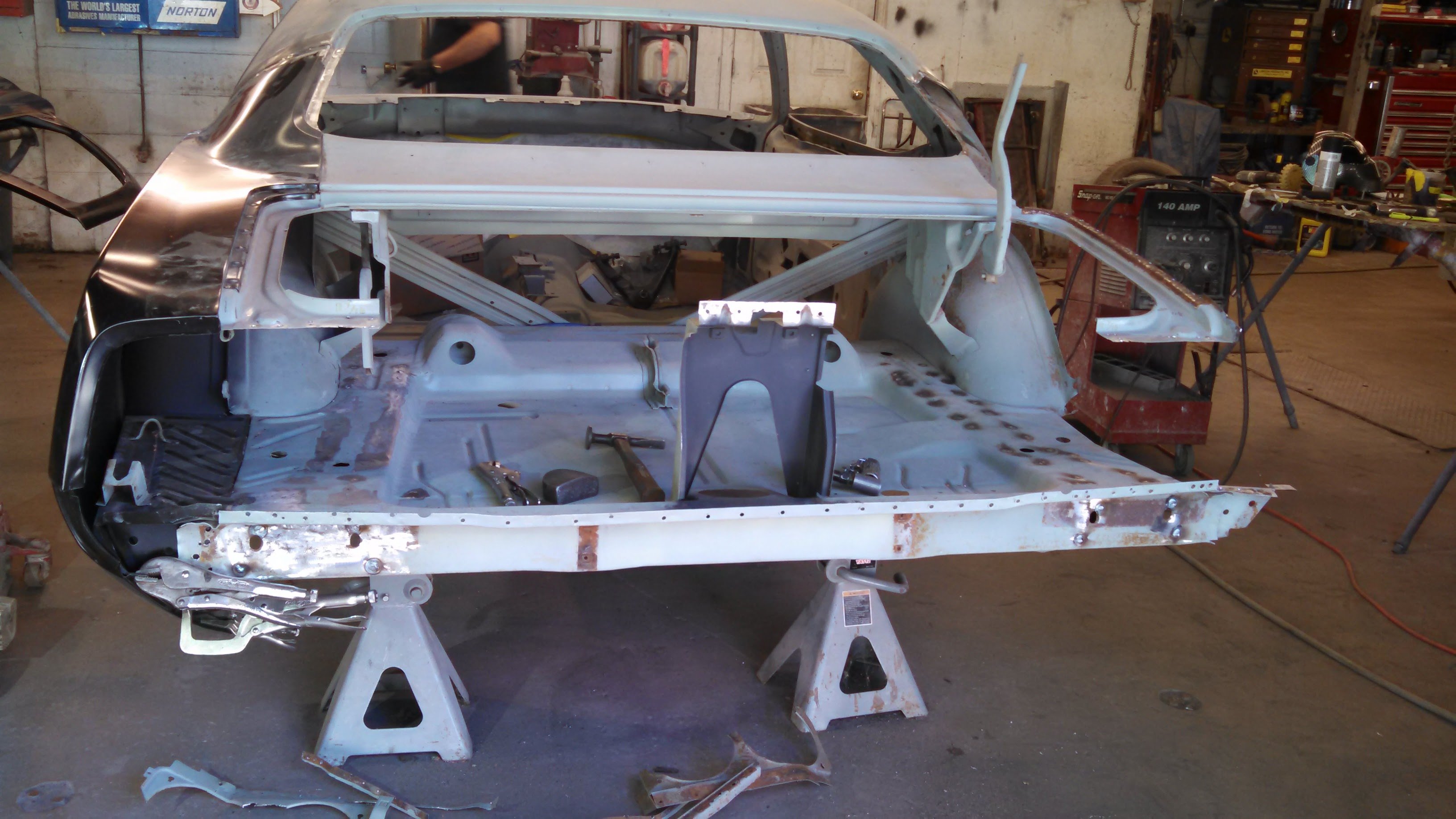

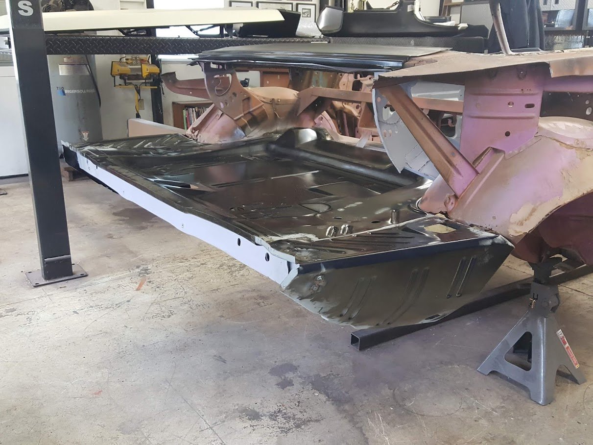

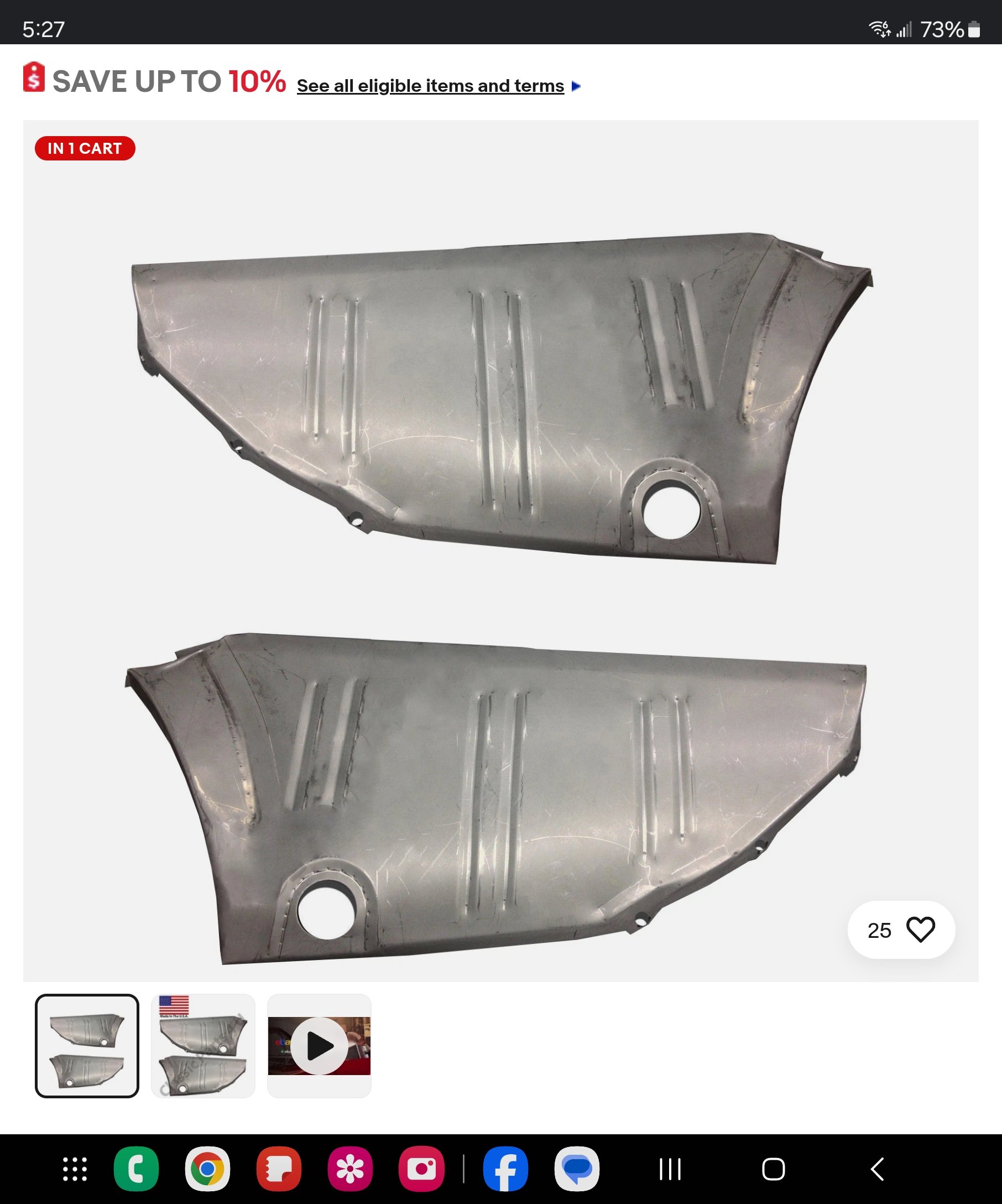

While installing the rear valance, I realized that There are no trunk extensions installed.. It had new quarters, and trunk floor that was already installed when I got the car.. As I was looking at pictures on the web , I noticed that about three out of every five pictures do not have trunks , extensions as well thoughts?
So I have decided to put trunk extensions on my project. I have a question.\n I saw a couple of videos where the trunk extension and the quarter panel at the bottom were not welded solid together. Does anybody have a thought on how they are done or supposed to be connected to each other?The curved part of the quarter panel at the bottom and the lower trunk extension bottom piece.Thanks

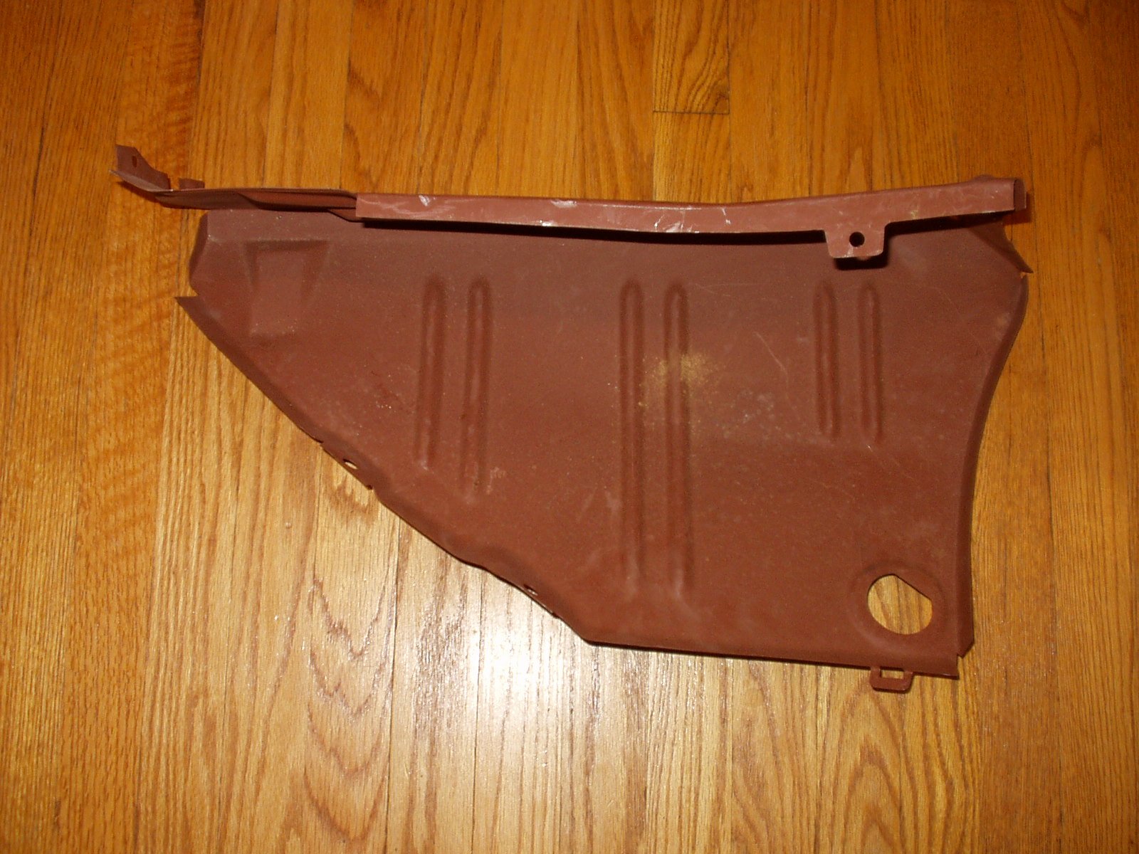

the trunk extension (inner quarter panel behind the rear tires) and the outer quarter panel are spot-welded together. they form a cavity. A nice place for small tools, housekeys, loose change, credit cards, and other small objects to collect as they fall from the trunk floor down into this abyss at either end of the trunk floor. Not to mention, dust, dirt and other debris collect in these areas, over time.

if you want to put it back, and make it correct, that's your right. from memory, this area is practically water-tight. I have cleaned these areas on prior cars. the two panels are spotwelded together, so well, one can fill the abyss with water from a garden hose and watch is slowly drip, drip, drip onto the ground. There is a removeable plug, about the diameter of a silver dollar, on the inner trunk extension, to help it drain and clean it out. but leaving it out seems a bad idea, because driving through any kind of water, be it a puddle or a rainstorm, seems to throw water from the rear wheels right onto that area.

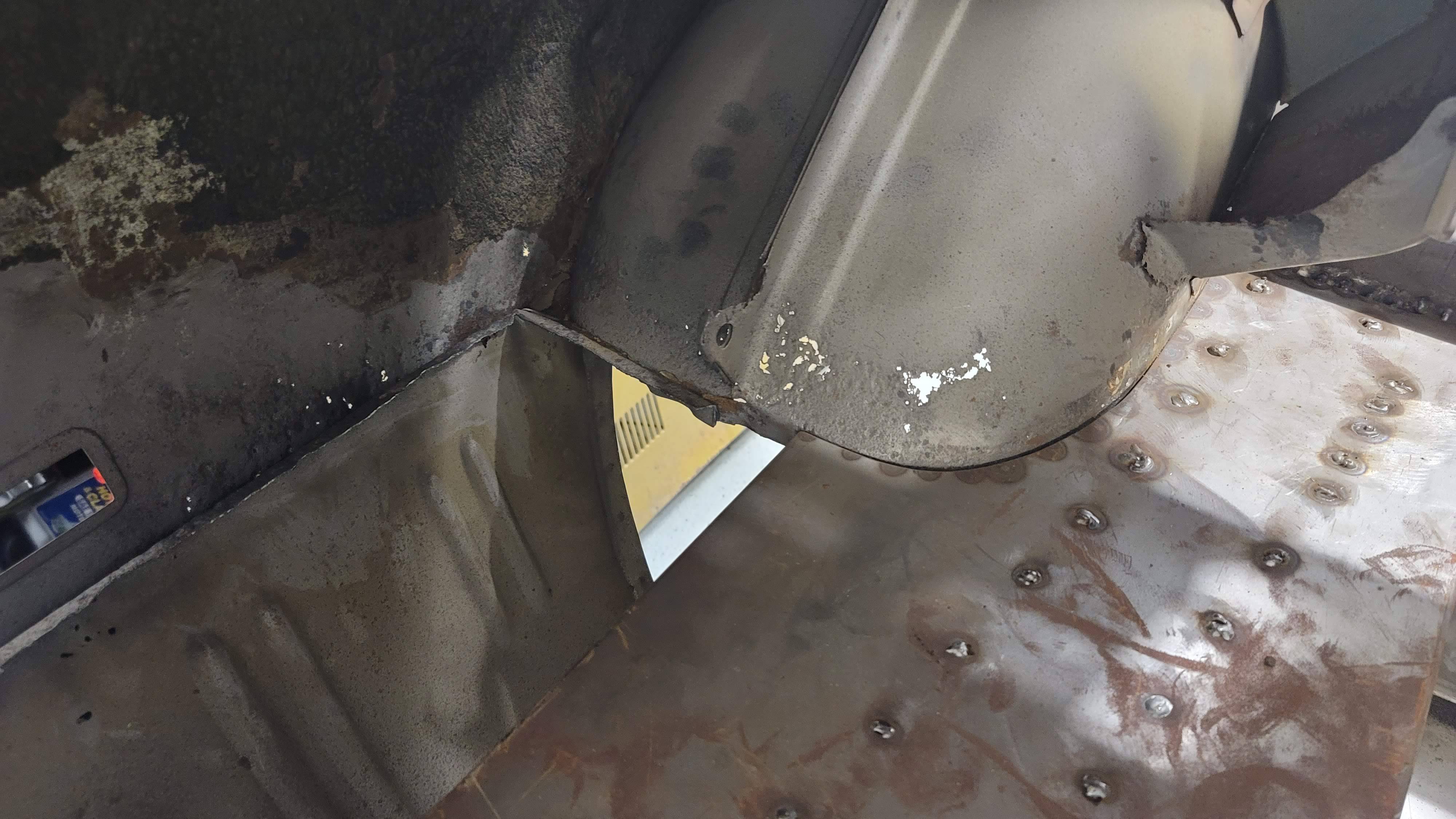

I'll admit to not looking under E bodies regularly, but I have never seen one without these extensions.
In any case, if you want to add them, it shouldn't be too difficult. Put them in place, spot weld, touch up the paint.
However, if you never noticed they were missing before, then someone must have filled the gap in the trunk floor to prevent things from falling out on to the road. This makes your work more difficult as you now have to remove these pieces before you can add the correct pieces. If you didn't put these pieces in place, then its anyone's guess how well or poorly the previous owner actually closed this gap and how difficult it will be to remove and correct.

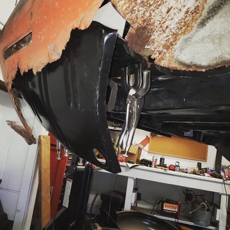

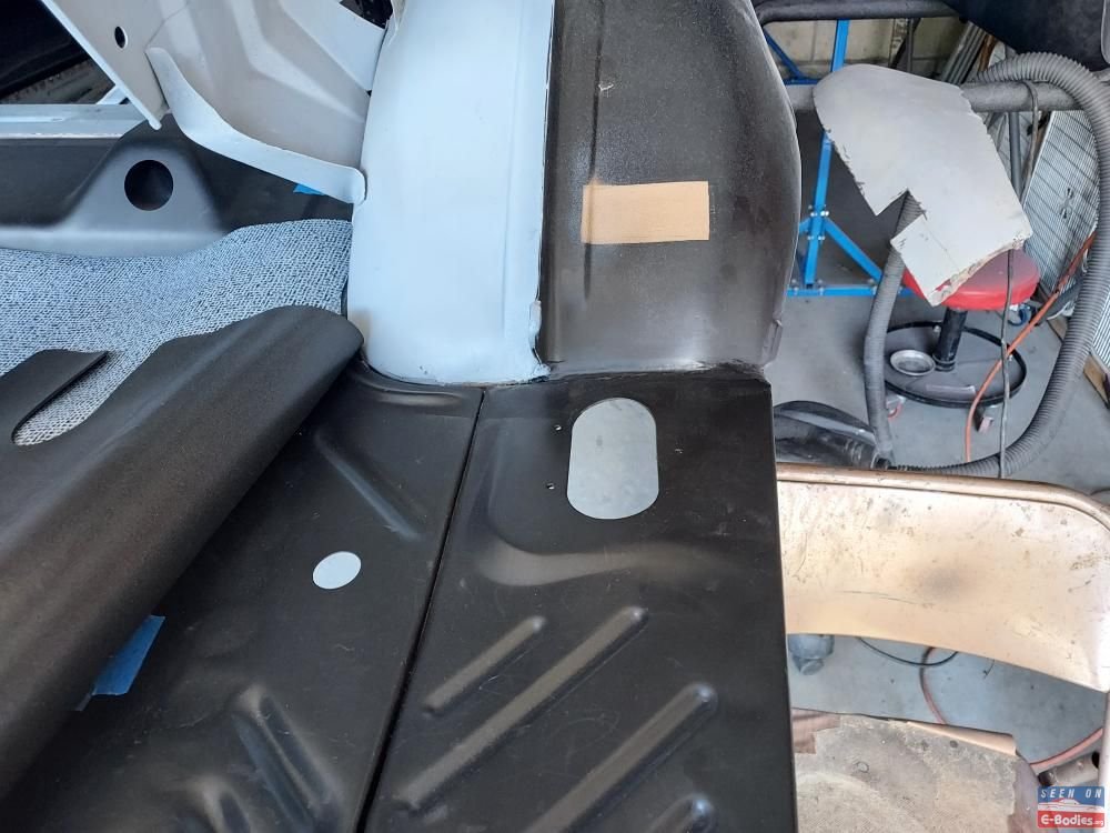

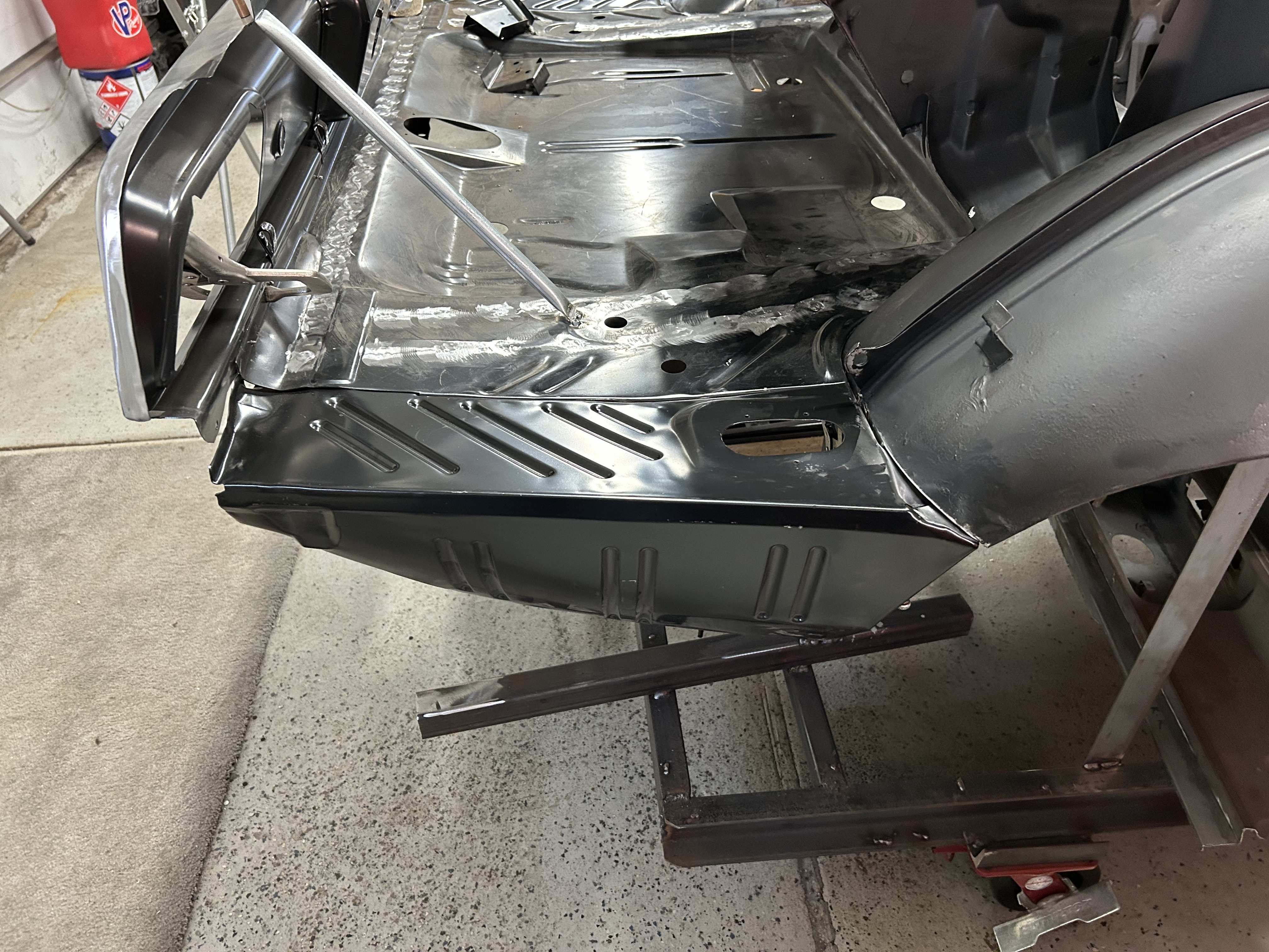

Does anyone have any pictures of these being installed...

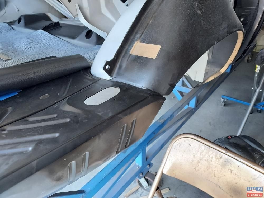

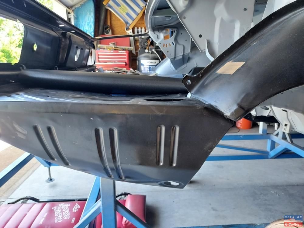

If I remember correctly, they were plug welded to the trunk floor, outer wheelhouse, tail panel and quarters. Where the qtr extension meets the bottom of the quarter panel was plug welded too. Seam sealer is used in the trunk to seal the panels abutting the extensions.
