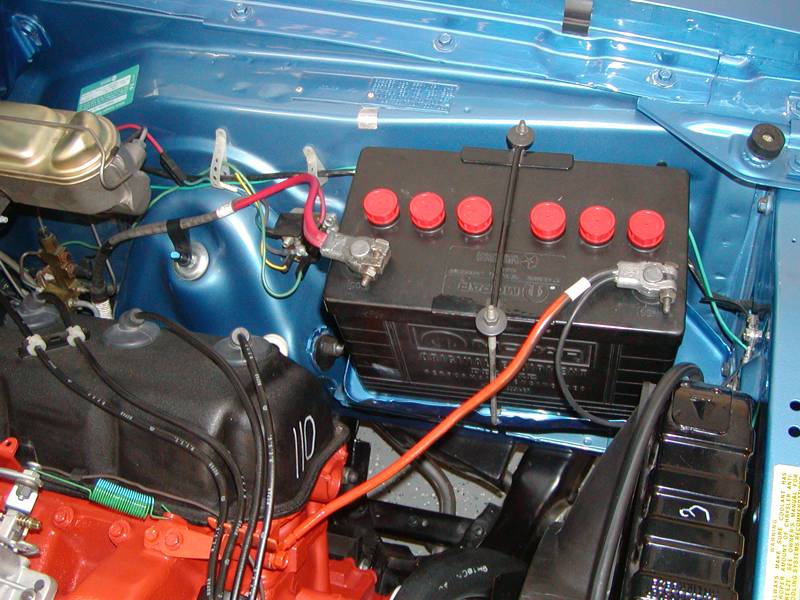

May 19, 2022 #1 Barnstormer Member Joined Aug 15, 2016 Messages 11 Reaction score 1 Location Wisconsin United States Anybody have a picture of how the positive cable should be routed from the starter on a small block 73 cuda?

May 19, 2022 #2 Challenger RTA Well-Known Member Joined Oct 28, 2018 Messages 4,285 Reaction score 2,321 Location PA Flood city Do you have this on your frame rail? Last edited: May 19, 2022

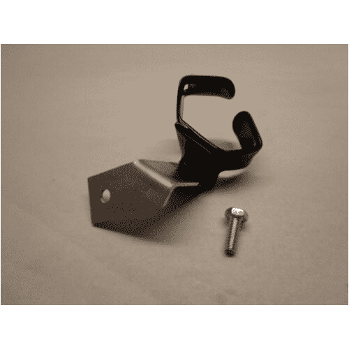

May 20, 2022 #3 Barnstormer Member Joined Aug 15, 2016 Messages 11 Reaction score 1 Location Wisconsin United States No, car was taken apart when I got it. Only bracket I've found so far is for down by the engine. I see yours runs down the fender for a bit so if the small blocks are the same that might be enough for me to figure out the rest.

May 20, 2022 #4 S Steve340 Well-Known Member Joined Sep 19, 2016 Messages 1,054 Reaction score 446 Location New Zealand That bracket locates on the chassis rail below the brake proportioning valve. Tucked in behind the shock tower.
