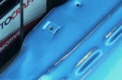

1972 - 1974 E-bodies used a battery hold-down with J-bolts like other models, but also bolted to a fender attached 5/16-18 threaded insert nut. The original pierce nut inserts were clinched to the metal. The following image shows the nut installed in a fender:

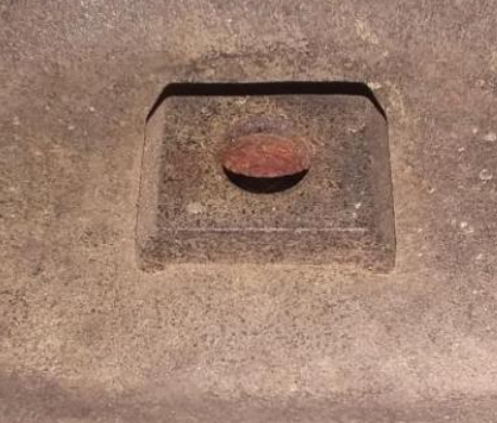

The following image shows a nut from the bottom side:

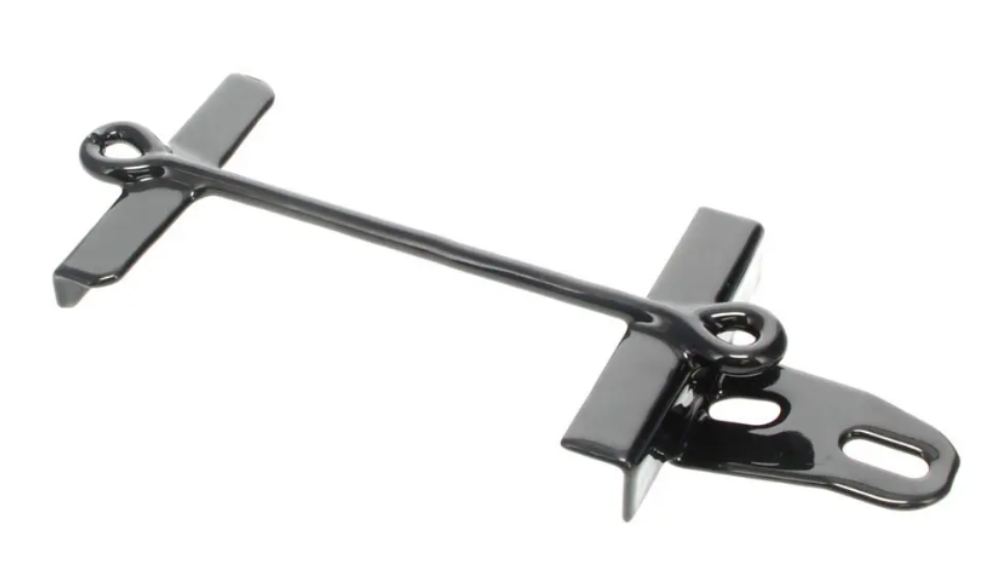

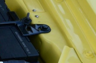

The following images show the E-body battery hold down, and a hold down attached to the fender:
