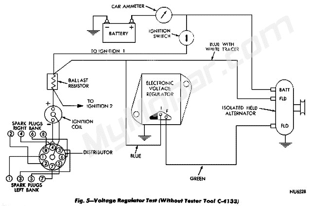

Posting the diagram below to help you understand you already might.
Check the grounds on the motor, chassis by the battery, alternator mounting bolts. Be sure they are clean and tight. The battery cable can corrode an 1" inside the insulation and cause a problem.

This is for stock Mopar charging system.
1:With the key in the off position should have on the alternator output battery voltage.
2:The field wires should both read zero we should have no voltage.
3: If there is voltage at the field wires with the key off, there is a wiring problem.
4: If no voltage here at the alternator output with the key off then we likely have either a dead battery or we have a wiring problem or blown fusible link.
5: With the key in the on position. there will be voltage at the alternator output, it's going to be lower than what it was with the key off, because the entire vehicle is energized. The voltage drop is going to be more you can still see it go from
12 and a half down to 11.7. Still going to have near battery voltage.
6: What's important. With the key on. The field wires should have voltage. It won't be full battery voltage but it's has power coming to the alternator and it will be a lot less on one side and one side is high. That's the inlet so that's power going into the field windings.
The other one, the one that's low is the output from the field windings.
The output from the field winding is what goes back to the voltage regulator.
The voltage regulator on this is simply a switch ( Remember it needs a good ground to function.) all it's going to do is connect this field terminal here to ground and when it connects it to ground electricity then flows through the field windings energizing it and causing the alternator to charge.

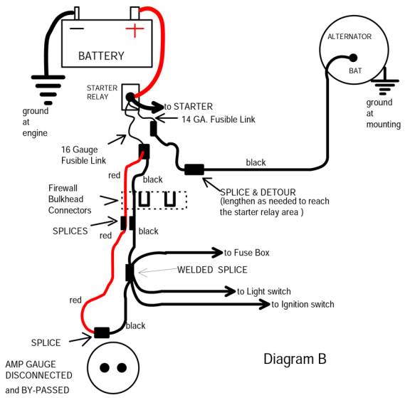

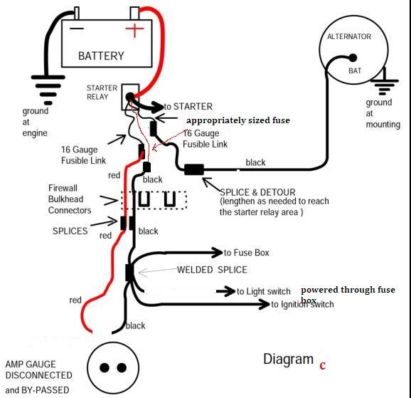

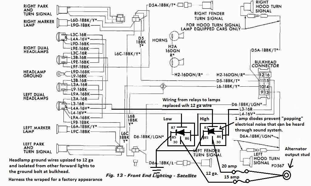

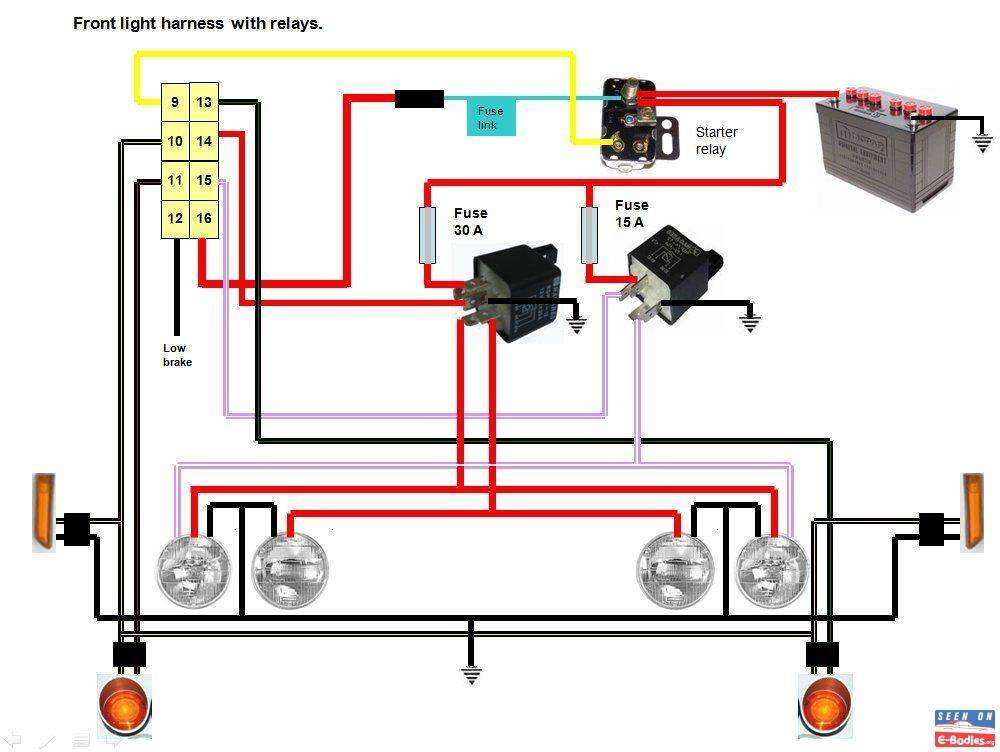

Bulkhead and amp meter bypass.
Here are some examples of what can be done. Not saying what is correct for your application. Connecting to the starter relay circuit is eclectically the same in this manner. BUT the gauge of wire from the relay to the battery is not adequate. That's why it should be connected to the starter feed or directly to the battery. Also a headlight relay circuit would be advisable. The main point of it is that the load is electrically connected to the alternator. That being said. Splice one also has to be feed from the alternator. The alternator never was a on a fusible link that feed splice one. It would be advisable to place one there. As it was said before the the diodes would or might blow before any damage . But why take a chance.

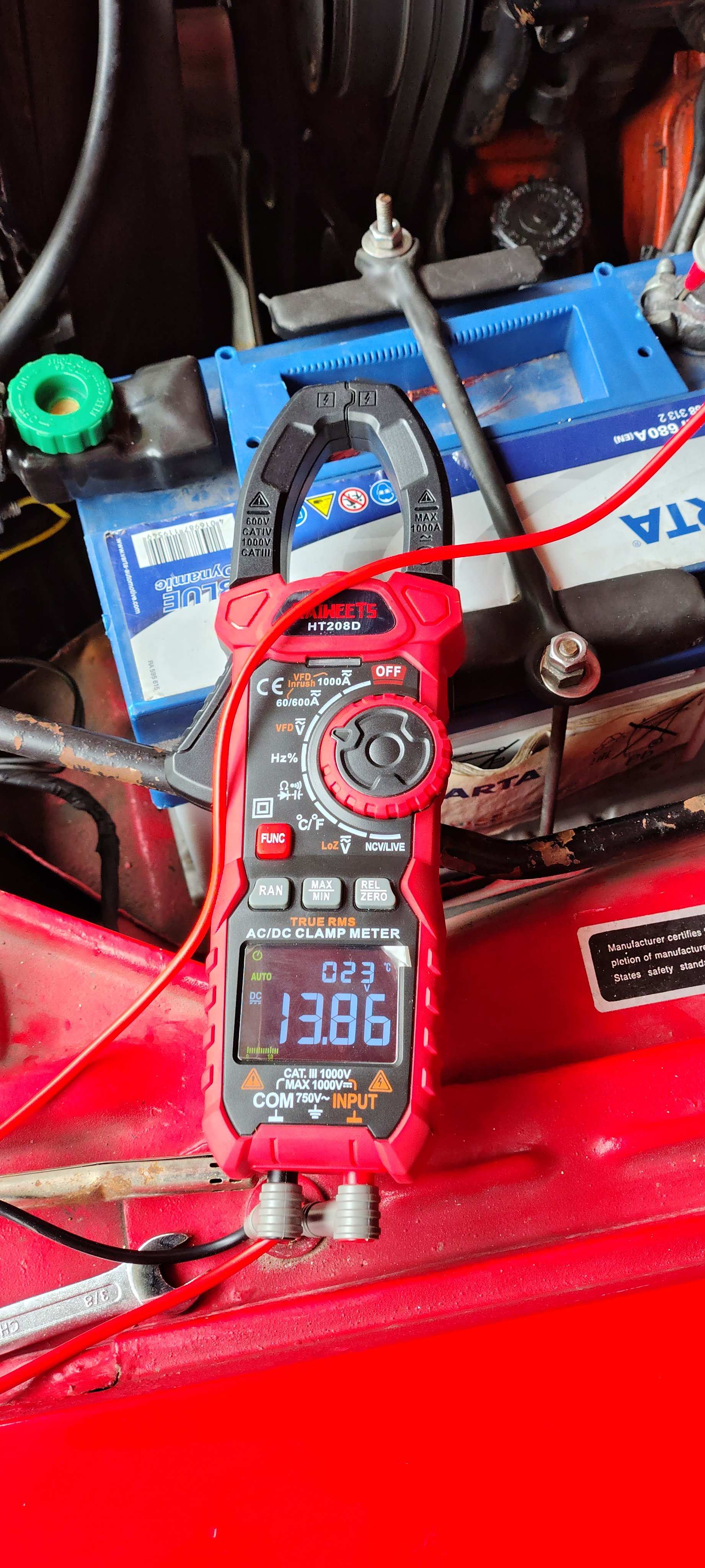

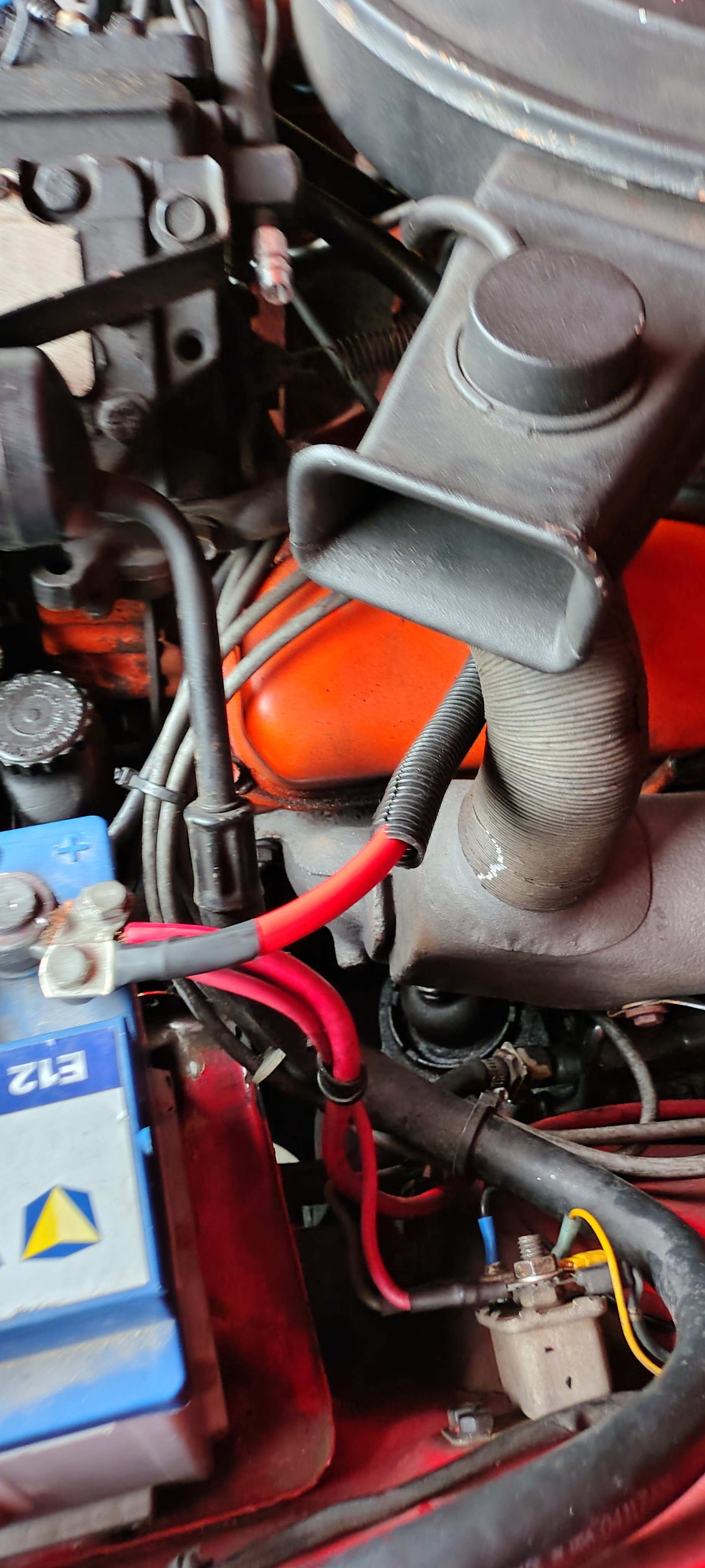

reporting back after all parts have arrived and have been installed. New alternator, regulator, 35mm2 and 4mm2 battery cables, some fuse boxes.
Now we're talking... 😁
The original alternator cable has been detoured to starter relay with 4mm2 wire and a 20A fuse for now, let's see if that is enough.
Main connection alternator to battery directly is 35mm2, currently without fuse but I'm thinking of adding another box with 80 amps or so.
Next thing will be the headlight adaption, but for now I am happy that this issue has been resolved, thank you for you input! 😃👍🏼

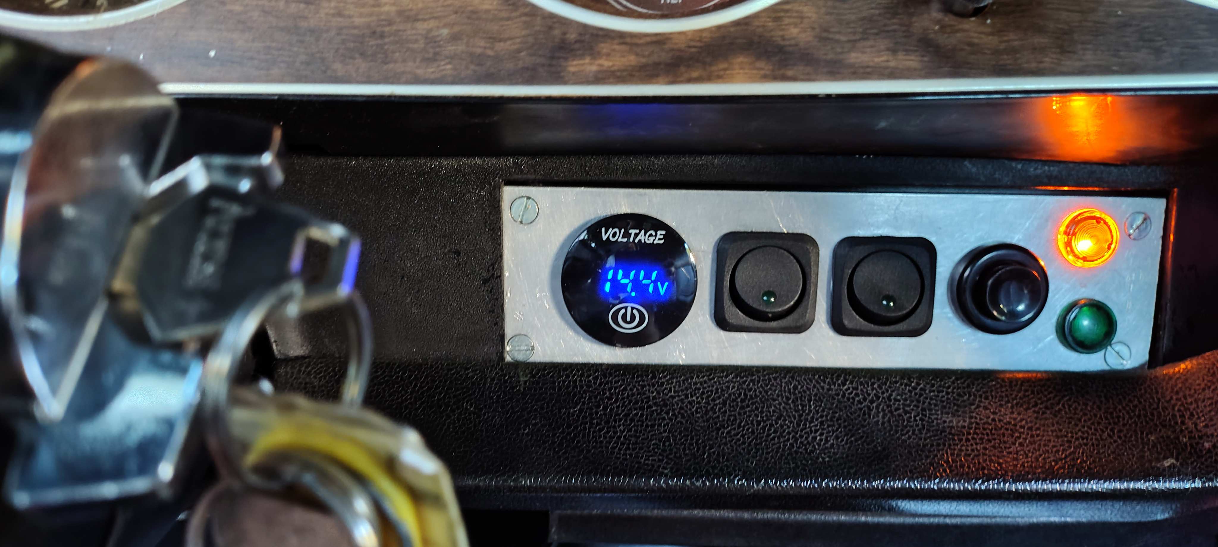

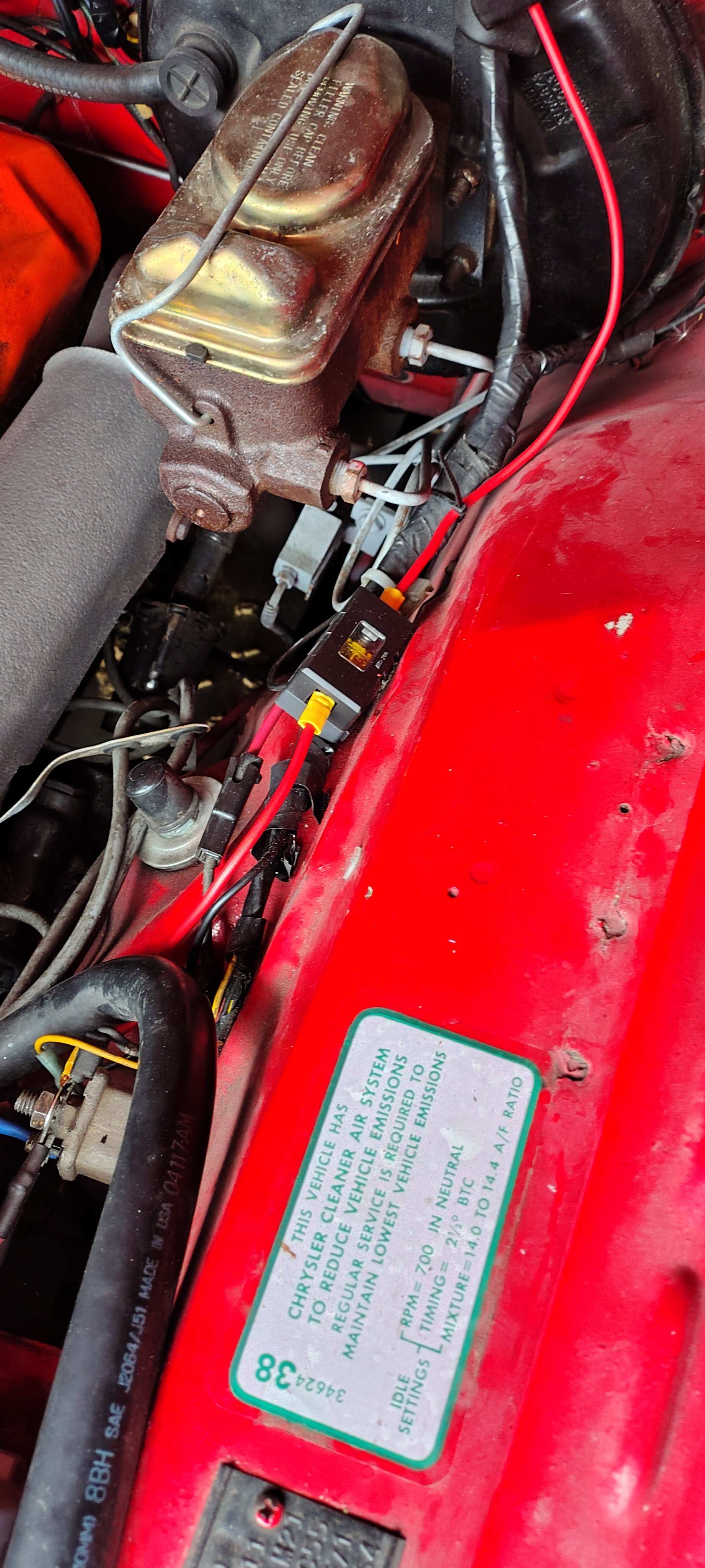

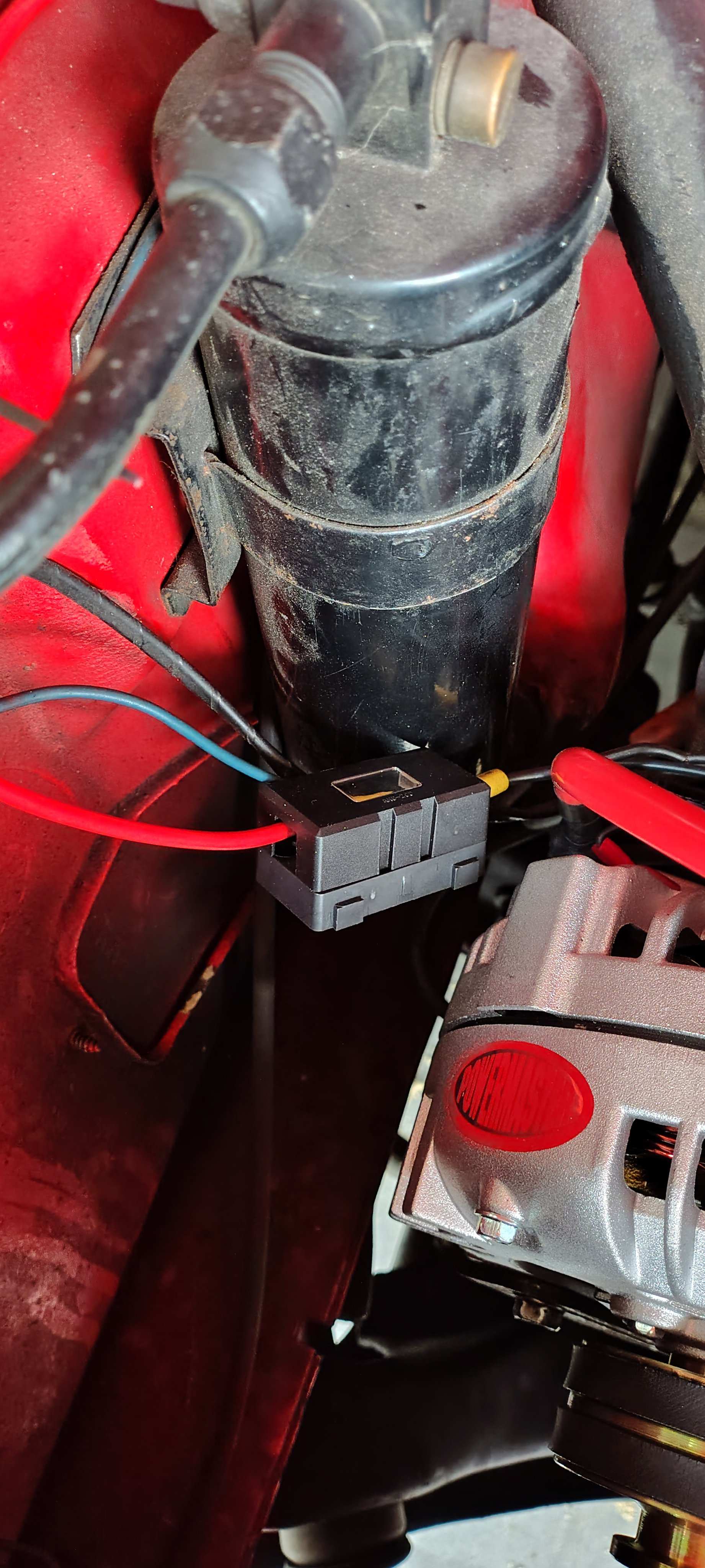

Meanwhile as I'm afraid to go longer distances due to clutch noises I had time for the remaining electrical stuff.
Instead of the non functional radio I made a panel with a cheap voltage meter and some switches for future usage and relocated the self made backup light here.

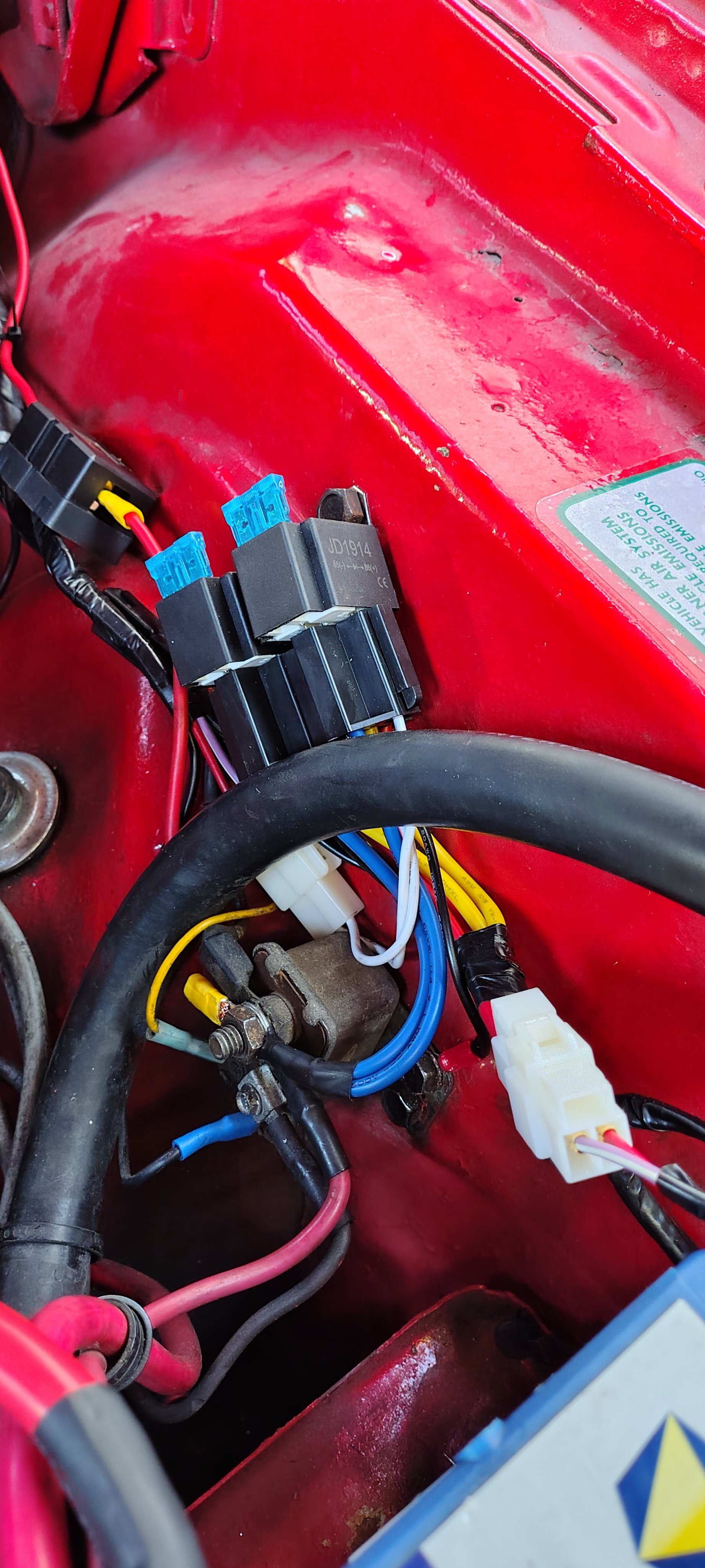

Also the headlight relay adaption was quite smooth, impressed how much brighter the headlights seem to be now 😮
I went with 15A fuses for both low and high beam, the clamp meter showed around 8-10A for low and high beam each... Should be fine, if not, the fuse is changed quickly 😉.

GOOD move on doing the relay up grade. You can see the results.
The only thing is. The load should be coming of the Alternator. Or is that the black wires with the red wire? I also see a red heavier gauge wire on the battery?
It will be ok until you do so. Other than that that load is being pulled through the both bulkhead connectors, 22 and 23. If any thing only use the high beams when you need them. The small red battery led is not heavy enough. I would think you already thought of up grading the headlight to a higher wattage. That you probably already did.

Pin 30 of the relay has the thick blue wire connected to the starter relay, Pin 87 is going to original headlight wiring (both AWG 12), whites are coming from bulkhead original wires.
But you have a point. Between starter relay and battery=alternator the wire is thinner 🤔 I might change that to 35mm2 aswell, still have a piece from the alternator installation.
Higher wattage is not allowed here, H4 with 55/60W is installed.
From post #11, that sounds like a direct alternator to battery parallel run, commonly referred to as the "shunt wire" bypass of late. For a all stock intact ammeter-based system, it is very dangerous as it circumvents/defeats the stock circuit protection for the stock wiring if the original charge path is left in place. Be sure to abandon/disconnect the original alternator feed altogether, sounds like you planned to bypass the ammeter, if done, the headlight relays can be powered off the starter relay with the shunt wire bypass in place, stock alternator feed disconnected.
KPB
Jul 6, 2025
15
23
Austria
Yes, ammeter has been disconnected already by a former owner, so I have now both original bulkhead wires separately fused, basically diagram C from post #10.
