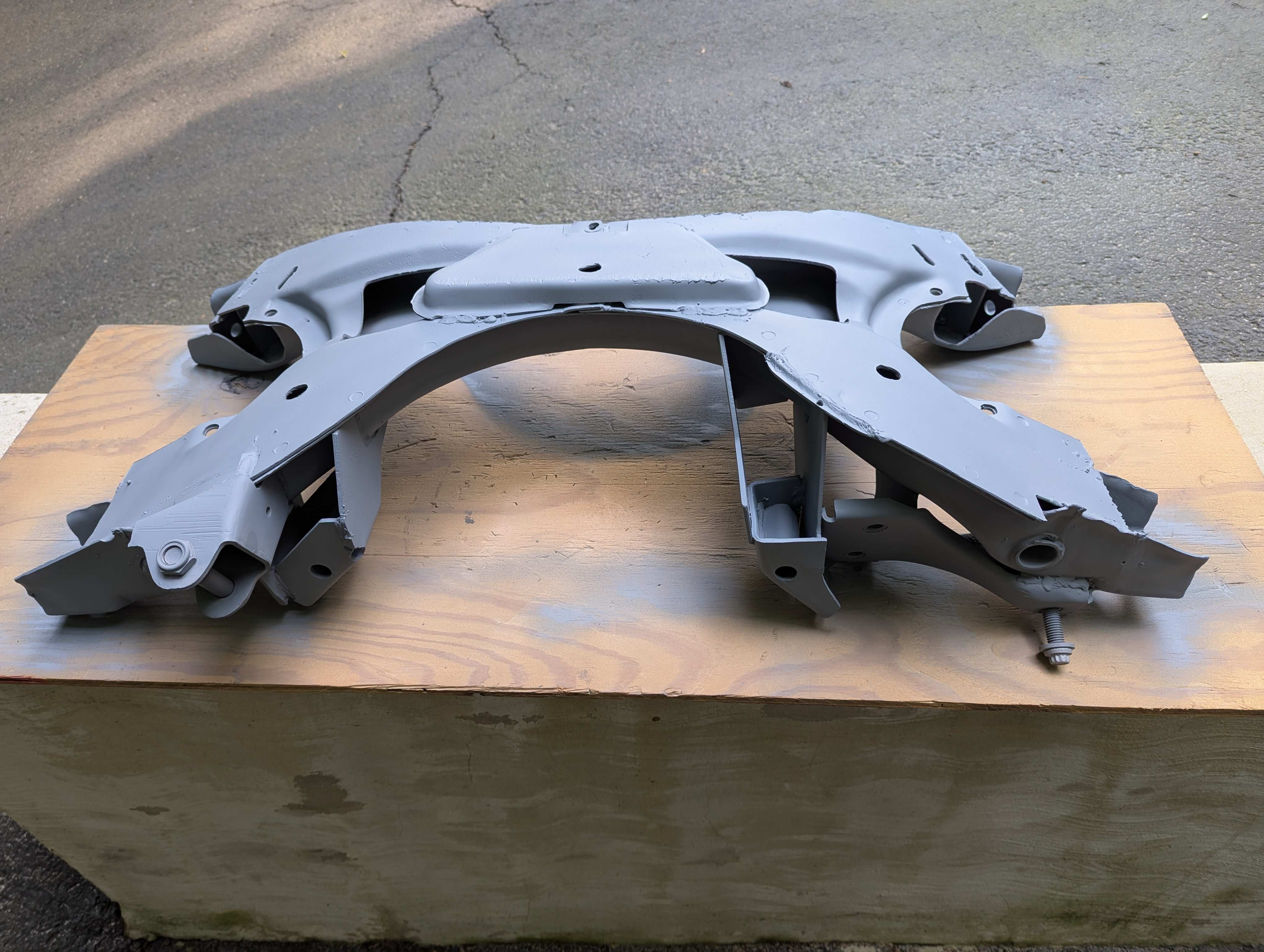

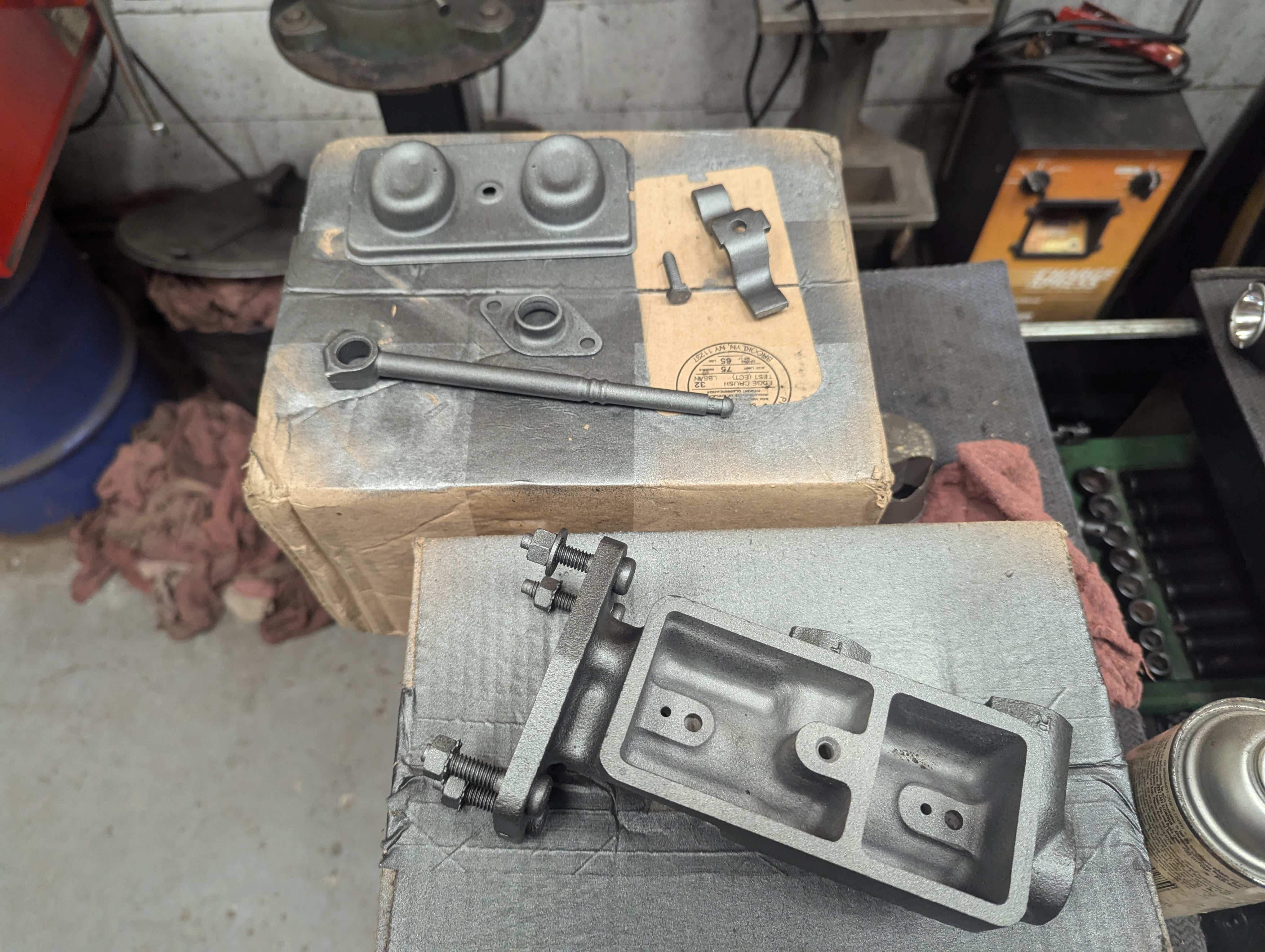

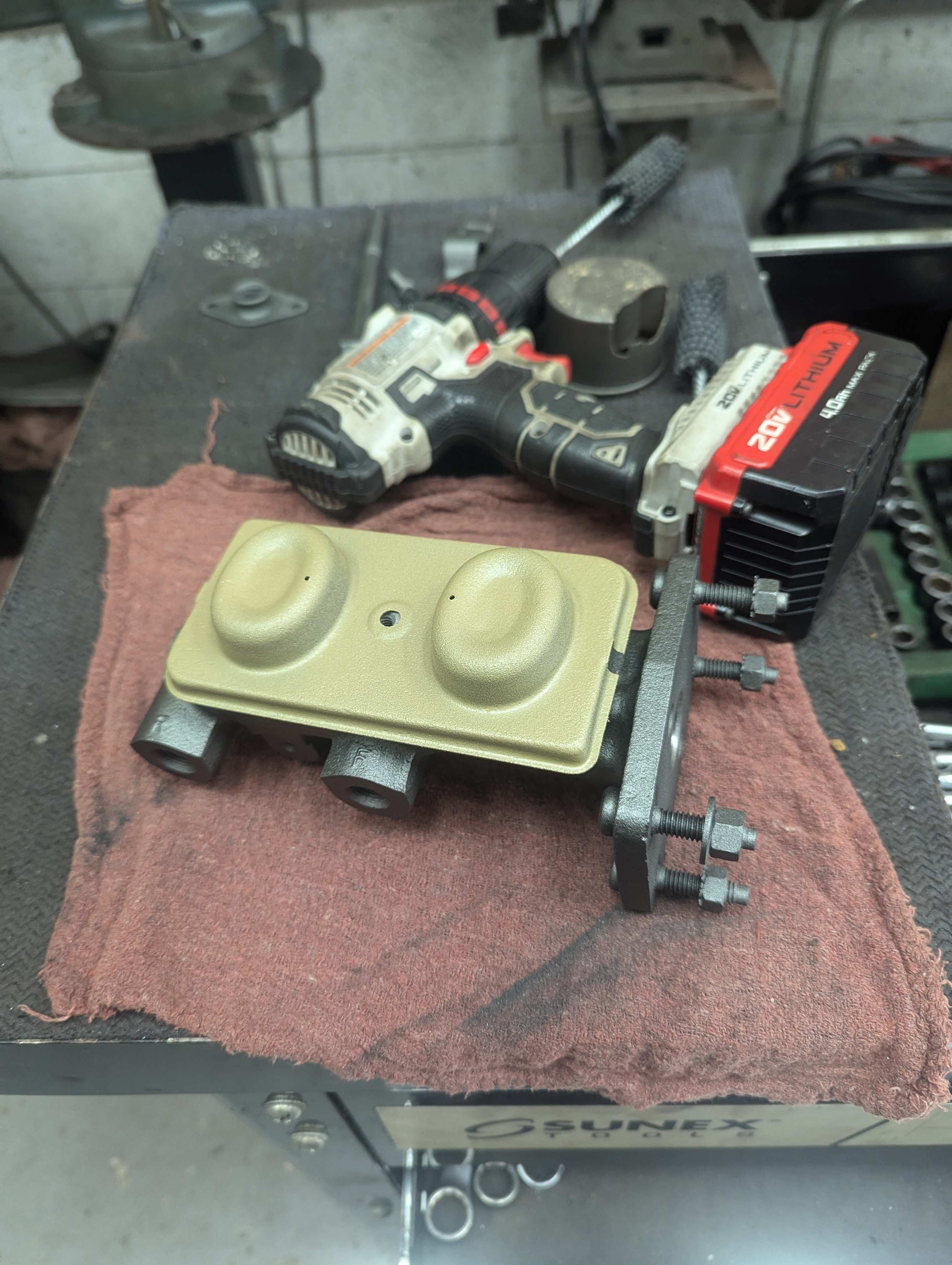

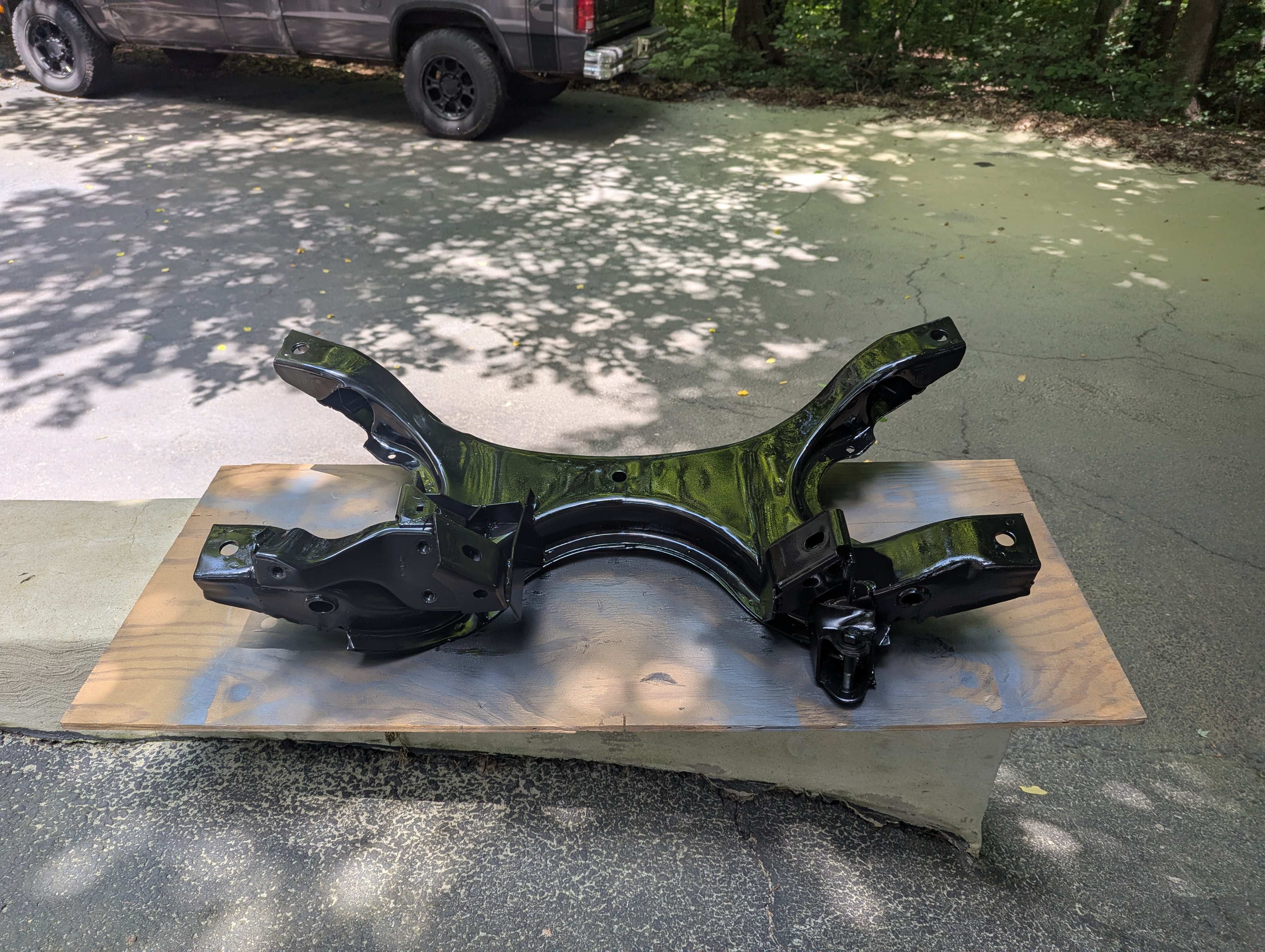

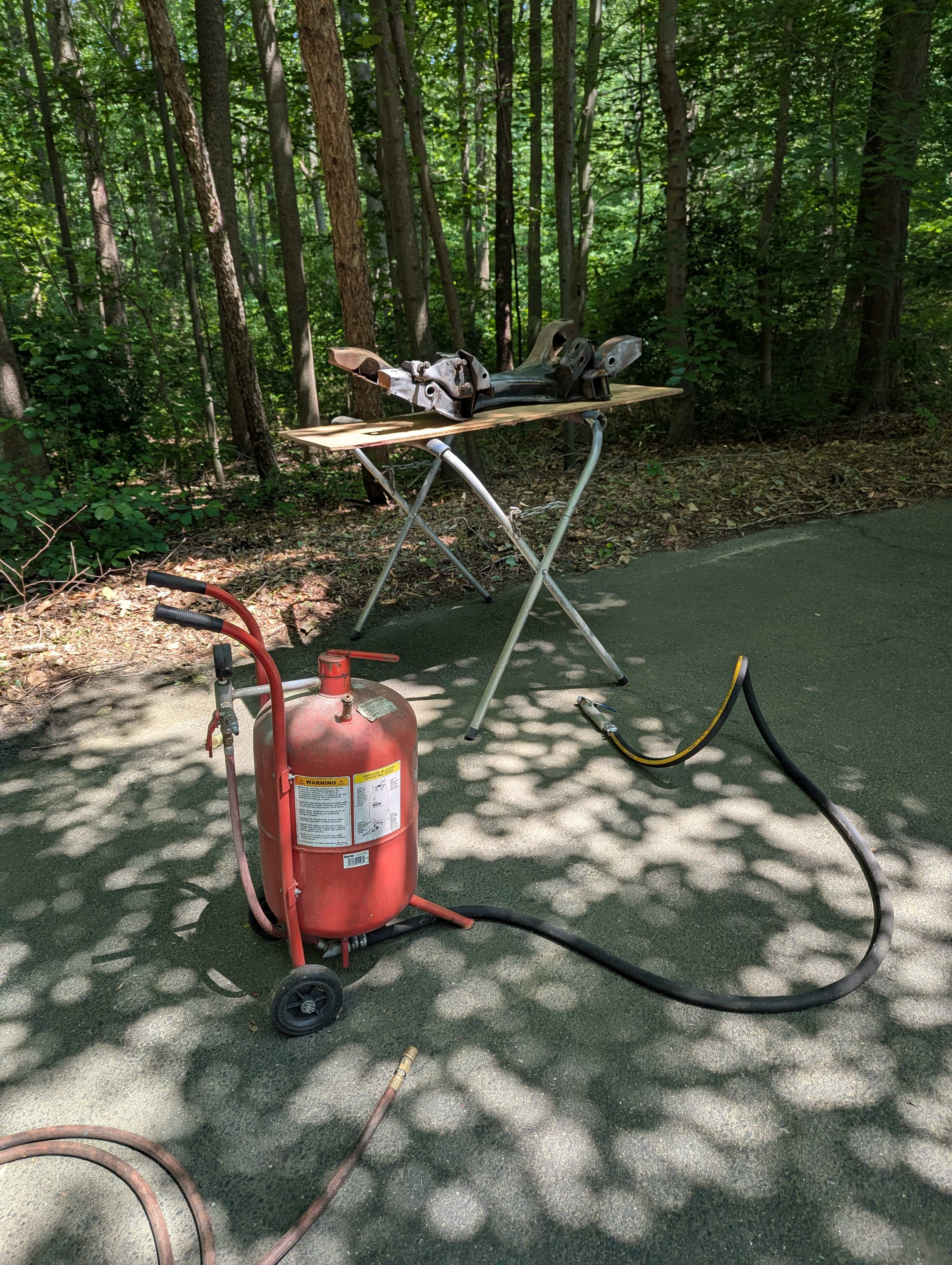

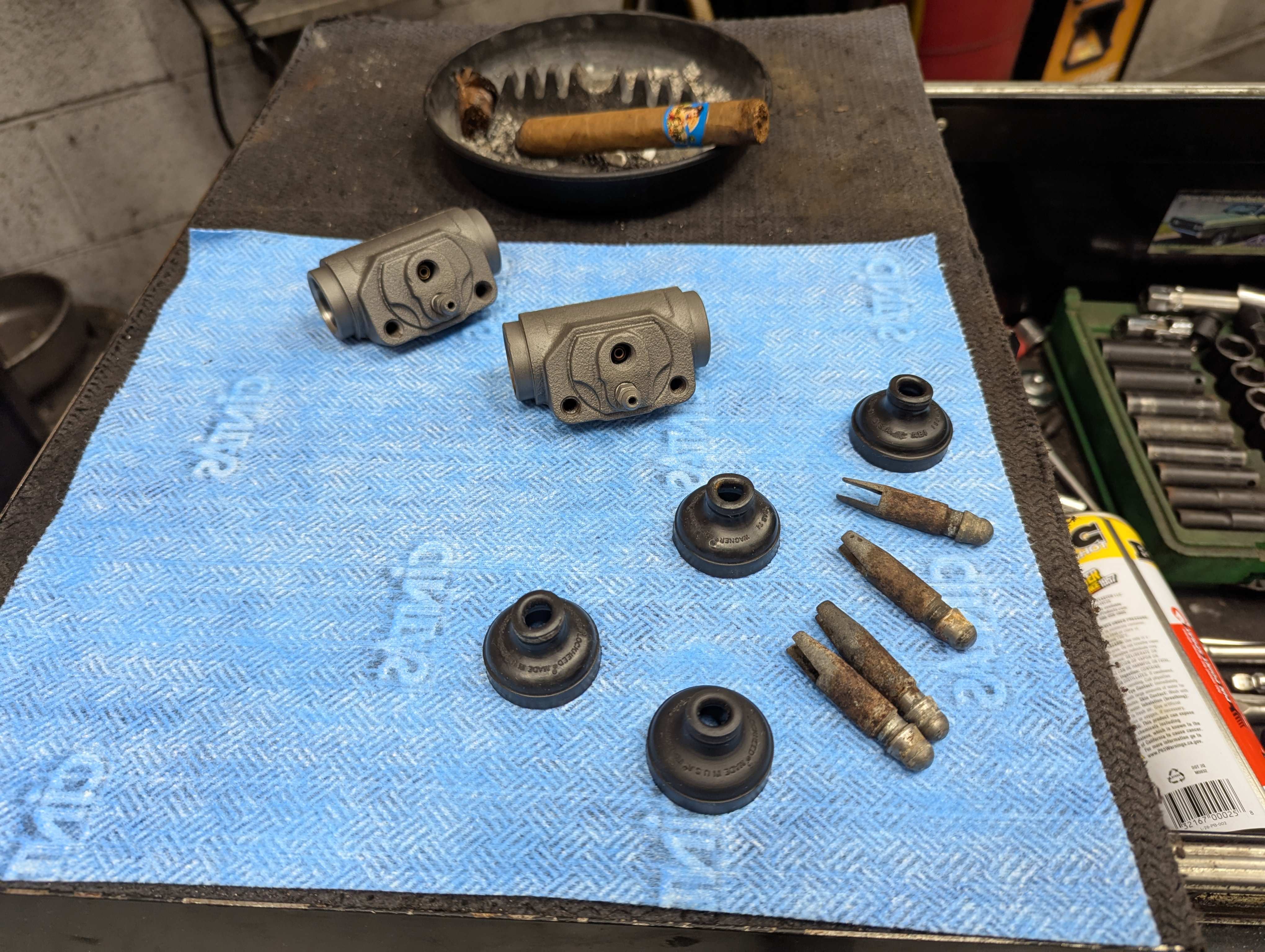

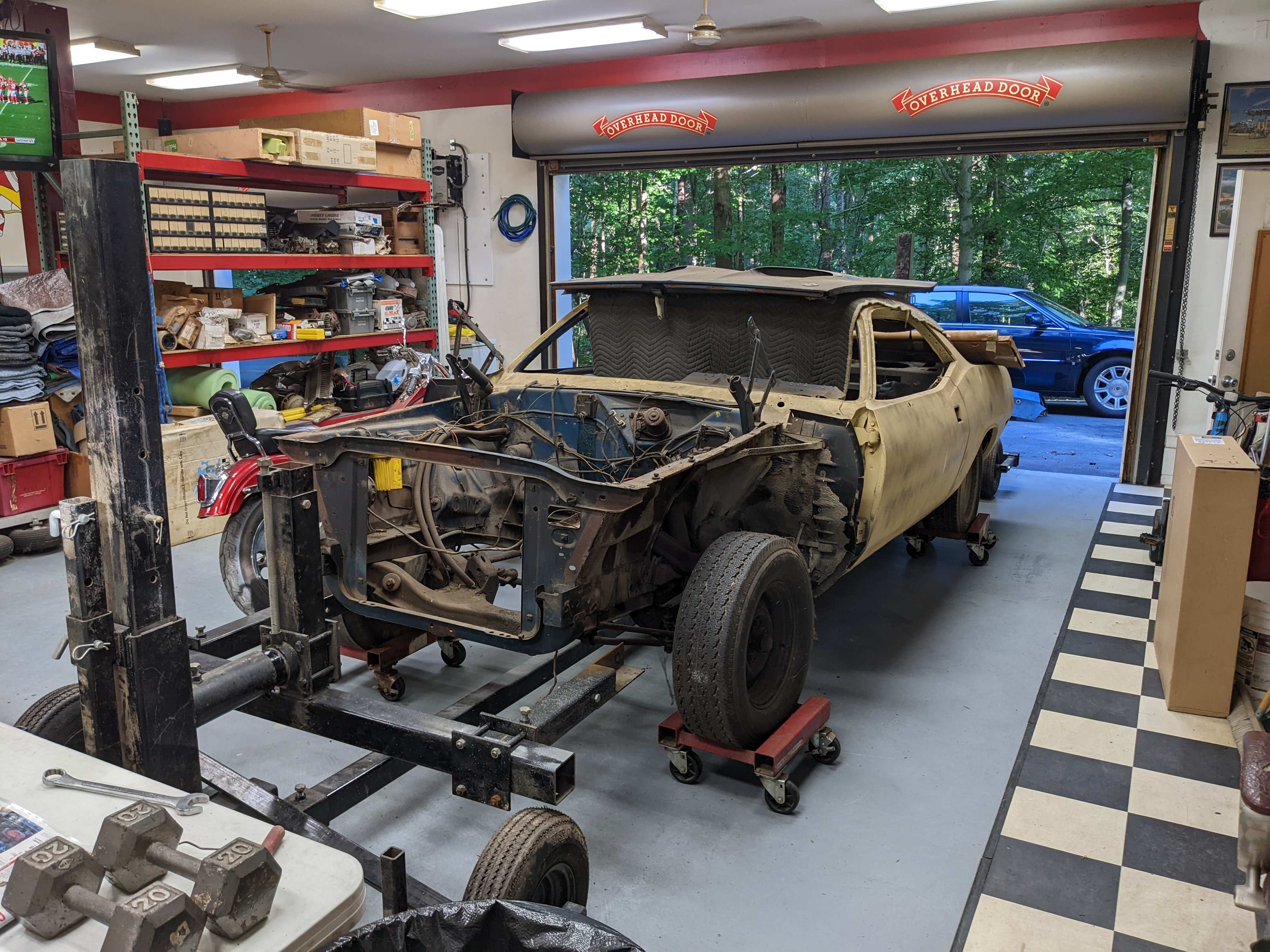

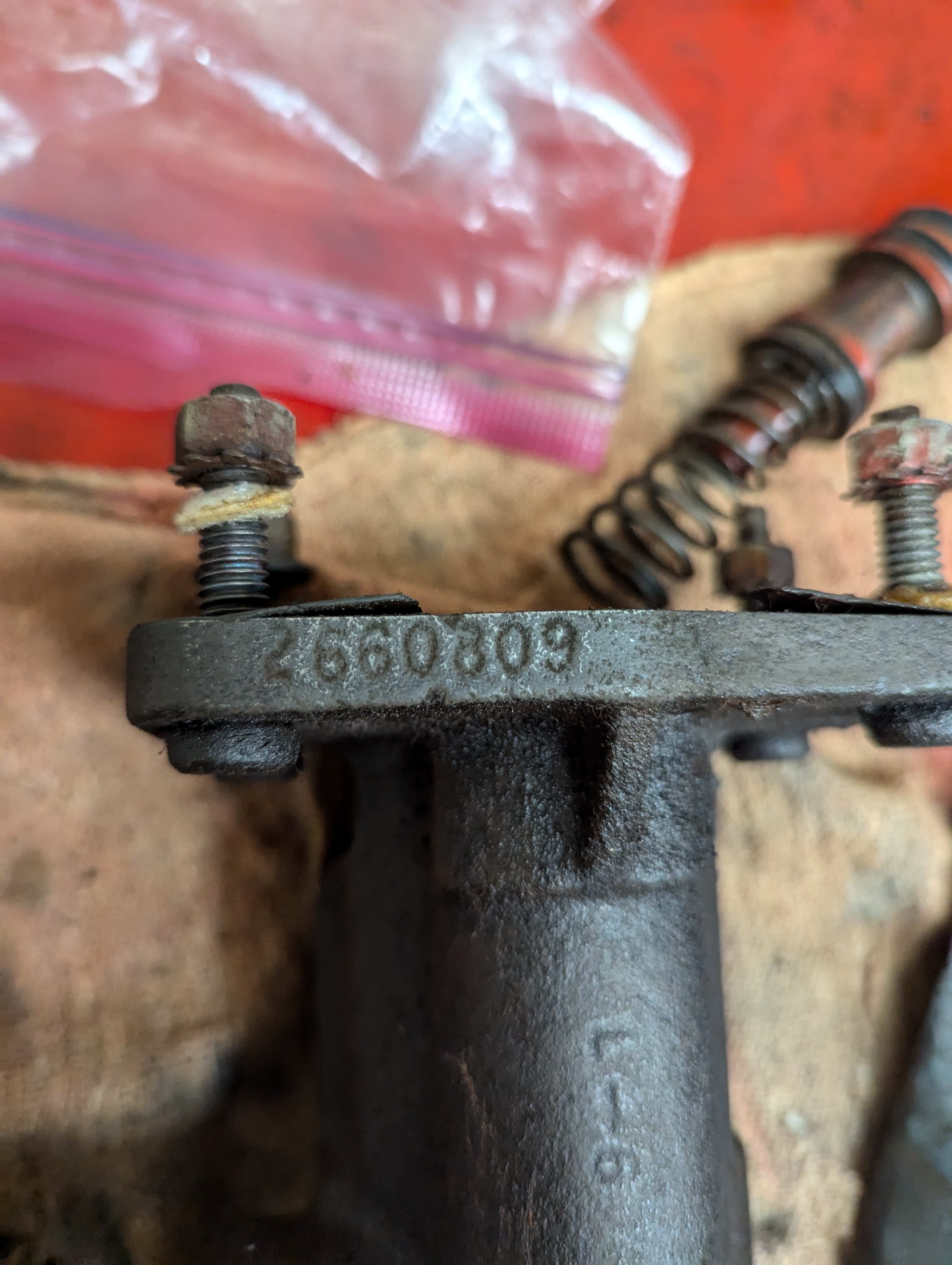

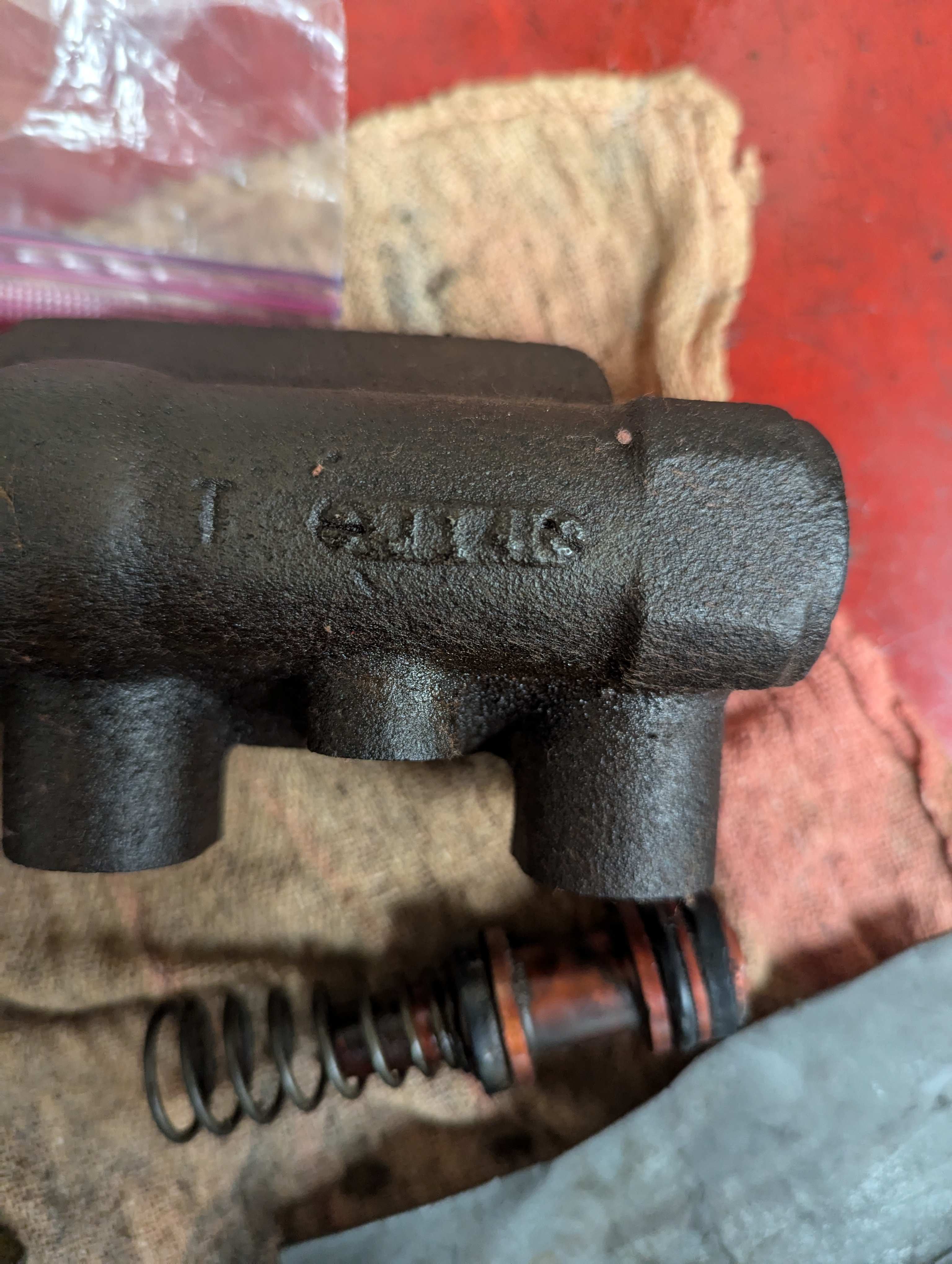

I don't do body work and paint. My shop is just not set up for it and I've never done it. You guys know how hard it is to find someone that will take a project. Even though this is not a huge project to paint. Most body shops just want to do production insurance work, easy peasy. I think I'm on guy number 7. He's supposed to come this week and take a look. Meanwhile, I have begun to work on individual components to have them ready, if and when the car does come back. The master cylinder was numbers matching date coded so I sent the cylinder out to be stainless steel sleeved. Haven't put it back together yet. Blasted the k-frame and got it ready, and then going to work on the differential which still had all of the brakes and tires attached to it sitting outside.

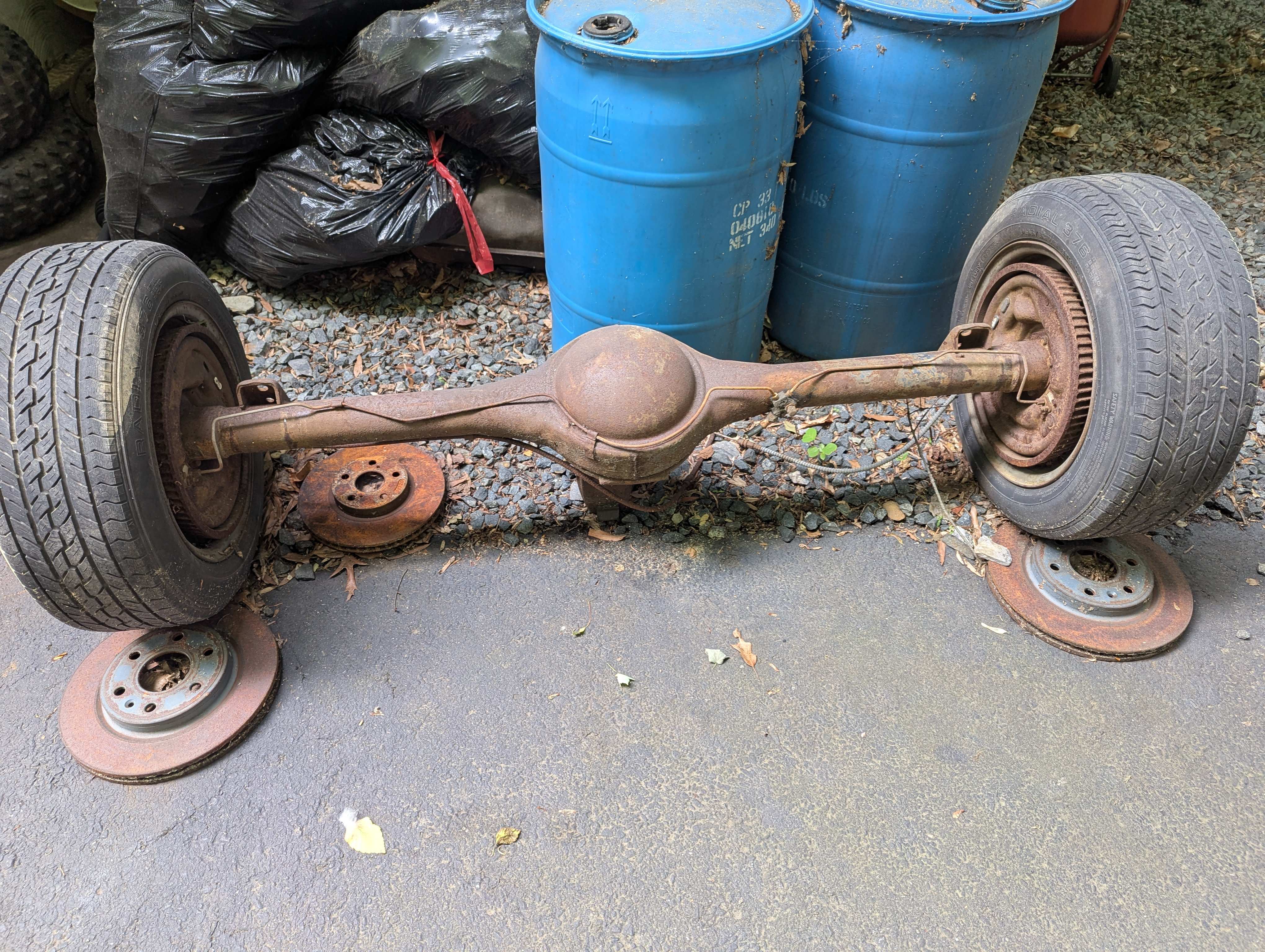

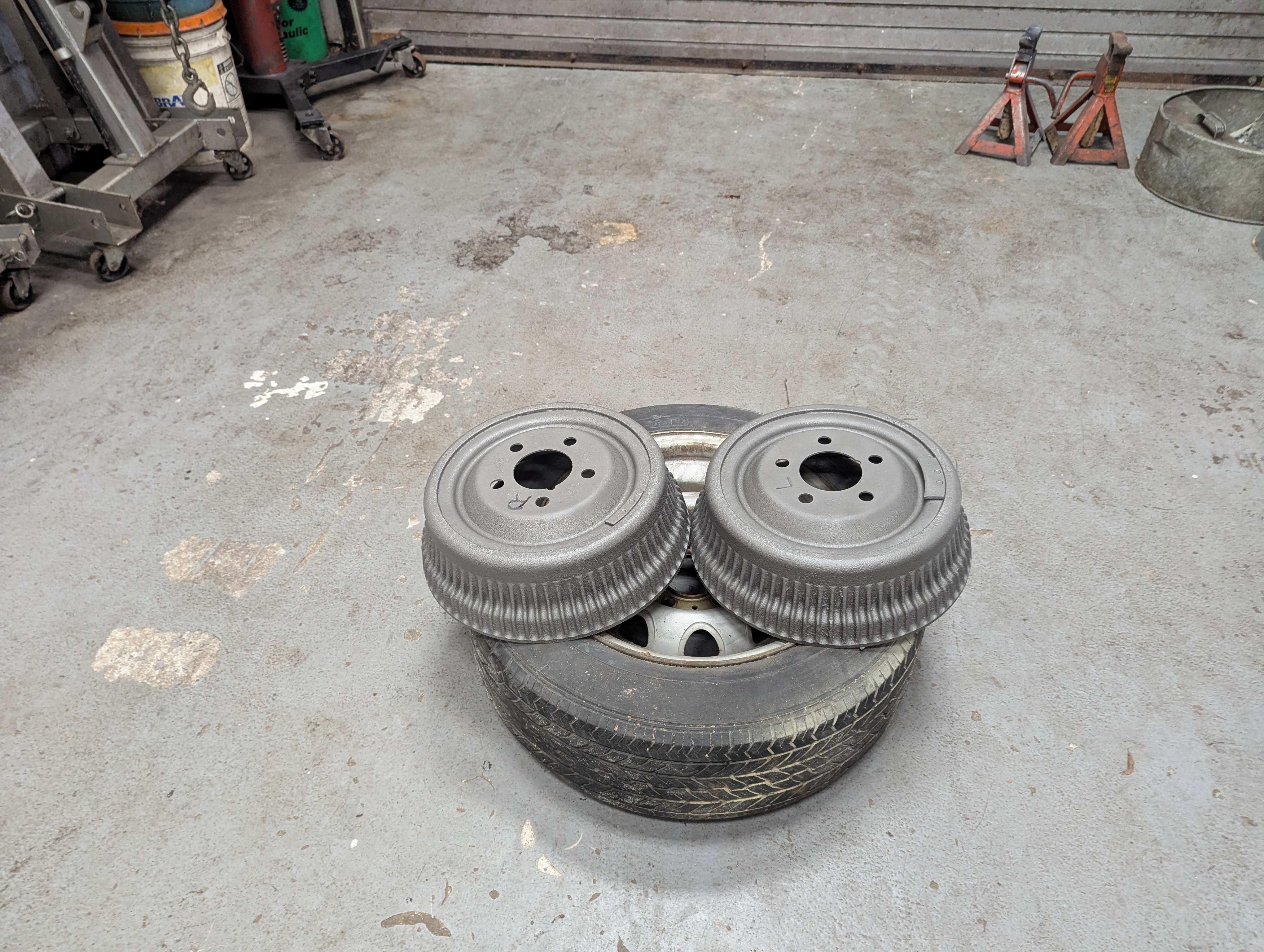

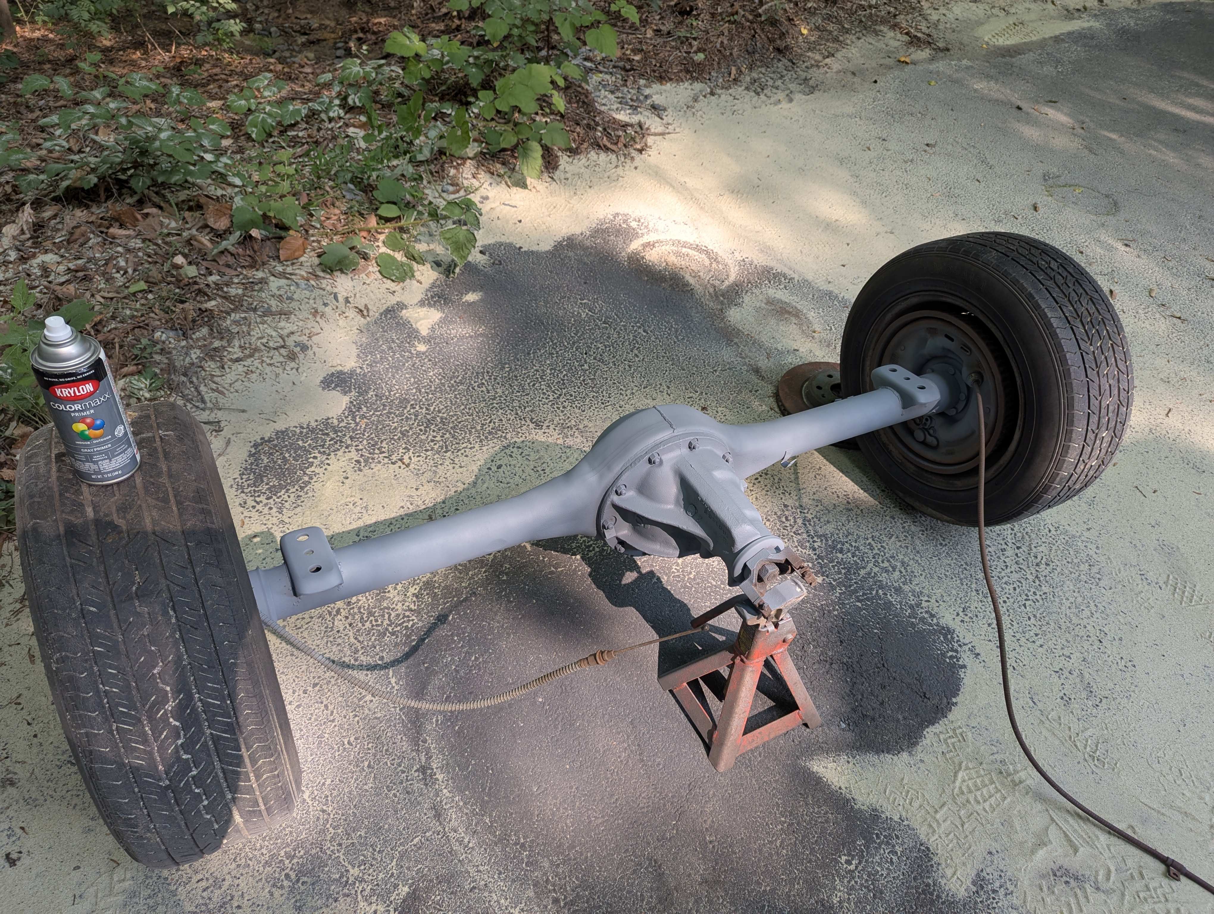

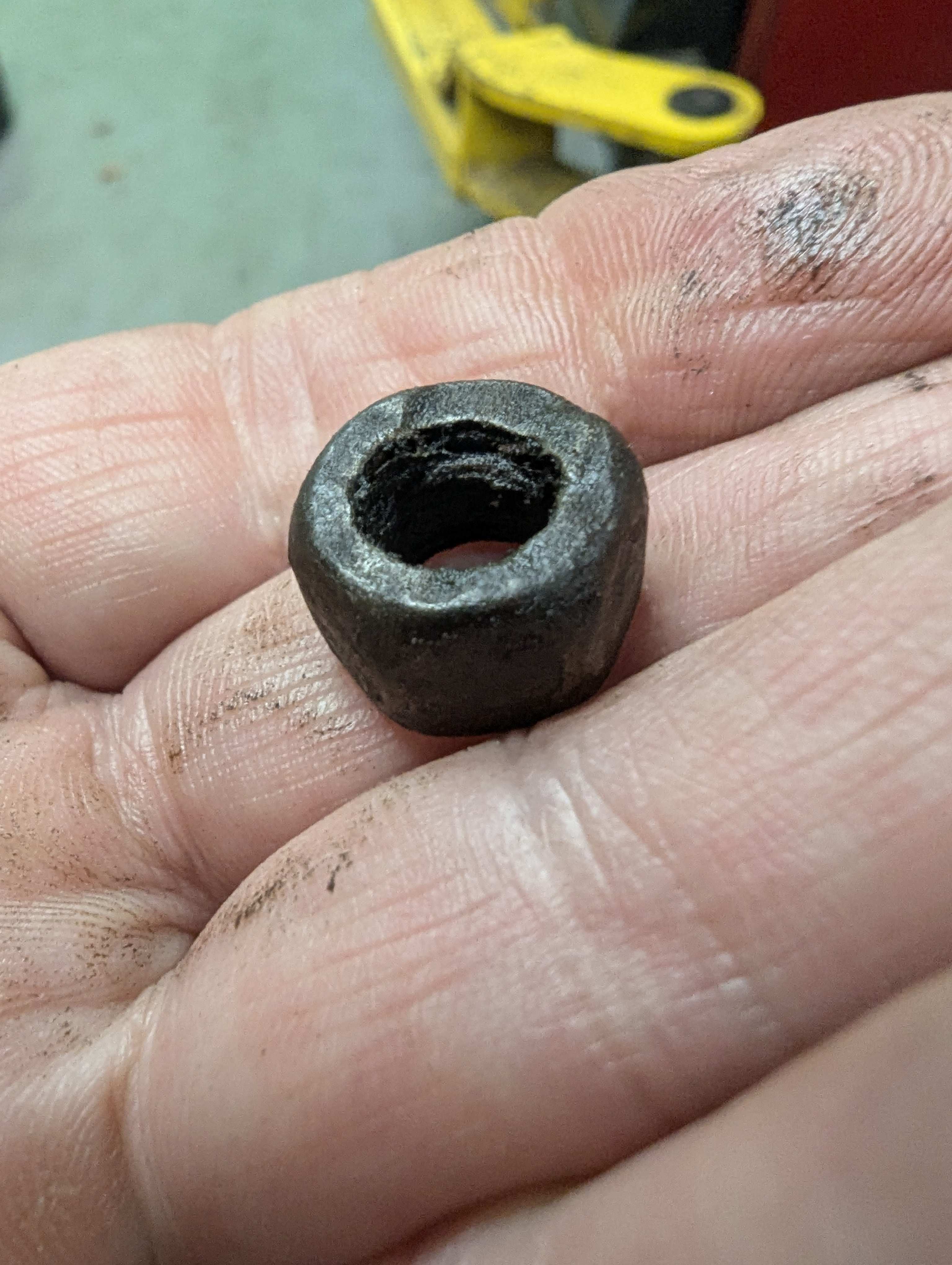

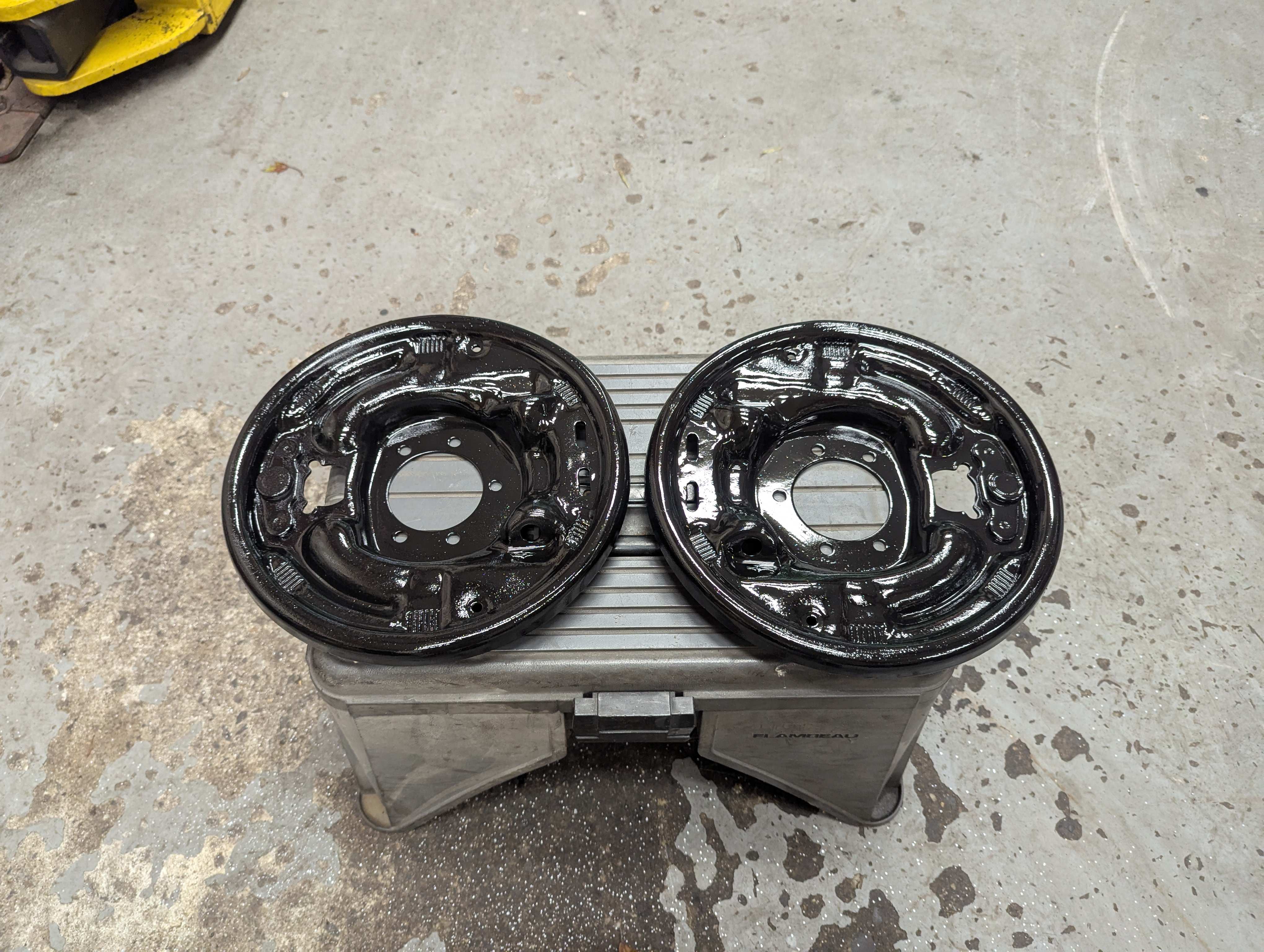

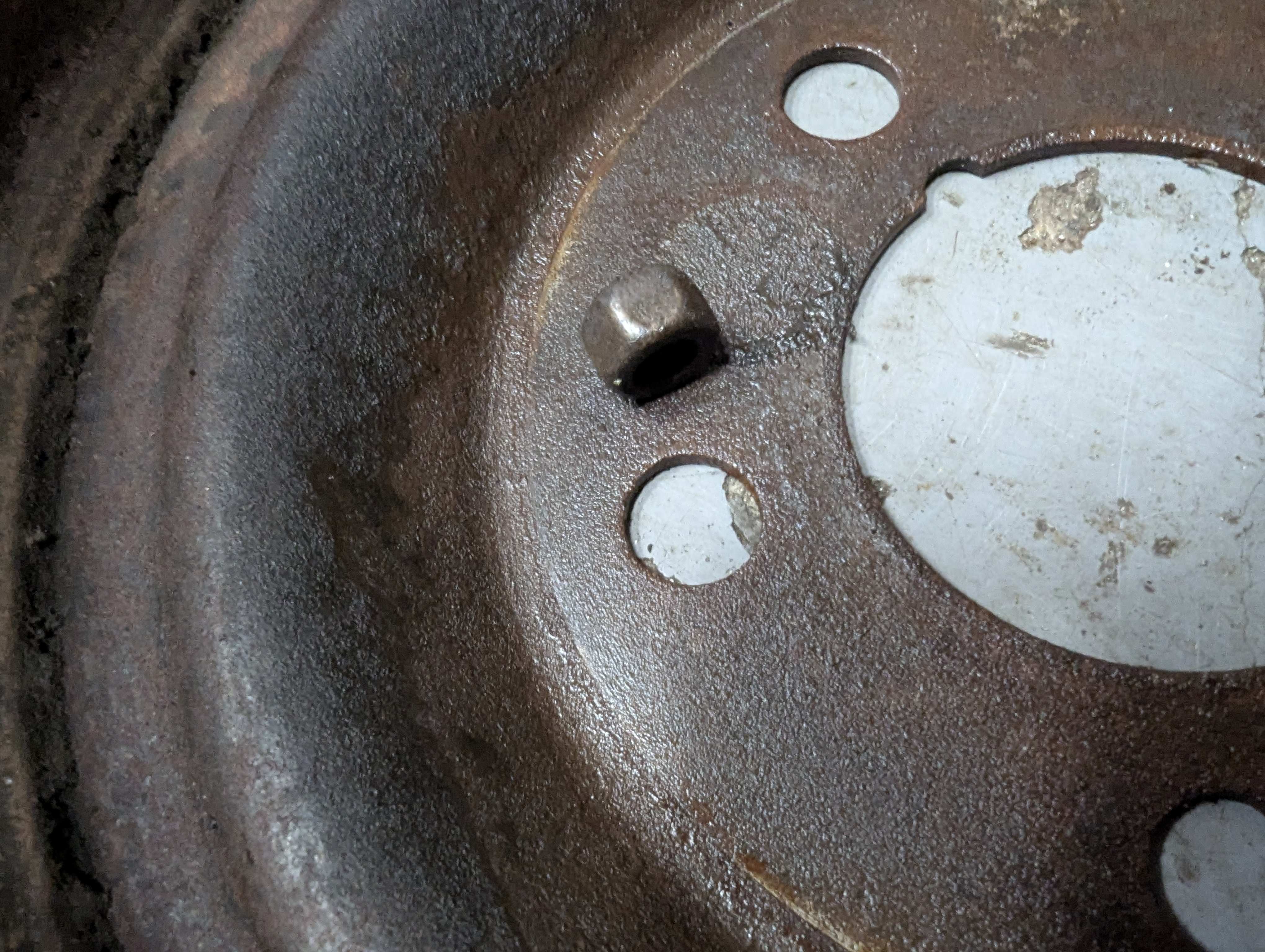

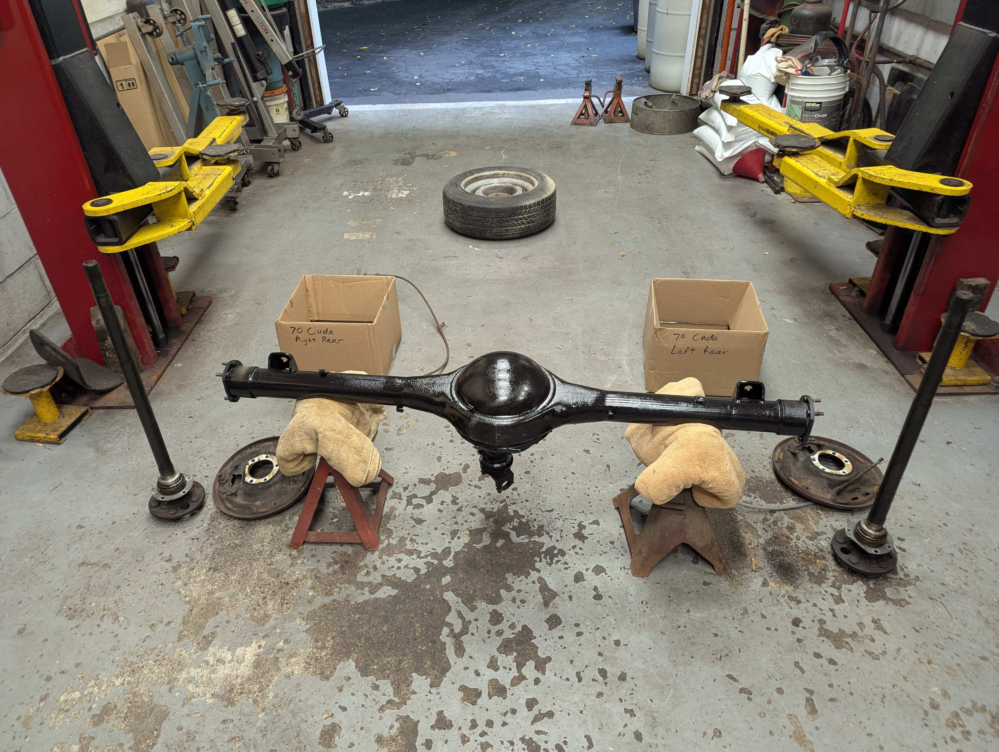

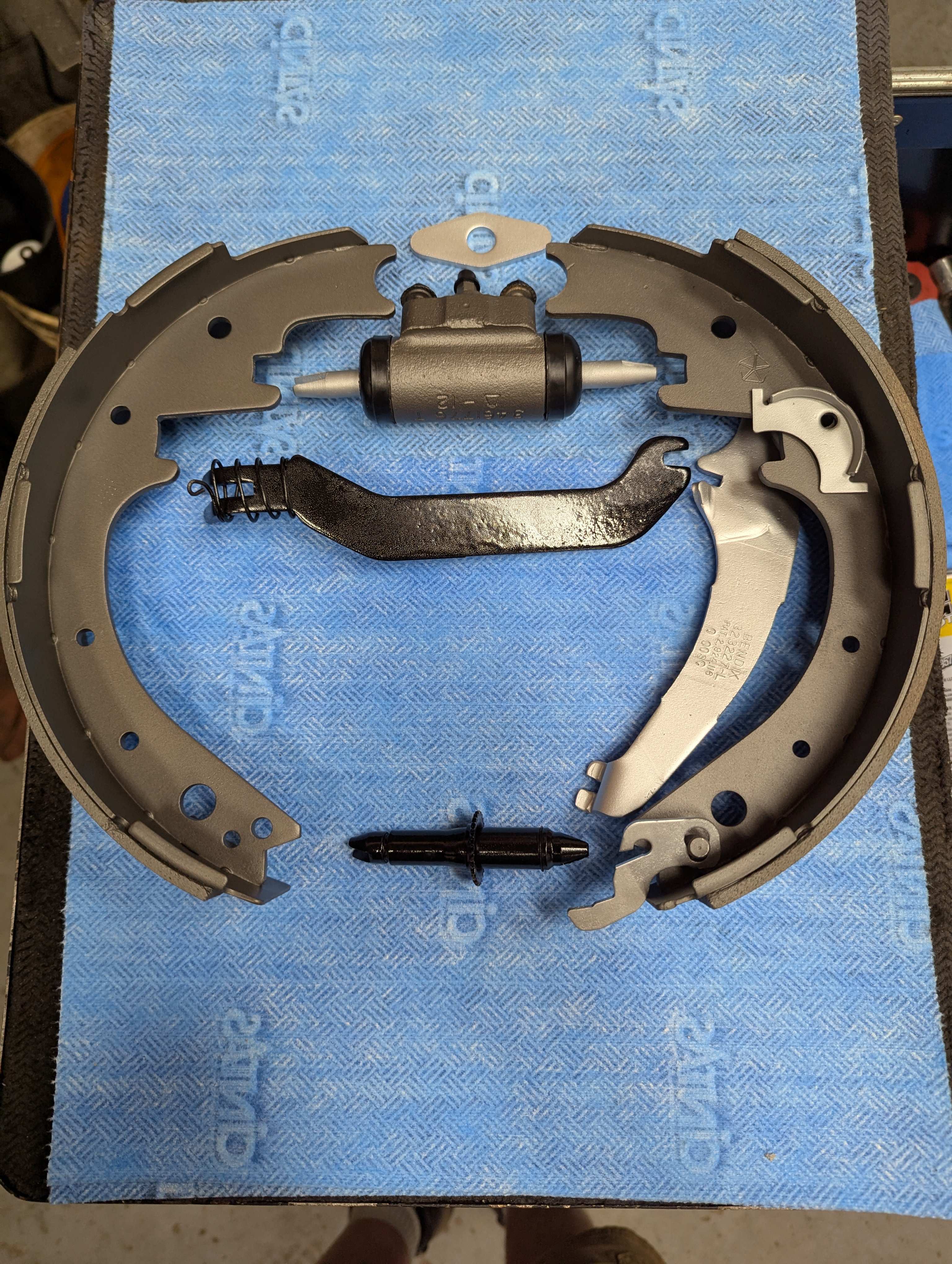

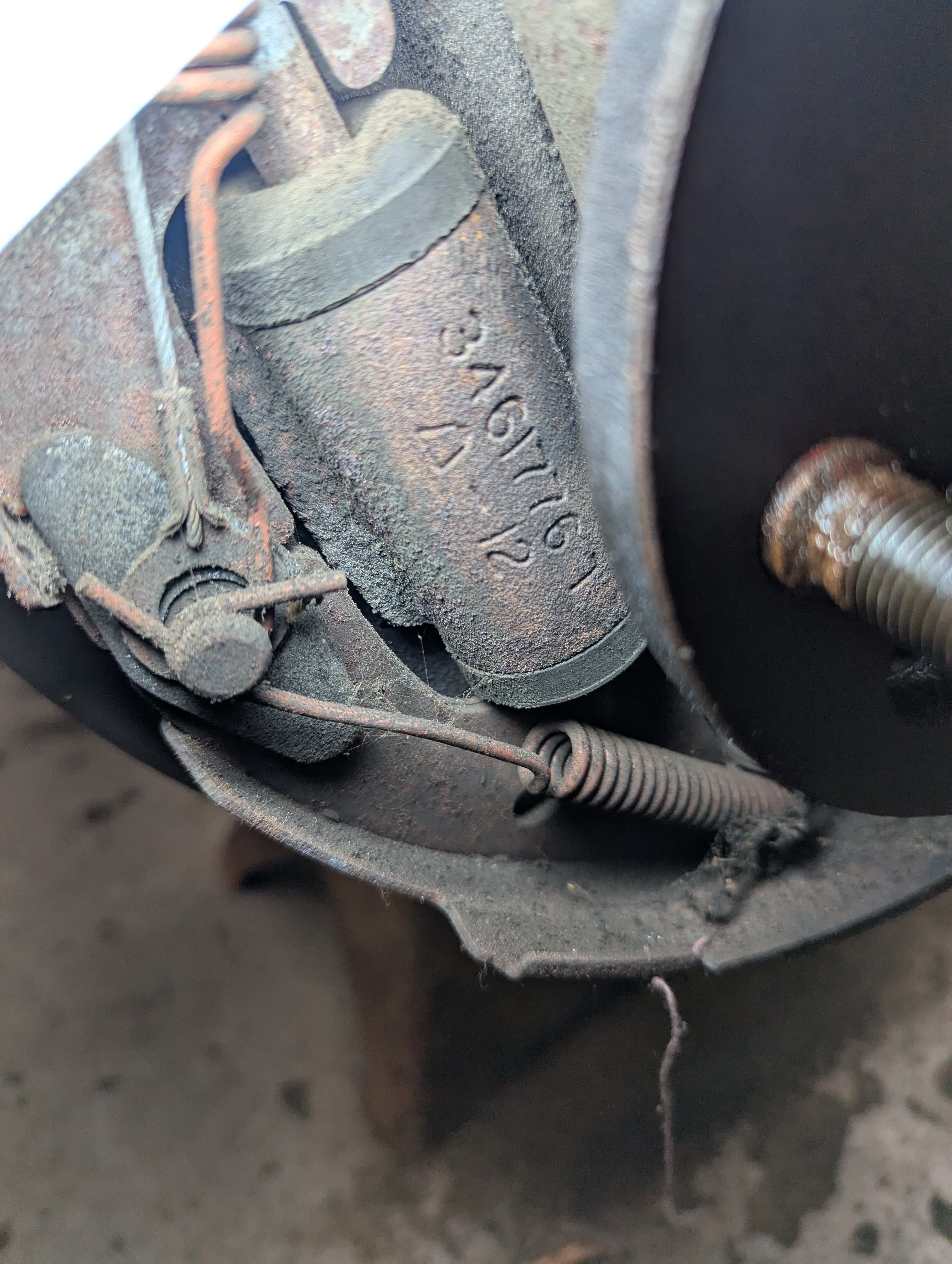

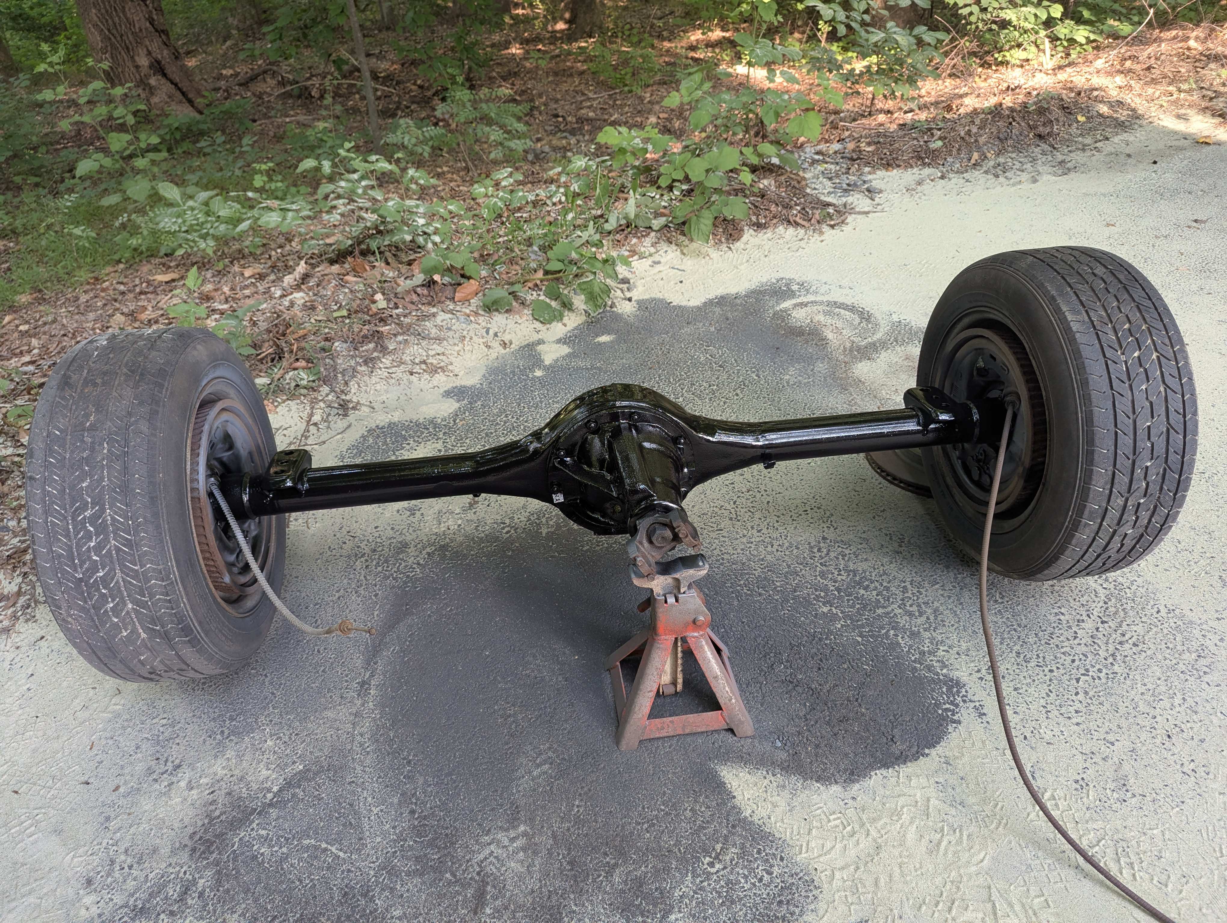

I blasted the differential outside since it was easy to roll around with the wheels and all still on it. Repainted it after I primed it and then rolled it inside. I was pleasantly surprised when I disassembled the drums and looked inside. One drum on the left side had a nut rolling around inside of the drum. I assumed it was an axle flange nut, but I was wrong. Don't know how it ended up there. Doesn't look like anyone was ever in there before. Everything inside of the drum looked original to me. Still had Mopar wheel cylinders on it with the numbers, and still had pentastar brake shoes on it. One of the studs for the axle plate still had the push on stop to prevent the nut from coming off on both sides. I honed and rebuilt both original wheel cylinders. I cleaned up all the hardware and the brake shoes in my blast cabinet and repainted them, ready to go back on. The drums I have cleaned up and painted and put on a drum lathe at my buddy shop to true them up.

Your car to do as you like, but backing plates would be natural steel color I believe.

This car had never been apart before. The rear backing plates were black when I removed them. I did check references to see what is correct. I did see some pics with steel color, but I'll leave mine black like they were. I think the black is correct for this car....

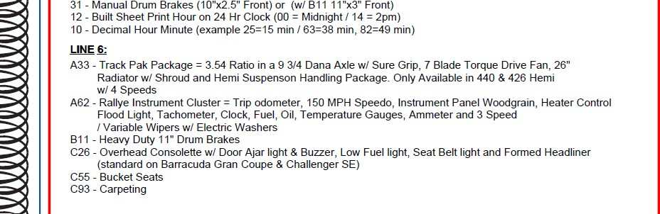

Yes R35 Am/Fm Multiplex. 3 speaker dash. The guy ordered it with the car. Console delete, HD 11in Man brakes, Man Strg, HD suspension....All Business...... :lol:

Most paint would burn off the brake drums after a few years. Some where painted black, a lot were natural and most are rust color after 55+ years! Chrysler typically used semi-gloss (almost a satin) black for any suspension/brake parts. I believe if the rear leaf springs were painted, they were dipped in black paint.
