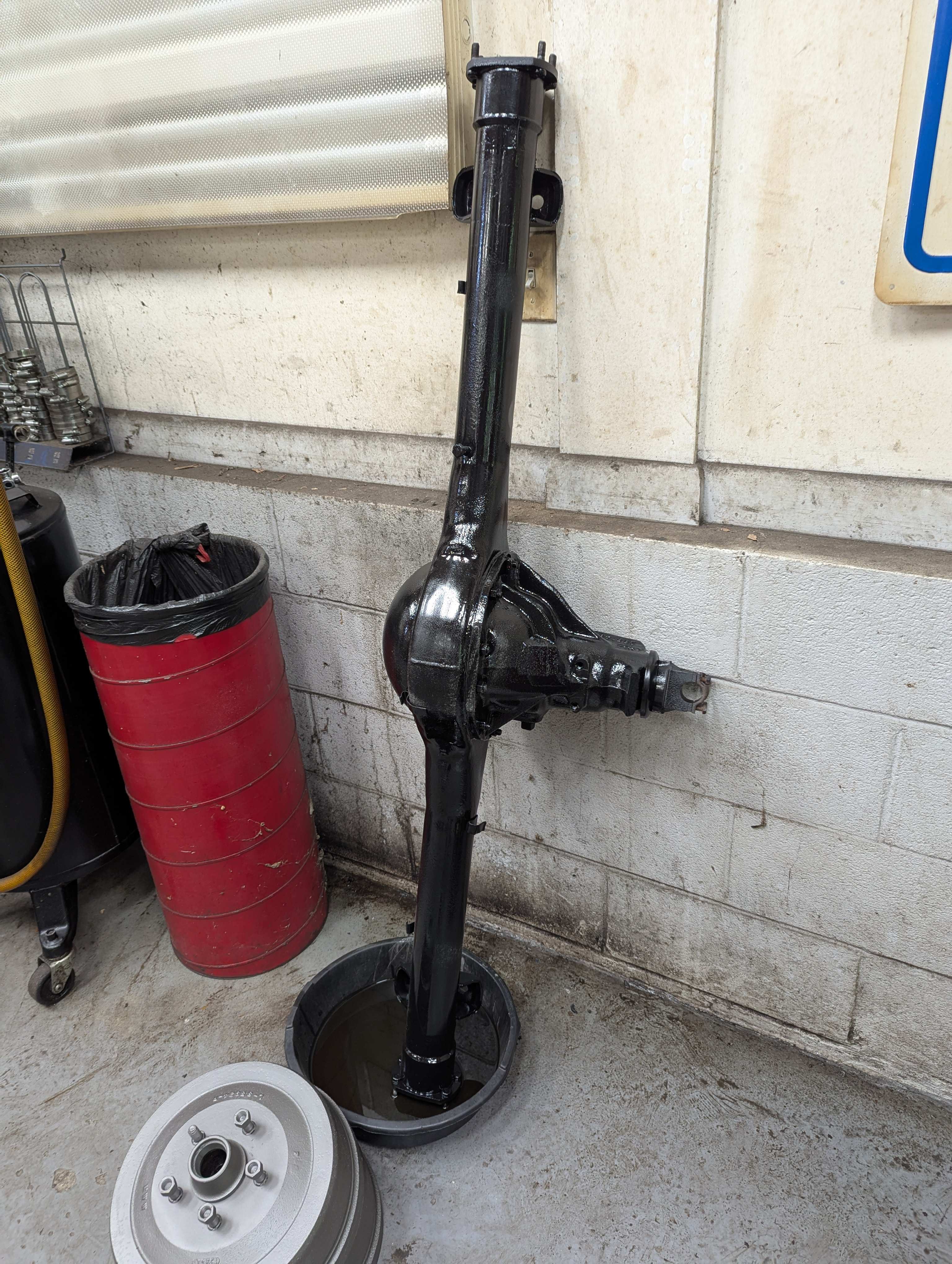

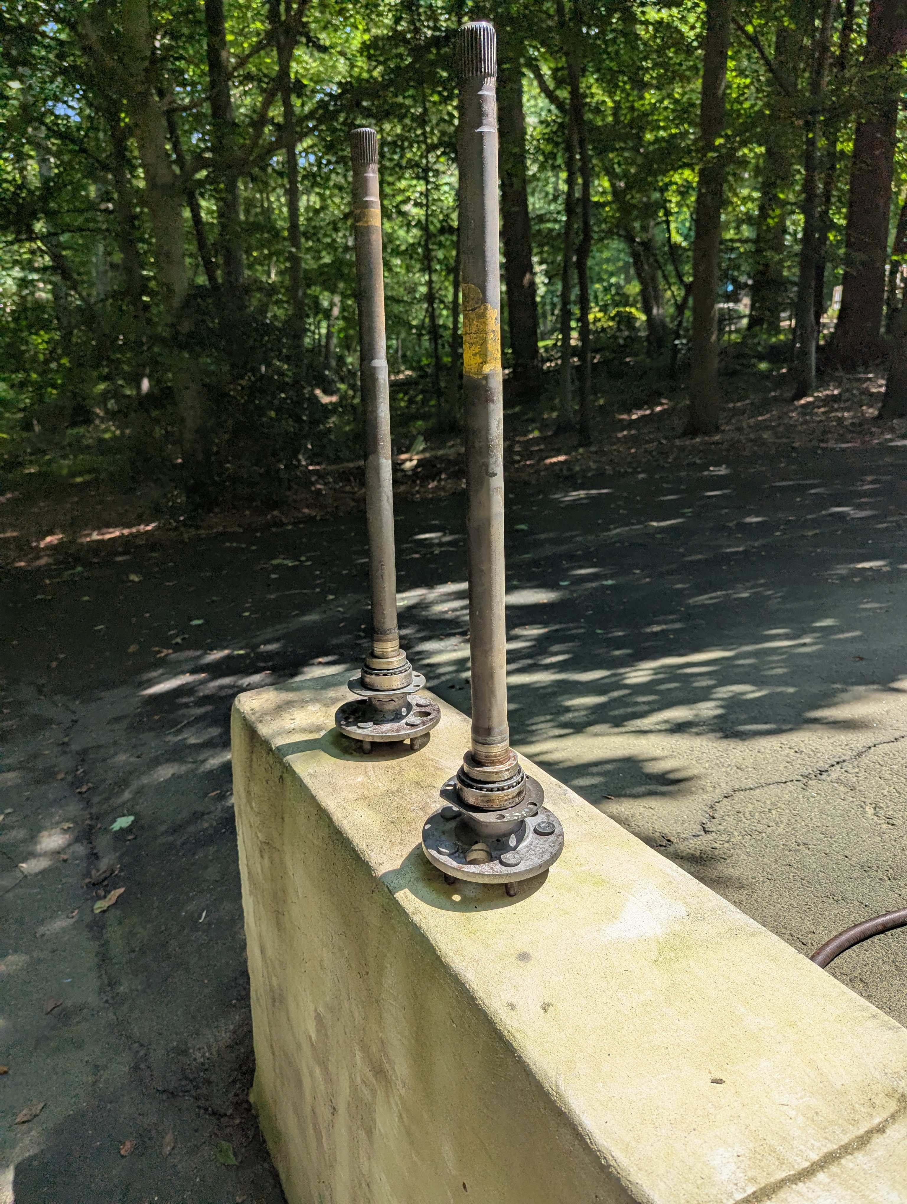

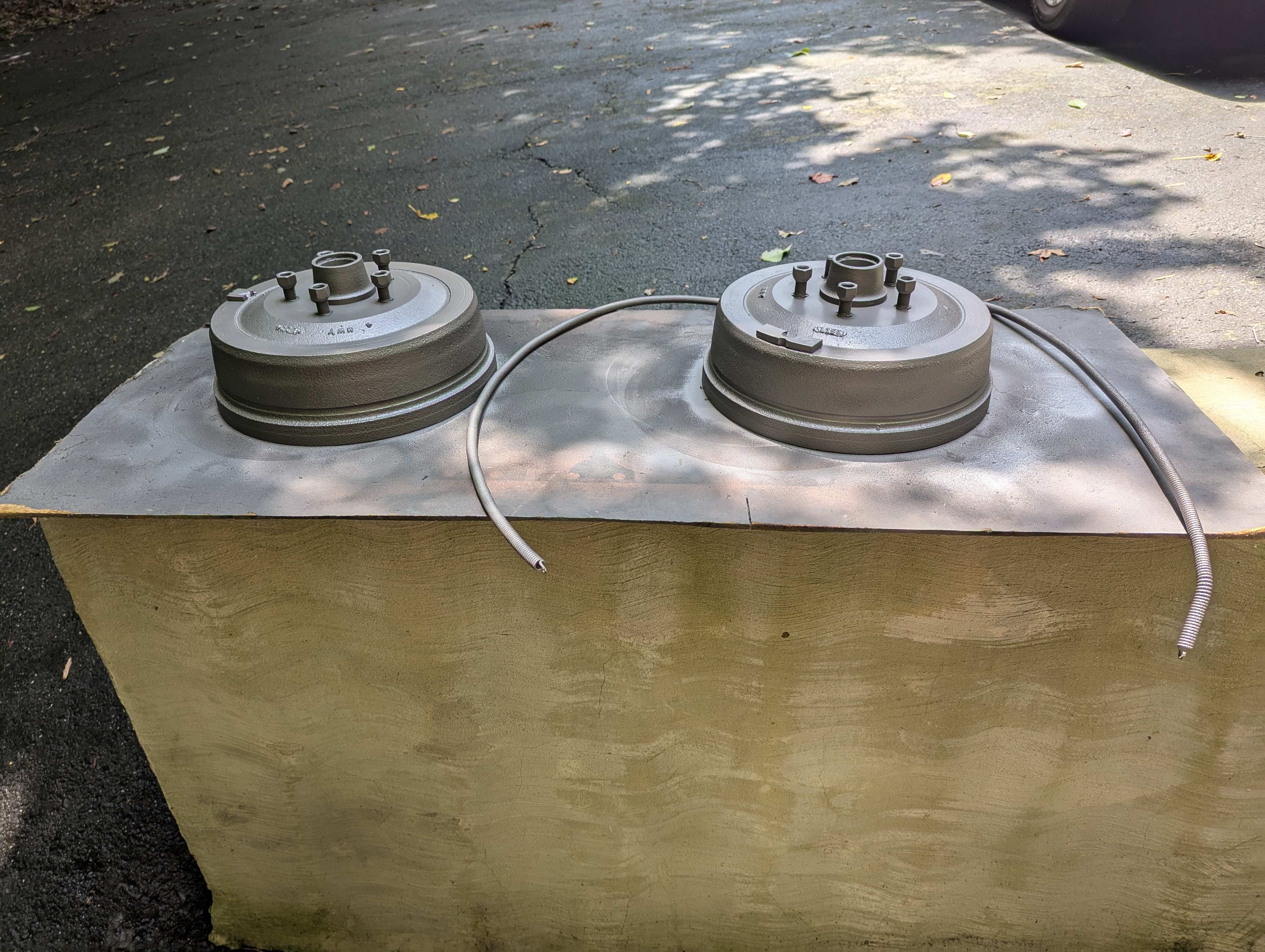

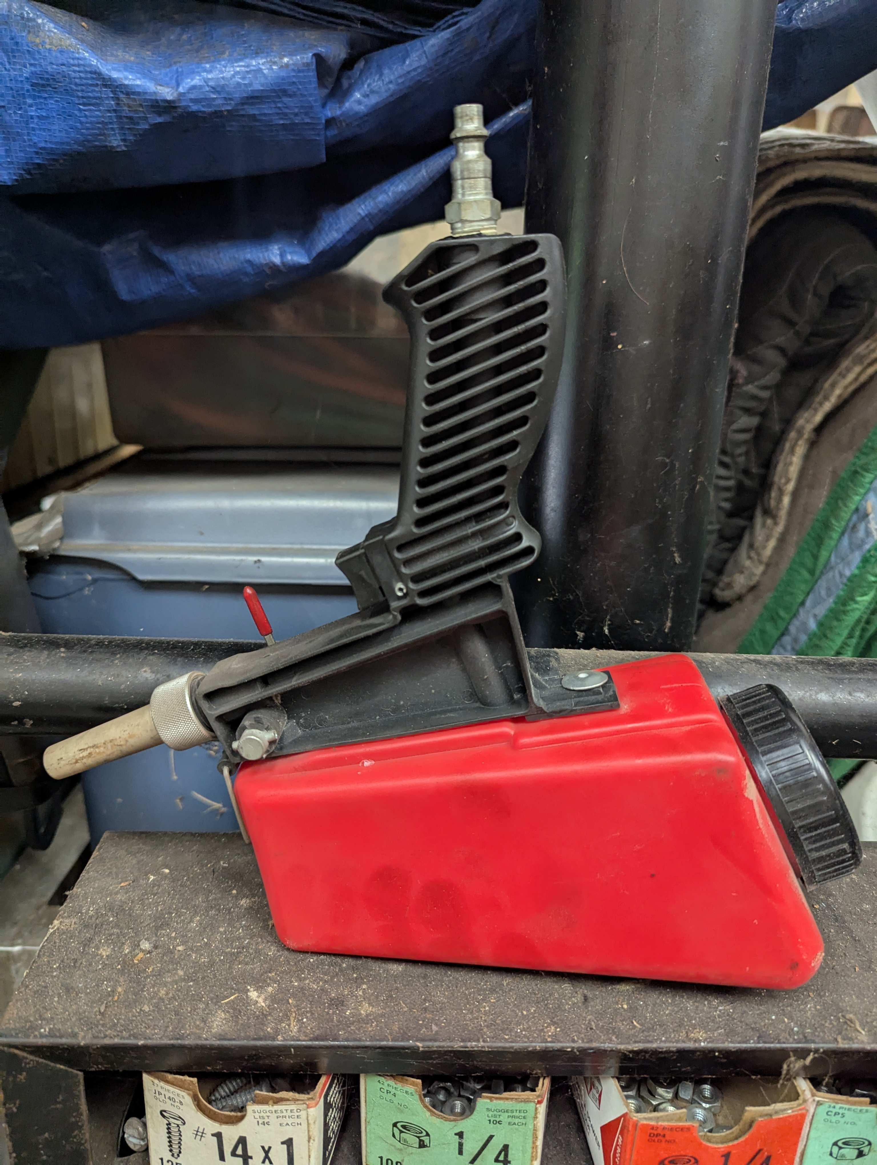

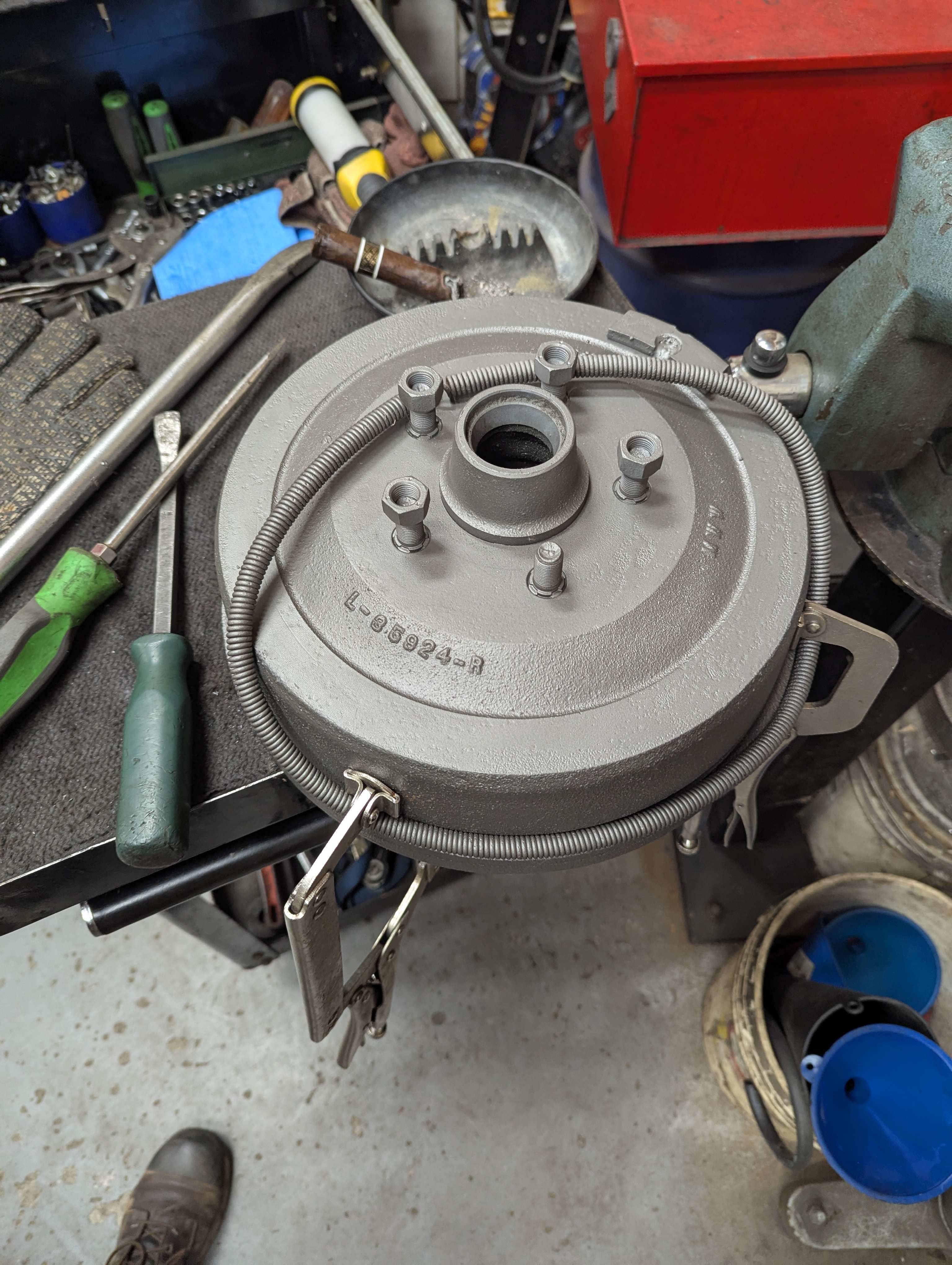

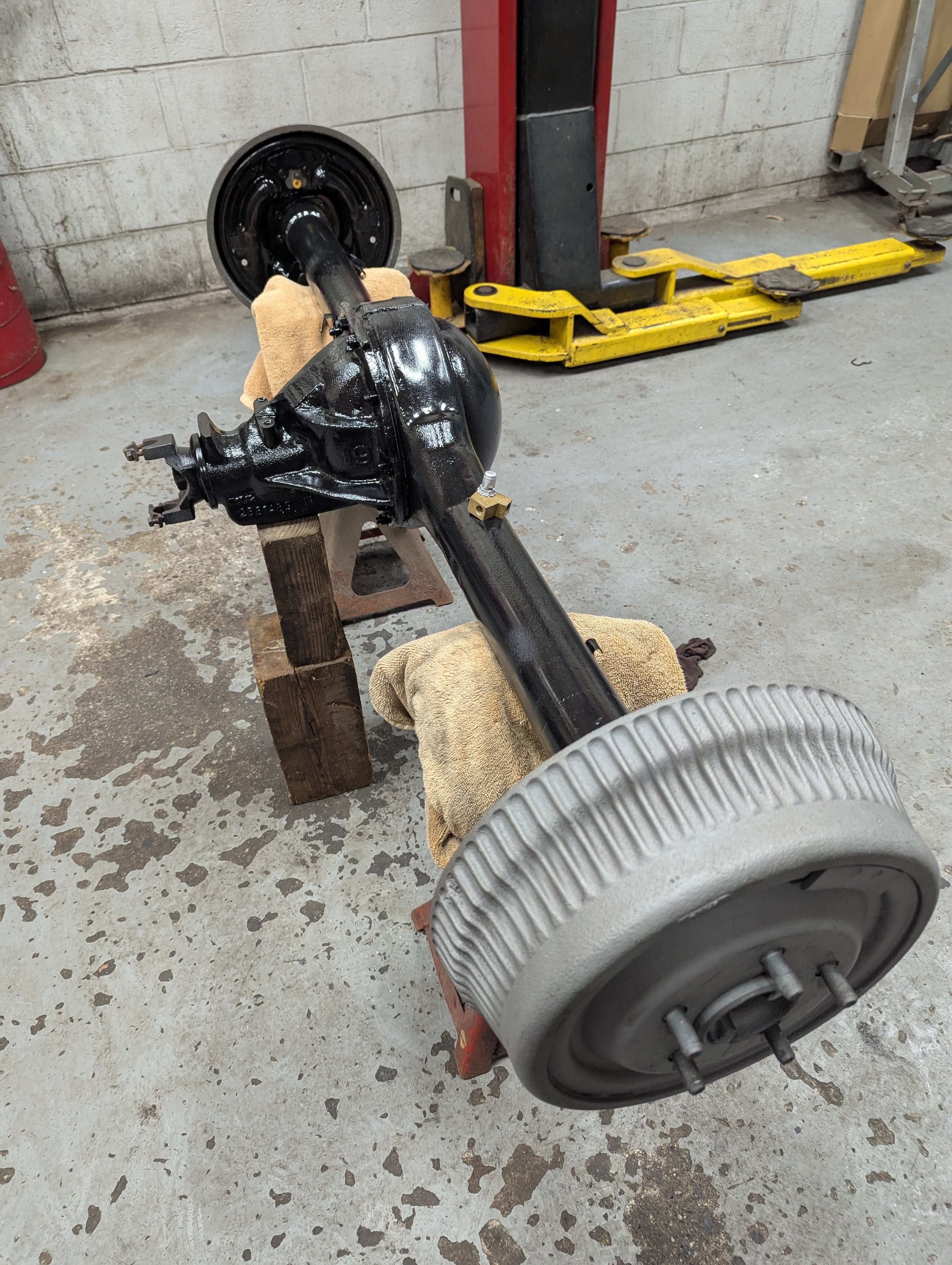

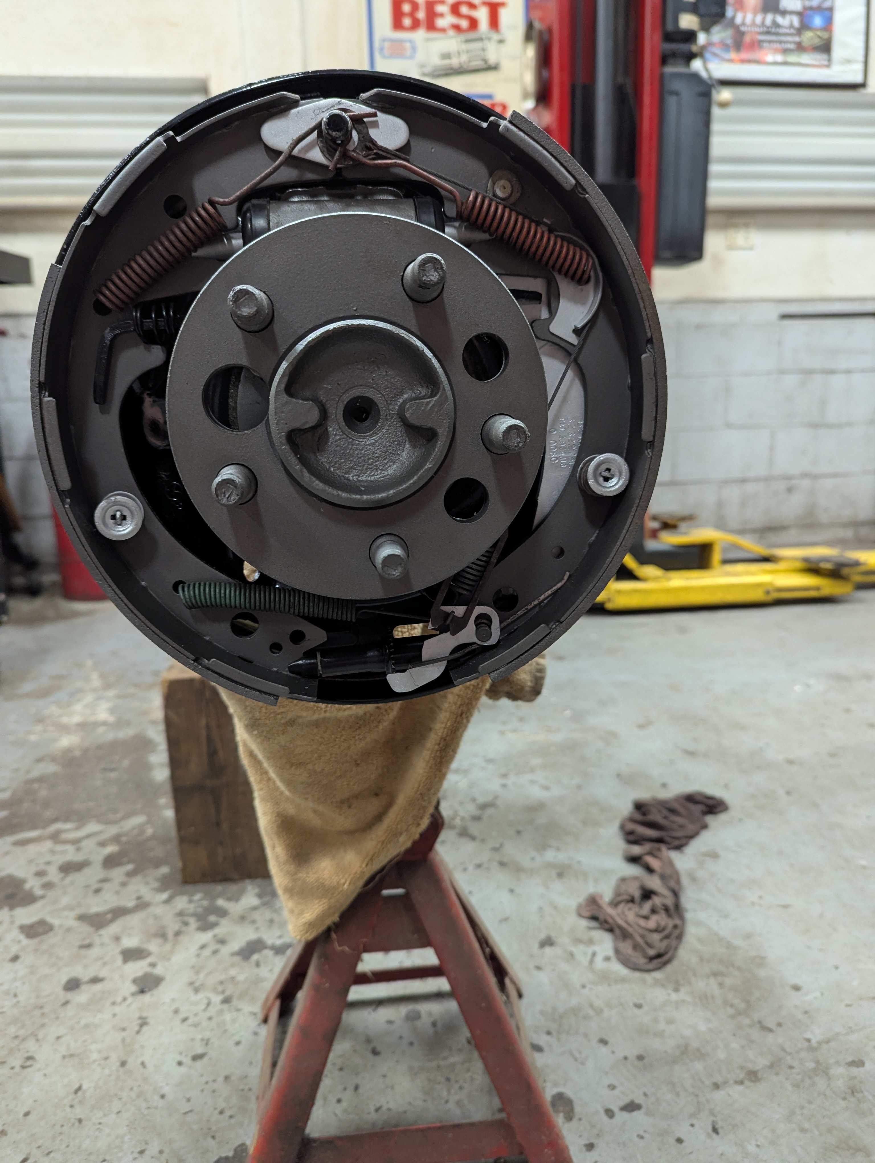

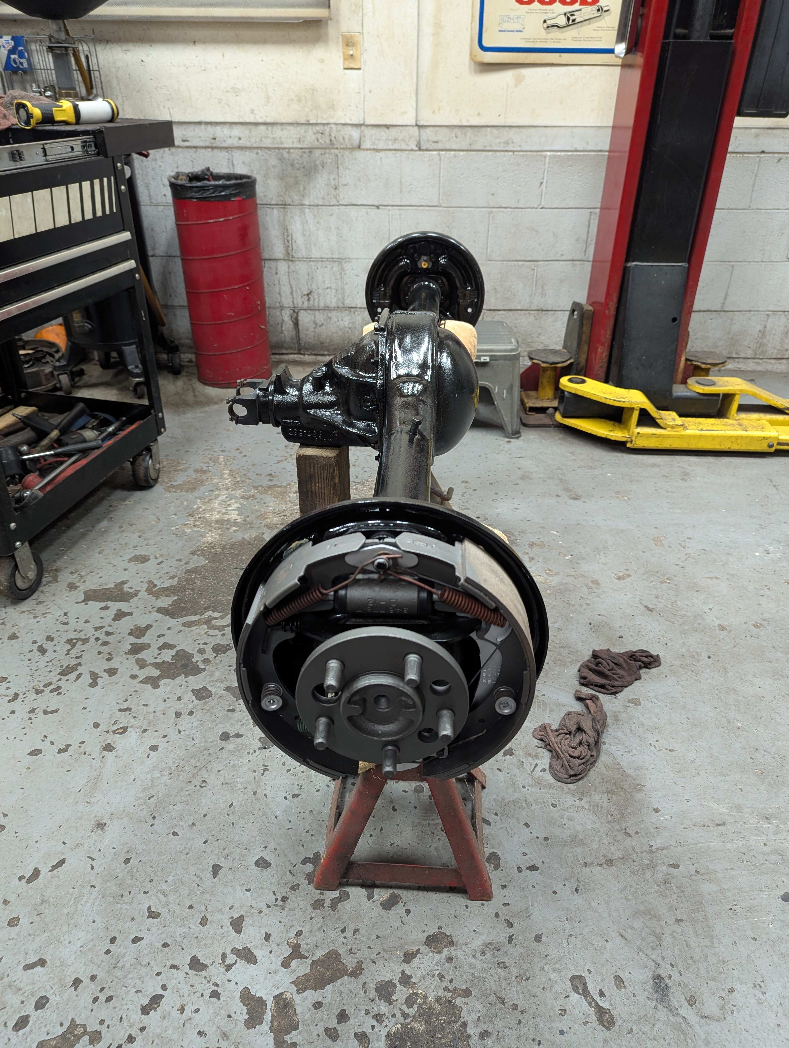

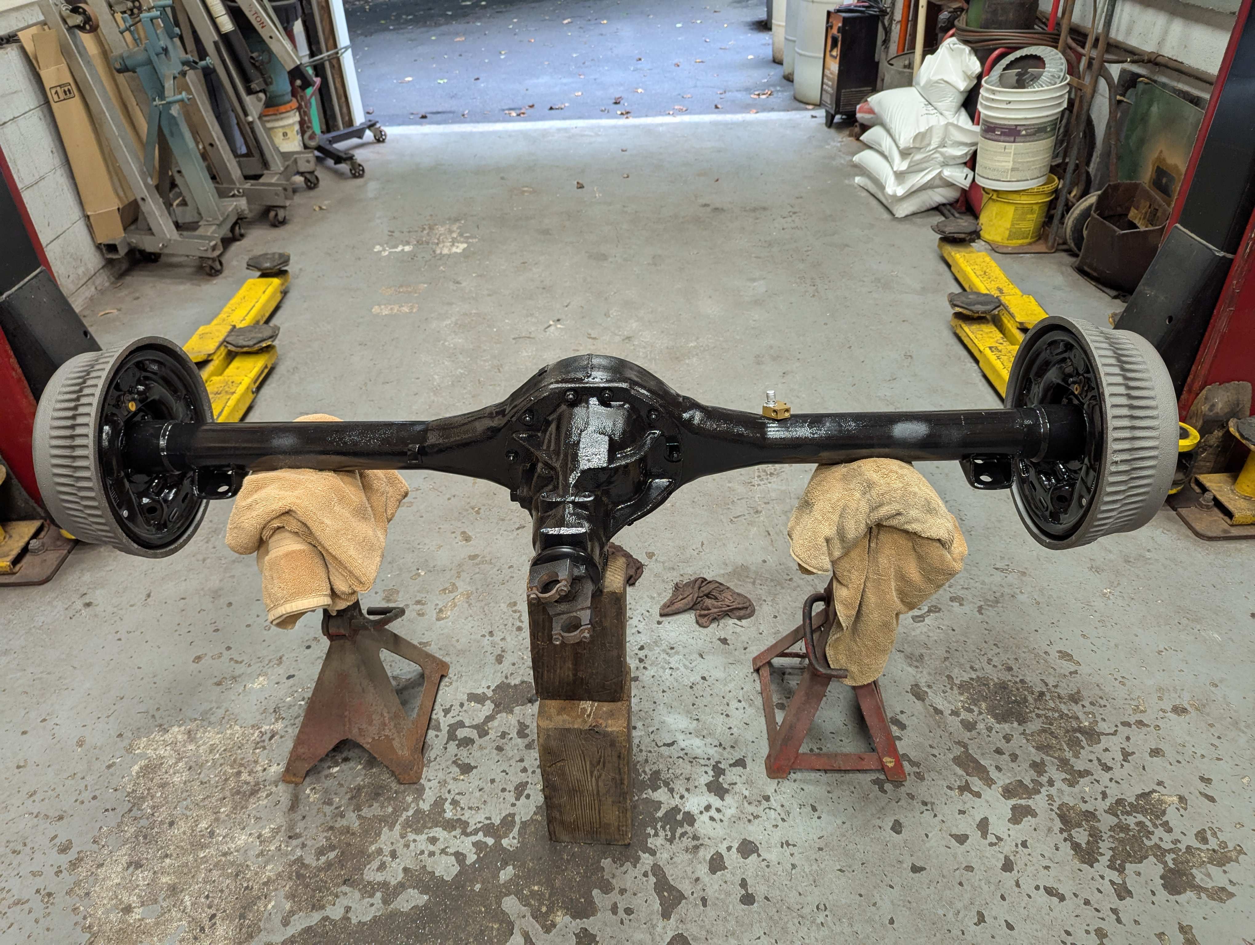

Got front hubs and drums cleaned up and blasted and repainted after they were turned true. I guess I'm getting old and lazy. Didn't feel like pulling the third member. So since I had it apart I just stood it up on the end to drain the gear oil out of it. Gear oil looked good. Will put new fluid in when I install it. Didn't like the way the axles looked either since everything else now is so clean. So hit them with the mini blaster and we'll flush out the wheel bearings again to make sure they are safe before I paint the axles with cast blast.

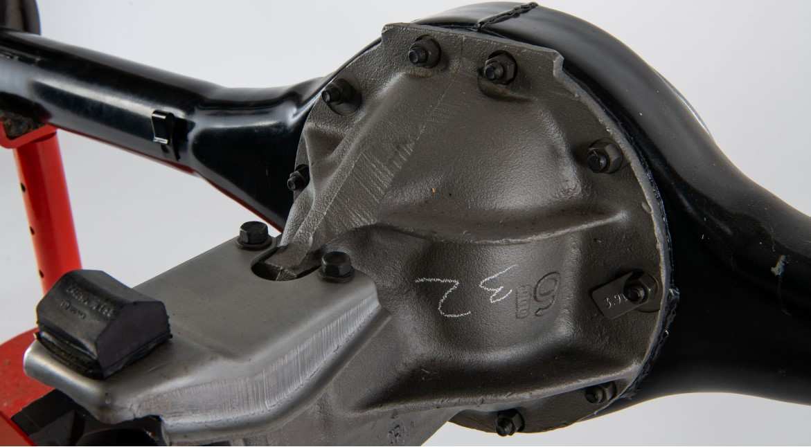

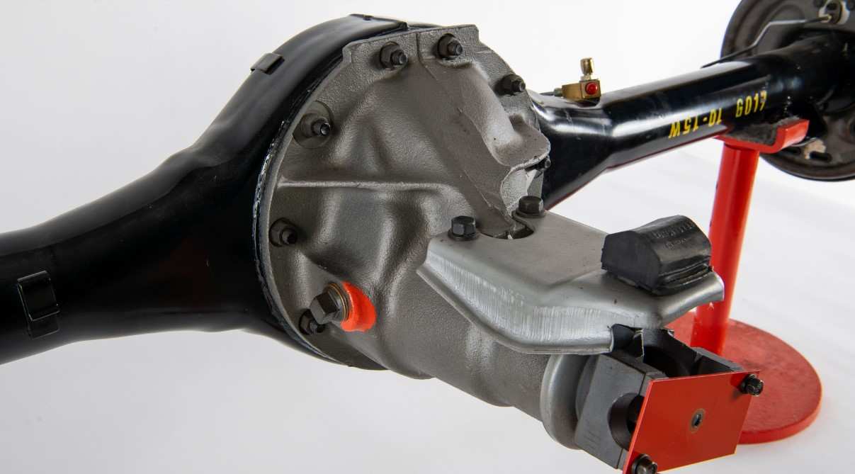

Have you considered pulling the 8-3/4" differential and restoring it to factory-finish (natural)?
