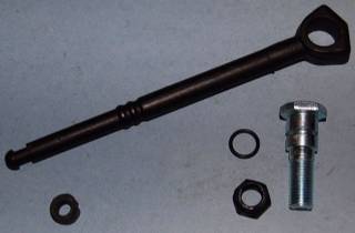

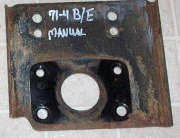

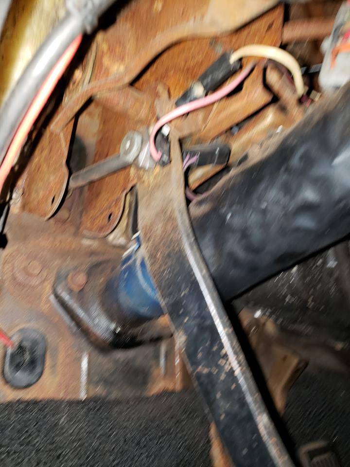

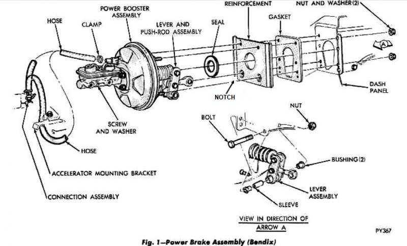

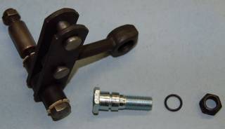

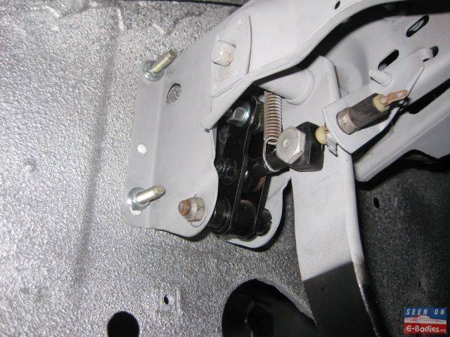

Hi Friends: Does anyone know if there is a different brake pedal for manual brakes than for power brakes? Ever since we rebuilt the 1970 Challenger the brake pedal is way too high, much higher than the clutch pedal. I believe the car originally had manual brakes. Now with the power brake booster, I am wondering how to lower the pedal height. Thanks.

The brake pedal is the same for power and manual brakes. The power brake pedal linkage to the booster is shorter. The manual brake setup just uses a rod to the master cylinder.
