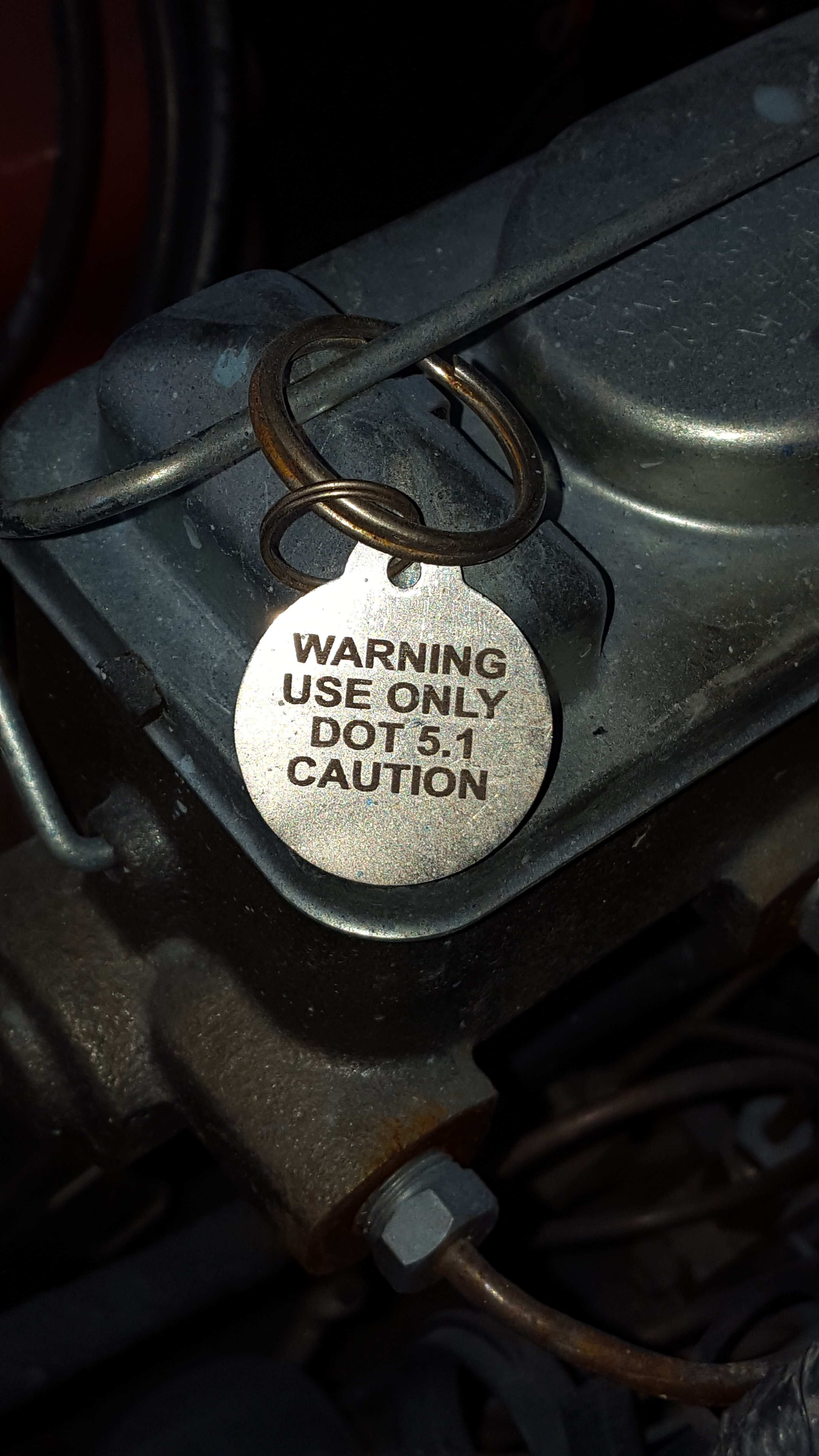

We can use dot 5.1 with our stock systems?
You have to purge the system and start over.
Ideally start with new components. Short of that make sure to get rid of ALL the old DOT 3/4 fluid as they are incompatible. The pedal feel will be different after converting to the purple stuff too!
I dont want to go through all the stuff that is good will just stick with dot 3 and get myself back to square 1
