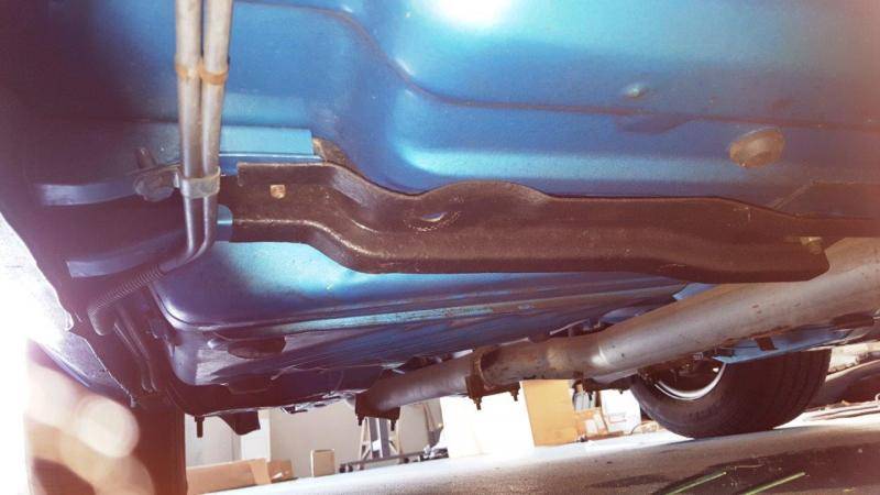

I am missing 2 of the reinforcing bars for the seat bolts under the floor ,they also have 2 square dimpled plates to reinforce the bolt area are they available after market .

Picture is an A66 originally done by Bill Allphin in Cincinnati .
See bracket below was it model specific

So these were specific to the 340 cars?
When the car was restored he used a rusted out SE for parts & transferred the Electric windows,6 Way seats & electric trunk release to the A66
The brackets were only fitted to the 6 way buckets due to the extra weight & stress ,I was using the A66 for reference a lot of parts from the TA i am restoring were missing as it has normal buckets i will not need .
