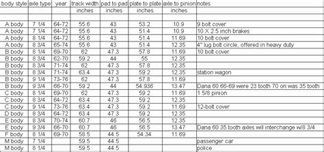

I have the opportunity to purchase a 1967 net Yorker 8 3/4 I am getting conflicting results from the internet Is this a doable swap into a 72 challenger? Yes I do know anything is doable with enough work but is this a easy swap thanks
It will bolt right in. The differences are:
Total width is 1/4"? narrower
Axle flange thickness is narrower
Brass brake block and vent location is different, so pre built brake lines won't work
It may have 11"×2" brakes
