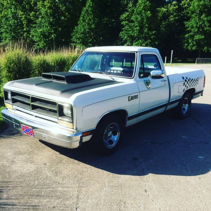

Vehicle: 1989 D100 Will see maybe 1000 miles a year as it's mainly a toy

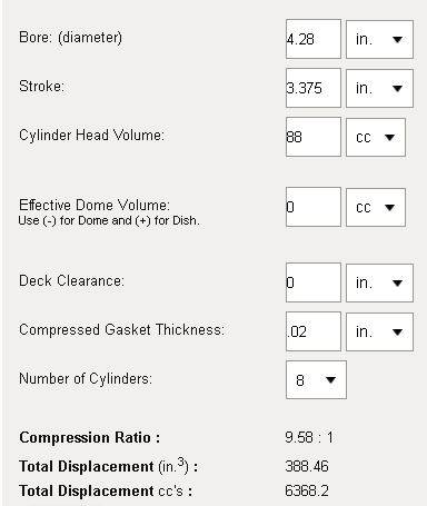

Block: 1968 383 bored 30 over
Pistons: Flat top @ zero deck NO valve relifs
Head Gaskets: Steel .020 crush
Heads:1968 250 casting code. Have 2.14/1.81 valves installed and are not shaved.Will be home ported
Intake: Torker 383 with gasket match porting
Carb: Holley 4160 750cfm Vacuum secondary
Gearing: 3.55 posi 9.25"
Stall: 3000 B&M Holeshot in a 727
Weight: About 3800 with me in it
I plan to rev it no higher than 6000
I need something that will give me good power, but not have too large a lift at 50 and cause a piston to strike a valve.
