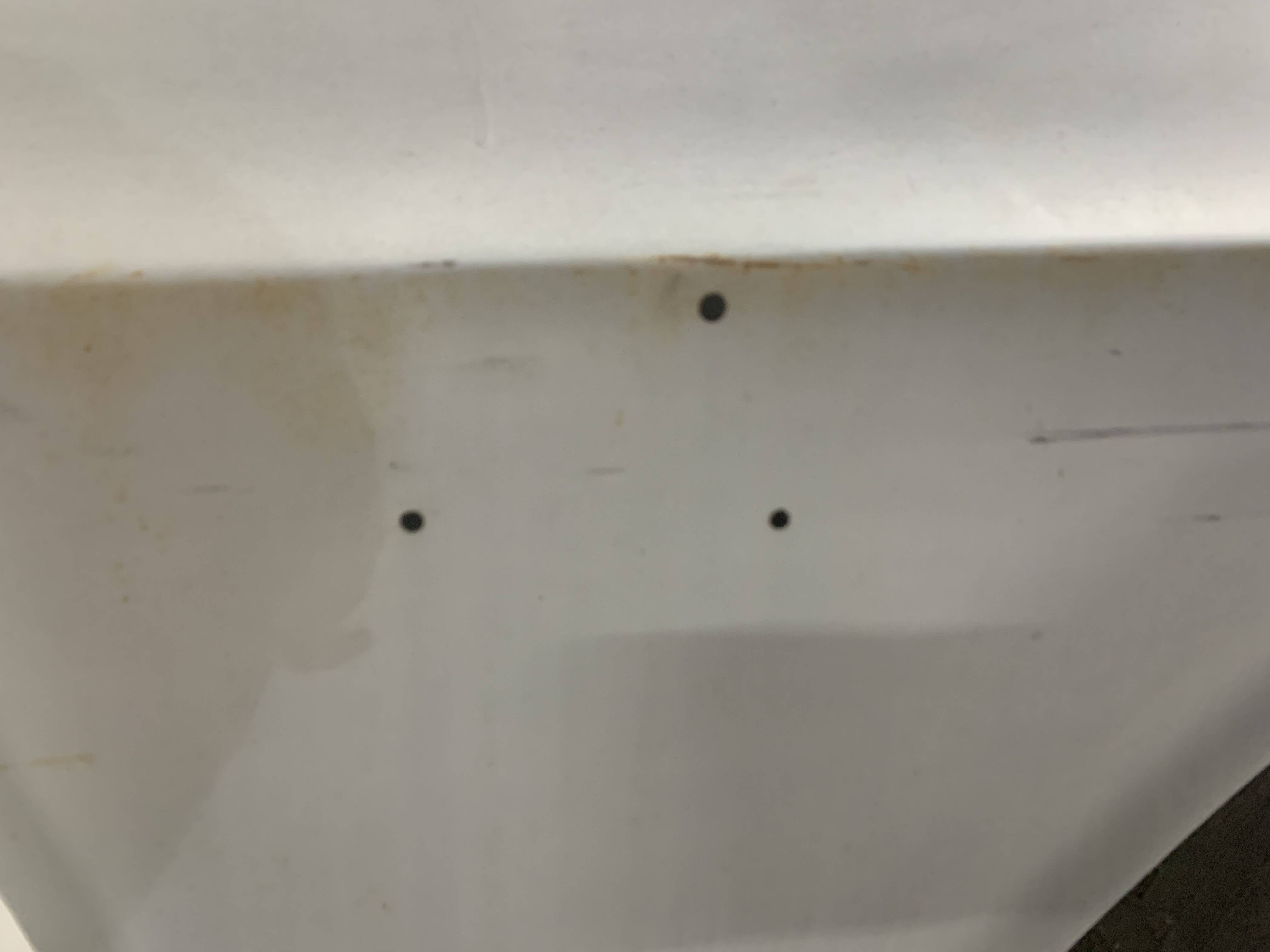

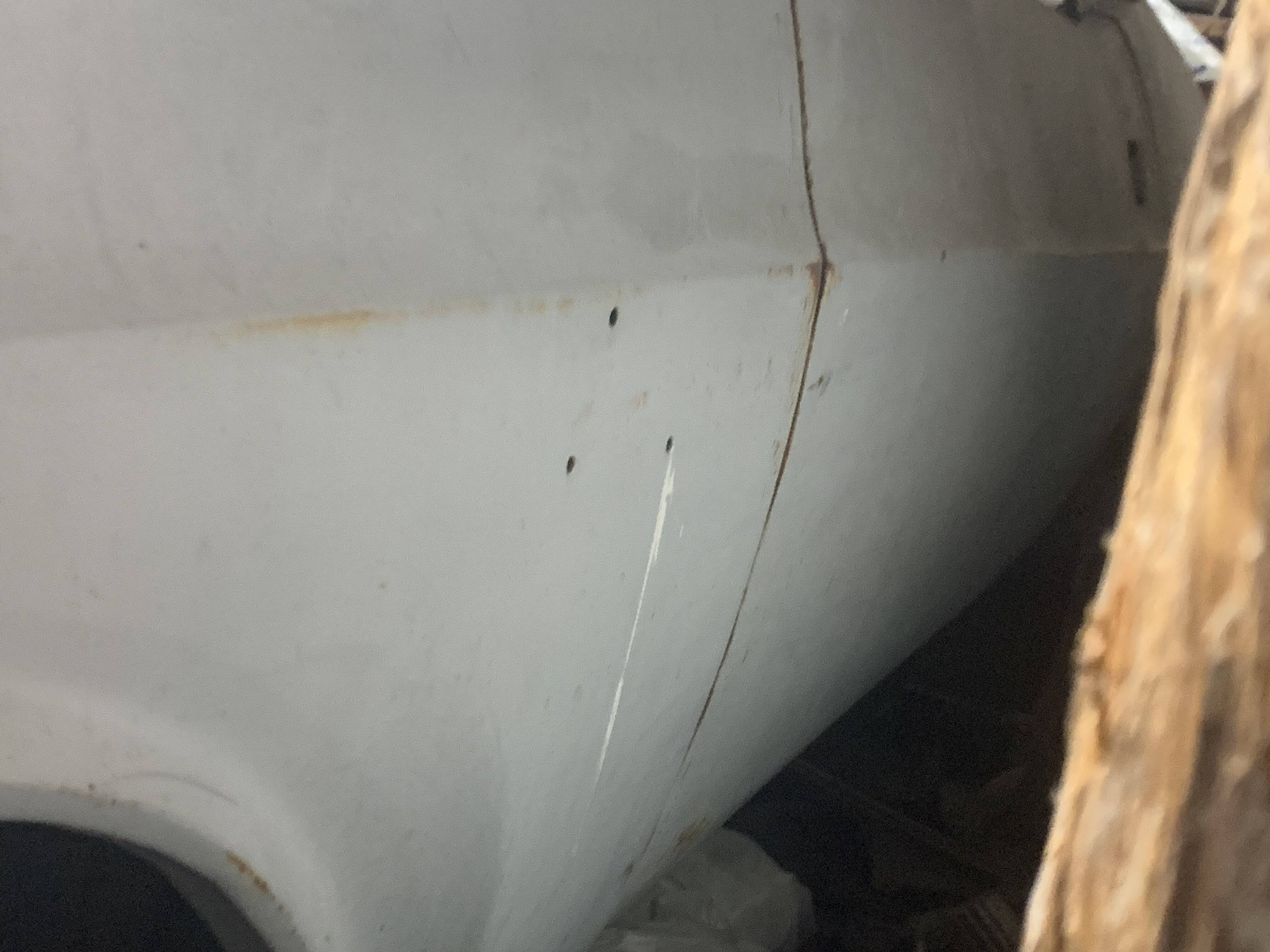

If the car had fender mounted RT badges than it would have the holes in the fenders, however if they got the longitudinal stripe than the would not be any holes since the "R/T" is part of the stripe.

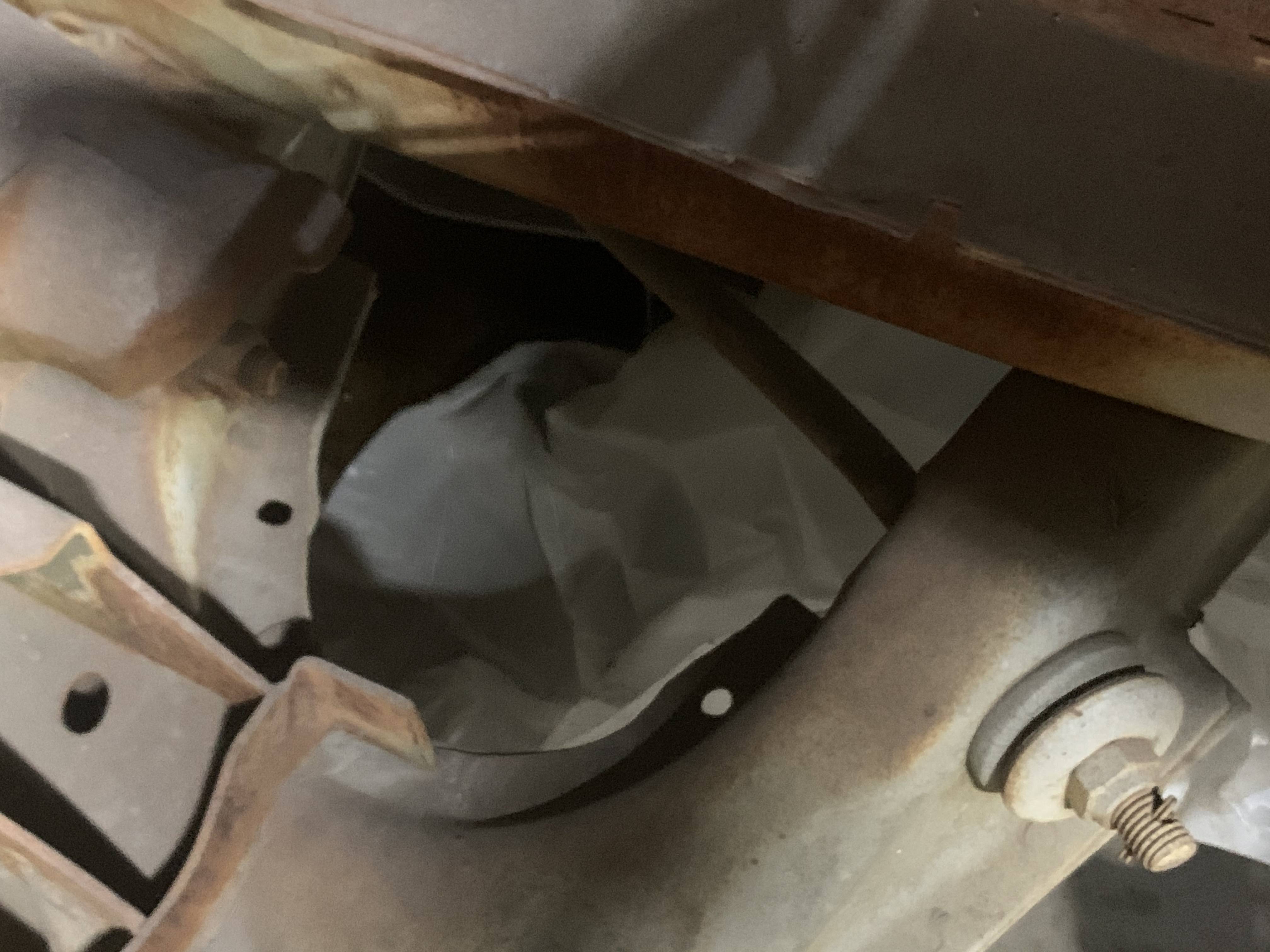

The RT part doesn't mean it would have torque boxes, those were a result of the engine choice such as 440, 440 8 pack and Hemi. I do not know if they 340 and 383 cars got them or were supposed to get them. There are many reports of cars that should have had them that didn't, my 70 Challenger is a 440 car and it has them.

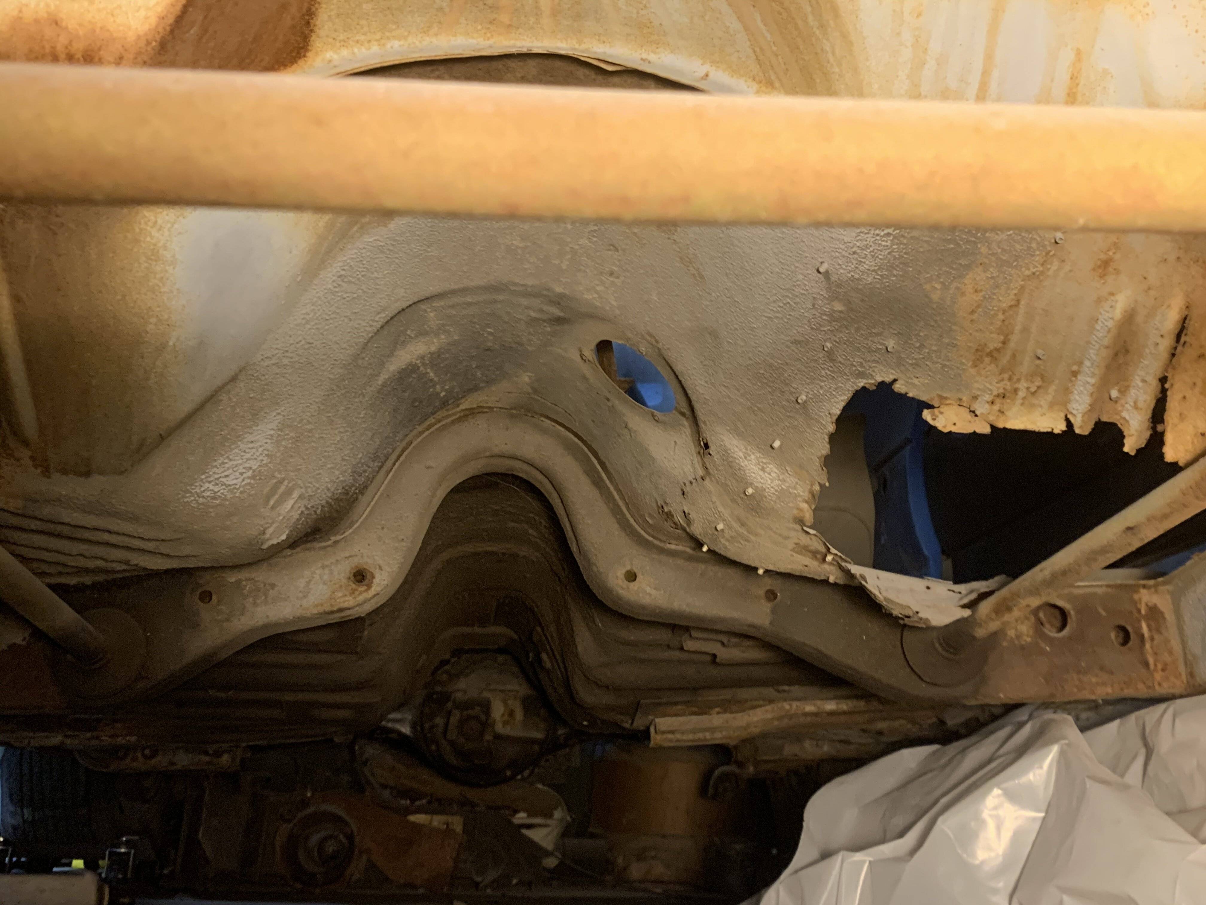

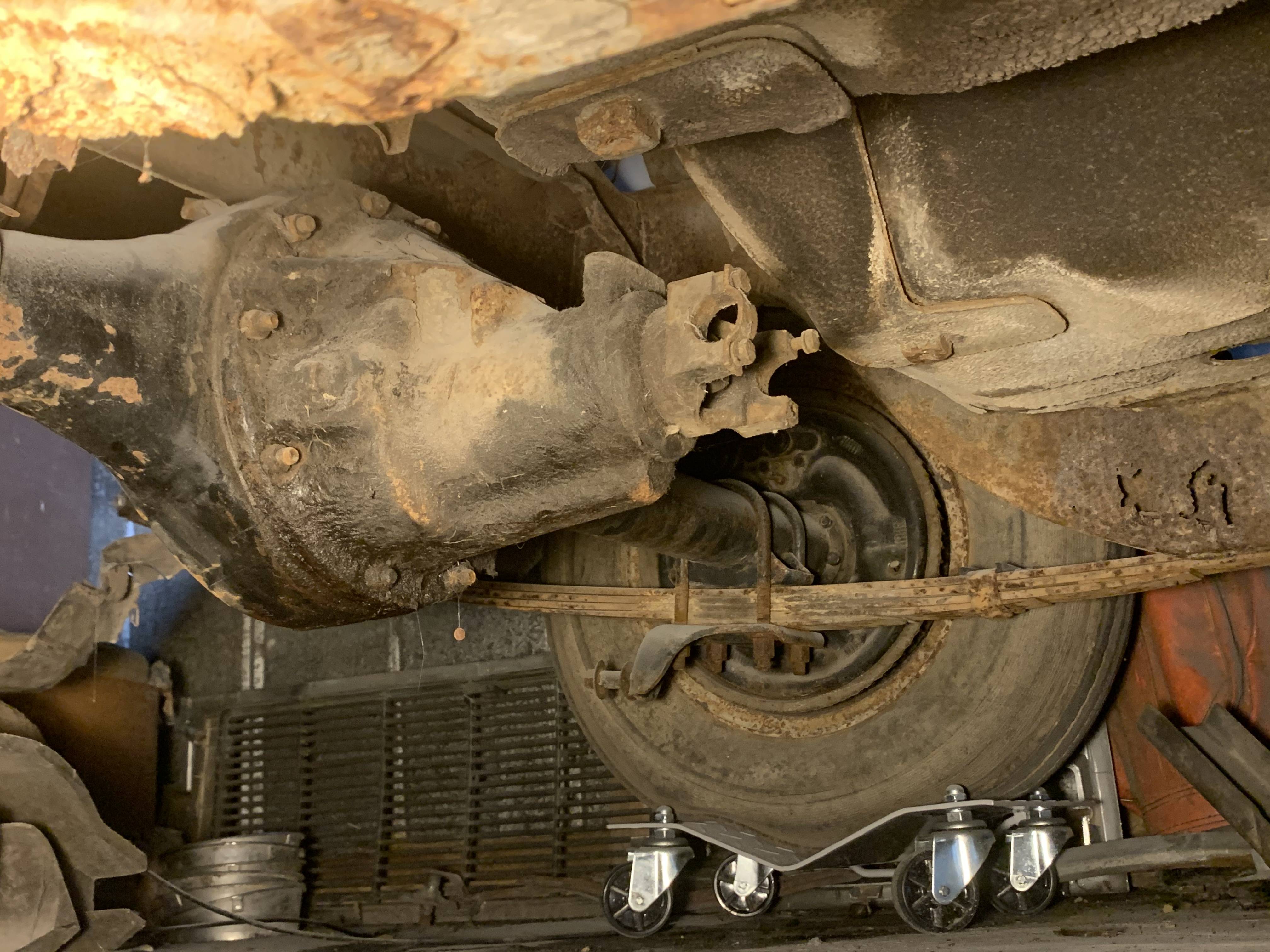

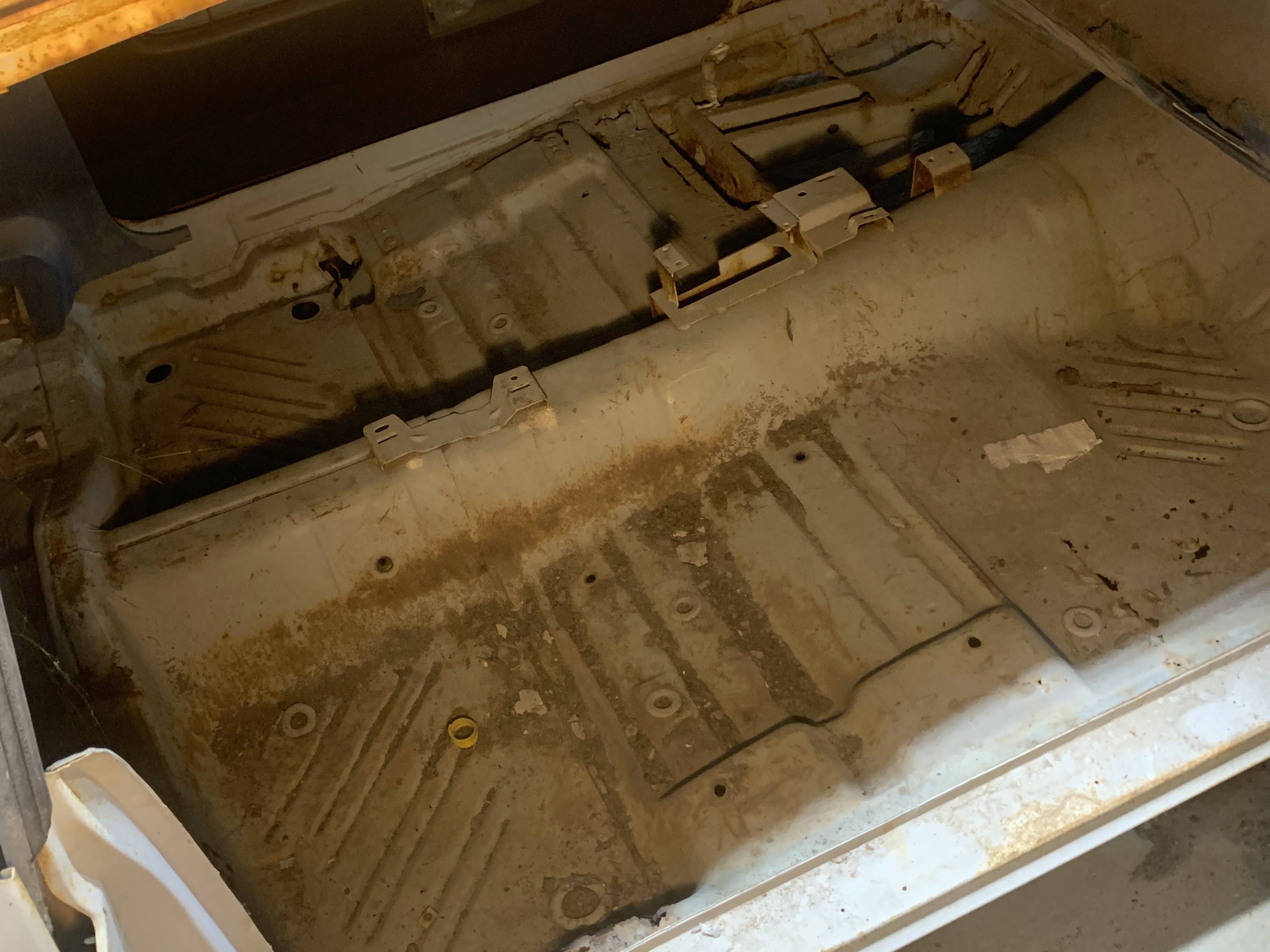

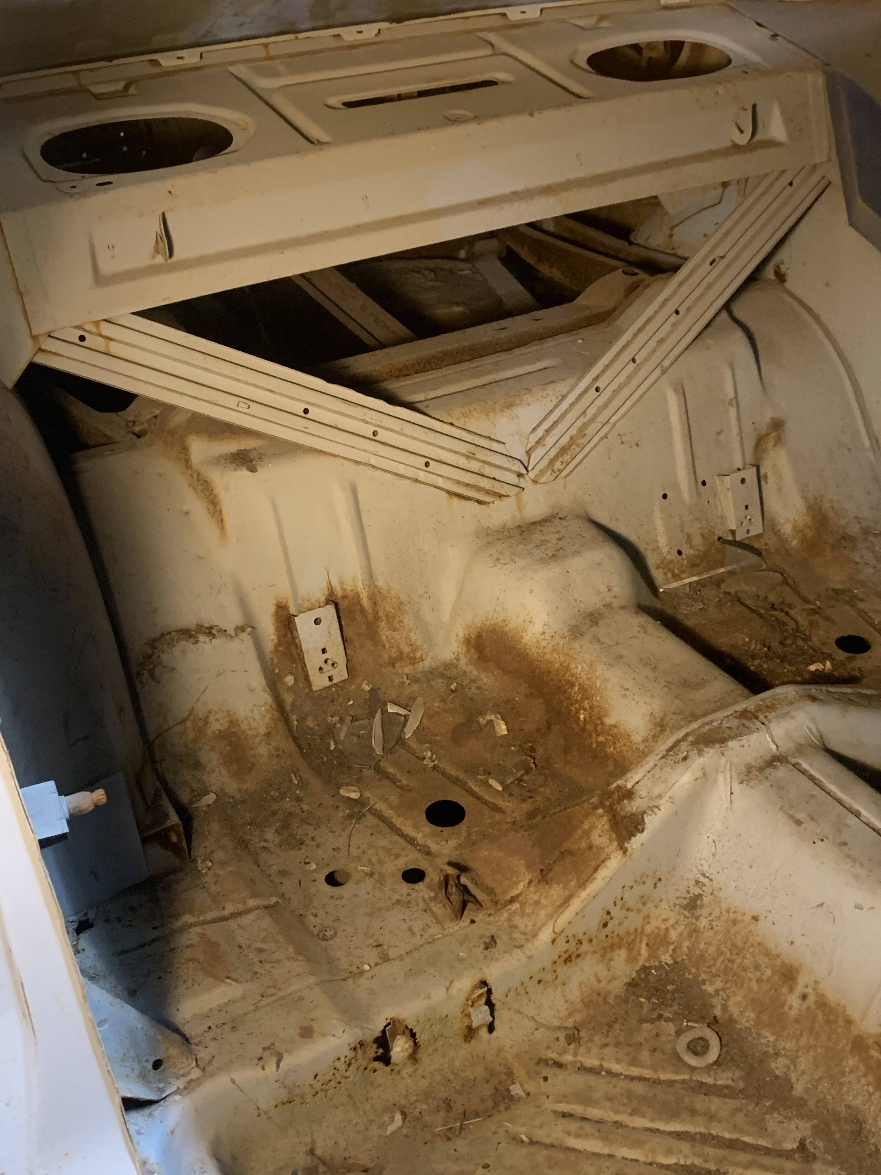

Here’s more pictures. It doesnt have sure grip rear end no posi trac done checked.

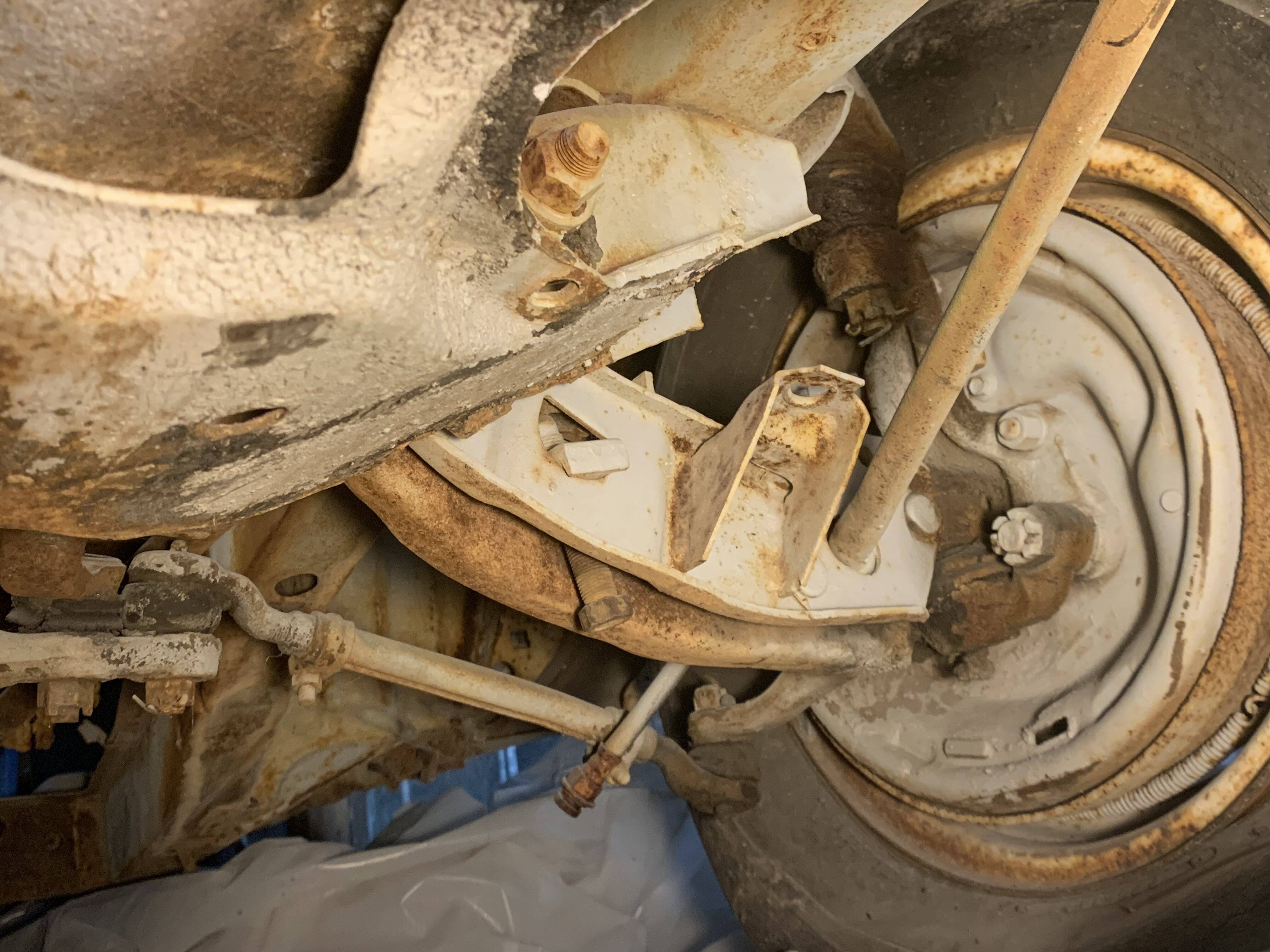

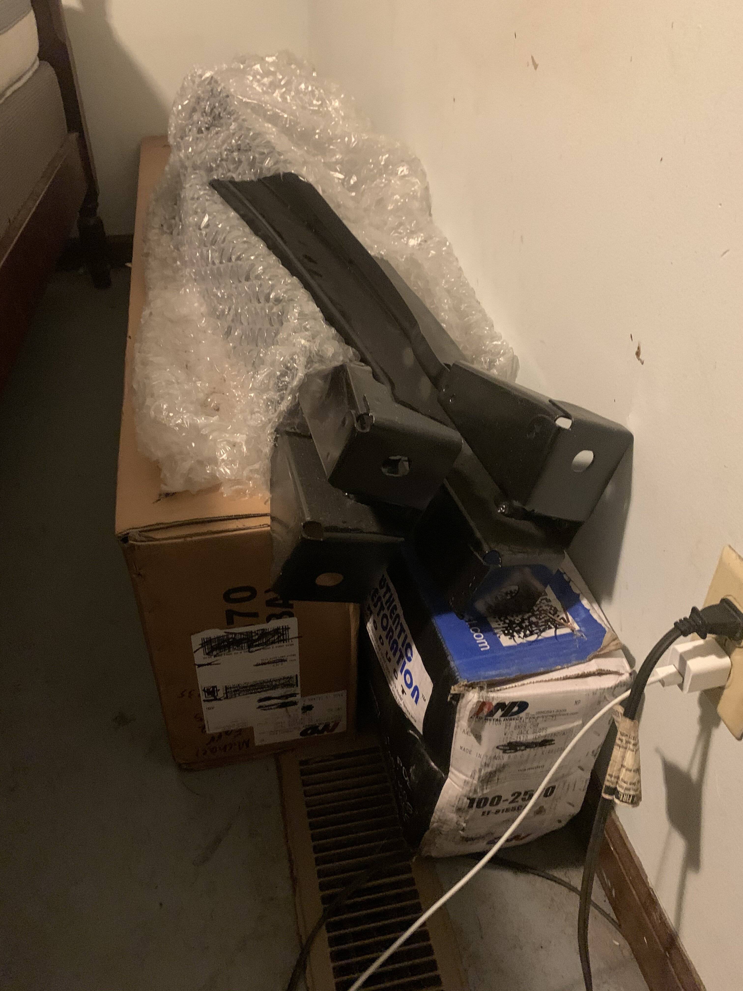

I have some parts in three and two all standard equipment except one rallye piece I believe. A green car might have been with this car and a blue one at one point.

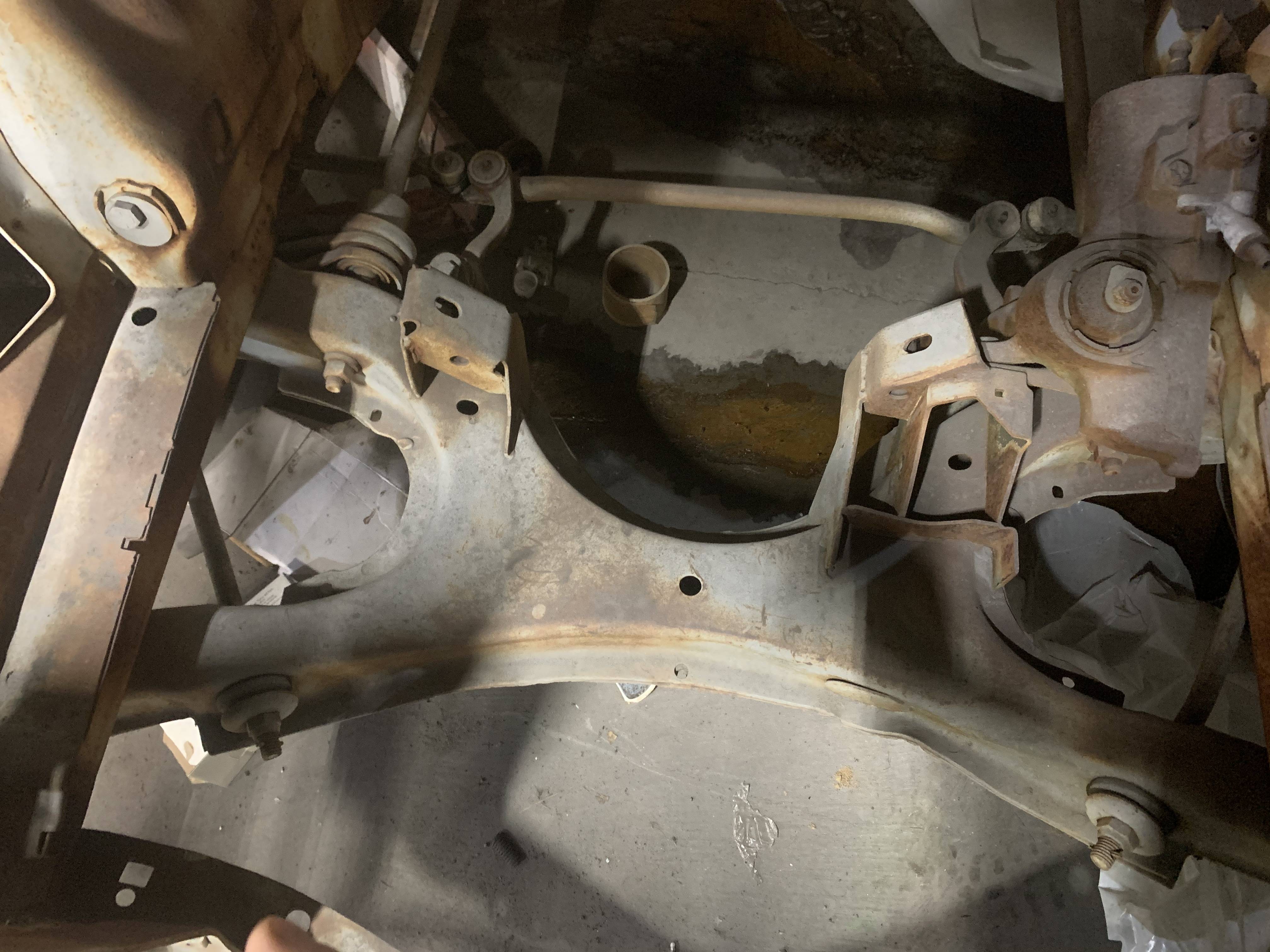

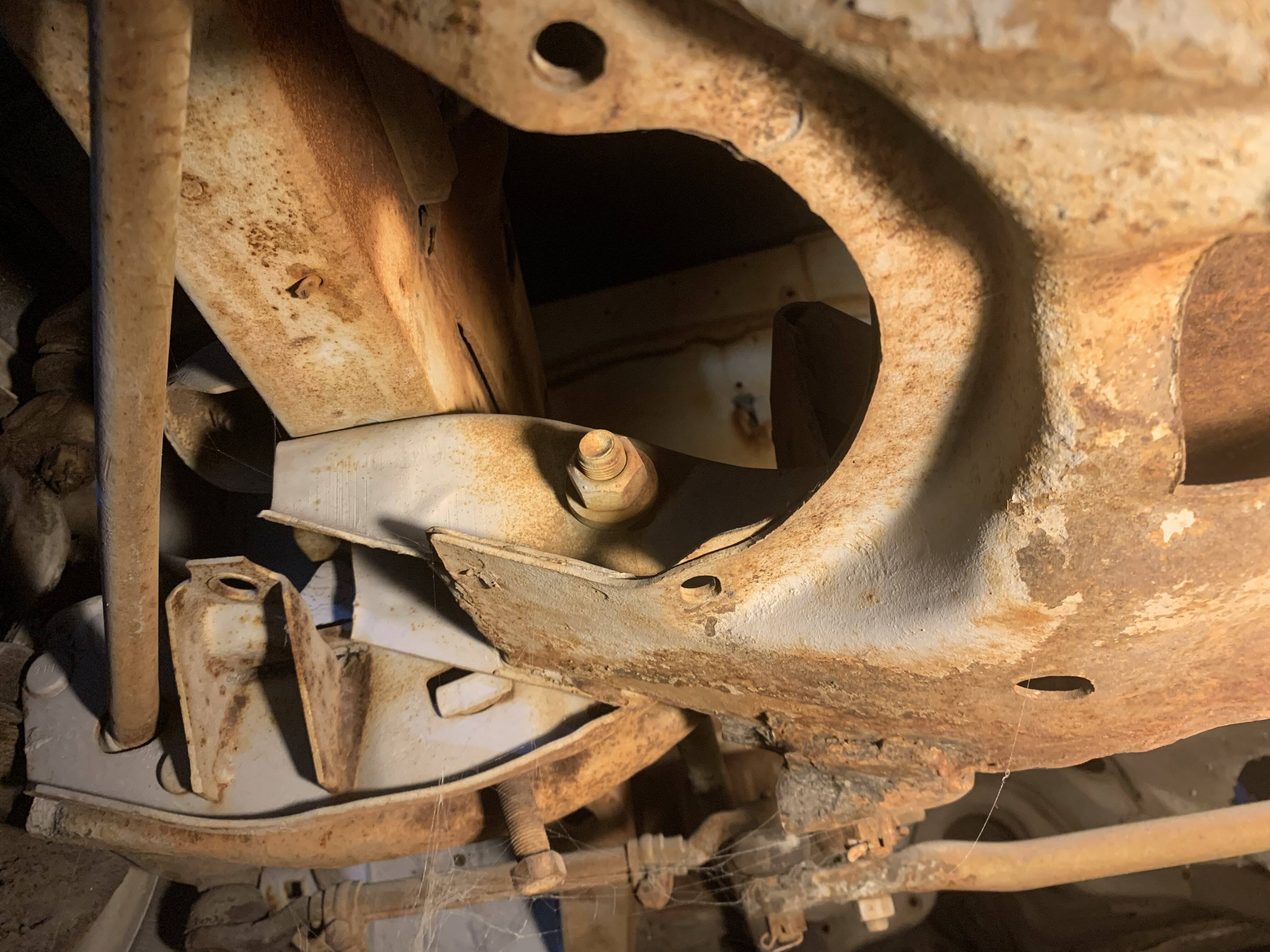

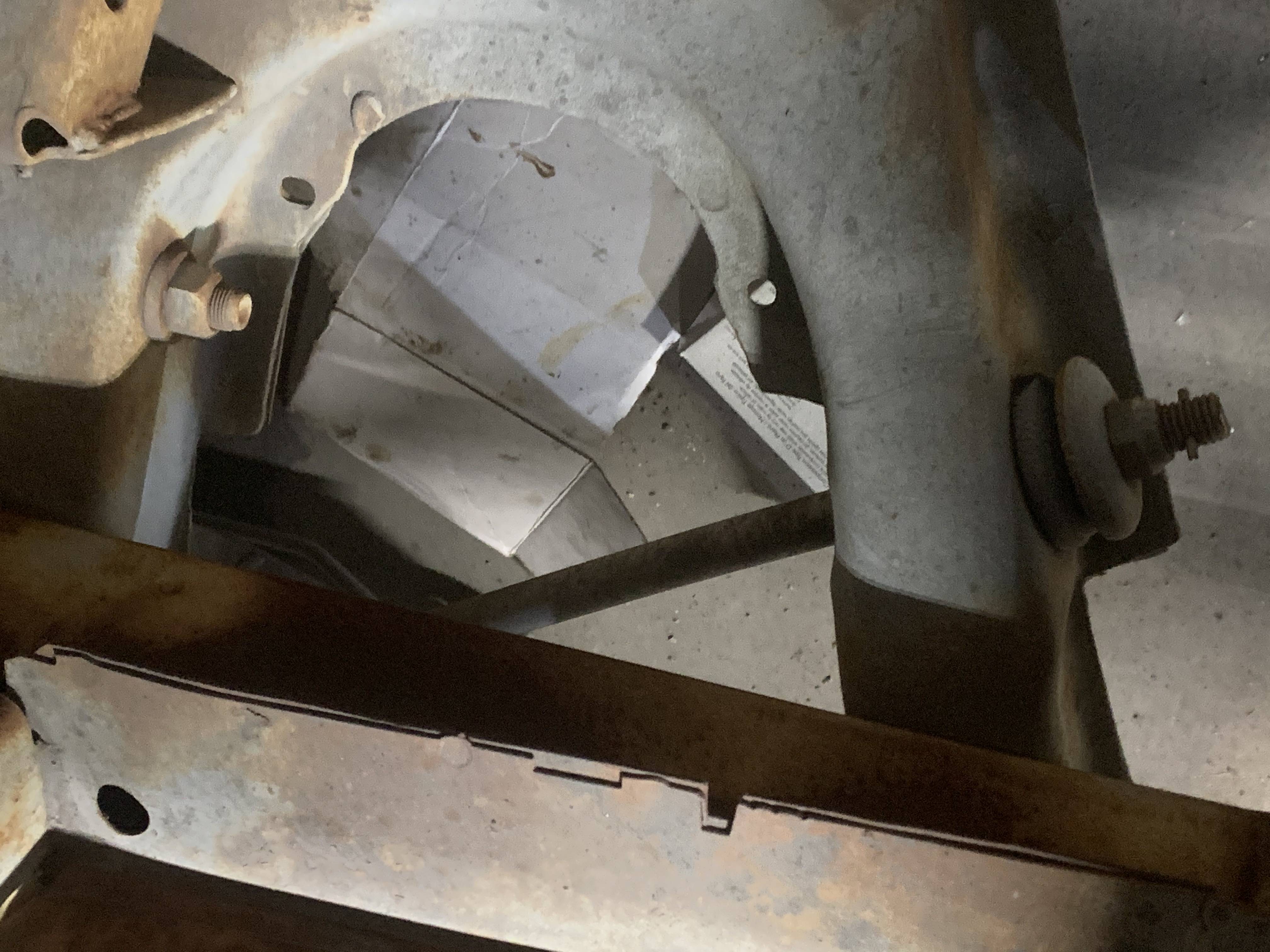

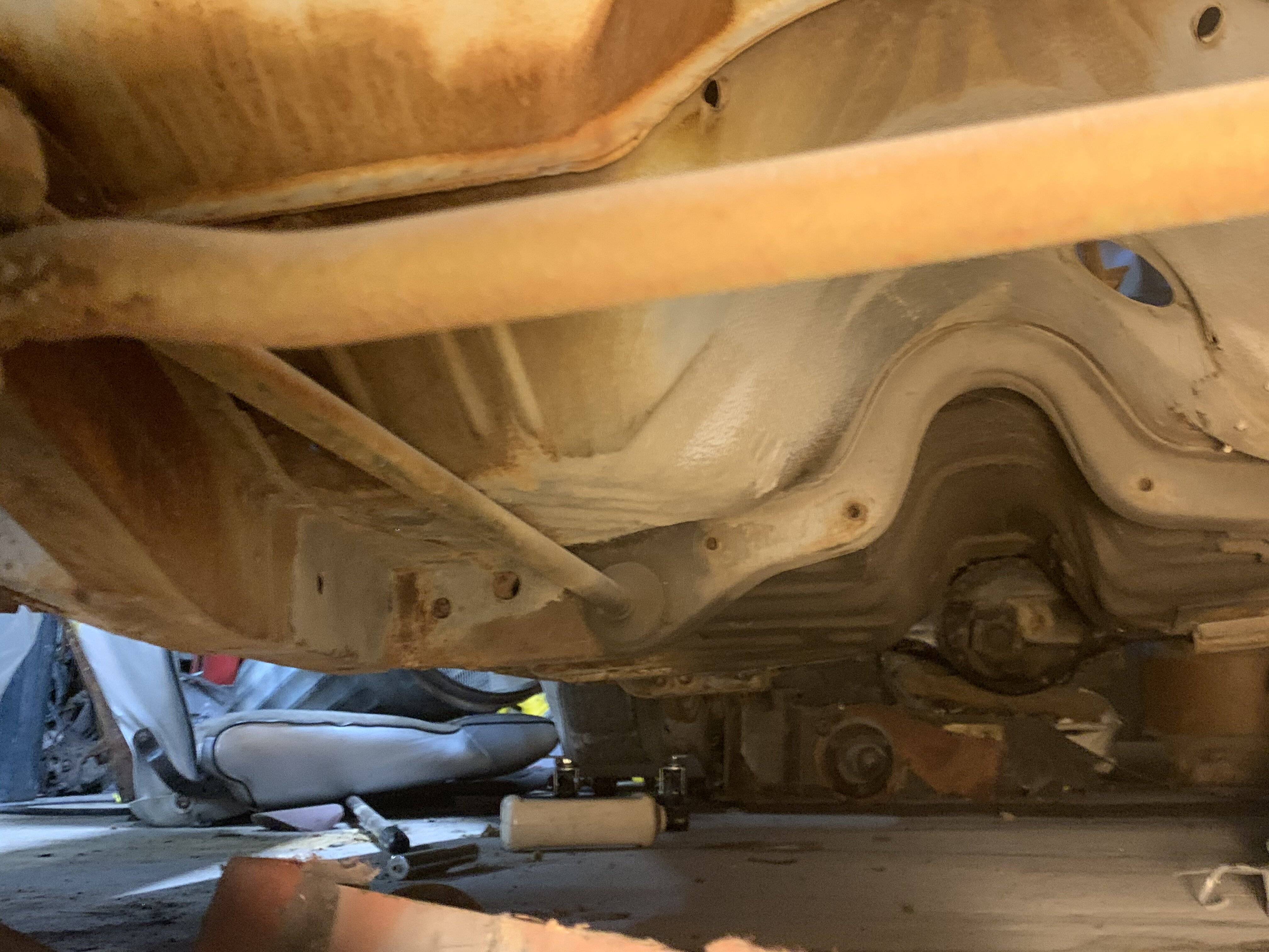

From what i can see looks like a solid car , no front sway bar may have been removed do you have a shot of the lower control arm see if it has a tag for the sway bar ,same as my latest was B5 then painted the same green as that was a slant 6 also E0132 start to the vin but was a JH23HCE0 with a b5 interior.
Looks to be quite original looking at the bolts & bushes
Im thinking it’s a 440 6 k frame. The sway bar tags does have signs bolts was there by the circler psi digging into the metal while tightening the bolt upon the tag will have to sand to be sure. It’s a solid car and very very easy to finish. all the hard work has been done it’s prepped that’s why I know it’s worth 10000. Anyone who knows sand blasting know it costs thousands to do this in labor and overhead. I’m just sick of thinking negative thoughts of what’s happened with this car possibly.

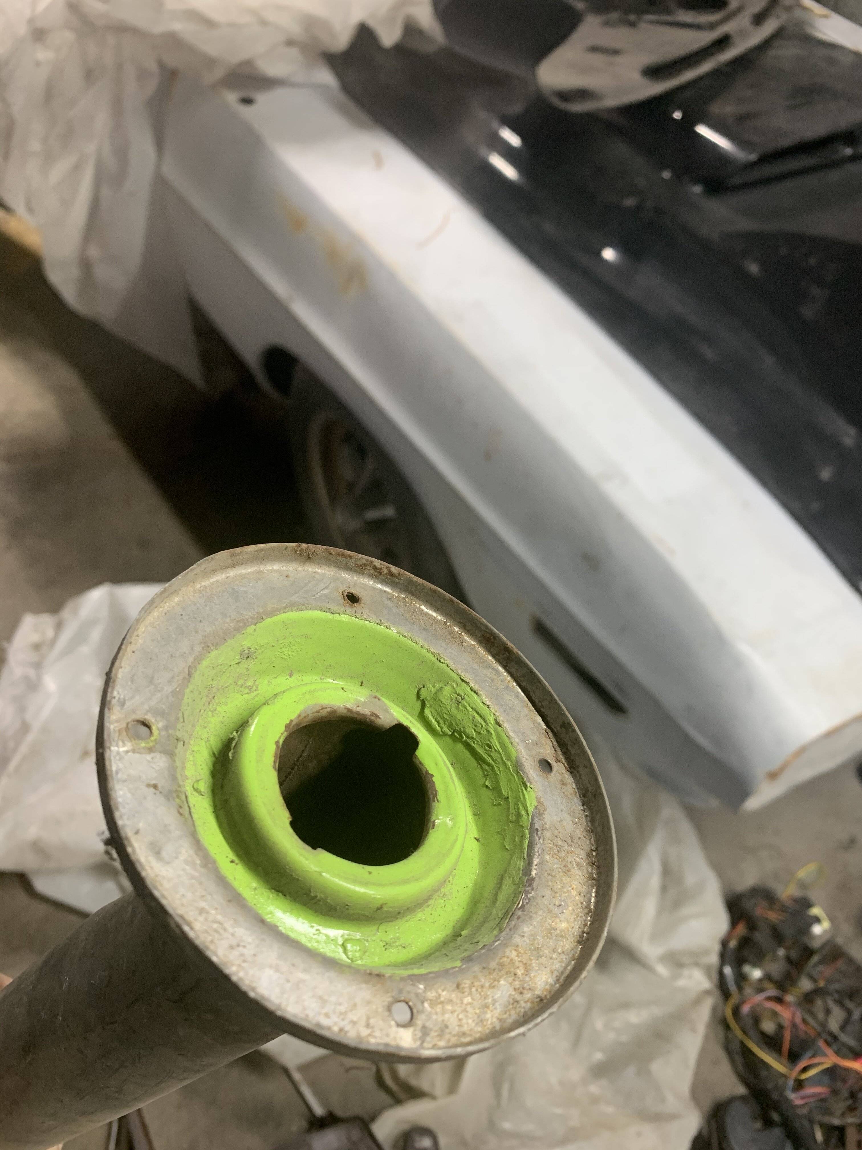

The chunk might have been replaced.

Drum brake front ,It has front torque boxes , front Sway bar,no rear tabs for sway bar
So what's the deal with the QR codes? I cannot see how having them in any pictures would be an issue.
I don't see anything in those pictures that would indicate is a 6 pack car, definitely had a sway bar but that doesn't mean a whole lot.
Agree no 6 pack there

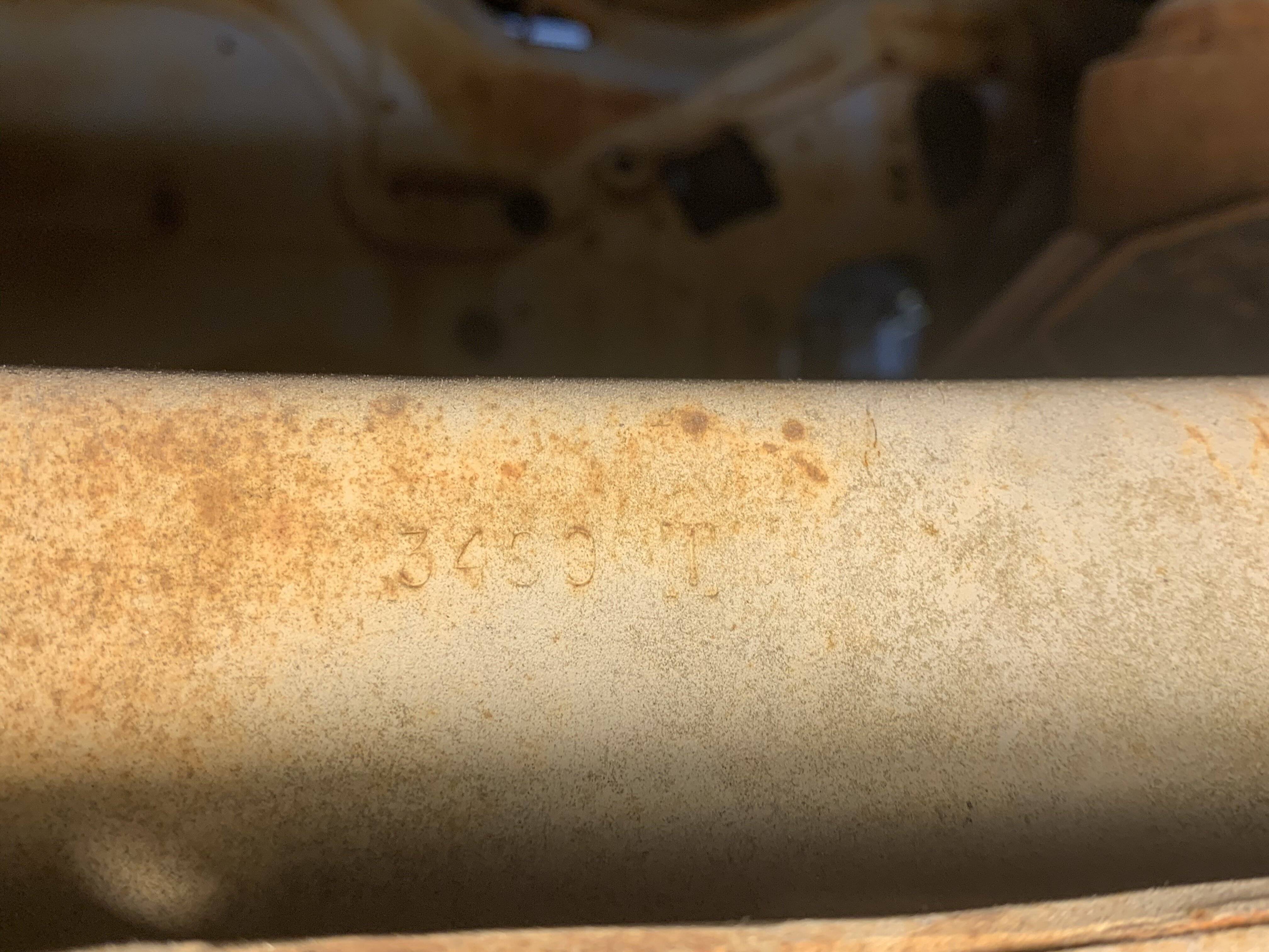

3480. Julian calendar says Date 1971 February 6th.

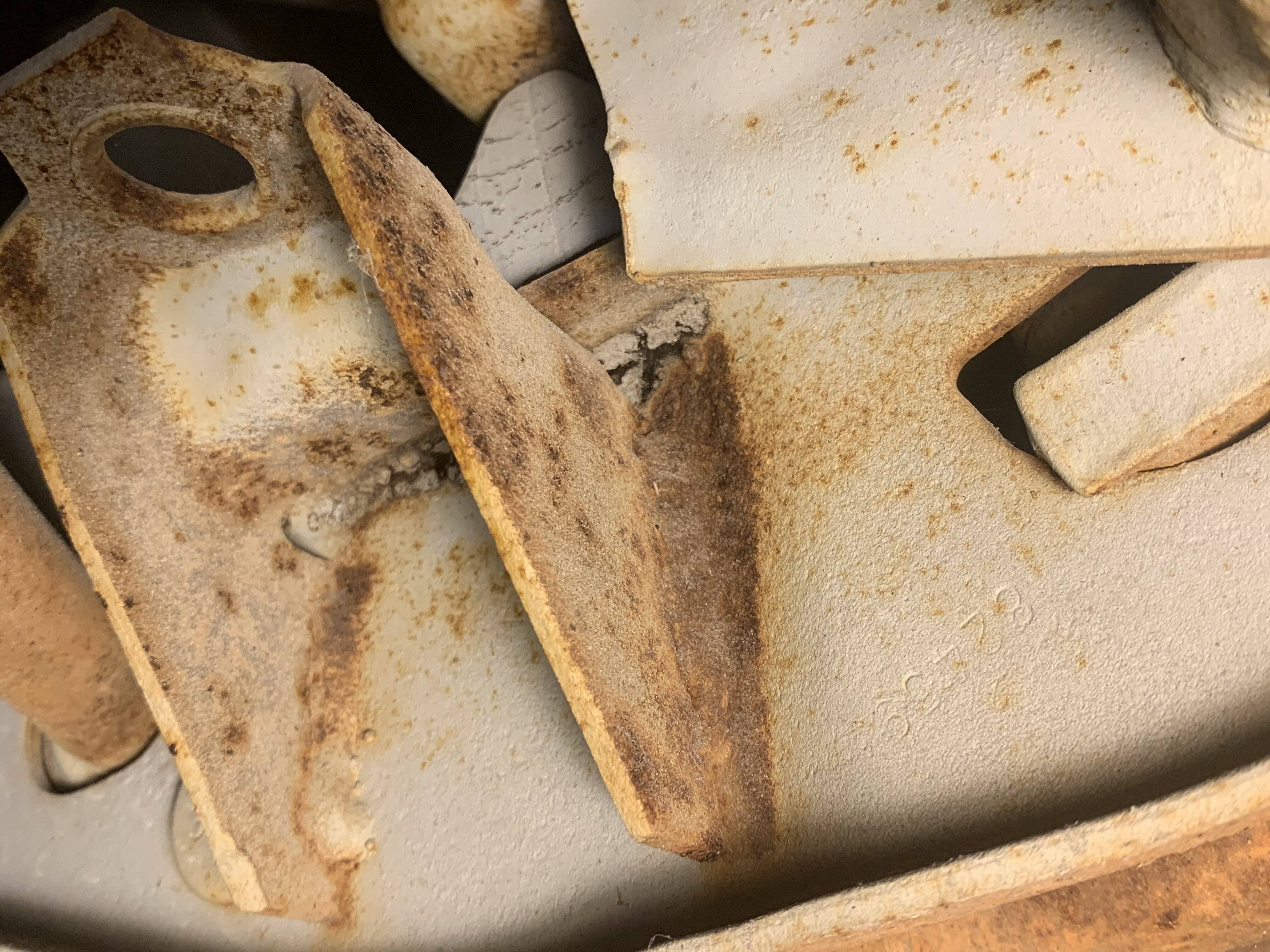

3480 date code for a 1971 challenger or barracuda. Or 348th day of 1970 I believe. When I strip this car I’ll find more I know. I still have to strip where you said to check also while doing it check below the cowl. I also have to check what fastmark said to check for heat marks below the cowl.
yes 71 k frame if you clean the Vin numbers up clean with a wire brush do not sand them you may find between whats left top & bottom there is enough to get a vin
