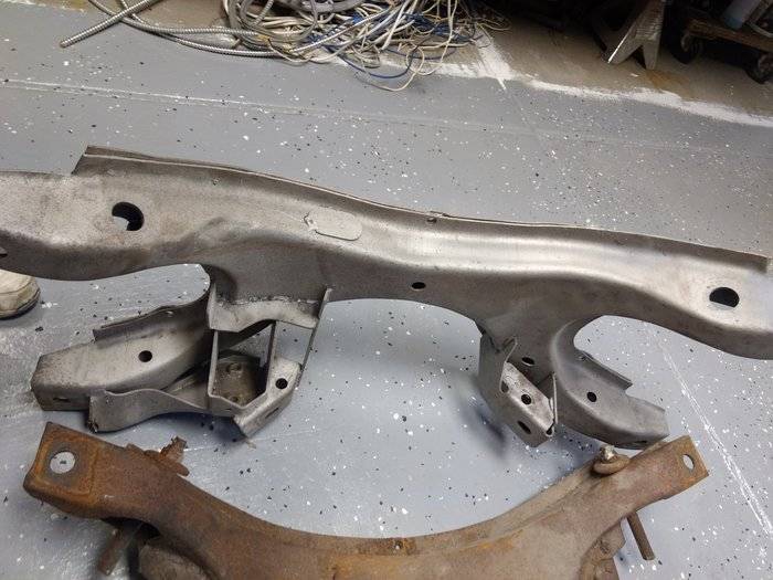

anyone know where to find numbers for reference to check what I have.
I sand blasted this K frame I bought from a guy who said it was from his B body.
in the crown of the front center are the numbers stamped -
0 4 7 0
or
C 4 7 0
It has a tag welded on the right upside down 12 -
before I begin to install this, just want to make sure its good for my 71 barracuda.
I plan to install an 440.
I have a second K member from a 73 cuda - in measuring all is close and seems the same,
except for the out side holes and frame are apx 3/8 longer/wider.
Thanks for any assistance -

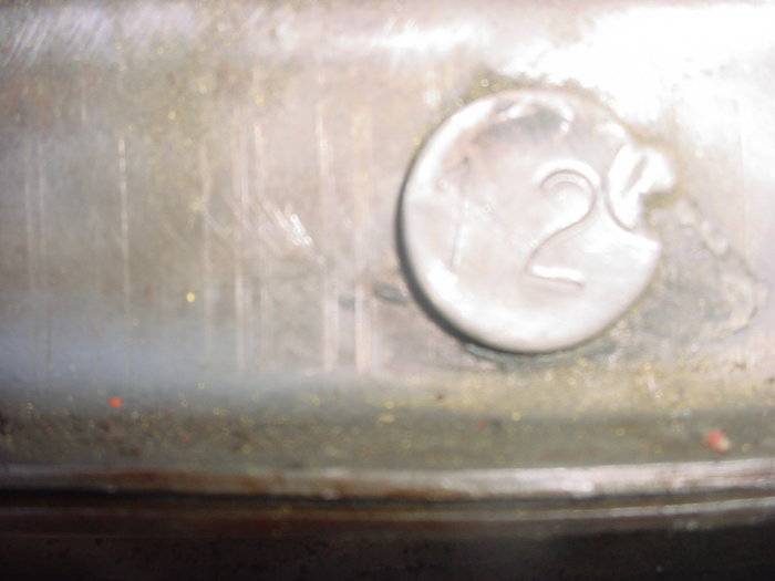

the center stamp should be the date code 4th 70 maybe.
I have a 70 A66 340 PS Sway bar also has the no 12 tag
DetMatt1
May 13, 2009
8,124
2,239
Metro Detroit
The 12 did come from a '70 E body with 318, 340 or 383 from the factory. They show a different part number for the 440 but that's probably just because the 440 unit had a skid plate.

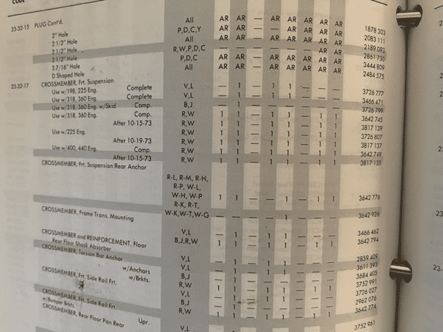

Check out this chart with the K frame part numbers (last two numbers of the the k frame usually on the "coin" and the K frame description picture

@parharamia, do you have a pic of the rest of the chart? I no longer have mine. I'm looking for the rest to 74. Thanks.
skip69donzi
Feb 10, 2022
169
30
missouri
1970-71 factory 440 k frame if it had a coin would be stamped with “74” last two digits of the part number; 3583074
