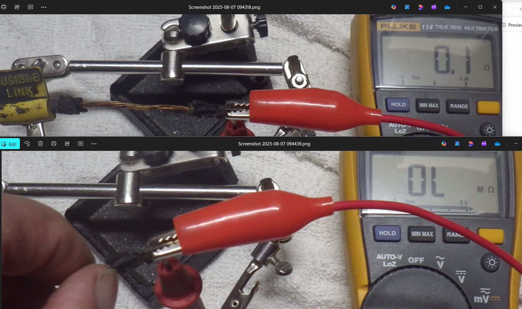

Last August the male terminal connector crimp went intermittent on my '69s fusible link. Just a slight bend was all it took to change state.....

That may be a fault in the fusible link or under hood wiring.
Get the engine running and start wiggling the connections - you may get lucky.
Sometimes gently stretching the wires works also.

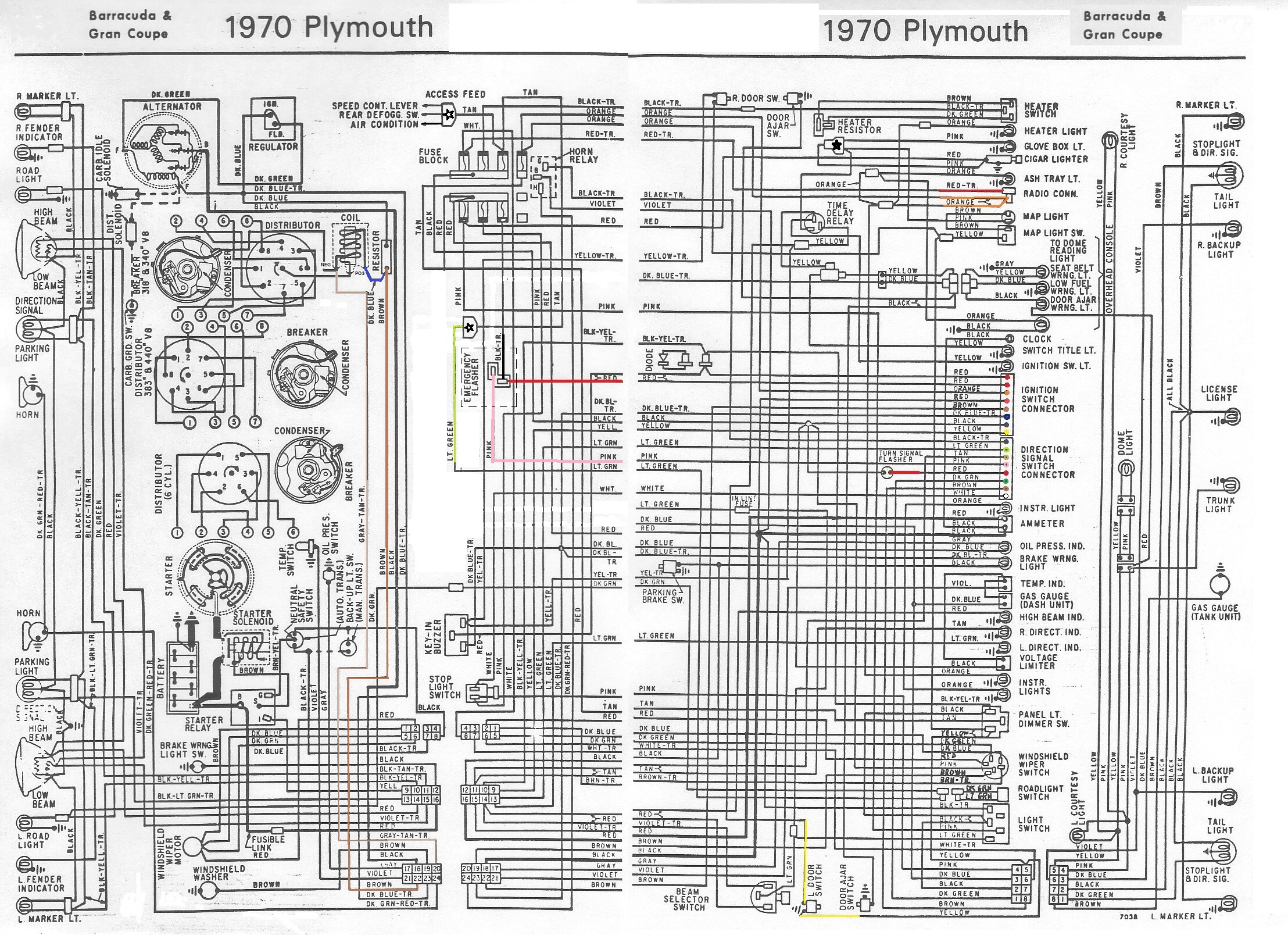

It could be a few things. In short check the battery terminals. Clean both of them. I say this so you know what it's not. Clean the wires on the starter relay. Clean the chassis ground in front of the battery. Then clean the motor ground. If you don't go through the process of elimination. You will be chasing you tail. It's maintenance that should be done anyhow. You might see something in the process. Fuse able link swollen.
Next I would inspect and clean the bulkhead connectors. Connector 16 red is the battery feed to the amp gauge and splice one. All loads are feed from splice one. If there is no power going to the ing sw the engine will stop but there will be other things working. If the alt feed connector 18 black is not good. It will not feed power to the alt. The alternator won't charge and you loose it all. So inspect and clean. I think you are going to find them melted. When it's cold there is contact. When it heats up it expands and breaks the connection. Let us know what you find. I will continue in the next post what to check next.
Ray's car is a 1970 Cuda 340 Automatic with Standard Instrument Cluster.
I agree with those who are checking electrical/charging system issues. Loss of Alternator/Battery power to the electrical system and ignition.
The 1970 Barracuda full electrical diagram is helpful for troubleshooting.

This may sound like a pain in the butt, but your symptoms seem indeed electrical. Start with the fusible link. If you had a short of some type, you would be popping fuses, or burning harnesses, and things would progress from bad to worse quickly. So I suspect you simply of an intermittent connection issue.

But again, start with the fusible link.
