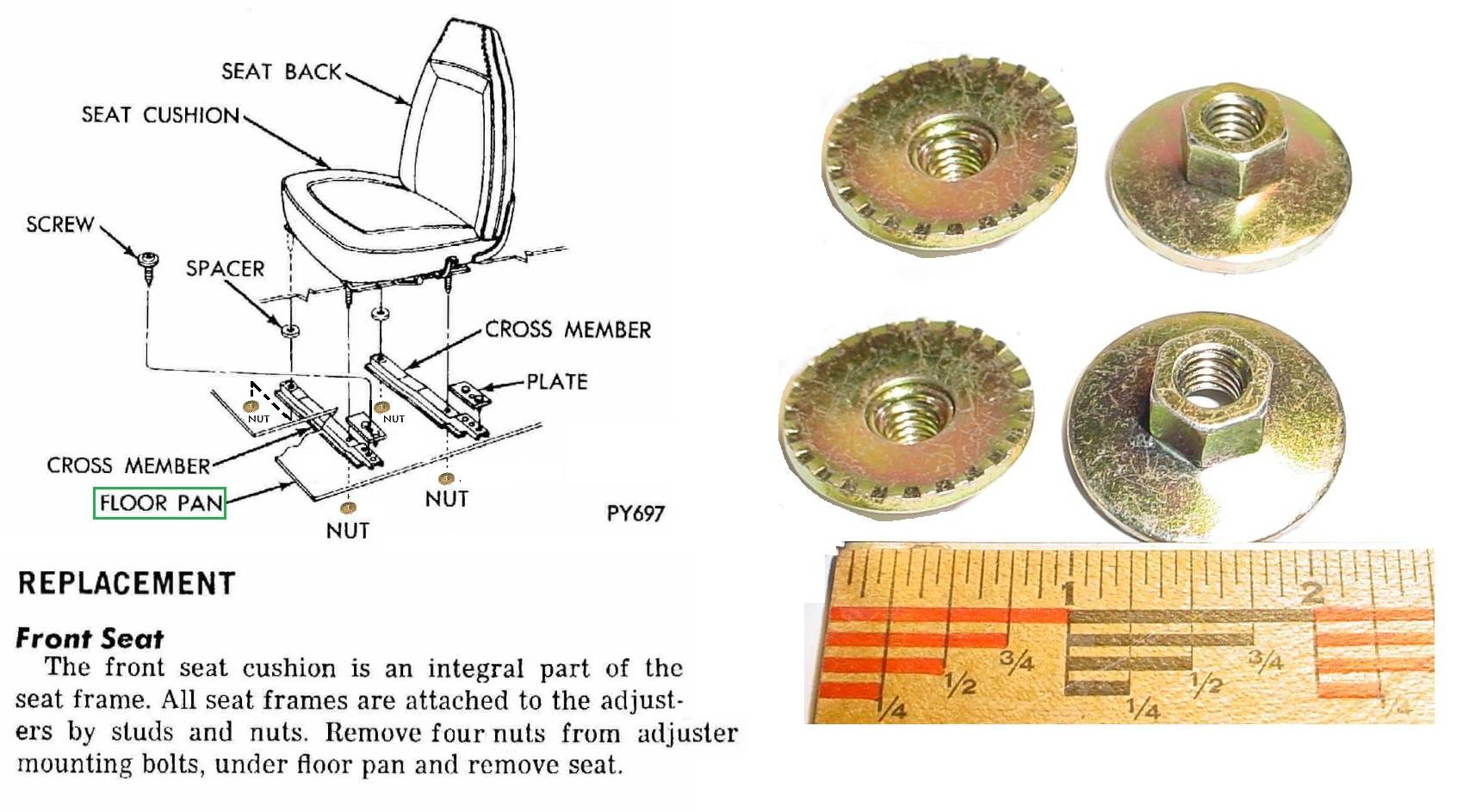

Service manual diagram and seat nut type/size

Yea easy peasy - no jack required - and you definitely need to remove those nuts on the underside as they hold the tracks on top of the carpet - you need those tracks out to work on the carpet
