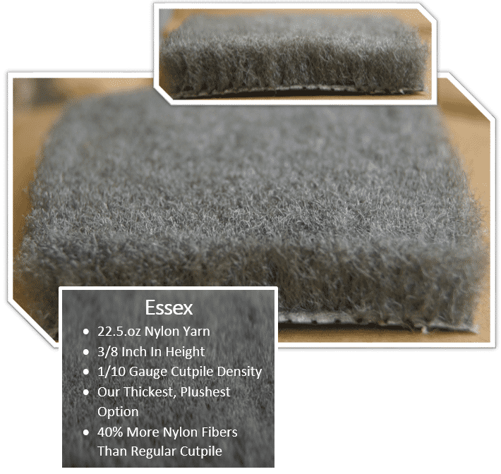

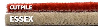

Looking at Rock Auto, seems ACC has 4 options,
1. Loop - 80% Rayon / 20% Nylon Carpet
2. Loop with Mass Backing
3. Essex
4. Essex with Mass Backing
Thoughts on what is what?

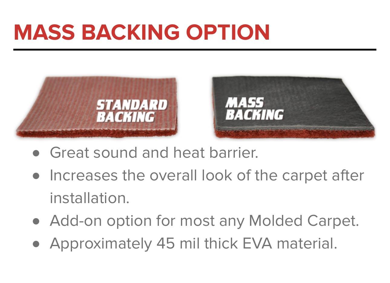

1. Loop - 80% Rayon / 20% Nylon Carpet came in my 70 Challenger SE. The mass backing will be extra.

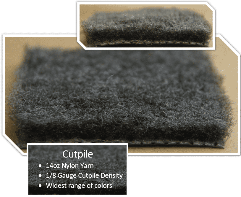

I agree with ACC Carpet. I got new carpet from them last year and it was a great fit. I got the 80/20 loop because that is what was original in these cars. The Essex is basically cut pile type carpet, what is used in the late model cars.
I got the mass backing option and feel it was worth every penny spent! The carpet laid much better than the ACC carpet I put in years ago with just the jute backing. The mass backing does add a little thickness to the carpet so if you're going to be fitting the carpet over a modified transmission tunnel you may not want to go that route.
