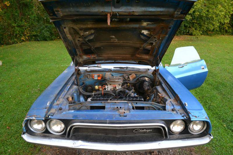

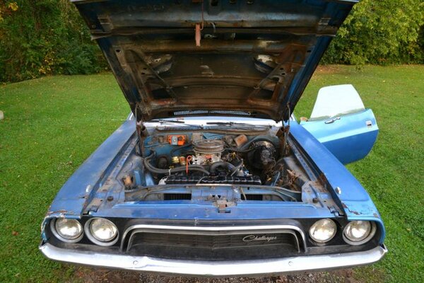

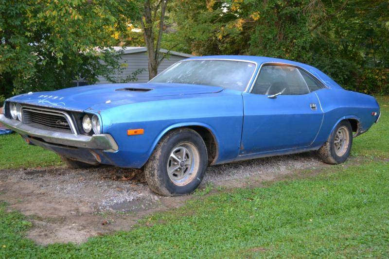

Let's see if i can post a pic the right way...
Bingo! there we go. This pic is from the ad when i bought it in october last year.
As bad as it looks, its actually much worse. If the drivetrain hadn't been new, i would have passed on it.

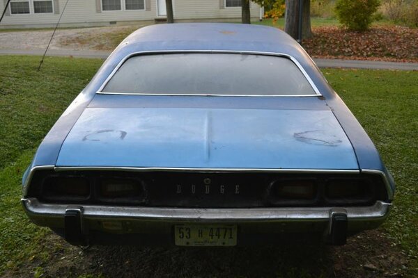

Removed the rear valance and bumper over the weekend. The big bolts holding the brackets to the car were the biggest pain in the neck! One rounded off the head. All but one valance panel bolt either twisted off, had to be cut, or ground off with an angle grinder.
Hammered the valance back into shape. Removed the rubber impact pieces from the bumper (again, bolts twisted off).
The bumper was deformed, looked like someone yanked it with a tow hook. Gave it wack or two with a sledgehammer and "fixed" it.
Zipped it all back together again Sunday night with new hardware and drove it to work this morning. Now that it all comes apart quickly its time to order some early bumper brackets and tuck those suckers in!
A pic of the rear when I first got it, sort of a "before" pic. Need to find a good camera for the "after" pics...
