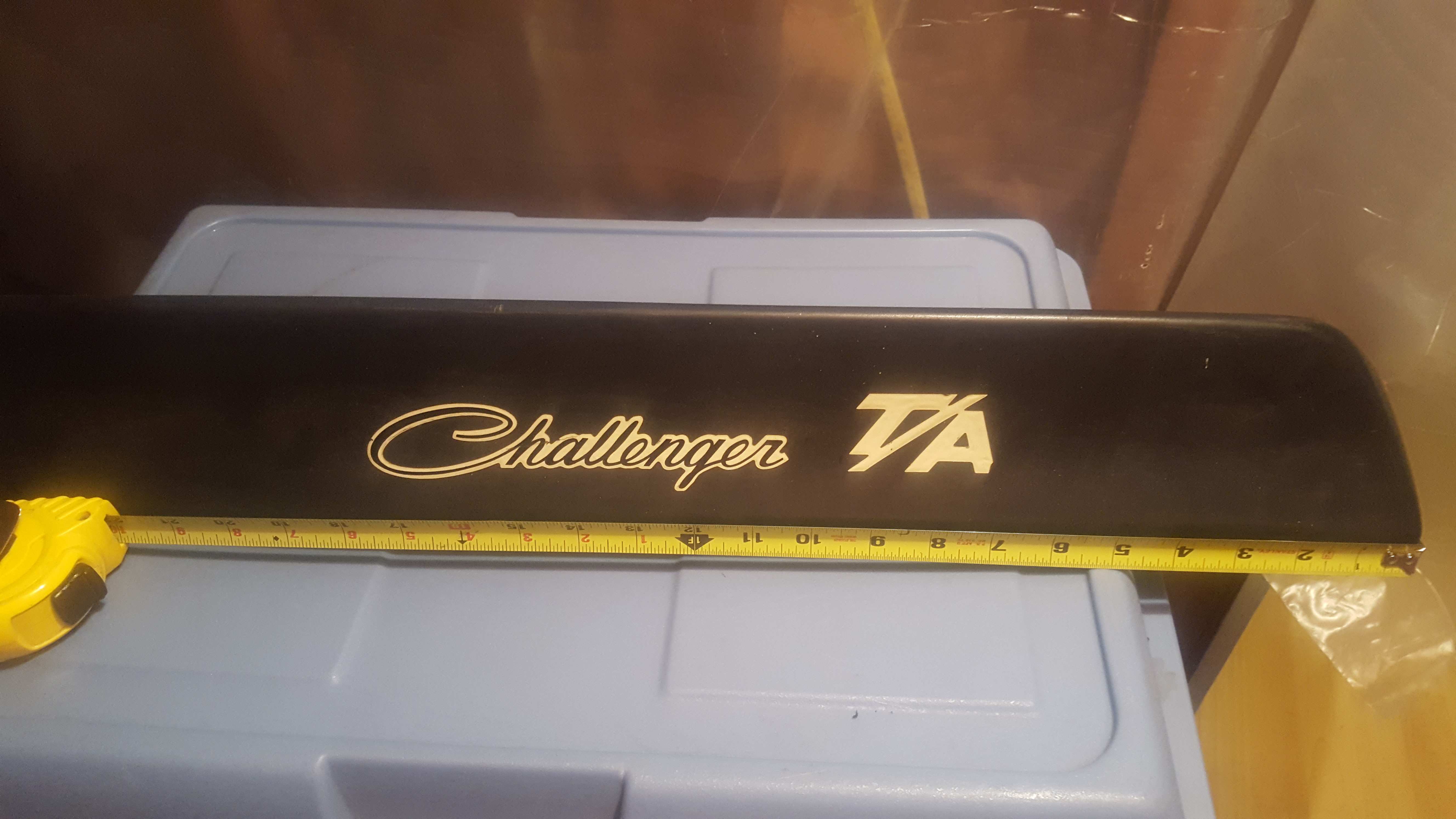

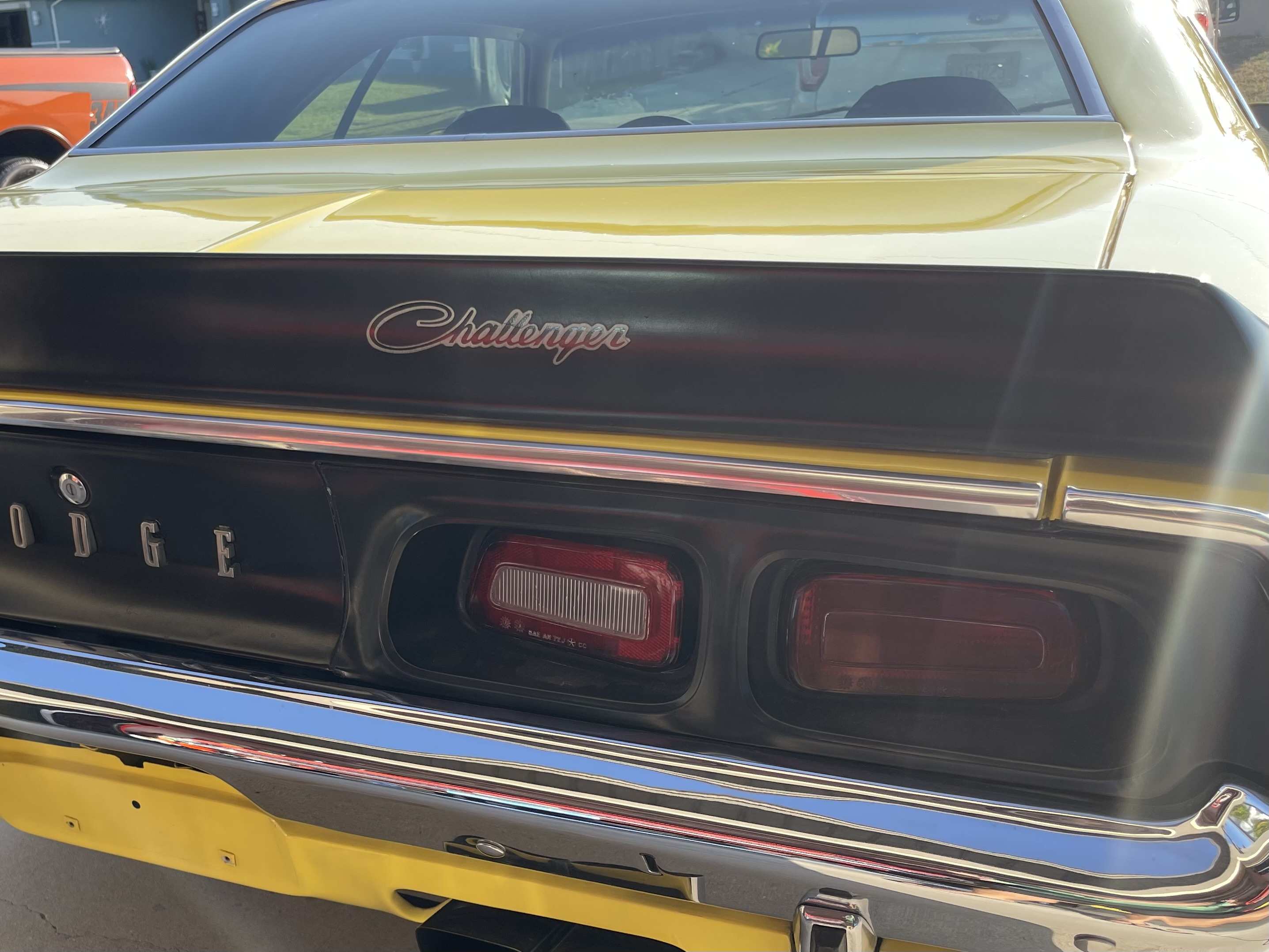

Does anyone have the measurements of where the Challenger text go in telation to the wing. How far from outer edge of wing and how high up or down from top and bottom edge. I think previous owner just non-shall ante threw it on there.
