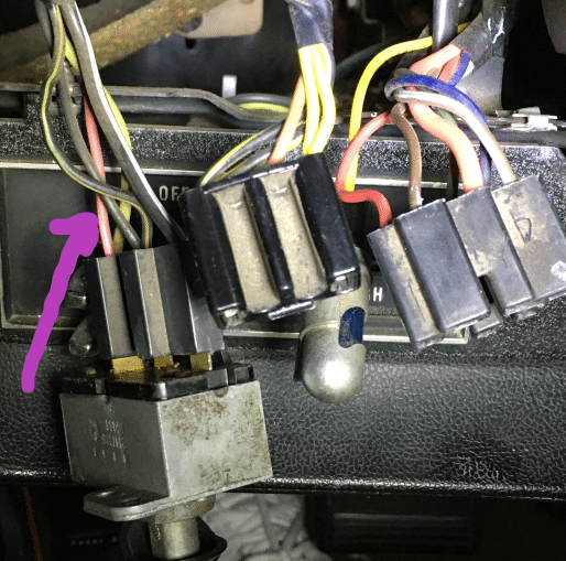

Checking a light dimmer switch
Tested and it still only works for headlights? Thanks for your help. any tips as to why running lights fail to turn on?
key is in on position when tested.
Do you have power to the terminal B2? If not you need to get out your wiring diagram and follow it back to the fuse box and beyond.
In this switch it would be the spring tension to help make a good contact.look at contact to see if burnt away. A weak spring from heat would allow arcing and burn contacts.
Yes B2 on headlight switch the connector has no power, traced to red mold and cigar liter its dead also.
fuse 4 is good and has power to it.
Parking lights working was Fuse 4 blown! so back to trouble shoot Dash lights. Note the Dimmer light
on Dome works!! just no dash lights yet. Checking every bulb and socket and ground now.
Thank for the help Guy's.
