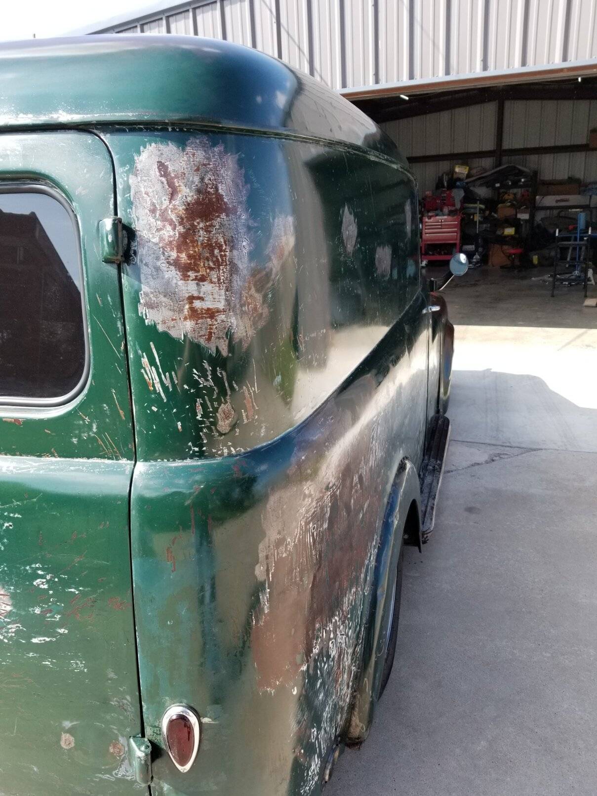

my 48 Panel van that i put a wipe on clear coat (Poppy's Patina). Looks great and lasts. Light sanding first to remove oxidized paint.
