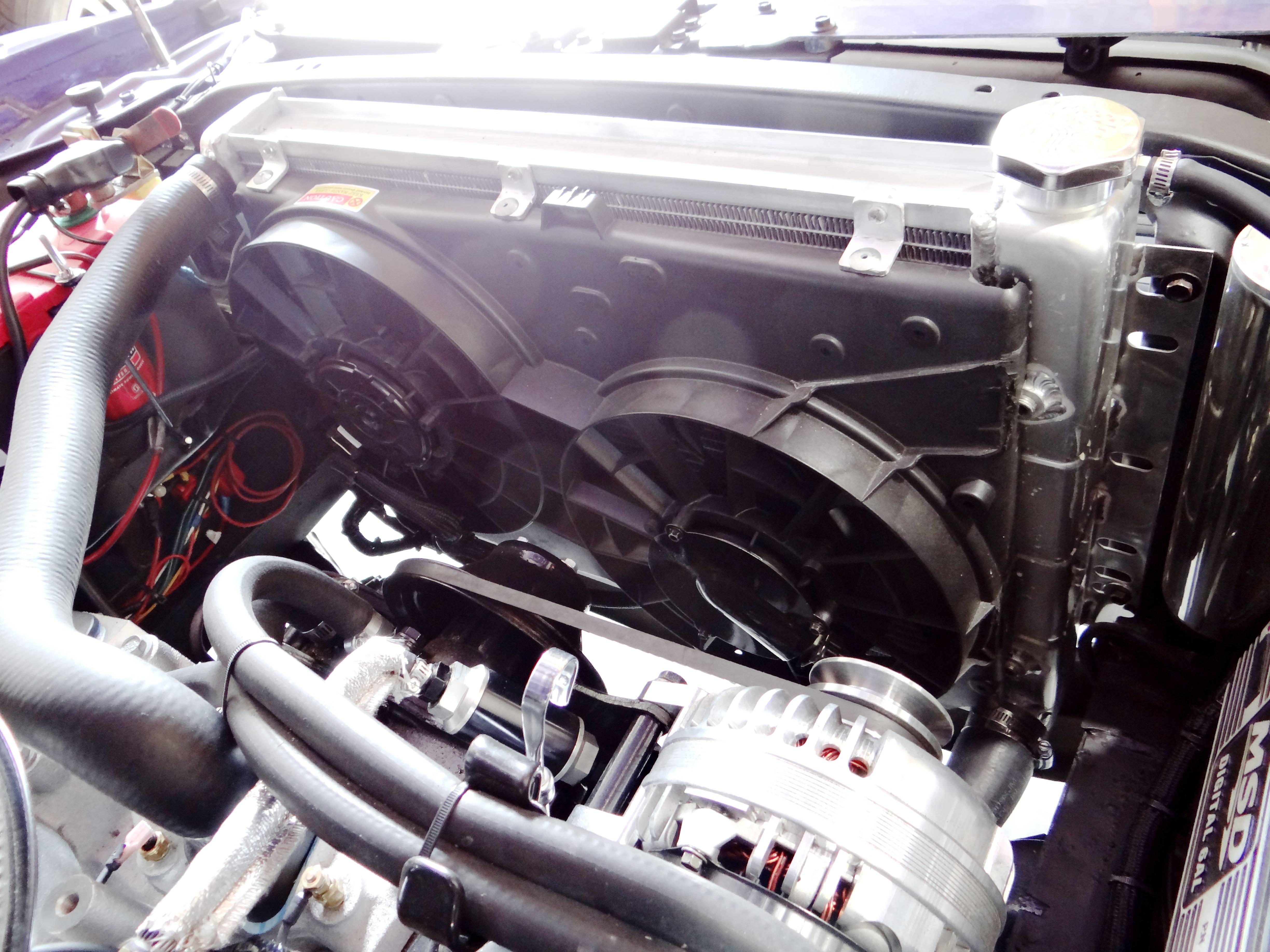

No experience with CC but agree with using 2 row crossflow 1 1/2 " tubes. Google comparison and you'll find this is modern technology that improves air flow thru the tubes, lengthens travel time across the tube, and aluminum offers better heat dissipation. I am running this set up on 3 resto mods - 383 El Camino, 383 66 Vette and the 408 Challenger. We have long hauled 13 early June Power Tours, 2 cars at a time, so about 70,000 miles real world experience. Talking heat as high as 105F and lines as long as 2 hours. Did a week in June in Texas. Tiny engine bay in the vette.
Never had a problem.
Also use a good electric puller fan. Used $100 4500 cfm Lincoln MkVIII fan/trimmed shroud in El Camino has done all 13 tours. The Challenger needed a dual fan for adequate spacing around water pump pulley, so I got a 3500 cfm $100 Contour fan from Rock Auto and trimmed its shroud to fit.
