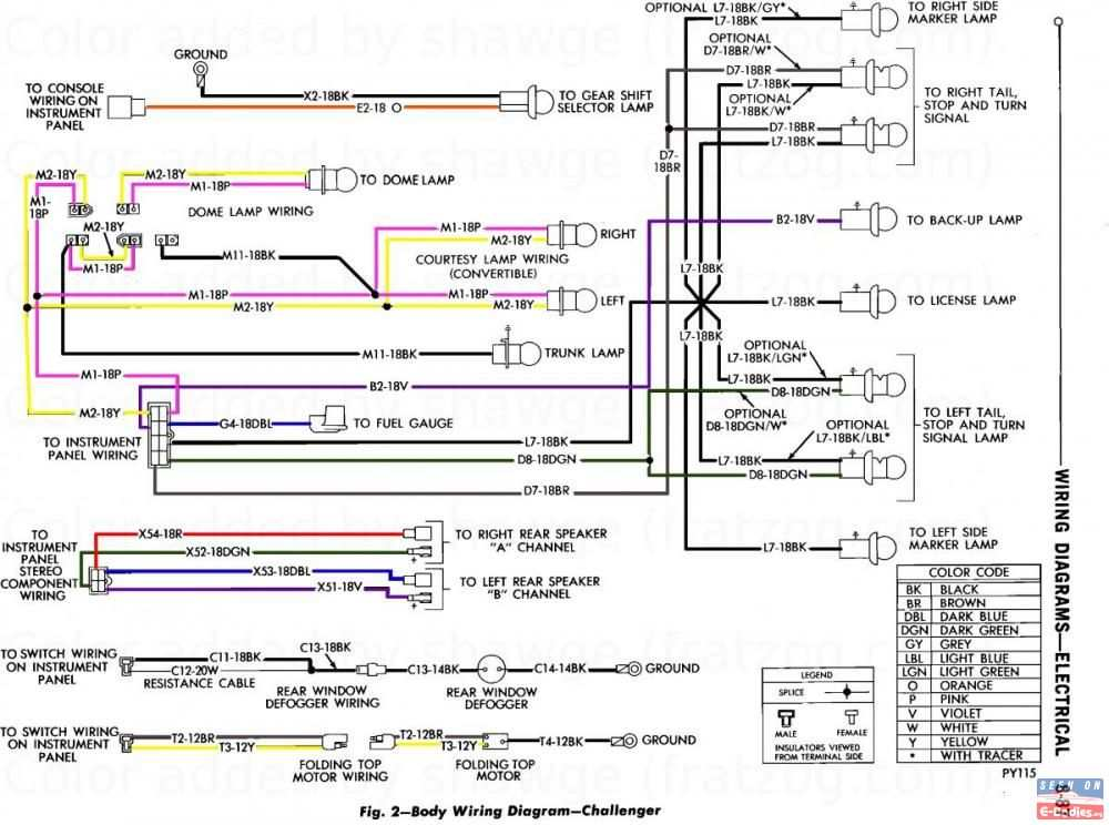

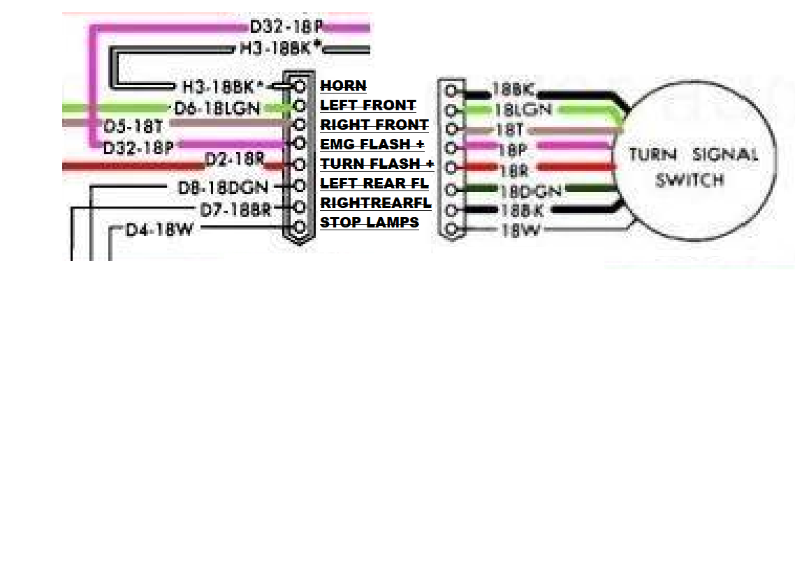

and i can't get the map light to power up. door switches don't trigger dome light either. seems like everything else works. Even 4 way hazard lites work. Anybody got ideas as to how to chase this problem down? Steering column connector is well connected. dash is installed/grounded
